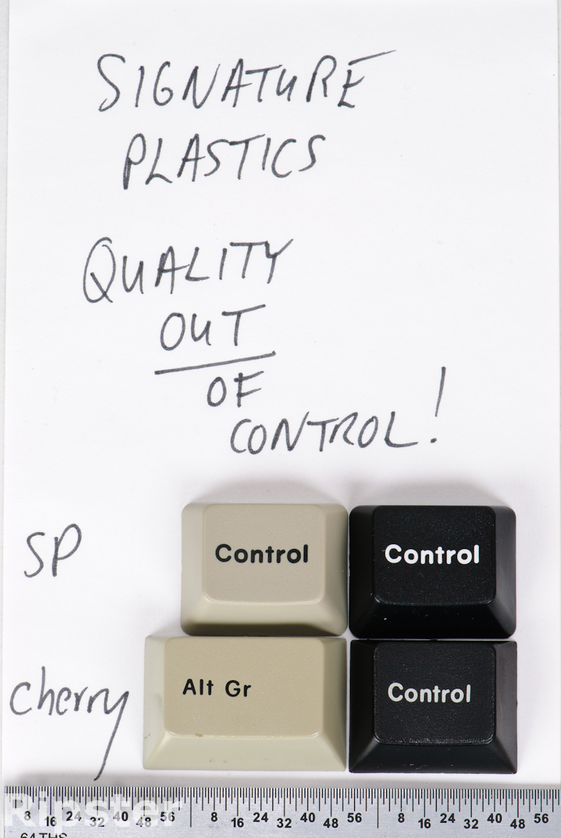

ripster
11 Mar 2012, 02:20
I'm not quite getting the Signature Plastic $100K number either.
They need metal molds for the 1st shot R1-R4 profiles and modifiers but CNC cut the second shot mold out of acrylic.
I think it's like Unicomp and tenkeyless. They give big numbers when they don't want to do something.
Even my bike brakes are now CNC milled, not forged. Why would the metal molds be even close to $100K?

ripster wrote:I'm not quite getting the Signature Plastic $100K number either.
Ended up being $50K btw.
I KNEW it wasn't $100K.
However the outcome is unchanged.
