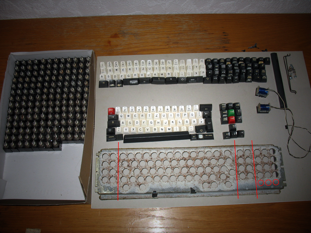

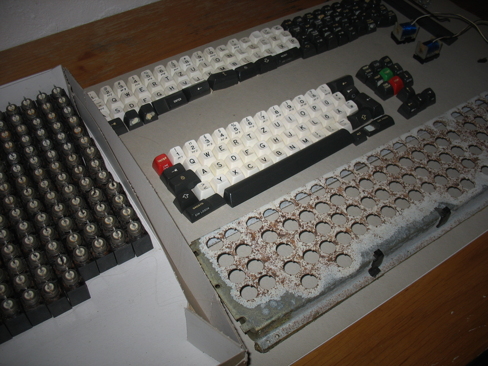

Today i took apart the two beamsprings retrieving the items i want to use:
The next stepp will be (a lot of) cleaning and derusting and then cutting the perforated plate and adding three additional holes:
I have some ideas concerning the electronics (straying away from capacitive sensing) but need to do some testing before i can write more on that.

Switch plate:
Not sure yet.
  • Easiest would be modding the existing plate (but it is true.. it would be nice to keep it original if i ever want to go back).
  • 3D printing would not be strong enough (the distance between the holes would be a predetermined breaking point.
    I would need to make it from many parts, too, as the printer build plate is not big enough and warping would be a problem if the parts are to big etc.
    Maybe i will try it but i am not confident it will work.
  • 1,5mm thick aluminum, a drill, a file and patience might be the best way (but i will first ask how much lasercutting would cost... maybe it is not that expensive and i am quite good with CAD software).

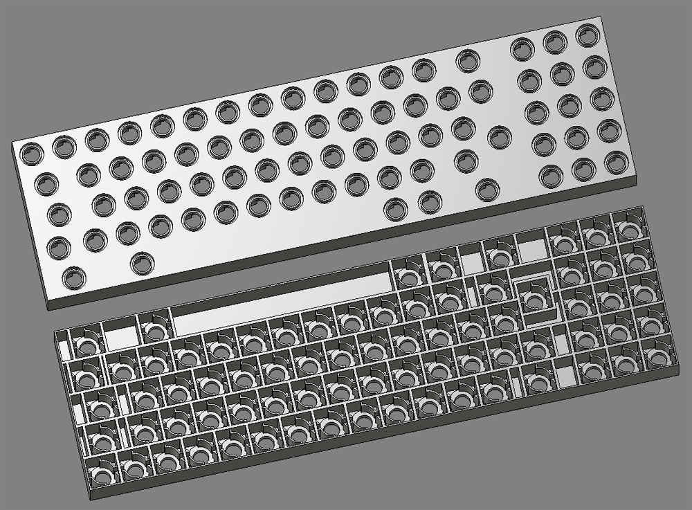

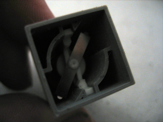

So, i have two options now:
1. Lasercut (and maybe bended) aluminum (or steel) plate (it is actually not that expensive, i was surprised...).
2. Printing a "rack" with the switch housing imbedded (plate only would not be stable enough) and only transfer the innards of the beamspring switches.
I did some testprints with a single housing and now, with revision number four, i have something that works surprisingly well:
The whole rack would look like this (but needs to be printed in two or better 3 parts):

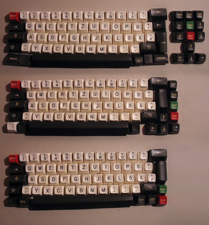

I settled for lasercutting some steel and started working on the CAD files. I now and need to make a final decision concerning the layout, too... in the beginning i wanted to make a TKL but a 65% or 60% beamspring board would be nice, too^^.
ATM i like the 60% most i think.

Is the ISO-like enter key on the 60% and 65% a beamspring/selectric mount keycap? Which keyboard is it from? I don't recognize it.
Monster-Toys
10 May 2019, 13:28
It is from my german "IBM 196C" ("Selectric II" in English-speaking areas i think) and compatible with beamspring switches.
I need get replacement somehow tho, as the typewriter is almost mint condition inc. cover and has all extras etc. ... too nice to be torn apart for keycaps^^.

Nice. They're cylindrical not spherical though, right?
Monster-Toys
10 May 2019, 15:26
Yes, they are. As the original return key has a different shape, too (concave instead of convex) it is no big deal i think (the bottom row with just enough room left to not fit another key is more annoying^^)

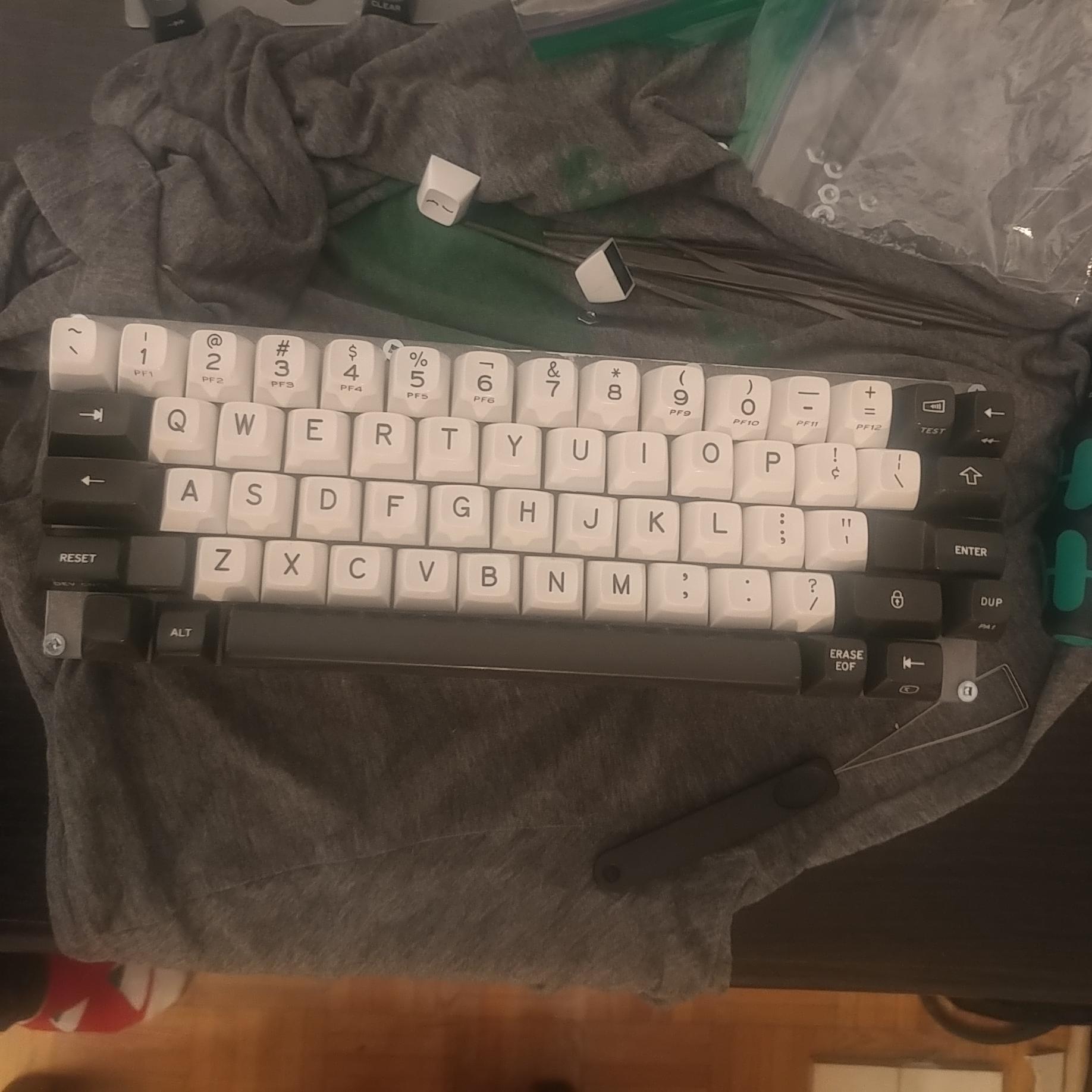

Monster-Toys wrote: 10 May 2019, 15:26 Yes, they are. As the original return key has a different shape, too (concave instead of convex) it is no big deal i think (the bottom row with just enough room left to not fit another key is more annoying^^)
If I were you I would use this sort of layout that wcass helped me with. Uses all original keys you should have them all. It is quite usable.
Monster-Toys
14 May 2019, 10:38
Cool, i did not know somebody else did something like that... did you make a thread about it? (I am back to tkl atm. I recognized that i use the arrow keys quite a bit when editing texts and using another layer for them would annoy me). The CAD files for the lasercutting are almost done (would like to have more time to work on it, feels horrible slow atm).
Btw.: Even though the selectric keycap does fit the switches, it is slightly bigger then the other keys and therefore not very usable.

Monster-Toys wrote: 14 May 2019, 10:38 Cool, i did not know somebody else did something like that... did you make a thread about it? (I am back to tkl atm. I recognized that i use the arrow keys quite a bit when editing texts and using another layer for them would annoy me). The CAD files for the lasercutting are almost done (would like to have more time to work on it, feels horrible slow atm).
I don't have a thread post yet but I think I will make one now. One thing I would recommend is making the PCB. Once you get the hang of it, it is not the hardest thing to do. Also Placas suggestion above of a 3d printed card is a very good idea. I have actually used this idea in some of my variants. I only have a cnc machine and not a drill press so it doesn't matter too much, but the little tabs are not the hardest to get.
