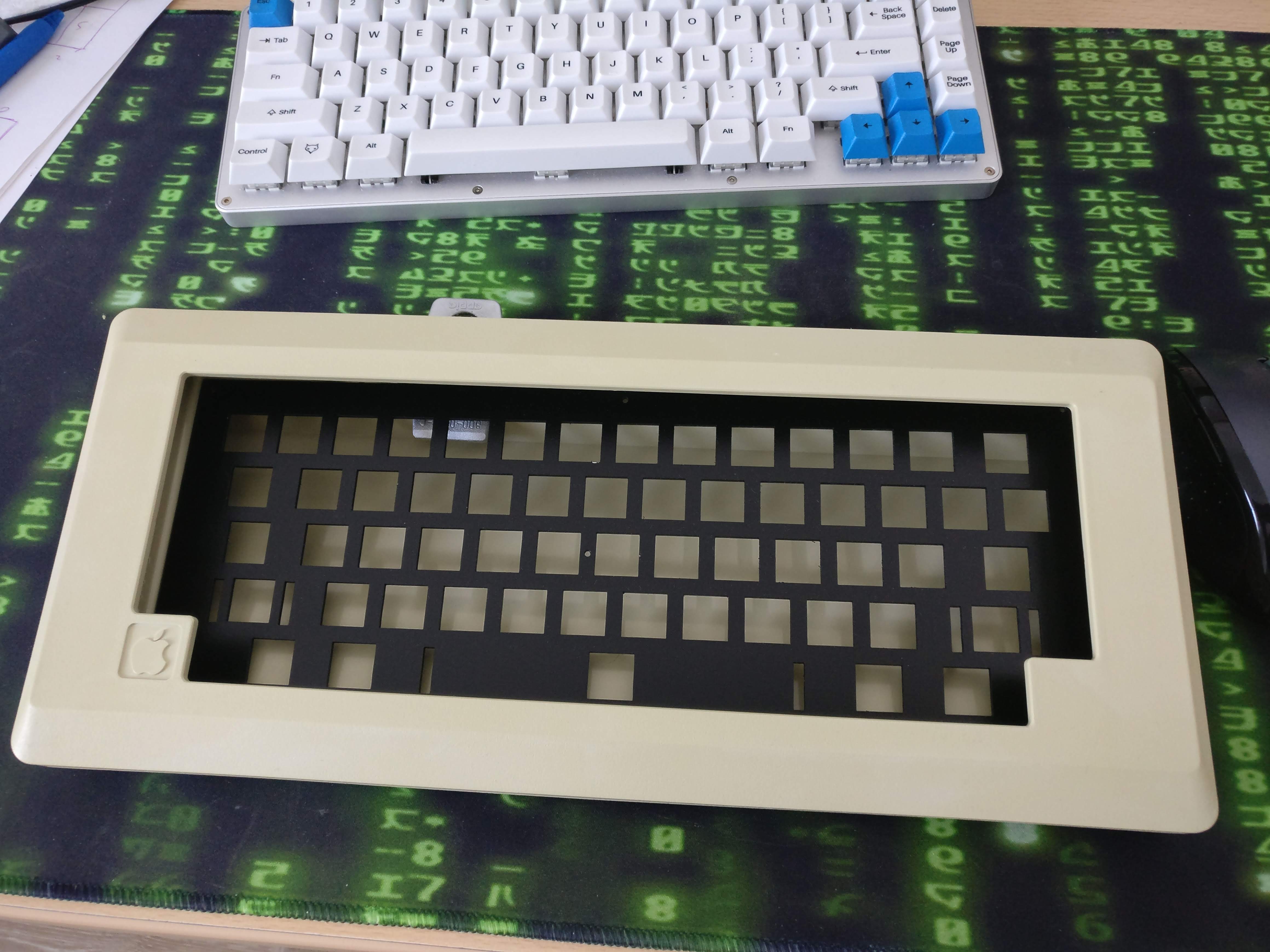

So, I bought an M0110 case and built a new switch plate for it. I now working on the PCB.
The case is already retrobrighted and I also painted the plate black just because (none of it will be visible so...).

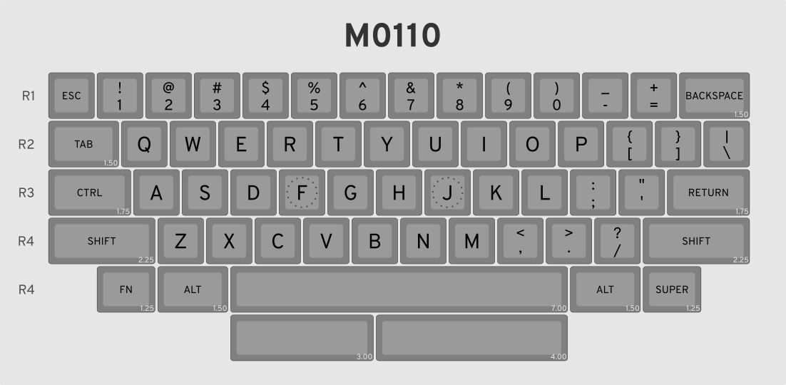

There are a few out-of-standard keys, notably the R1 1.5 backspace. Have a look

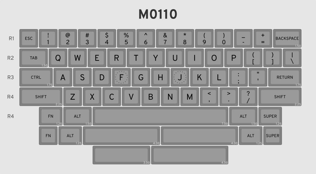

The PCB will support a split spacebar as well and I think I'm going to re-cut the switch plate for that.

Serious, if dumb, question: Apple M0110 keyboards used Alps SKCC switches. How clashingly low would MX switches look? (I suppose that SA profile keycaps would be mandatory for this). Would MX low profile switches even be above the case's waterline?
ALSO: since one of the design "features" of the M0110 keyboard layout is its symmetry, why go for an assymetrical split on the space bar? Why not go for a 3u/1u/3u formula? Or, given the availability issues of 3U keycaps, with a 2.75/1.5/2.75U split?

depletedvespene wrote: 17 May 2019, 19:03 Serious, if dumb, question: Apple M0110 keyboards used Alps SKCC switches. How clashingly low would MX switches look? (I suppose that SA profile keycaps would be mandatory for this). Would MX low profile switches even be above the case's waterline?
the case came to me without plate, but I already modded a m0110 and it doesn't quite work with standard cherry mx.
depletedvespene wrote: 17 May 2019, 19:03 ALSO: since one of the design "features" of the M0110 keyboard layout is its symmetry, why go for an assymetrical split on the space bar? Why not go for a 3u/1u/3u formula? Or, given the availability issues of 3U keycaps, with a 2.75/1.5/2.75U split?
I can't do that keeping the original layout, it could be done of course if I redo the whole case, but if we go for a "standard" layout (ei: 2u enter) we don't have the symmetry anymore.
edit: you could keep the symmetry reducing all modifiers size and make a 2x4u spacebars I guess. Not the easiest to source, but still feasible. Not sure I like this solution though

Uhhh... you've already made a modification to the original layout (on the M0110's bottom row, the space bar is 7.5U and the Option keys are 1U; you're using a 7.0U space bar and 1.25U Super and Fn keys); two 4U space bars wouldn't fit there unless you got back 1U of witdth.

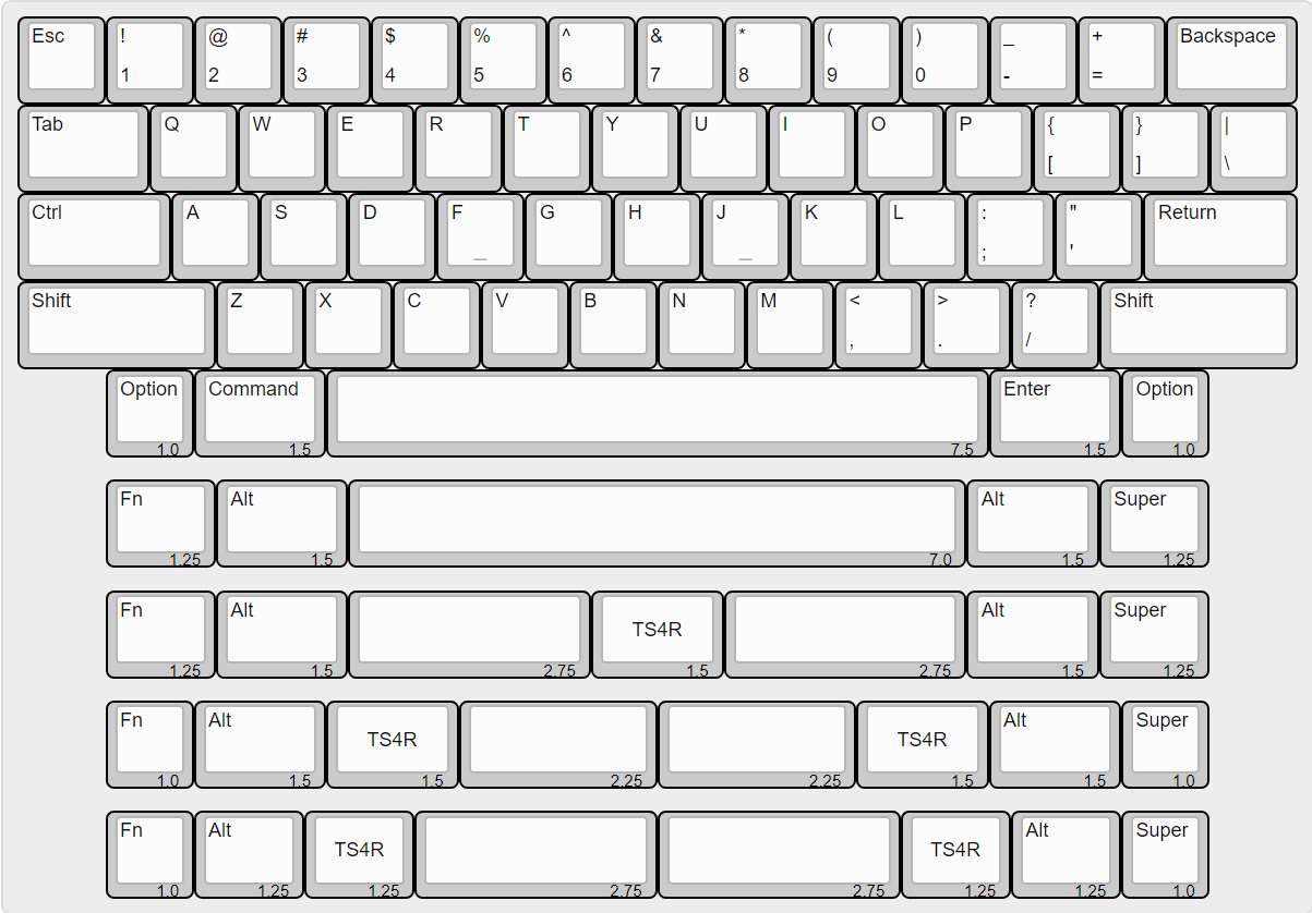

Indeed, and given that you have 12.5U of width to work with, there are several possible options to split the space bar while keeping the bottom row symmetrical (*):
Options for a 14.5/12.5U bottom row.
In my entirely subjective opinion (YMMV; WDIKAA), the fourth row in my graphic is the best.
(*) Symmetrical to the entire board, not symmetrical to the home row keys, it must be noted.

if this is one off, I'll go with whatever I can support with the keycaps I have, that should be either 7u or 3+4u. If there's any kind of interest I can add support for as many layouts as possible.

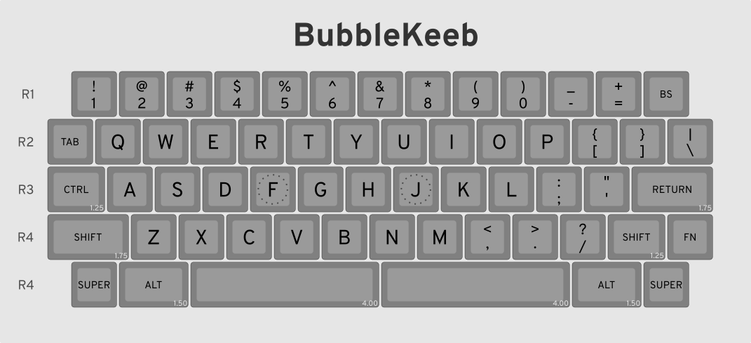

rather unrelated but while working on the layout I ended up with this:
don't know you, but I find it adorable :D I think I should make it
(alternative bottom row may apply)

It's not often that I see a 60% keyboard ("58%" would be a more precise moniker) that lacks BOTH the `~ AND the Esc key. Perhaps it would be a straight out necessity to make that 1U BS key into `~ and put Backspace on the left split space bar; more so, perhaps the left Shift key should also be split on the outer side to put another Fn key there.
Ob. disc.: as a lifelong vi user, I am legally required to hate this keyboard layout. Give me a few minutes so I can find more faults with it. :mrgreen:
EDIT: never mind that bit; sub-1U keys are the spawn of the Devil. Serves me right for not having my coffee before doing simple arithmetic.

ESC would be FN+1 (or vice-versa). `~ could be to the right of the right shift. c'mon man, it's a custom keyboard, with custom firmware you can do whatever you want. Plus you could place a plethora of 1Us to the bottom row.

matt3o wrote: 20 May 2019, 18:03 ESC would be FN+1 (or vice-versa). `~ could be to the right of the right shift. c'mon man, it's a custom keyboard, with custom firmware you can do whatever you want. Plus you could place a plethora of 1Us to the bottom row.
I know. It's just that moving Esc to the Fn layer seems like a violation of all that is well and good in this universe and its surroundings.
Also, don't think alternatives for the bottom row on your BubbleKeeb have not been popping and bursting inside my head all morning. ;)

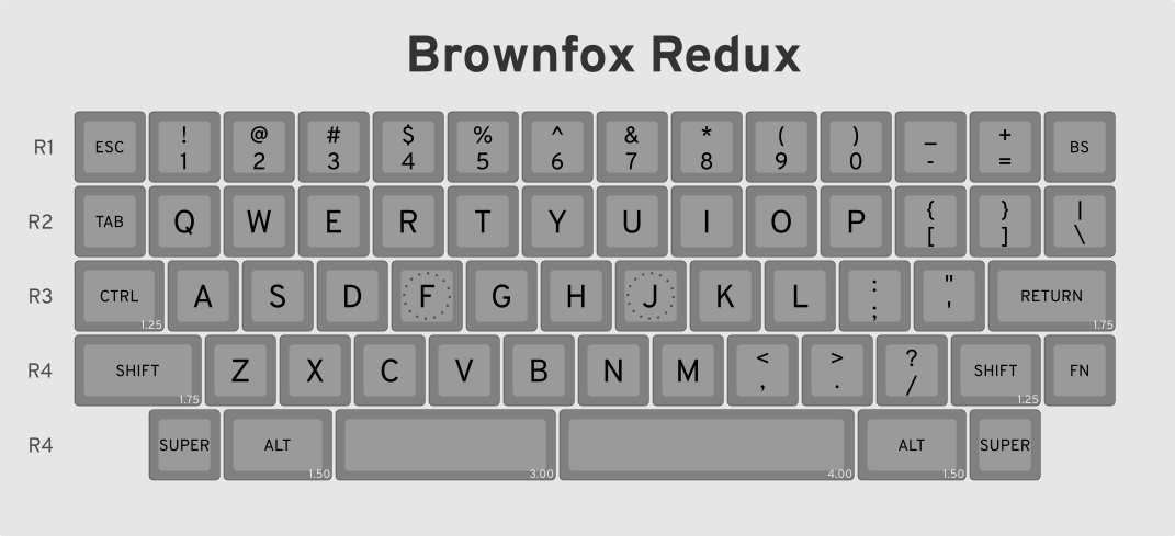

Natural evolution would be
which is dramatically close to my very first custom (the brownfox) just without arrow cluster
