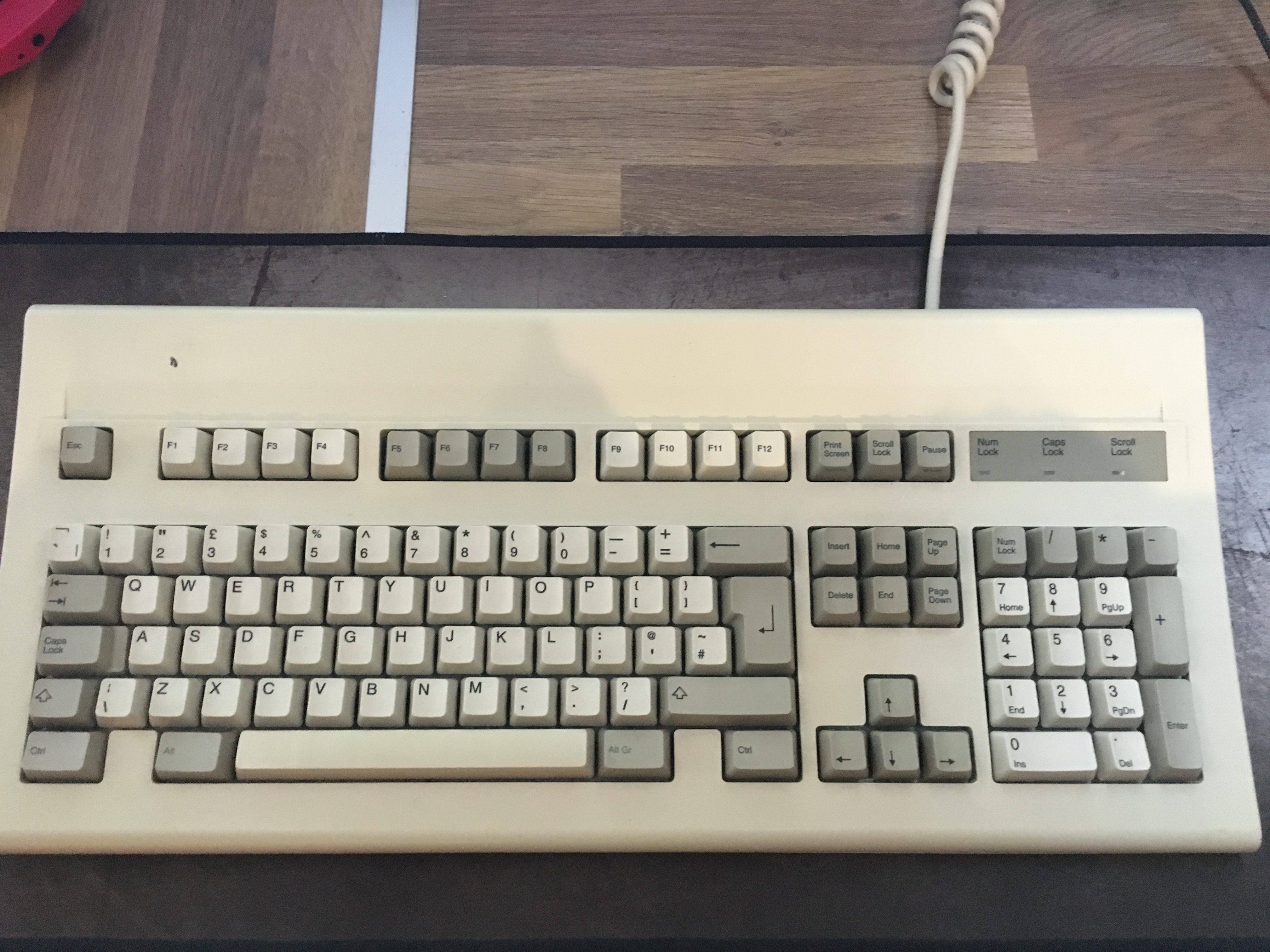

hey guys,
i recently bought this unknown cream alps keyboard (maybe dampened creams, idk really) from tentator (huge thanks to you!!)
it blew me away. never had any keyboard with vintage alps. the prestine mint condition, the absolutely beautiful sound and crisp typing feel. i immediately fell in love.
(apple font on led cover?)
so heres the problem: i cant figure out how to get this thing to work. theres no brand, no useful serialnumbers. and the more i try to figure out what it is, the more weird it gets (atleast for me).
12V 150mA?
it has two ps2 inputs, one on each side. both of them with a keyboard symbol (i guess its that).
so my young innocent heart believed i could get it to work only by connecting it via the proper cable.
(tried both sides)
cable fits in perfectly - good thing! started my machine (i should mention its a modern windows pc, but with native ps2 input), keyboard starts to beep (it has some kind of inbuild speaker), lights flashing and that was it.
lights stuck in a weird order, beep is gone. no signals will be transmitted to my computer. it will do that on every reboot of the machine.
i figured maybe its the wrong protocol and i opened her up. maybe im lucky and i could find some kind of switch or jumper. nothing.
controller is a philips 80c51bh-3, tried to find some useful infos but turns out these things can process a lot of stuff so idk.
i dont have any ideas and as you can see im really a newbie in terms of this stuff.
if you have any ideas please let me know. thank you so much in advance.

The keyboard uses SKCM Ivory switches, SKCM Cream are not dampened.
The p/n is oddly similar to the ones present on the SGI Bigfoot series, as seen here : wiki/SGI_Bigfoot_series which is why I'll take a wild guess, and say that it uses the SGI protocol, which is why it doesn't work on your computer

thats the info i needed i guess! pretty sure its one of them. any chance to adapt it easily?

Okay, that's not a ps/2 keyboard.
See that SGI copyright? That means its an SGI protocol, which means…
You're screwed unless you can find the documentation on the protocol and program your own converter.

One of BlindAssassin's AT101 PCBs might work for this.

You could also figure out the keyboard matrix with multimeter, make firmware for the matrix and then hook it up to a Teensy++ 2.0 (or any similar controller with enough I/O for full keyboard sized matrix) .

The SGI connector (unverified) is in kbdbabel: consistent in being a mini-DIN-6, needing 12V, and having a pass-through for the mouse (hence the two ports on the keyboard).
drakware sells a converter in the other direction, so the protocol is probably known (if it isn't just RS-232, say). See also here.
