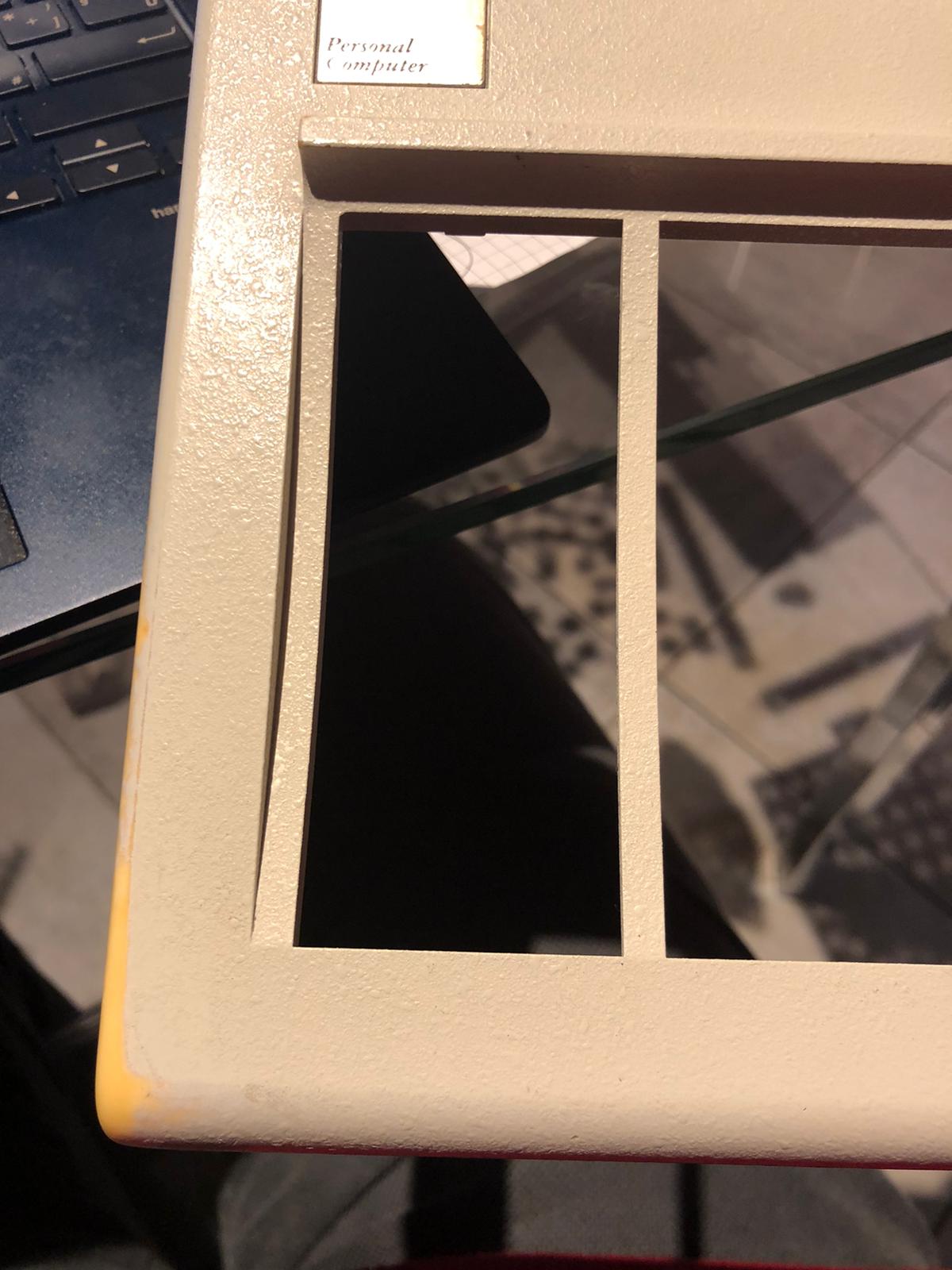

So, I recently got my hands on an IBM 3278, along with some pristine Selectric I blue keycaps (ended up proxying the whole typewriter from Canada since I saw a horror story on here about the seller damaging the caps while removing them for shipping).
Works like a champ, but sadly the paint on the case is chipped, and the off-white doesn't really match the black/blue color scheme of the keycaps (imo, although it kinda feels sacrilegious even considering it).
As such, anyone have any experience repainting a beamspring case? I was thinking about taking it to a shop to sandblast/powder coat it, but since the wrist rest/manual door is plastic it would have to be painted separately, which would likely cause a color mismatch (although two-tone for the case might not be too bad).
Also, the little plastic retention piece that keeps the wrist rest in place is broken and only the top portion is left which is currently taped on. This means that any time pressure is put on the bottom of the wrist rest, the door pops open, which is quite annoying. I was thinking about 3D printing a new one, but sadly I don't have the whole piece to measure/model it. Anyone have this issue before by any chance?

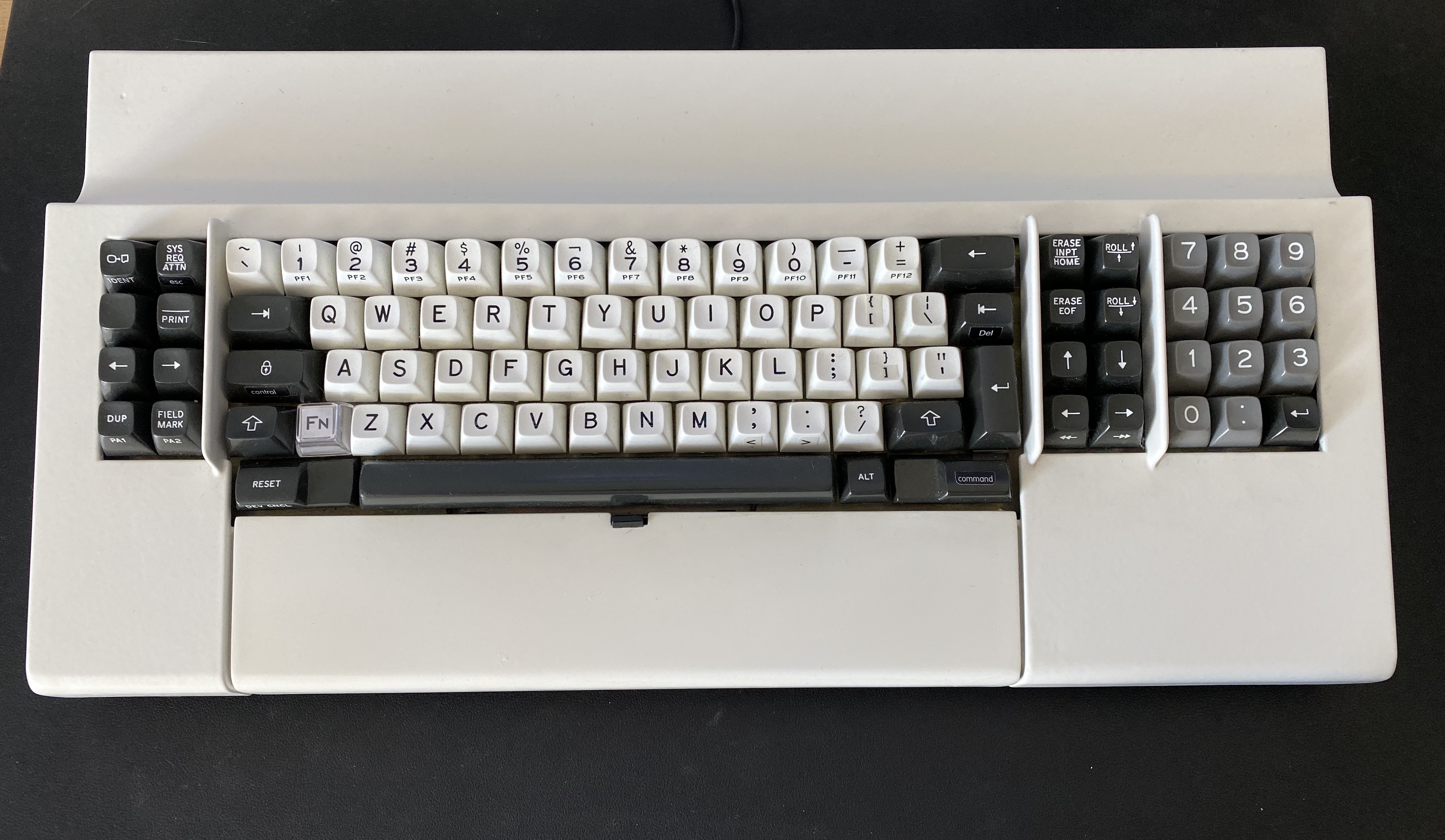

Hi, I did both - I painted it with different colors and primers but finally went for powder coating. You wouldn't believe how quickly paint is fading / stripped off the case, when you use it daily (like me).
The powder coating I have on it since some time is a dream:

Just curious darkcruix how did you get the relegendable keycap for the Function key? Looks really good though nice Beamspring.
darkcruix
15 Oct 2019, 14:29
It is an MX mount key from Signature Plastic :)

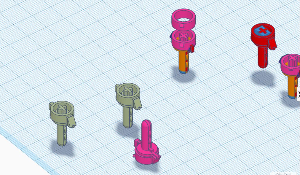

darkcruix wrote: 15 Oct 2019, 14:29 It is an MX mount key from Signature Plastic :)
Hi Darkcruix, why do you not use more of the MX mounts? I thought I remember you having many more MX keys on your beamspring

How can one get something like MX mount to work on a beamspring stem?
SneakyRobb
THINK
15 Oct 2019, 16:19
Hi,
I need to update my 3d models as I am still learning FreeCad, but you basically can just print/mold a new stem out of plastic/resin.
Then insert it into the slider part.
darkcruix
15 Oct 2019, 17:28
And I can tell - it works great

darkcruix wrote: 15 Oct 2019, 13:36 Hi, I did both - I painted it with different colors and primers but finally went for powder coating. You wouldn't believe how quickly paint is fading / stripped off the case, when you use it daily (like me).
Gotcha, thanks for the info! Fantastic looking board btw.
I'm curious: was the wrist rest also painted, or was the powder coat color chosen to match the original color? I thought only metal parts could be powder coated due to the heating involved for curing.
