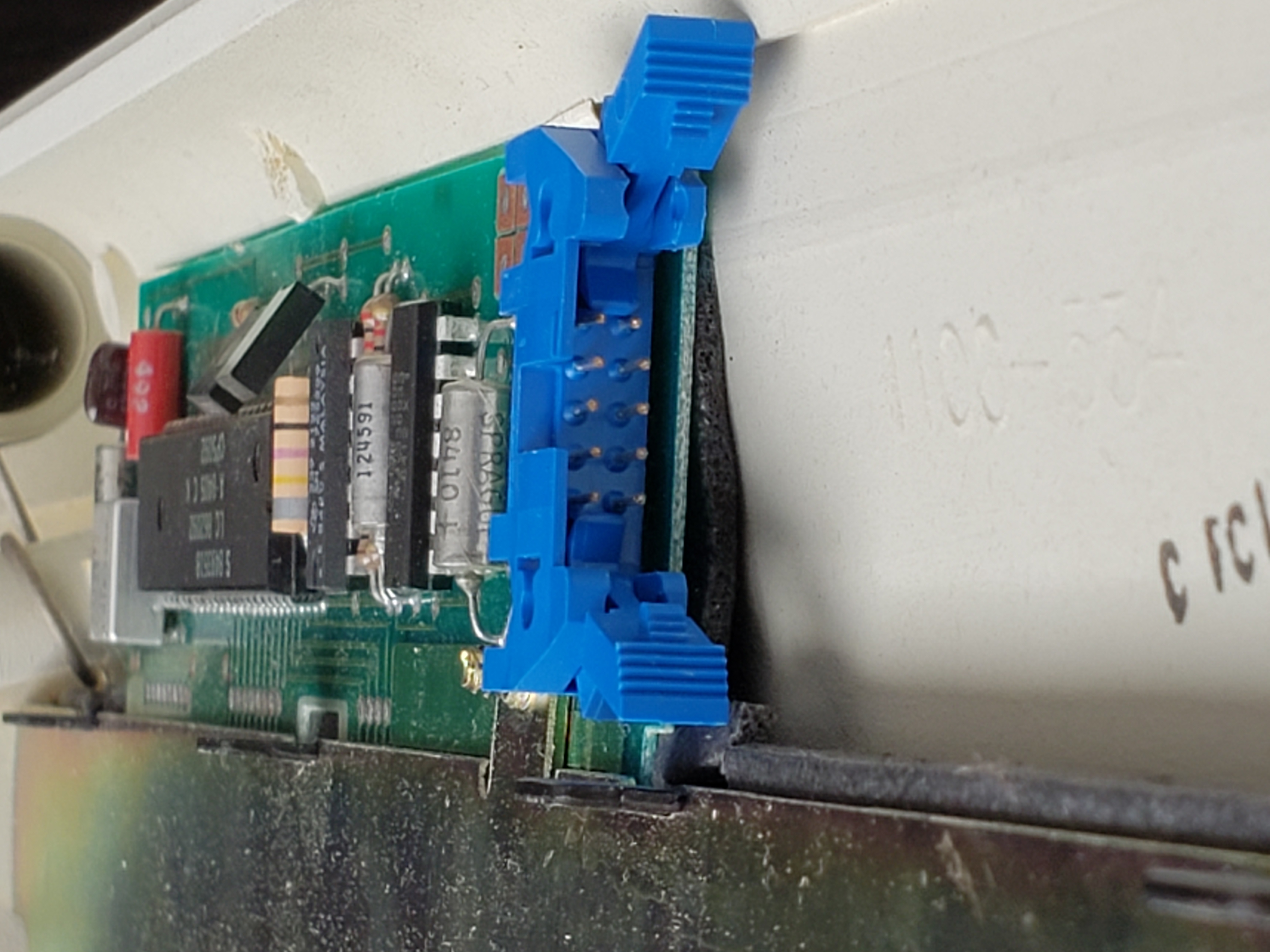

I recently purchased an IBM Model F XT on eBay without a working cable. I'm attempting a Soarer's XT to USB conversion but I'm unable to find any pinouts for this 10-pin connector on the board's controller.
Can anybody help me sort out which of these 10 pins correspond with Vcc, Ground, Data, and Clock?
Much thanks!

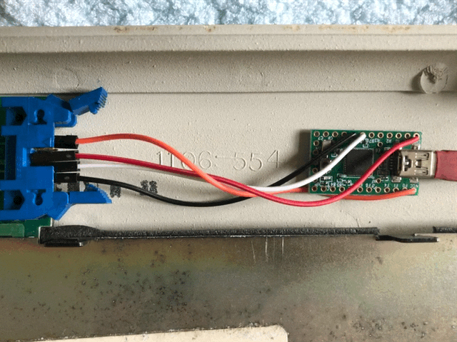

here is a photo which shows wiring to a teensy2.0
from top to bottom, only 1, 3, 4 and 5 are used and they belongs to the lower row of pin on the blue socket.
hope this help.
hope this help.
- IMG_9130.jpg (330.5 KiB) Viewed 1924 times

Thank you for the quick response and helpful picture! That was the last bit of information that I needed to get my Soarer's converter up and runninganthonymak wrote: 20 Jan 2020, 04:18 here is a photo which shows wiring to a teensy2.0
