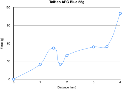

Well, in the absence of any info forthcoming I went ahead and did some crude investigations myself. I was able to measure the force for actuation and complete depression, as well as approximate distances for those two. The other points in the graph are "experimented subjective impressions".
This is no substitute for an actual force measurement but at least gives the main idea: 52g click near the top, a pronounced dropoff and quick recovery, then gradually to 55g close to bottom. Light with pronounced tactility, most similar in overall form to Matias switches, which I guess isn't surprising since they are both simplified Alps mechanism.
Anyway, not complex Alps, but worlds different from Cherry. I hope these switches (and the Fuhao/Fukka) will get some more interest and keyboard models so they and their keycaps don't die out.
