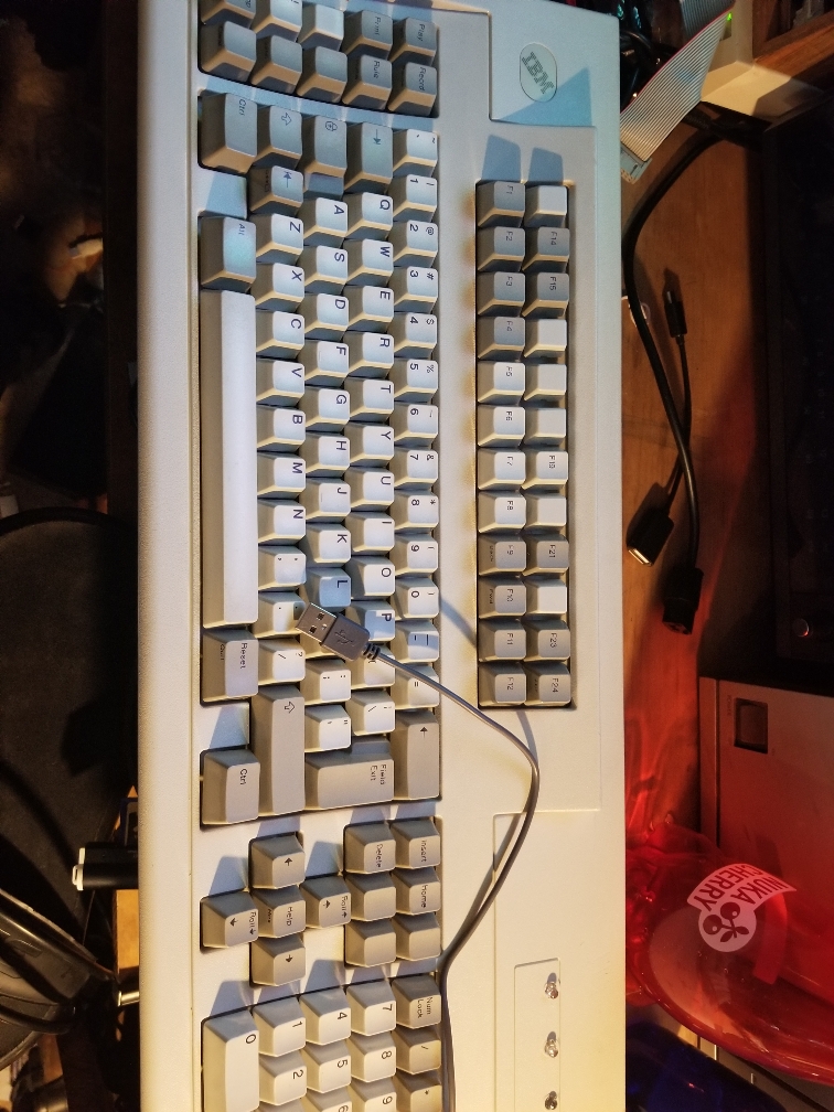

Salutations. I put the "Decision Data Clone", aside once I got ahold of this IBM Model M. It was filthy but it is almost completely restored and set to USB output..
When I plug it in 2 lock lights come on briefly then turn off. I must've made a soldering fault on the third. The system recognizes the keyboard, as does HID listen.
When I use HIDlisten. Every key gives an output of "R05"
There was a note to pull the pin on the controller board. Unfortunately I am hard pressed to find one
Is there something I am missing?
- tapatalk_-403949364.jpeg (538.14 KiB) Viewed 7118 times

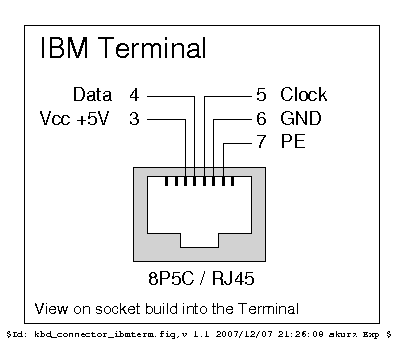

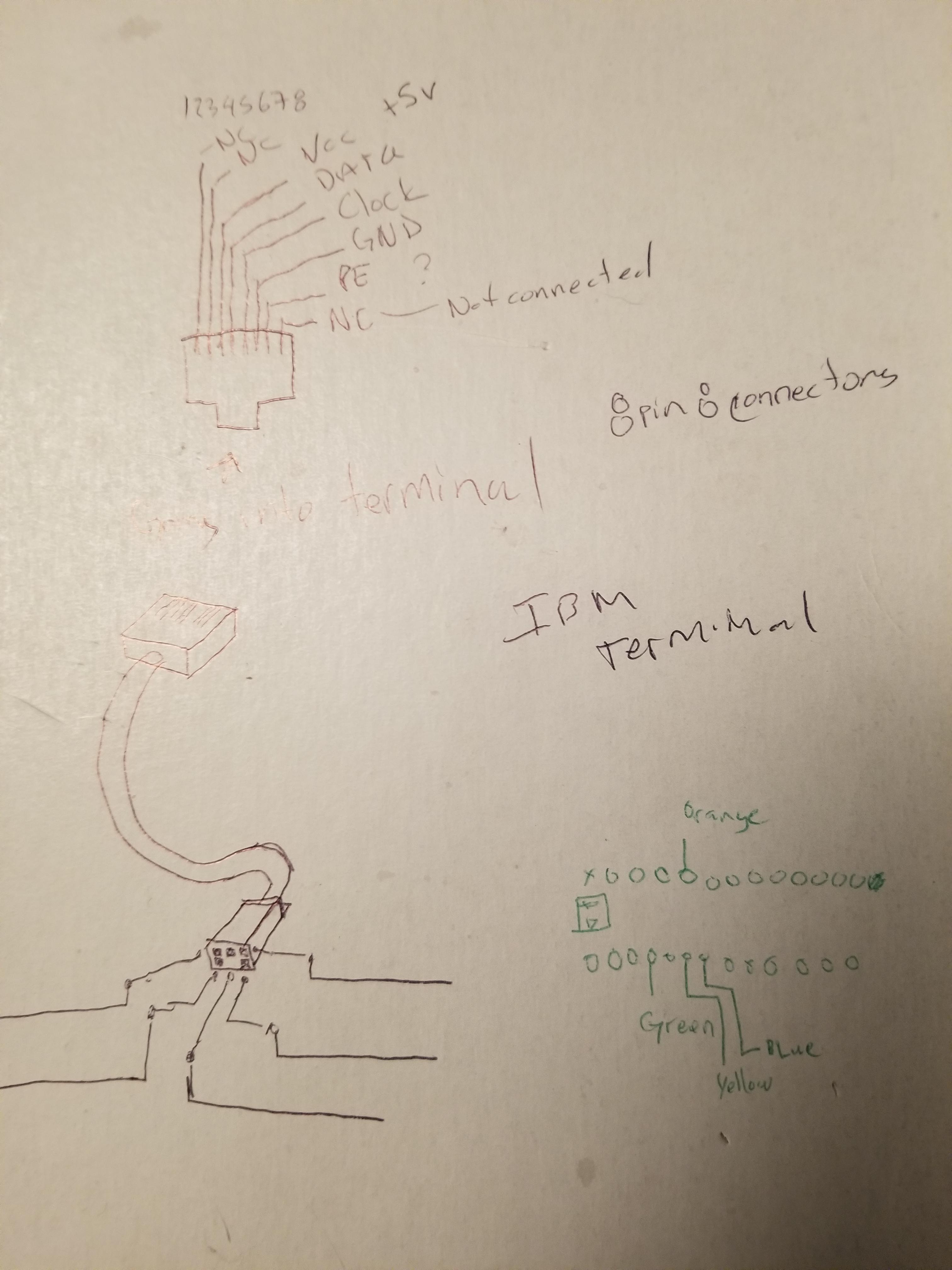

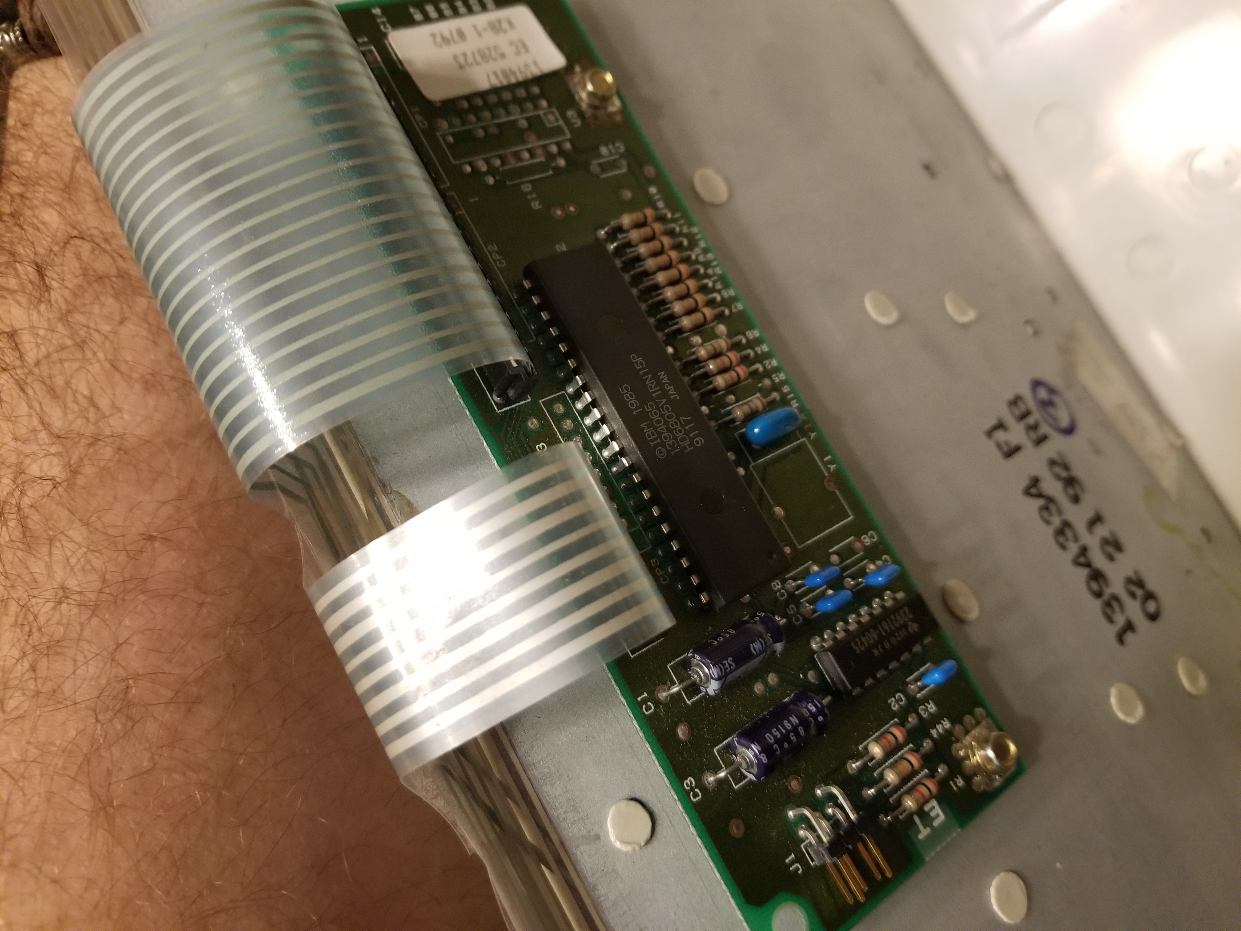

Here is the controller board. It has 5 pins but only 4 connectors ( my assumption is GND VCC DATA and CLK ) following the same pinouts of IBM Terminal. The Reset pin is not connected on the 32U4 pro micro to the keyboard ... is the unconnected pin where RST goes?
- 15802657634123523719356258325909.jpg (3.32 MiB) Viewed 7110 times

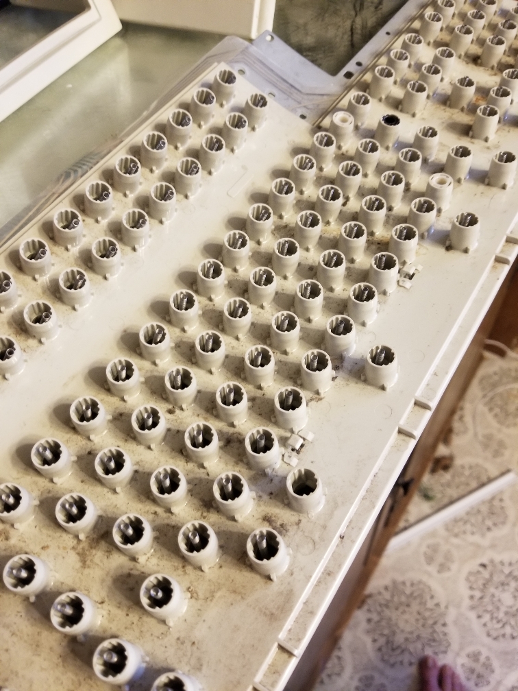

In truth... I'm good.. I really like the springs. The additional keys are what I'm after. The feel of the board is still better than those made nowadays. Here are the other pics that didn't upload.
- tapatalk_2012069717.jpeg (668.99 KiB) Viewed 7092 times
- tapatalk_-1267588079.jpeg (126.12 KiB) Viewed 7092 times
- tapatalk_-966216639.jpeg (531.5 KiB) Viewed 7092 times

So .. based on your reply.. happen to know what is causing the same code to be repeated? Or what the PE pin is? Any help would be greatly appreciated.
Am I asking in the wrong place?
Thanks in advance!
Thanks in advance!
- kbd_connector_ibmterm.png (5.41 KiB) Viewed 7055 times

I think you don't need to do anything with that pin, but I'm not very well-versed in that sort of thing -- definitely take that as caution.Mehridian wrote: 29 Jan 2020, 05:20 So .. based on your reply.. happen to know what is causing the same code to be repeated? Or what the PE pin is? Any help would be greatly appreciated.
Thanks in advance!
Isn't there a how-to to make a Terminal converter already? There should be. Search for a Soarer's converter. Perhaps that might just help you.
You're definitely in the right place! There's a lot of knowledgeable people here that will help you, and hopefully they will in this case.
kmnov2017
- Main keyboard: Model F77
- Main mouse: Logitech MX Master 3S
- Favorite switch: Alpaca V2
You need only the 4 pins to work. The reset PIN is not required. The PE pin can be ignored. Double check all your connections and make sure that there is no short between any of the cables.
If the problem persists, just for the sake of trying, remove the lock LEDs and try again.
If the problem still persists, there may be a grounding issue. This can be fixed by running an independent cable connected to the metal part of the keyboard and other end connected to the GND on the promicro.

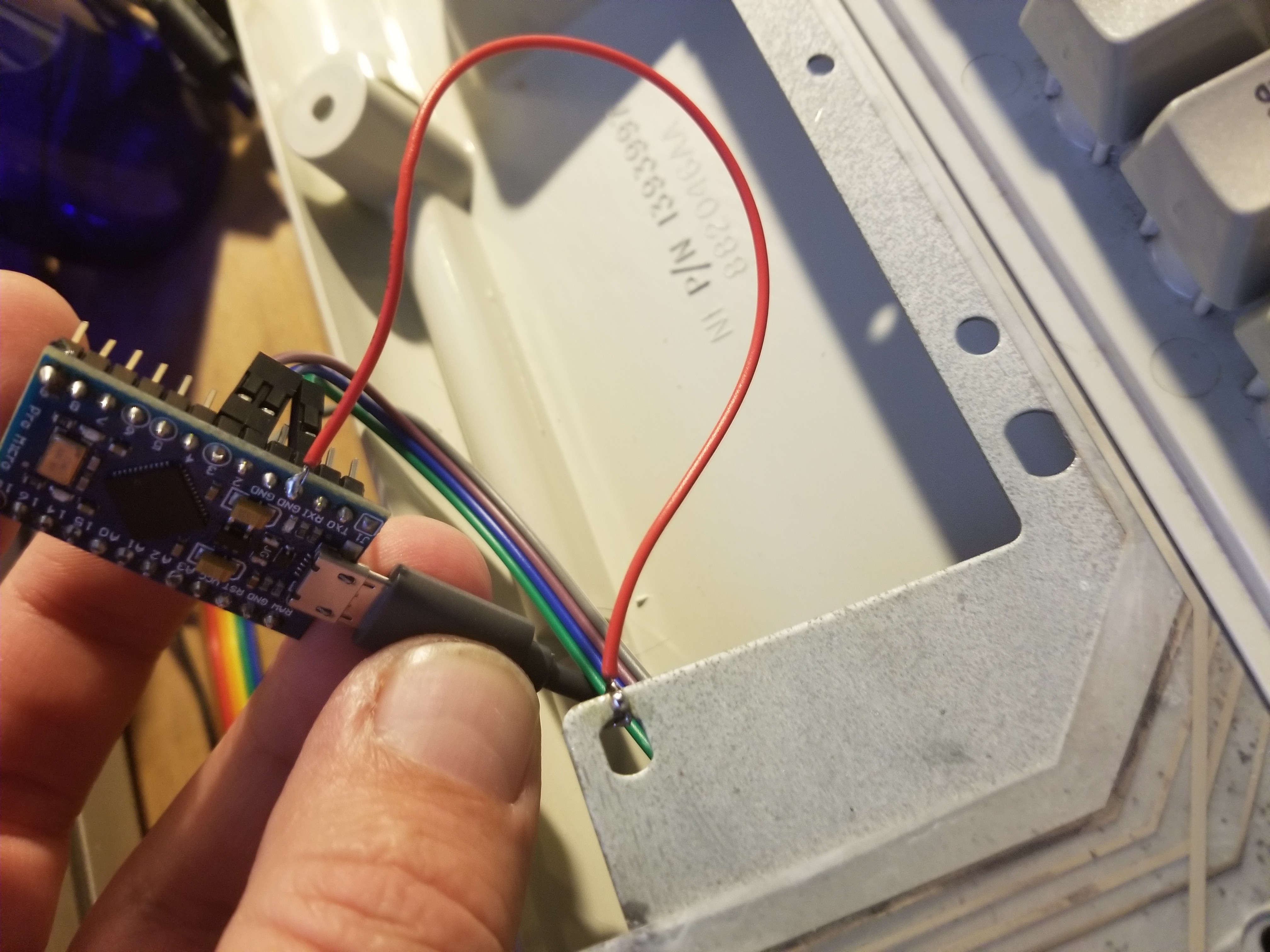

Step 1. Checked all wires for Connectivity
*no change*
Step 2. Removed LEDs From circuit
Code Following from HIDListen
Looks like the wrong Code Set. I find it hard to believe the Keyboard ID is really 0000. Damn more work to do ...
Step 3. adding grounding wire to Metal backplane and grounding through 32u4
thanks @kmnov2017
*no change*

kmnov2017 wrote: 29 Jan 2020, 11:17 You need only the 4 pins to work. The reset PIN is not required. The PE pin can be ignored. Double check all your connections and make sure that there is no short between any of the cables.
[/quote
Well least I got the same response ...
Even with the ground
- 15803074703978292200515297343550.jpg (3.16 MiB) Viewed 6943 times

Connect a different keyboard. Take any old PS2 keyboard and wire up the ProMicro to check if the ProMicro is at fault. If the other keyboard works, the controller on your Model M is dead. One of my model Fs (not M) had a similar problem, turned out the orignal controller was dead. I didn't have time to diagnose each of the component one by one, so junked the original controller and replaced it (this is still WIP).

Judging from pictures, this is originally terminal version with RJ45 connector? I have converted couple of those using just very cheap RJ45 to DB9 connectors. Plenty of cheap options around, for example:
https://www.aliexpress.com/item/3284150 ... 4c4dyzpOl5
I connect the RJ45 wires to Teensy according to the picture you posted earlier in the thread. Teensy even fits inside the case. Easy, cheap and non-destructive modding. And it preserves the original IBM cable.

So I came back to inform that I am pulling good data from the board at this point.
I went back and resoldered all the connections. Plugged it in ... turned on HIDListen.... presto!
Thanks to all for your help. I am glad I shave my head... I woulda pulled out hair!!
