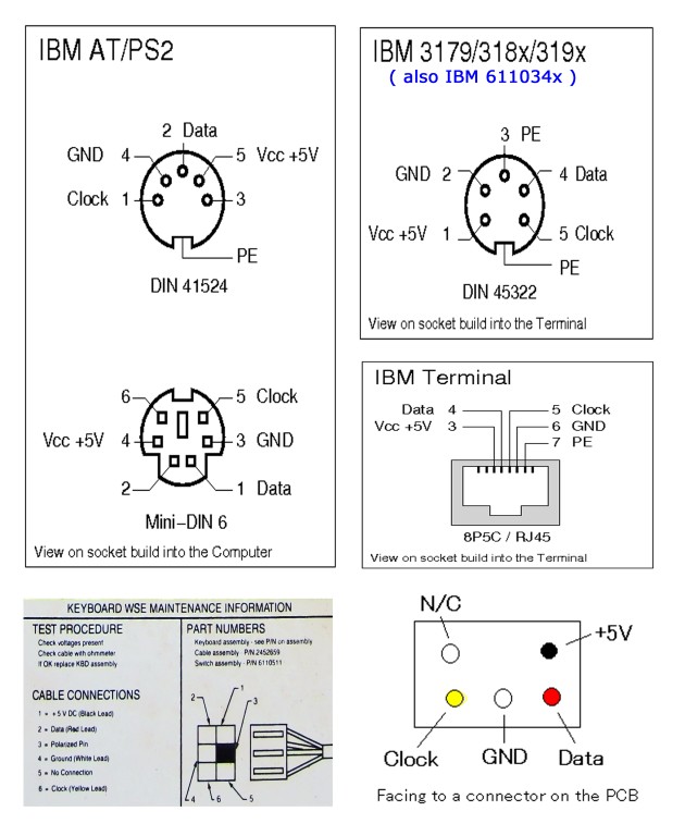

A year old thread I know but I'm after something similar, albeit simpler. I have an IBM InfoWindow terminal with the RJ45 connector but I have no keyboard for it, and replacement IBM keyboards are more expensive than I want to risk not knowing if the terminal works properly!
Can I just wire up a normal PS/2 keyboard to the RJ45 port and get it mostly working, even with the scancode 2 vs 3 thing?
Found this to give me the wiring?

I don't think you can do that. Precisely because of the scan code thing that you mentioned. When you plug an RJ45 terminal Model M into Soarers, the converter reports it running the other scan code mode. It's a different protocol to standard AT / "PS/2" (which are identical).
Now, what you could do, if your "normal pc keyboard" happened to be a regular Model M, is swap out its controller for a Terminal Model M controller. I might even have one spare myself. Certainly I remember some people pulling them out for USB controller swaps around here in the past; even a Terminal SSK. But only works on a Model M.
