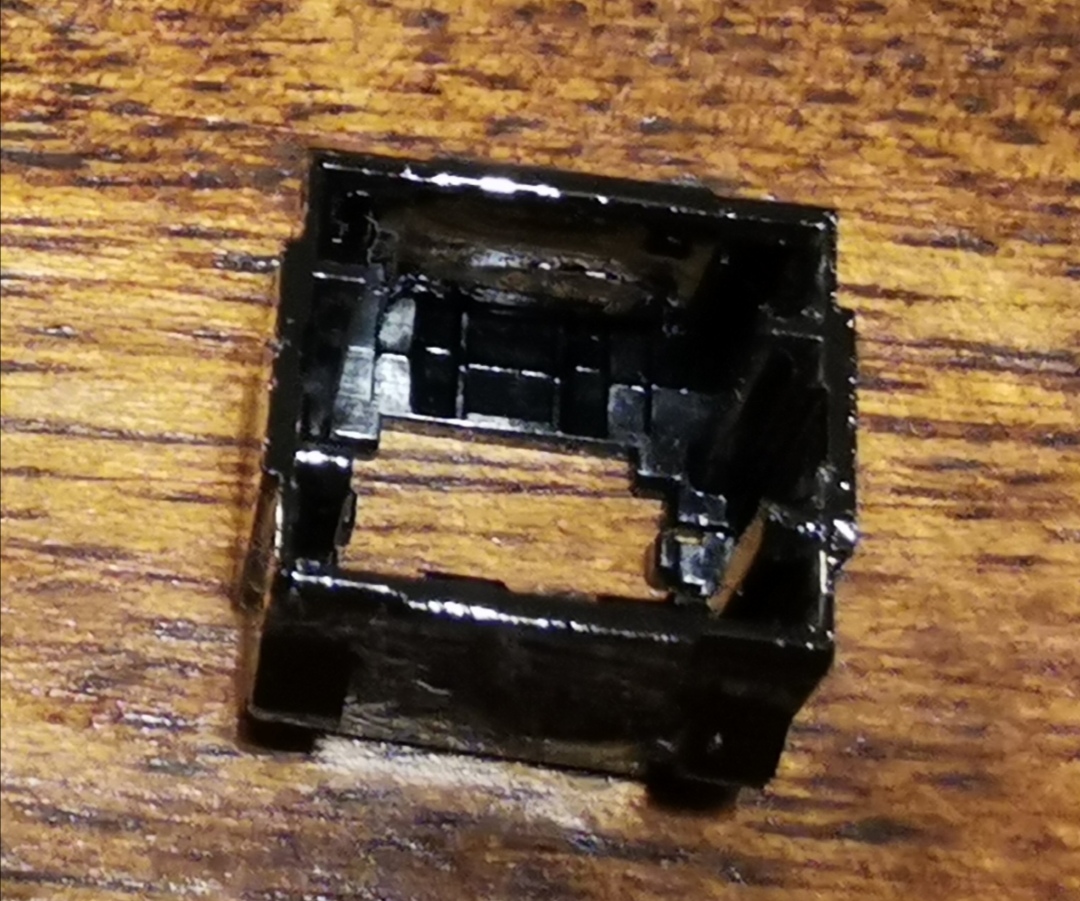

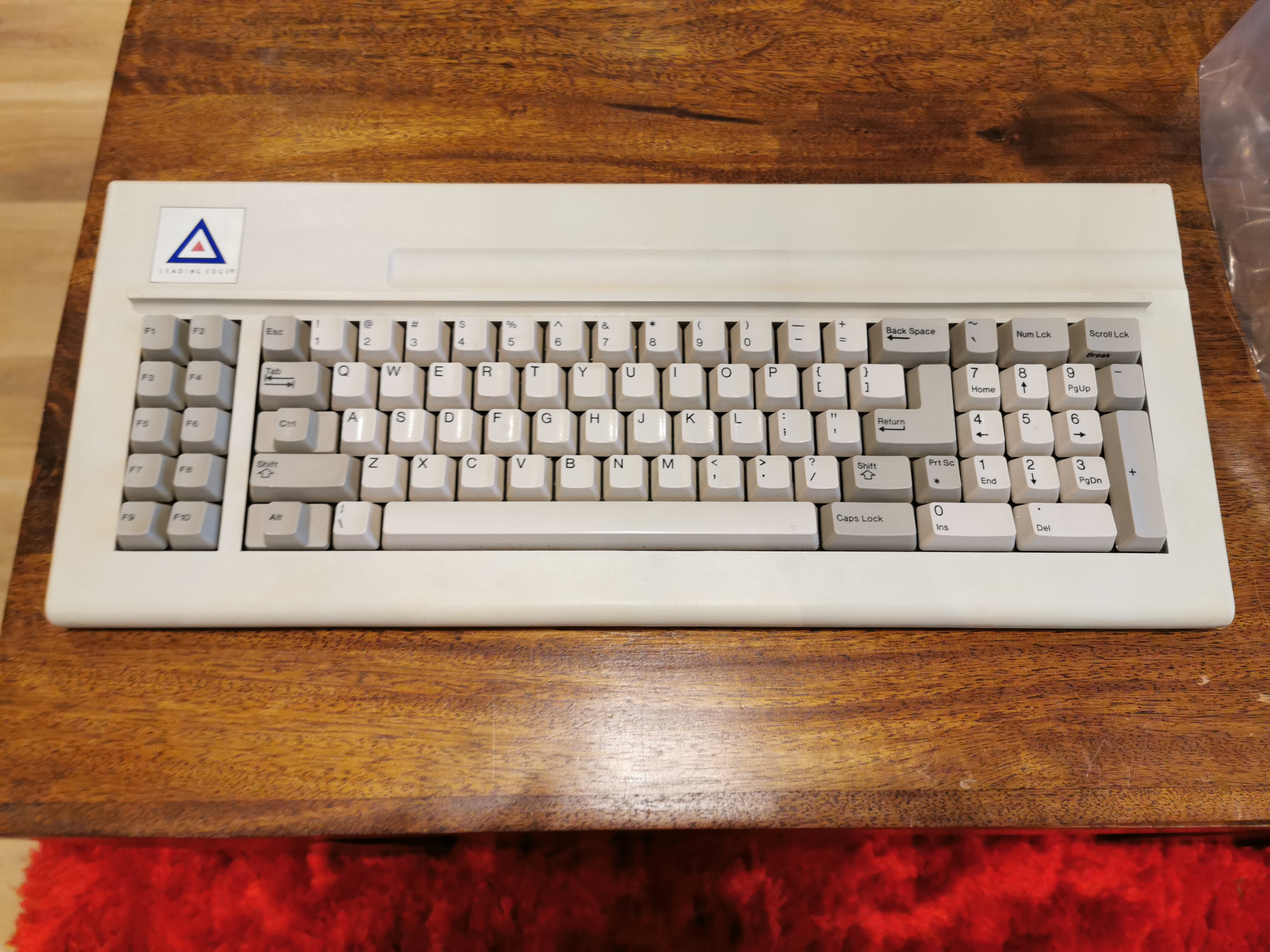

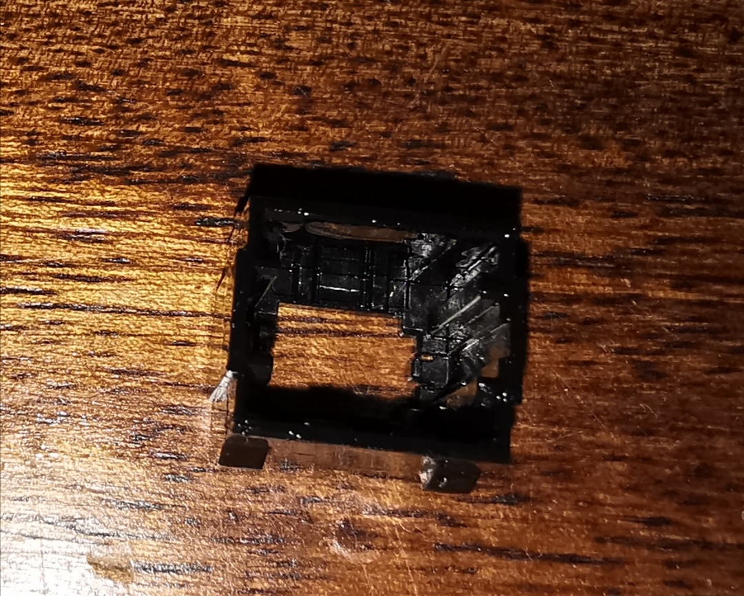

Do today I finally my Leading Edge DC-2014 got delivered. When disassembling I noticed there was an oily liquid inside the keyboard case.
Upon further inspection some of the switches have so much lube oozing out of the switches and just wanted to ask is that normal in the factory production.
Below are some images showing what I mean. This is my first blue ALPS keyboard so just wanted to get some feedback on this as I am really just not sure.
Any help thanks.
Any help thanks.

No, that is not normal at all. Where or who did you buy this from?
This almost looks like it was done by someone who was unfamiliar with Alps (a newbie to the hobby, or someone who has no experience with the switch) in an attempt to lubricate the switches. Alps Electric did not use a wet lubricant for their sliders.
I find it highly unlikely this was anything other than a deliberate attempt at lubrication that they went overboard with. Unfortunate.

Does it look like something was spilled into the keyboard at all? Are the keys also oily? Anything obvious?
Good luck. I'd use 99% isopropyl alcohol if you have any. It should get rid of it, maybe a degreaser like Simple Green could help as well if you don't have 99%.

Yes keys and case are oily and all the rubber feet are brittle...

Luckily not all the switches have oil in them only about 4. And those 4 have so much oil inside them that the click leaves cannot move to click at all.

If you don't plan on desoldering, then I would use 99% isopropyl alcohol and scrub it down real well, maybe with a toothbrush or similar tool. If you do desolder, a degreaser like Simple Green should work well, or a strong liquid detergent.
An ultrasonic cleaner would clean them up well if you're going to desolder.

I would generally agree, but in this case there seems to be so much grease... looks like they may have to desolder switches to clean the lower housings and switchplates.
Alcohol would work for the removed top, but it looks like the bottom of the switch will still have goo sloshing around in it, and I'm not sure how Fkazim can remove the stuff from the bottom without desolder, then wash. He also says the goo is on the keycaps and the case, so the entire thing may need to be disassembled and de-oiled.
Like there might be grease just floating around behind the switchplate that can't be removed otherwise.
If that is the case, the amount of work jumps up a lot. It does seem like it would be possible to totally restore it though.

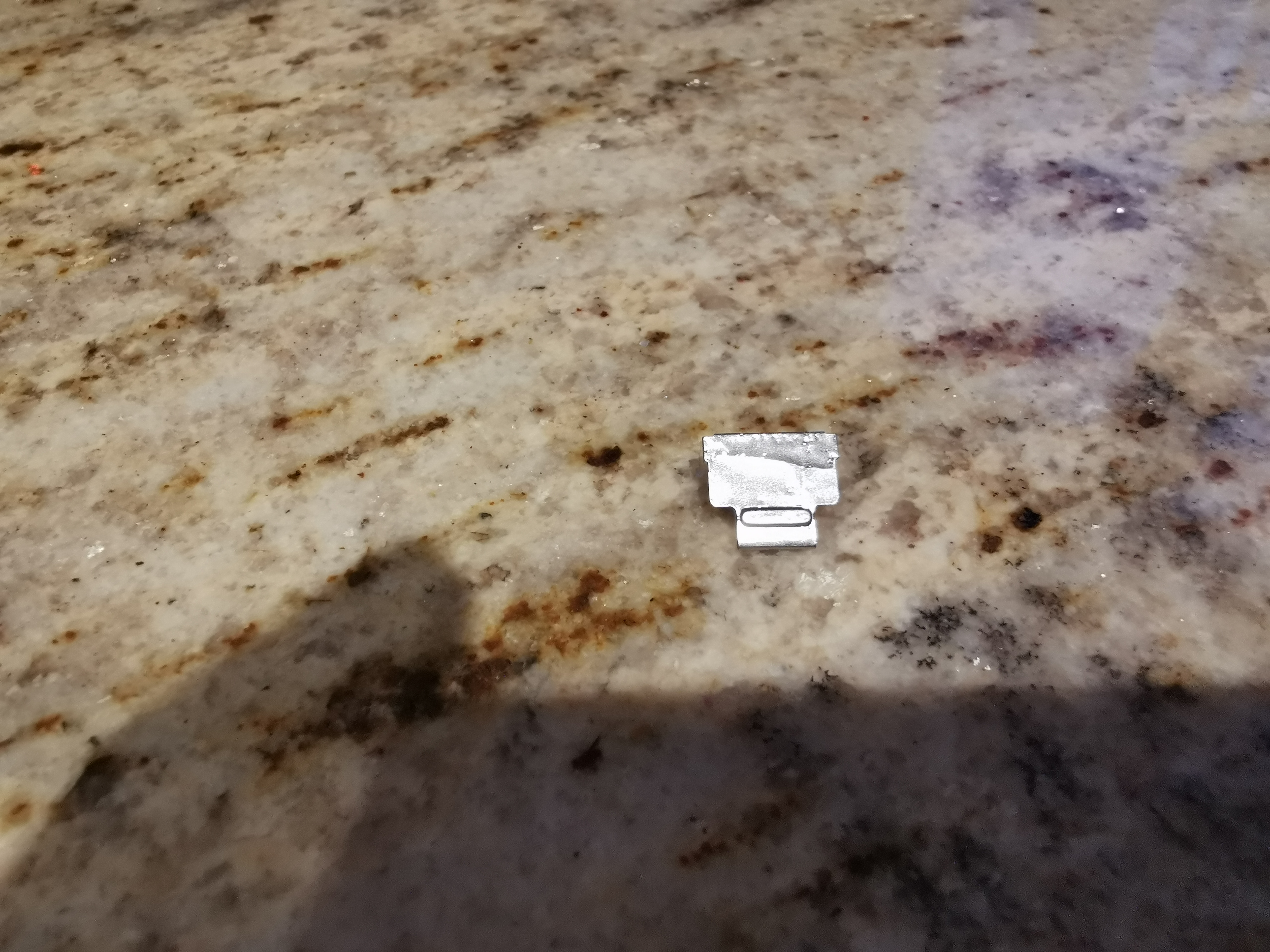

Even the click leaves were stuck to the switch housing because of the oil. IPA is working great for removing the oil thanks for letting me know about that trick guys.
