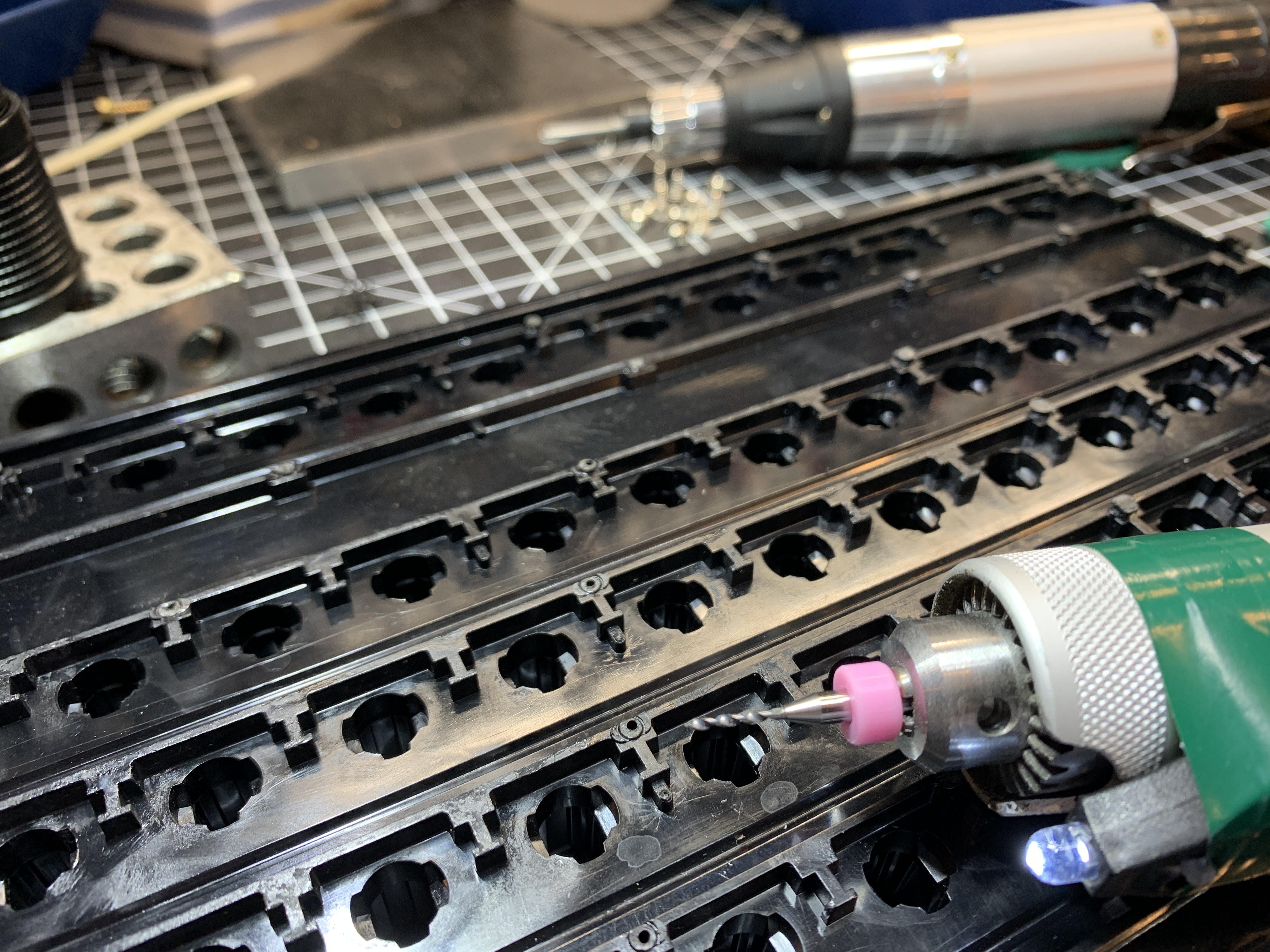

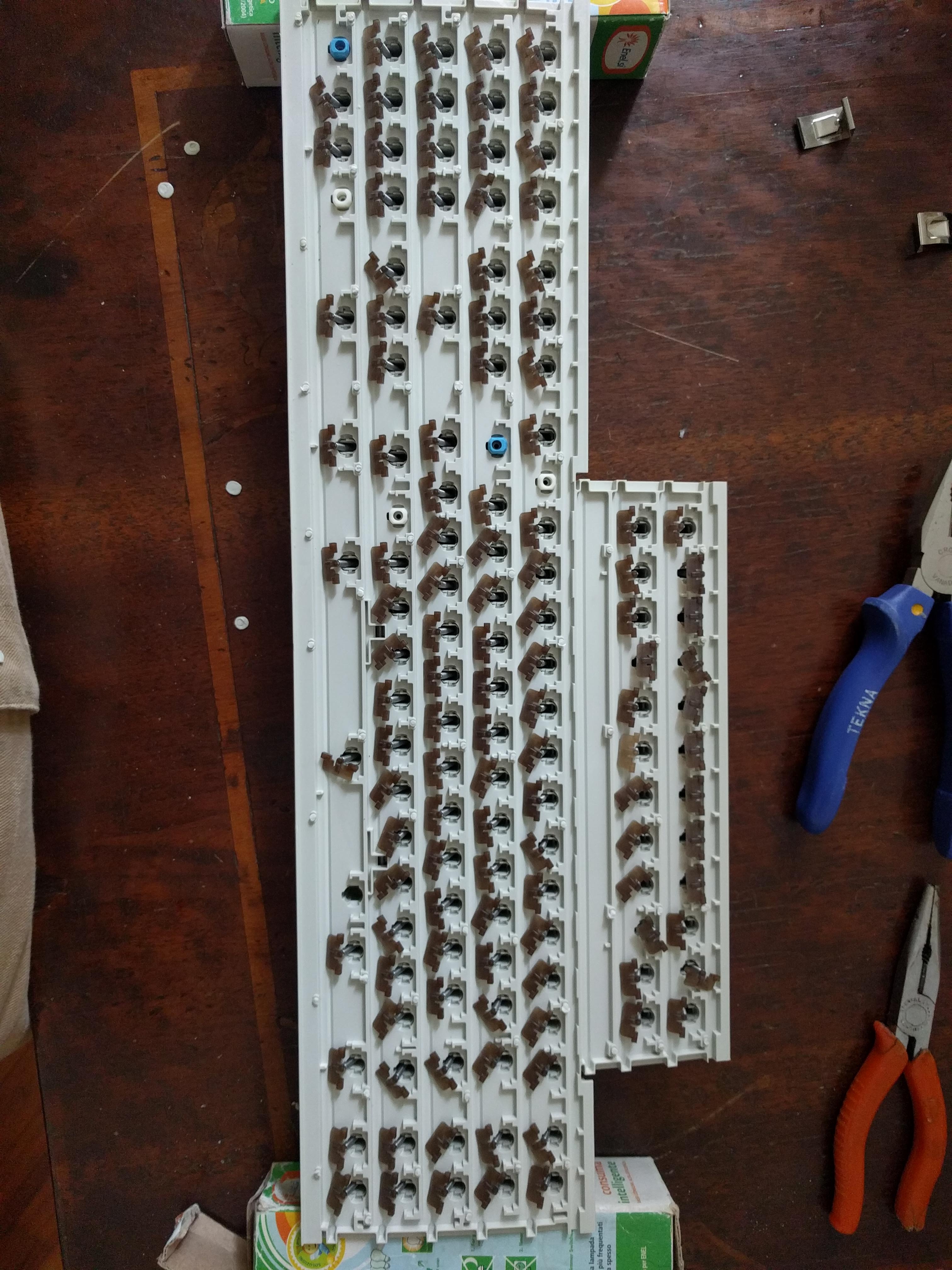

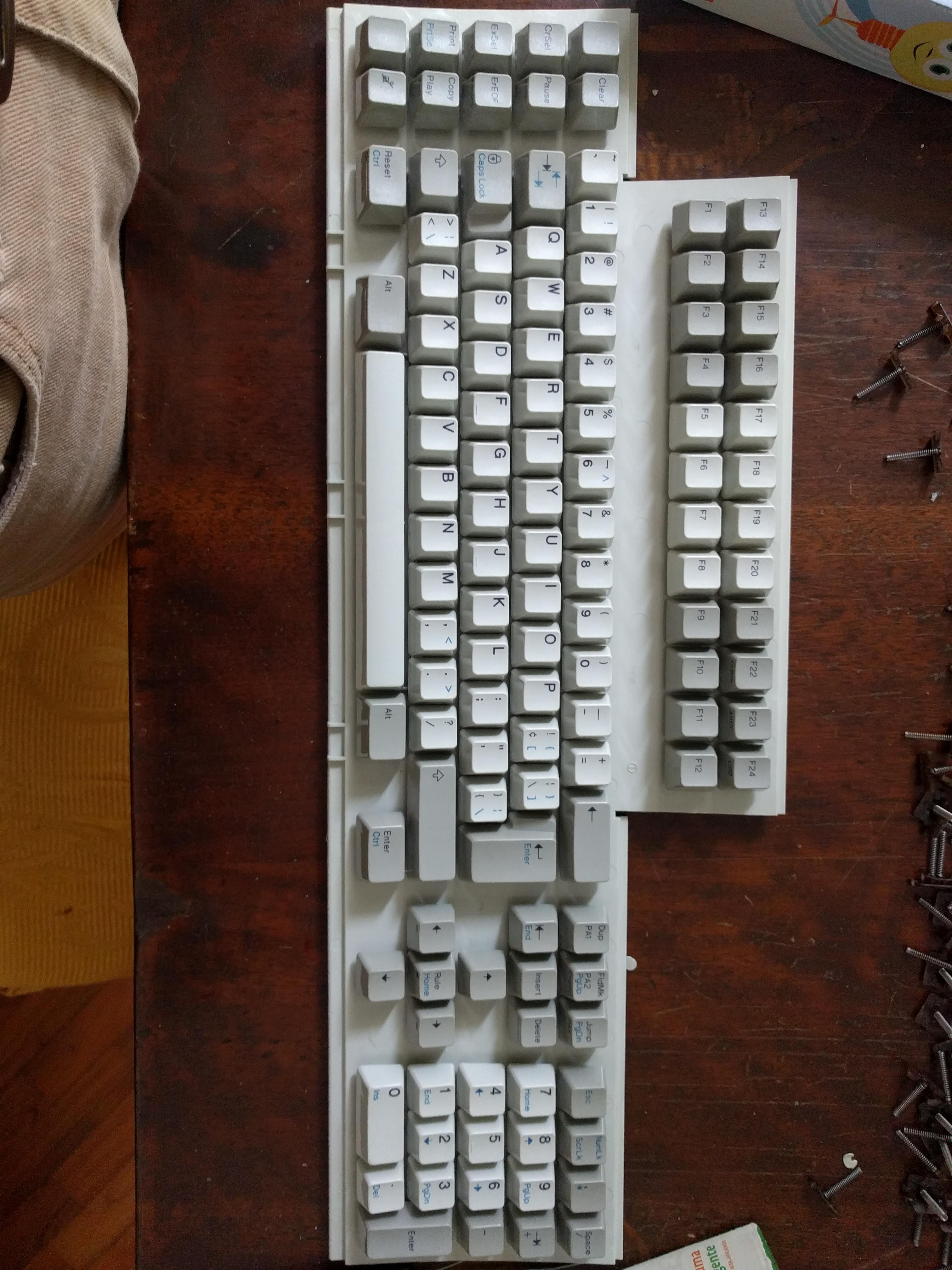

Hi Tritian, I can confirm that the screw mod is far easier than the bolt mod that's a very pain in the ass. I practised both of them and I can assure you that the bolt mod performed on an old IBM model m terminal no LEDs, also involved a ladder so that the keyboard didn't touch any surface during the process of plate fastening. A real nightmare. On the other hand, the screw mod, made with little m2 wood screws has been quite easy, even though I opened the keyboard plates in order to make sure any plastic pieces from broken rivets didn't fall off underneath spring hammers or caused any kind of hindrance in key mechanism. As you can see from the pictures taken before the operations, I made use of a Dremel with a drilling tip of 2 mm making almost as many holes as rivets there were on the back plate. I preferred making them straight on plastic without using the back plate as mask. If you block the keyboard plates with some vices before cutting old rivets out, I think you might get the job done with less effort, I suppose, but it could prove to be asurgical work. How much were you good at little surgeon when child?

Interesting, I didn't think about having little pieces of plastic rattling around within the mechanism after I was done. How much of an issue is that? Should I not consider a partial screw mod, since I then couldn't seperate the mechanism and ensure there is no plastic debris blocking flippers?

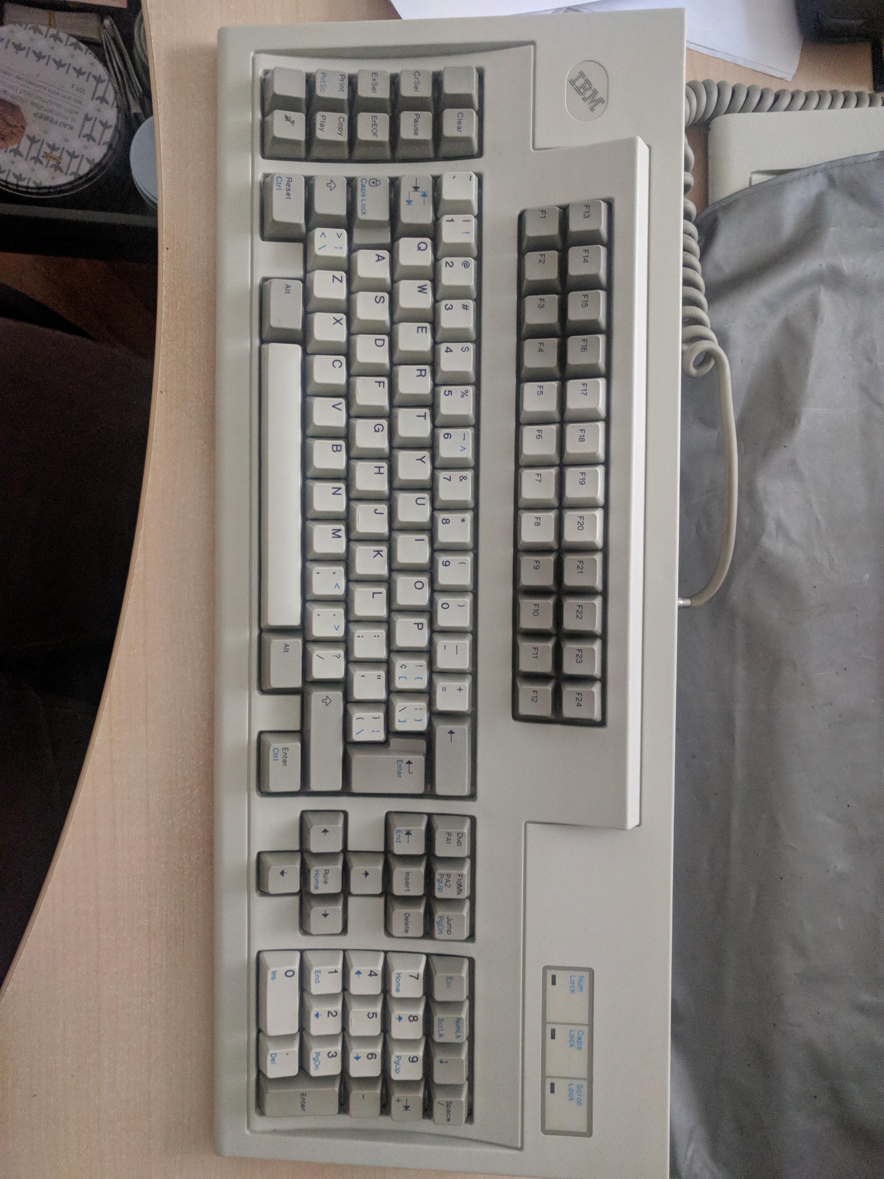

That's a lovely M122 you have. Did you add those lock lights custom? I havent seen any M122's with lock lights, except the newer Unicomp ones.

Thanks for linking to our old ClickyKeyboards video. I normally do hundreds of model M restorations every year and I would not describe the work as “fast”.
When I was in graduate school (neuroscience) in the 1990s, one of the research rotations was in neuroanatomy and neurosurgery and I worked with surgeons and surgical drills and micro drill bits and learned how to do precision work. Adapting the lessons learned has helped decades later with model M keyboard restorations.
As long as one is precise with making the right holes and not rushing and uses the right tools, parts, and clean techniques then it all results in a good and clean outcome.
It takes some practice to “do no harm” and not crack the plastic barrel plate or to incorrectly “miss” and make a mess of debris.

Tritian wrote: 07 Mar 2020, 12:14 Interesting, I didn't think about having little pieces of plastic rattling around within the mechanism after I was done. How much of an issue is that? Should I not consider a partial screw mod, since I then couldn't seperate the mechanism and ensure there is no plastic debris blocking flippers?
It's not common to face plastic debris issues with model Ms but I think they might occur according to keyboard conditions. Anyway, working with plates still fastened together i don't think it's the best, unless you are Mr ClickyKeyboard (@E. - Even if reading your notes about neuroscience made me shiver a little bit. It was not pleasing reading of a drill and surgeon in the same period).
My Model M122 is a particular one. It's an IBM model M 1397000. If you want to deep, more info here: http://www.seasip.info/VintagePC/ibm_1397000.html
As far as I know it s the only 122 that doesn't need a soarer's conveter to work with modern pcs. It's a ps/2. Have a look to keys layout.... try searching for the ESC key.....
