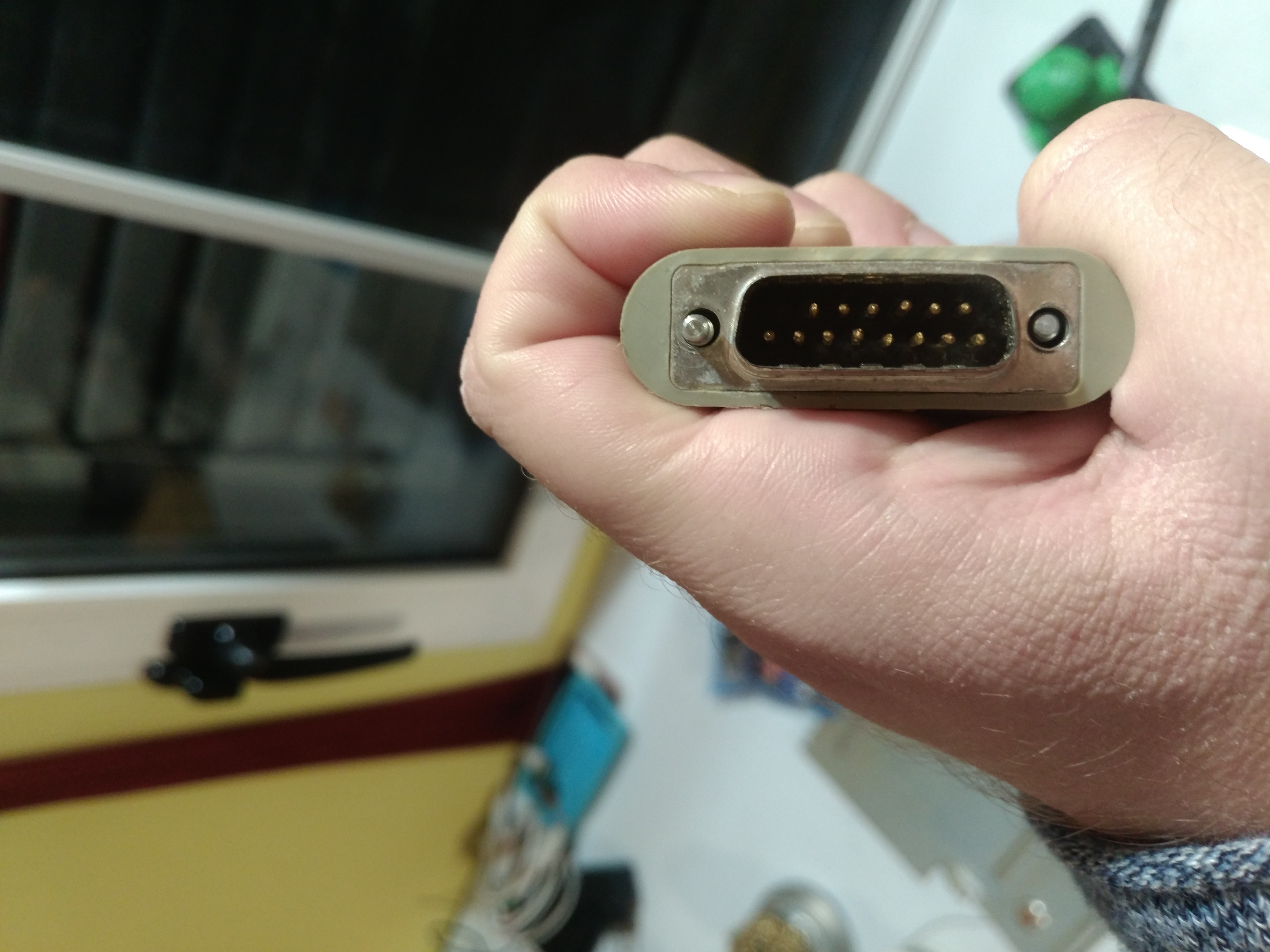

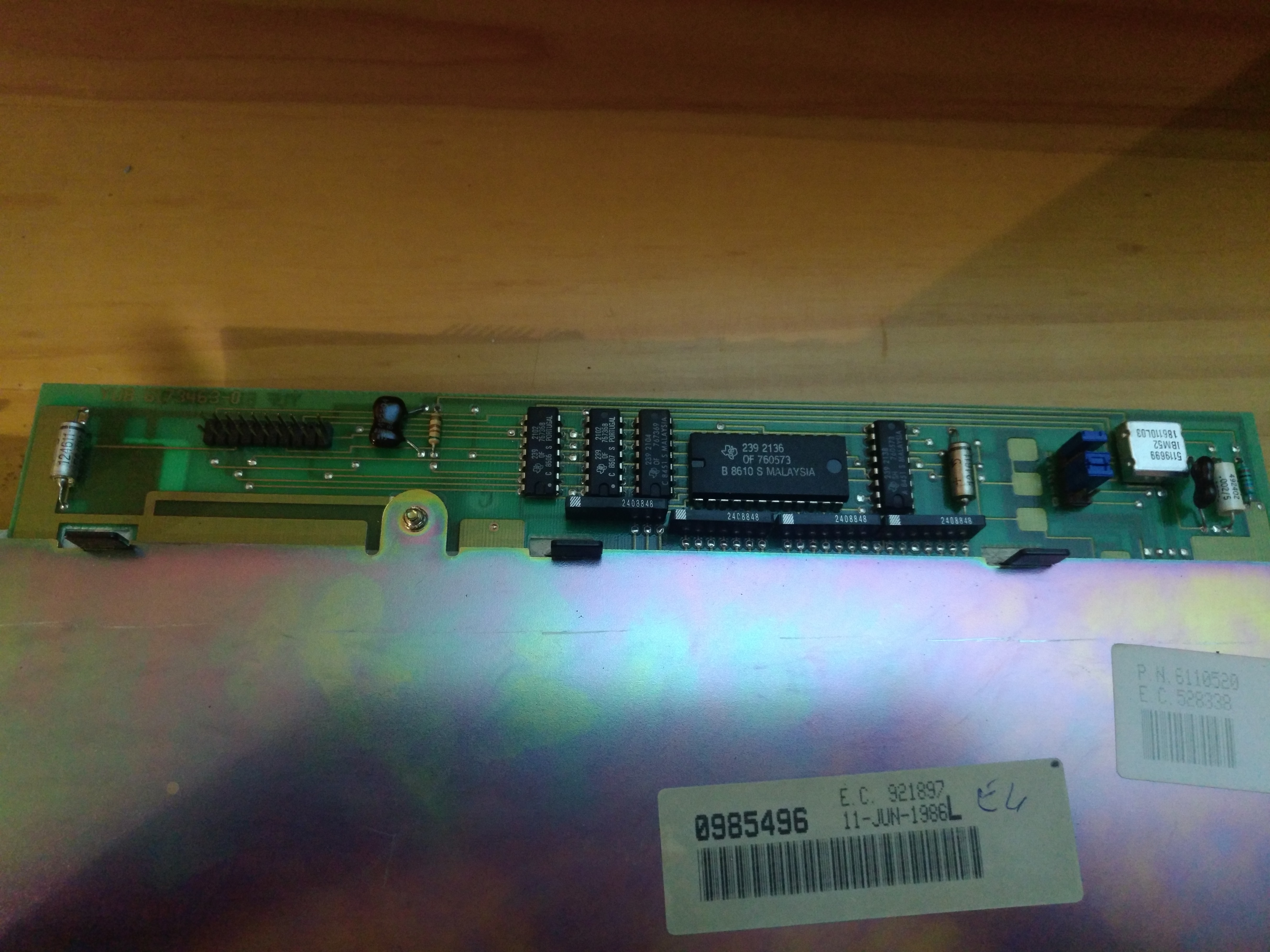

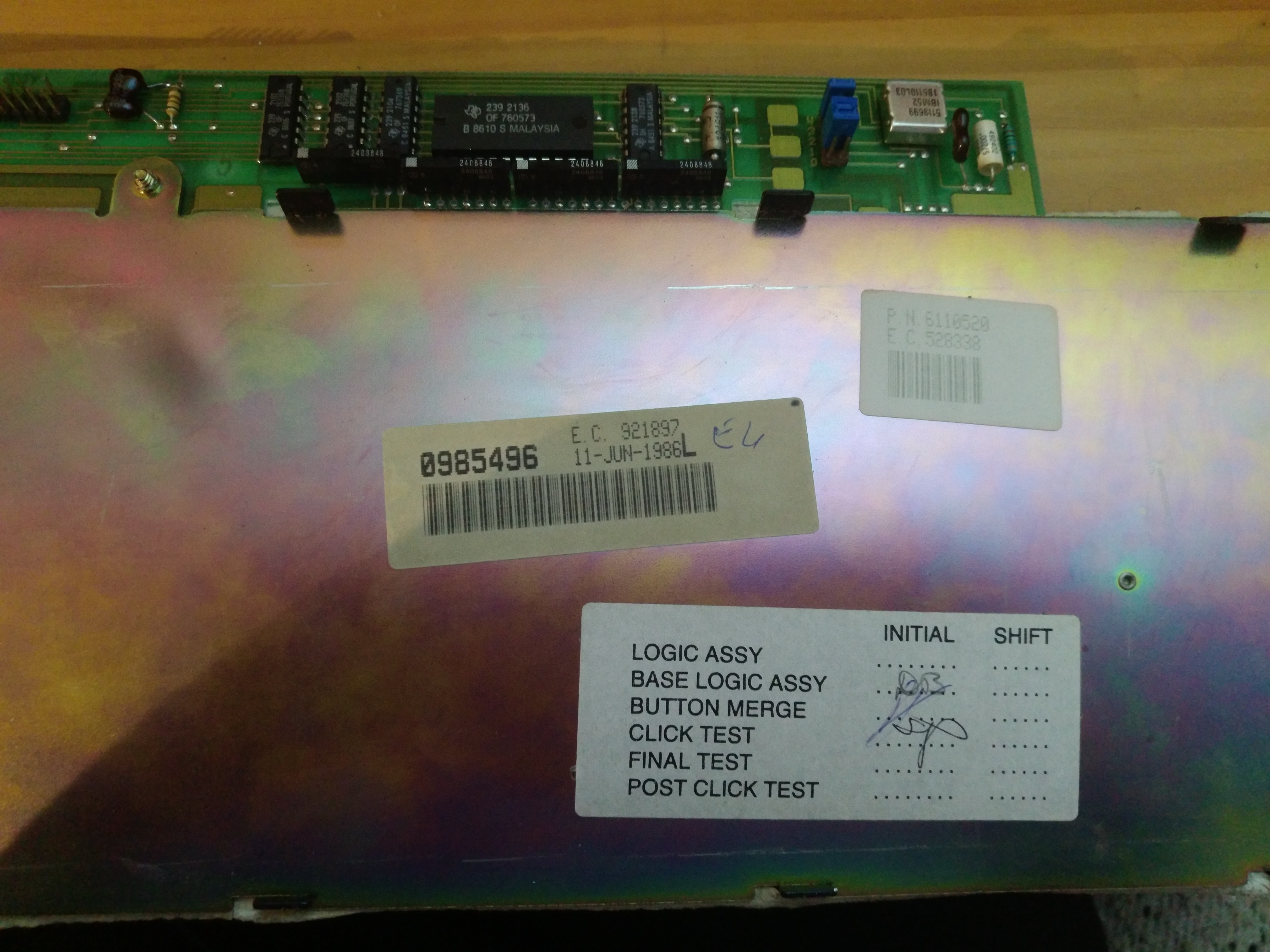

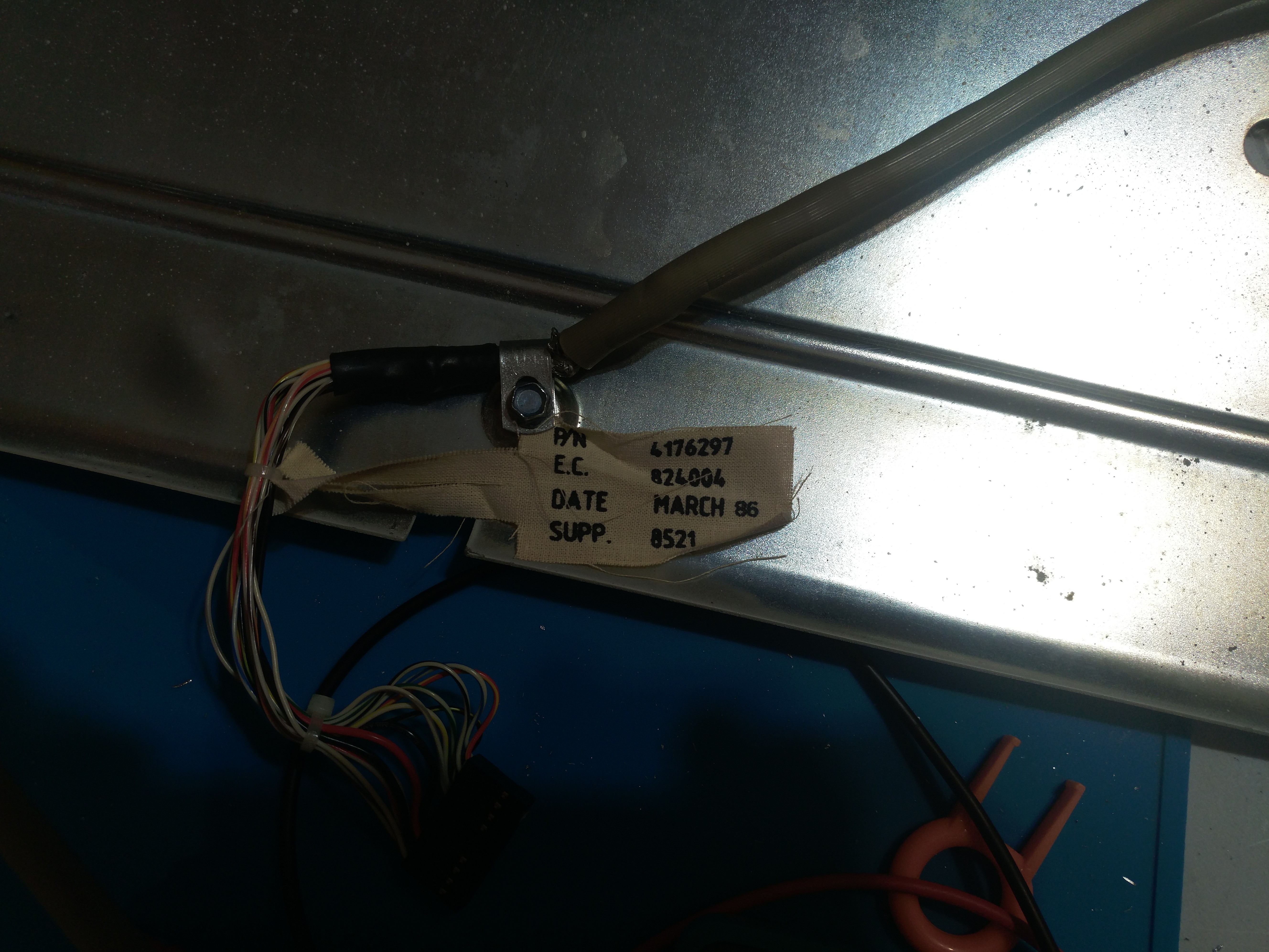

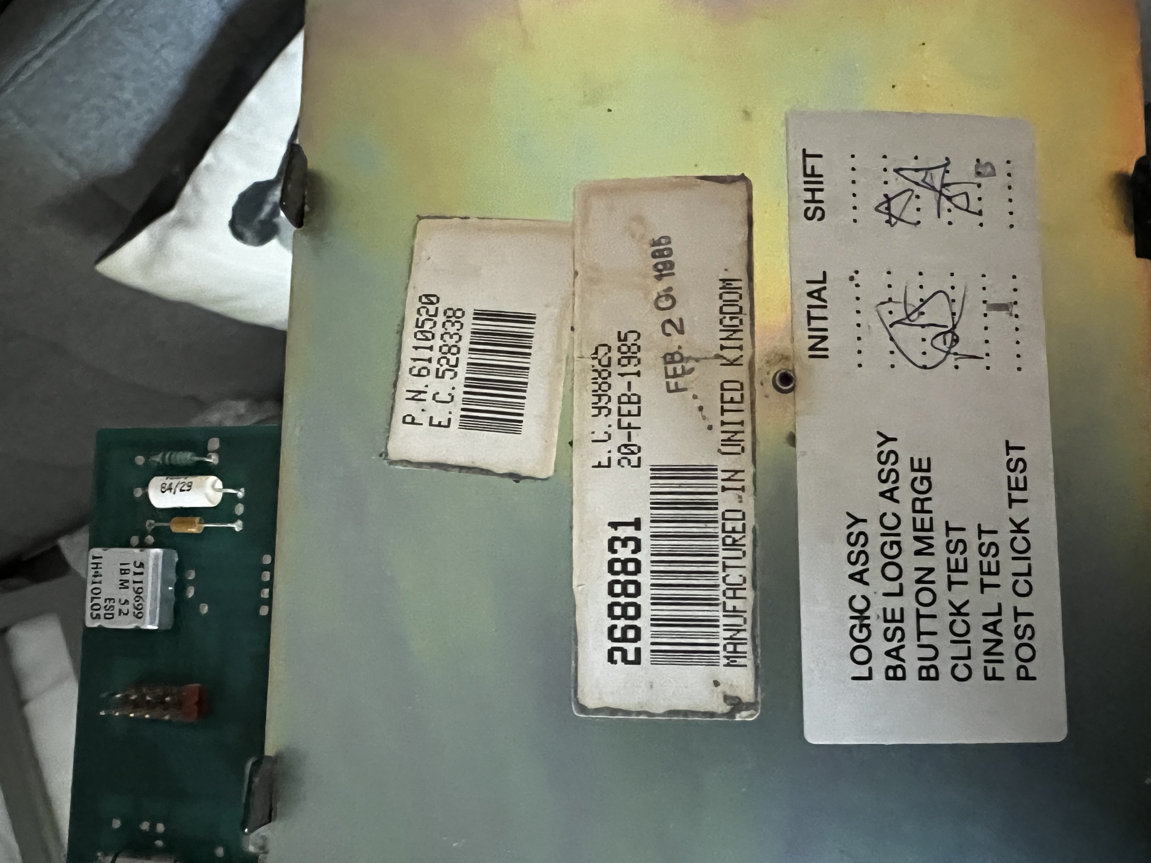

Some attached pictures!
- FJIMG_20200318_031841.jpg (2.52 MiB) Viewed 25821 times
- FJIMG_20200318_031833.jpg (2.69 MiB) Viewed 25821 times
- FJIMG_20200318_031919.jpg (3.18 MiB) Viewed 25821 times
- FJIMG_20200318_031857.jpg (1.84 MiB) Viewed 25821 times

If you have access to a regular XT capsense PCB, since the layout is the same, you can just change capsense PCBs (which has the controller on it) that and you'll have an easy to convert XT signal and you could even use the XT's original cable if you so choose. I've made this suggestion a few different times on different threads and I can't say I've seen anyone actually do it, but I see no reason why it shouldn't work given that the layout is the same and I'd have to assume that the retaining clips that hold the capsense PCB down to the backplate are also in the same places.
I don't have a bigfoot to try it with myself, but if I did, I'd probably go the Model F XT PCB route if you can get one without having to pay international shipping rates. Alternately, you might just totally swap XT guts into your case if the backplate uses the same mounting as the XT.
Other thing you could do is chop off the original controller and handwire to commonsense or Xwhatsit, like I have done here: viewtopic.php?t=19522

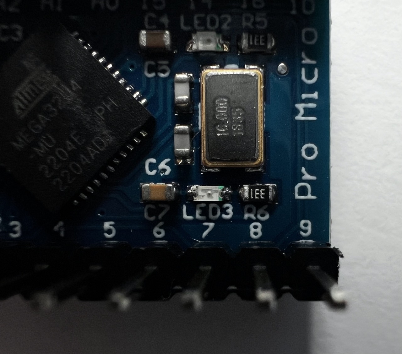

If you're using Soarer's Controller firmware, it can work but with one modification. The firmware's (at least by default) use of pins was designed with Teensy 2.0 in mind, and one such pin it uses (PB0) is exposed on the Teensy 2.0 but is used internally for an LED (RXLED) on Pro Micros. You should be able to remove the LED's resistor and solder a wire onto its pads to recover the line. See my website for the full pinout you need to use for Soarer's Controller on Pro Micro.AngryCockroach wrote: 10 Apr 2024, 16:33 Hi, did you make it run with the Arduino Pro Micro?
I have acquired three Bigfoots and would like to use the cheaper Pro Micros instead of the expensive Teensy or Micro (without Pro).
AngryCockroach
Oh wow, thanks for the fast answer. You mean the black little one on the right?
That is very tiny... I soldered the legs on the micro several times for other Ms or Fs, but that tiny thing looks difficult....

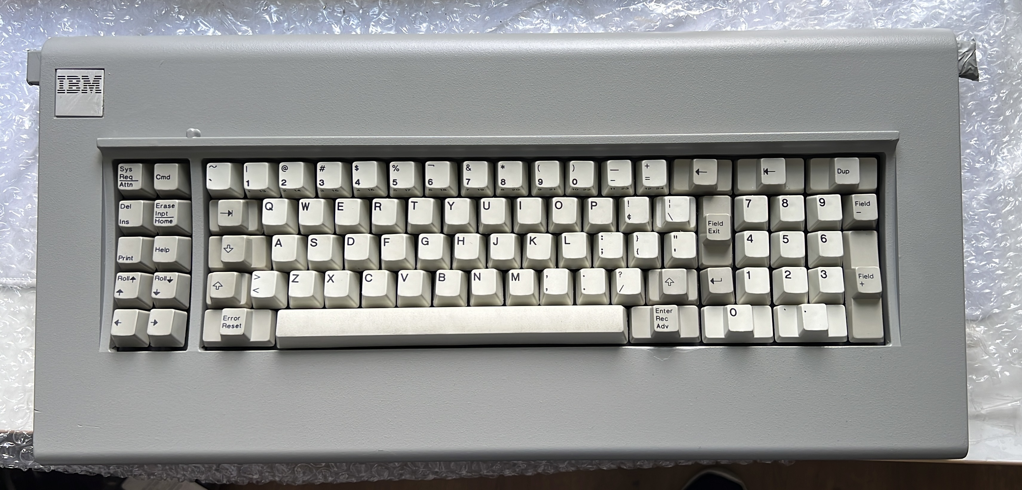

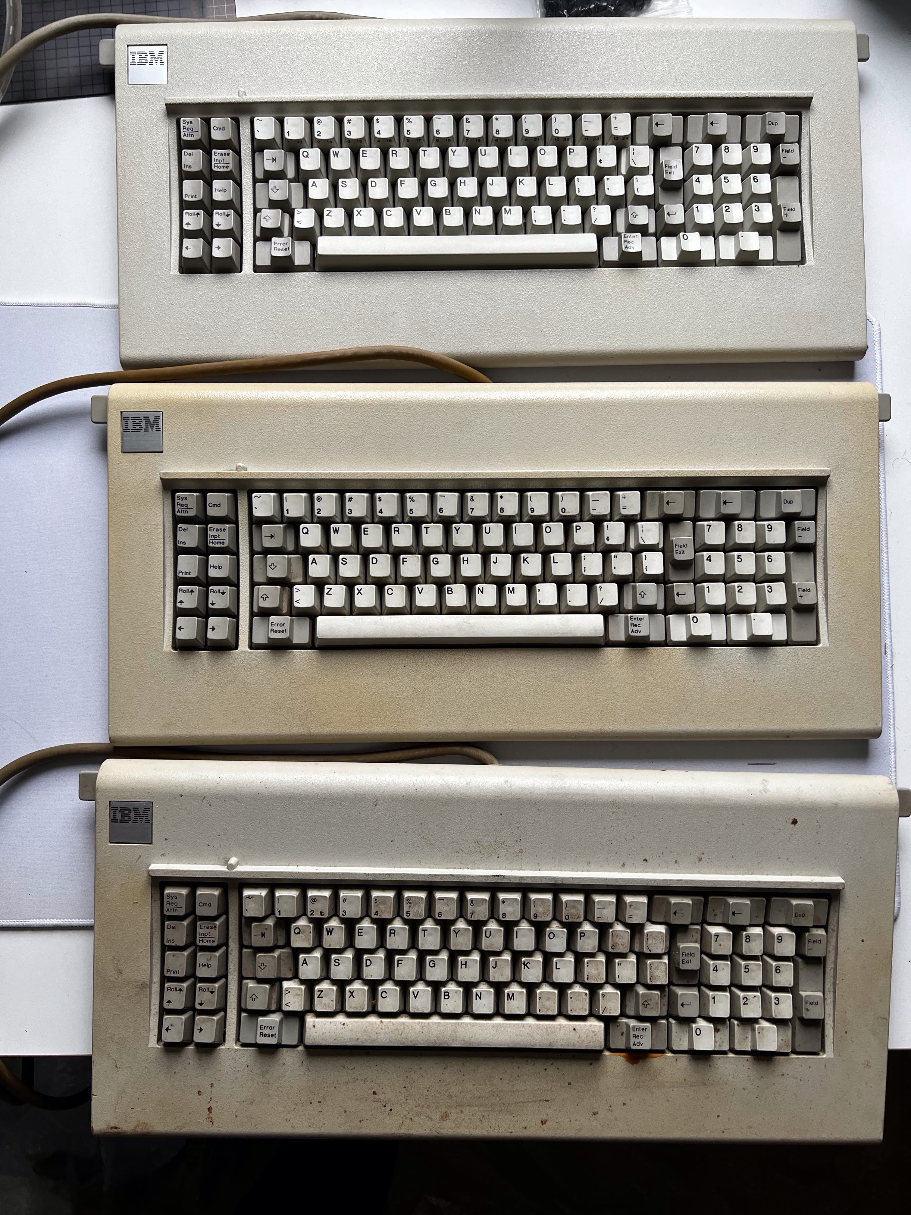

Here are the bigfoots. I will paste pictures after the restorations.

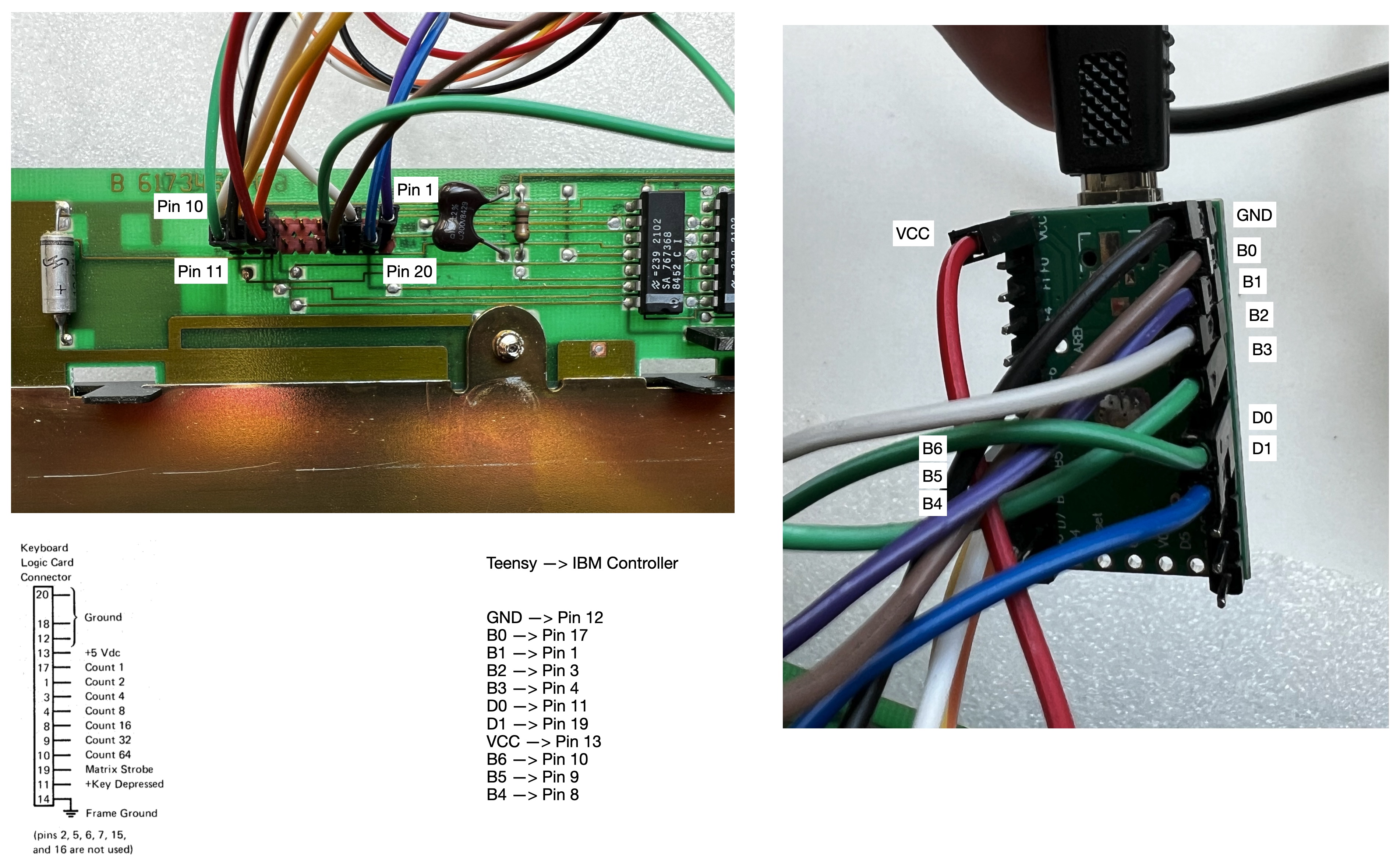

I now hooked up the teensy (with Soarer 1.2 beta) to two of the bigfoots but it does not work quit well:
Some key presses result in multiple character outputs and some keys do nothing at all. It is the same on both keyboards. So I assume it is no hardware error on the keyboards or the PCB.
I connected the teensy like shown in this thread: https://geekhack.org/index.php?topic=48950.0
I also tried switching out the grounding screw but same result.
Anyone knows more about the settings for the bigfoot in the Soarer Controller (debounce, ...) and what might help?

And I painted the last keyboard grey because the paint was damaged and I wanted the industrial look.

Do I have the 5291 or the 8521?
The product number suggests the 5291 right?

Ok, I found the issue:
The linked guide on geekhack is wrong: Wire 2 and Wire 3 need to be each one pin above!
Here is how you connect the keyboard to the Teensy:
AngryCockroach
I had some duplicate outputs which I fixed with debounce 2 (instead of 1) in the config.
