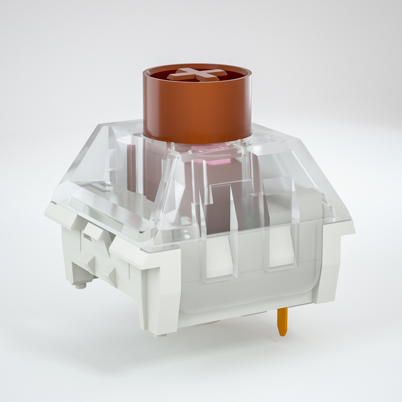

[New Product] Kailh Silent Box Switch
Feature:
Linear and tactile options
Circle Stem
Buffering rubber mat
Noise Define Standard:

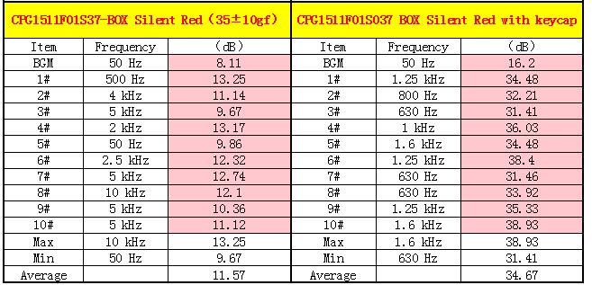

Red is under the 40db,
Brown is under the 45db
red silent noise test data
CPG1511F01S38.pdf
kailh silent brown box datasheet
(862.74 KiB) Downloaded 1351 times
CPG1511F01S37.pdf
kailh silent red box datasheet
(871.96 KiB) Downloaded 1217 times
kailh silent tactile box
Kailh Silent Tactile Switch (2).jpg (252.9 KiB) Viewed 51690 times
kailh silent linear box
Kailh Silent Box Switch.jpg (256.8 KiB) Viewed 51690 times
02 Apr 2020, 06:57
The values in the datasheets are interesting...
The Silent Red (pink) switch has only 35gf listed actuation force, which would make it similar to the super-light linear Gateron Clear.
The Brown switch has 45gf listed actuation force and 65gf listed tactile force at around 0.6 mm key travel... which would be closer to a Zilent V2 or ... silenced Hako!

Okay, my BOX Silent Browns finally arrived.
tl;dr: BOX Silent Browns are business-like, sturdy, and silent switches no heavier and slightly more tactile than MX Brown. To get BOX Silent Brown, dampen an MX Brown, remove scratchiness/sandiness, reduce wobble and put the bump at top.
Here's what I posted elsewhere:
I just opened my BOX Silent Browns.
The first thing that strikes me is that these are very light. They can't weigh much more than regular BOX Browns, and may even weigh less. Anyway, they're definitely Brown-weighted. Within 5 gr of MX Brown. I tested them beside some 63.5 gr Ergo Clears, and the BOX feel as light, or lighter.
The second thing is that they aren't super-tactile. They may be slightly less tactile than regular BOX Browns, but I'll have to test them side-by-side. They have a similar force profile as BOX Brown. There is a tactile resistance right at the top that has to be overcome, and then it just drops. I recall BOX Brown as having a steeper and starker 'drop' that felt more like a buckling mechanism.
It's a profile that resembles Zilents, but less steep, less tactile. Someone recently said that they feel midway in between Zilents and Aliaz, maybe closer to Aliaz, and I agree with that in terms of overall tactility. But the bump profile is closer to Zilents than Aliaz.
They're basically a less tactile, less sharp Zilent. That may be good or bad for you.
Third, they're definitely silent. They are much quieter than the Ergo Clears they are running beside. They might be quieter than Aliaz, since there is no weird spring noise.
Overall, these appear to be perfectly functional silent switches. They are a not-too tactile version of BOX Browns or even Zilents. They feel consistent and fairly smooth, but also kind of boring. Like these haven't been designed to wow you or anything, just function as a silent Brown using the BOX design.
I took a risk and have a couple of GMK keycaps on them right now, and it sounds and feels fine. Nothing has cracked yet. I think I may enjoy the KBDFans PBT Dolch more with these switches. Very quiet and stable.
When speaking of tactility, it's all relative.
When I say BOX (Silent) Browns aren't very tactile, I mean that in comparison to the new generation of super-tactile switches, such as Holy Pandas, or Zealio V2.
In comparison to MX Brown, they are more tactile. Some people say that they are more tactile than regular BOX Browns. I would say that BOX Silent Browns are medium tactility, if on the lower end. They occupy this category together with MX Clears. I have Ergo Clears [63.5 Progressive] that are less tactile than these BOX Silent Browns, and Ergo Clears that are more tactile [60 gr actuation].
I had someone else type on these just now. They thought that the BOX Silent Browns were "heavier" than both 63.5 gr Ergo Clears, and 78 gr H1 switches. Now, the H1 switches are obviously heavier in spring weight, but because they have little tactility, the BOX Silent Browns actually seemed 'heavier' than the H1s.
Personally, I find that the BOX Silent Browns are more tactile than Cherry Browns, maybe even the less-tactile Ergo Clear variants. But I find them a little harsh. Because once you clear that initial bump, it just slams down like Zilents. And the BOX Silent Browns only have 3.6mm of travel. So it's a bit of a slam-slam. At least you know you're typing.
I think these might be a good candidate for a stock custom switch at KBDFans or Varmilo. Like if you need a 65% or something that's quiet, order a TADA68 / VA68M with BOX Silent Browns, and it's ready to go. Just add dampening.

My evaluation of the BOX Silent Brown switch is that it succeeds at being a quiet BOX tactile. It is right there on the level of Aliaz and Zilent, and may even be slightly quieter.
Its tactile characteristics are in between that of the Zilent V2 and the BOX Brown. Both have the tactile ceiling at the top, and subsequently collapse. The tactile event of Silent Brown may be slightly more resistant than the original BOX Brown, and I find that there isn't as much of a 'buckling' effect as there was in the BOX Brown.
The BOX Silent Brown wobbles less than Cherry MX tactiles, but probably more than Zilent V2s. They are not a wobbly switch by Cherry standards. They are also smoother than stock MX tactiles, but there is some scratchiness present, maybe a result of the dampening.
The biggest weakness of the switch for me is that it races to the bottom very quickly after the tactile event. With 3.6mm travel, I find myself reaching bottom more quickly than I would like. I did not find that I experienced this problem with the original BOX Browns.
If these switches hold up in terms of longevity, then Kailh has a pretty solid silent tactile on its hand. However, I find that the original BOX Browns feel a little more 'crisp' than the Silent Browns, and have more of a 'buckling feel.' Consequently, I would like to see a non-silent BOX Brown V2 using the new circular BOX stem. An improved BOX Brown V2 that doesn't turn clicky and doesn't risk breaking keycaps would be a worthy improvement.
