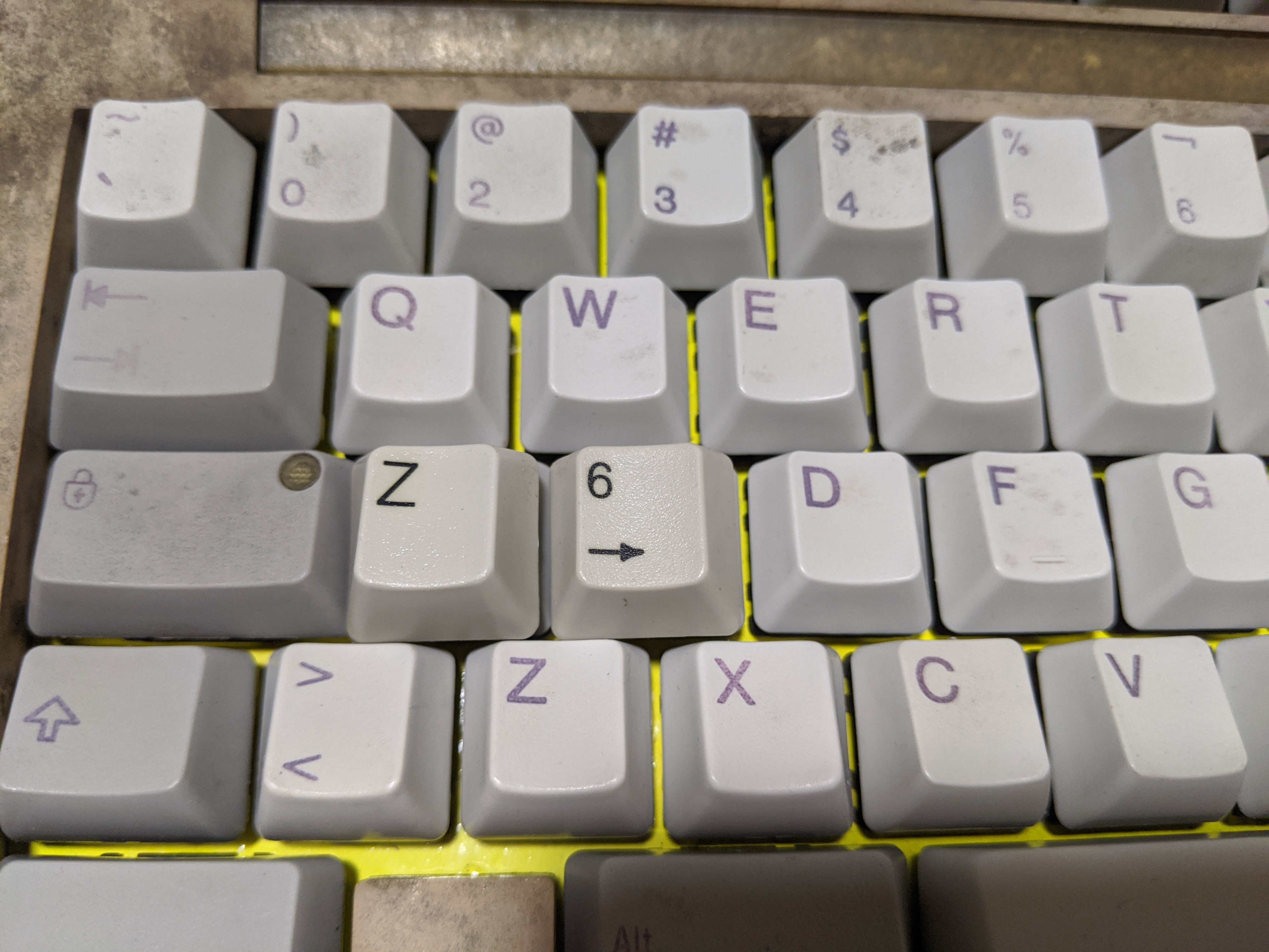

Dyesubs can what I call "smudge" and "bleach". With the former, the edges become blurred and the legend loses its sharp edges. With the latter, the colour simply fades; in the case of IBMs, usually into a purplish colour. This isn't (necessarily) paired with smudging.

Speaking of purplish colour, I have a couple of NMB boards with space invaders and dye subs that were outside for an extended period. Some of the lettering has almost disappeared, and what is left is mostly a light purple. Some caps from an RT8875 included for comparison.

I have some caps like this on my ICL DRS keyboard manufactured by NMB. Not that common but it does happen from time to time.4_404 wrote: 18 Jun 2020, 10:24 Speaking of purplish colour, I have a couple of NMB boards with space invaders and dye subs that were outside for an extended period. Some of the lettering has almost disappeared, and what is left is mostly a light purple. Some caps from an RT8875 included for comparison.
