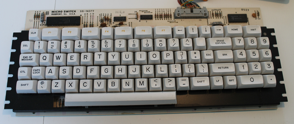

Here is the board, there are many more better photos of the similar boards in the threads linked to above (the cable is hardly original, I think the wiring matches a bidirectional IBM PC parallel port):

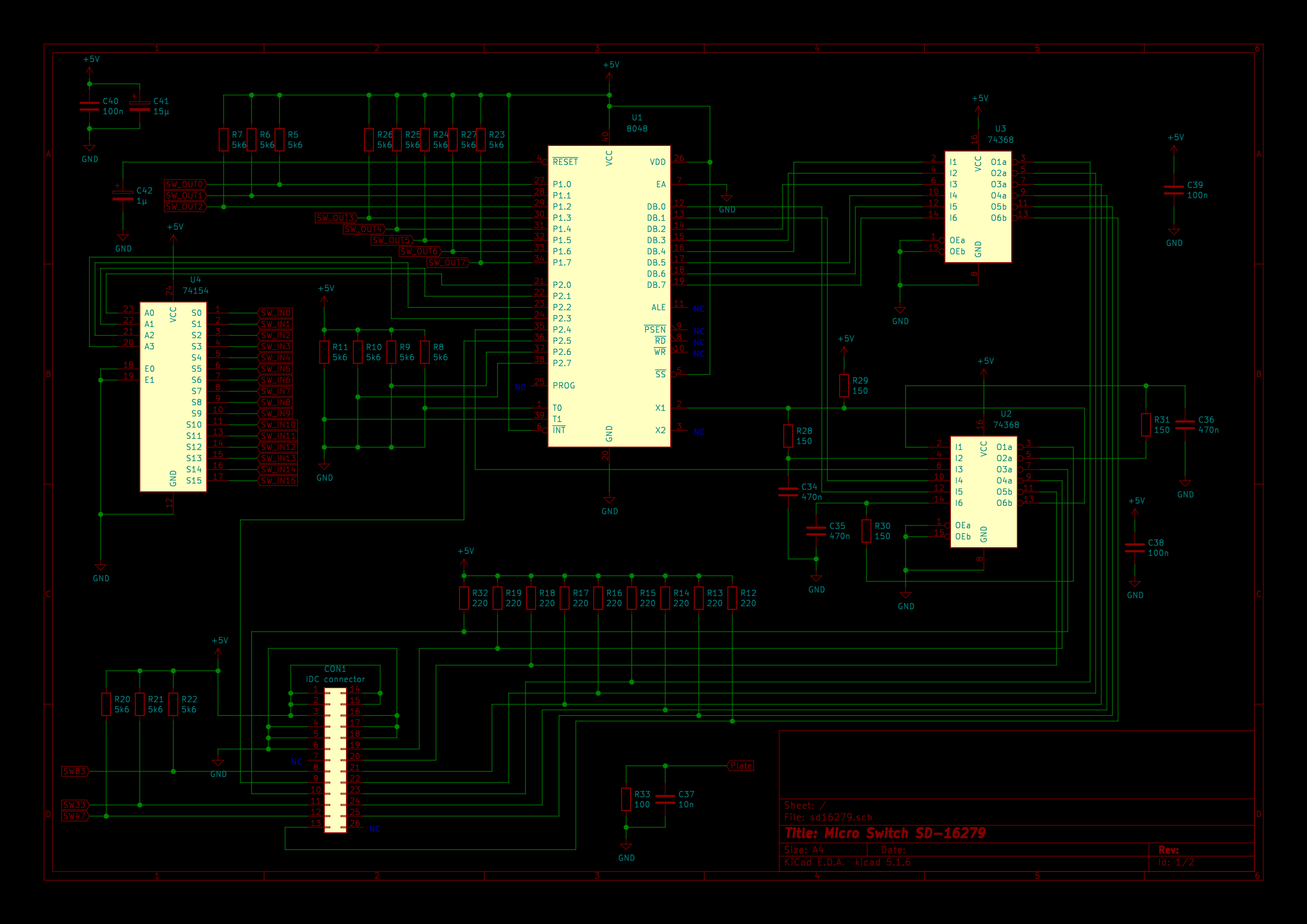

I was happy to find that the PCB is single sided, so it is easy to read, and I made a diagram of the whole thing (there may be errors, of course, and also it is a bit messy as I just drew it as I went along "reading" the PCB and I haven't cleaned it up afterwards). Here it is, minus the switch matrix:
Quick summary of the schematics: the controller is an 8048 and it buffers its output with a pair of 74368 hex inverting buffers (three of those gates are also used as an oscillator). Then a 74154 demultiplexer is used to scan the switches (I used the labels "IN" and "OUT" from the viewpoint of the switches, so the demultiplexer outputs going to the keyboard matrix are labelled "SW_IN"). The switch outputs SW_OUT are connected directly to the "DB" port of the 8048 (with 3 exceptions, see below). I'm guessing the funny resistors R8-R11 are spare inputs (require desoldering of some wire jumpers).

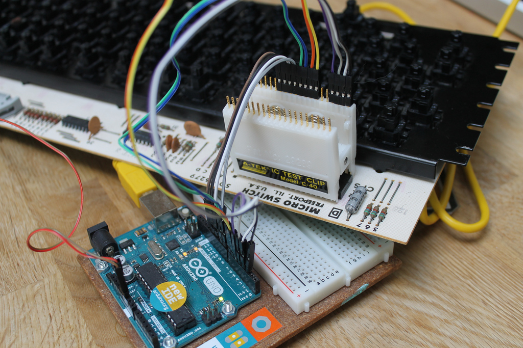

One could make a reasonable USB interface connecting only to the output port as it is, perhaps using the special keys RPT, END-OF-MESSAGE, BREAK and BLANK as modifiers. Somewhat better control of the keyboard's state is of course desirable, but I also wanted to keep the board as untouched as possible. I ended up to piggy back on the controller: I connected an Arduino Uno (for testing, eventually to be replaced by a Tweeny) and let the original controller do its thing with me spying:
This works. I listen to the four SW_IN lines (pins 21-24 on the 8048) and wait for the transition from 0 to 15=1111b (the 8048 scans downwards). Then I record the SW_OUT lines (pins 27--34 on the 8048), wait for SW_IN=14, record the SW_OUT lines etc. I also timed the 8048: it holds SW_IN fixed for roughly 150µs, except for the value 15=1111b, which is held only for around 70µs. This is possibly because only the SHIFT and CTL keys are connected to the SW_IN=15 line, so I can imagine that the 8048 code handling this line is different from the rest (incidentally, the SW_IN=15 line together with SW_OUT4, SW_OUT5, SW_OUT7 are also exposed through a 4-pole edge connector labelled "TP", I guess for extending the keyboard with up to 3 external switches). I also need to monitor the END-OF-MESSAGE, RPT and BREAK keys through the 25-pins connector. In this way I can read the entire keyboard state without interfering with the keyboard's original function, and it could still be connected to a VIP terminal. I think I am done at this point as it now is straight forward to make a USB interface; I just have to wait for my Teensy to arrive in the mail.

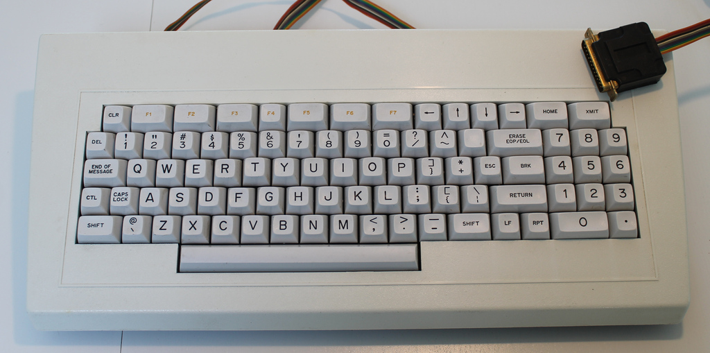

Here are some pictures of my white Honeywell, for comparison. I think we have the same unit.
I also have the original cable..
You made a great work rebuilding the schematic, how can I help?

Luca: Hi! Yes, same board, it seems, the "CUST. PART" number matches as well. But the exterior "ti" label is different, yours is BKBD002A-003 and mine is BKBD002B-002. Whatever that means. That 3M-connector, what is it? It isn't DSUB?
lucar
26 Jun 2020, 15:07
It's DSUB , it's not clear from the picture. It's the same cable You have, only a different brand. The interesting fact is that we have the part number!

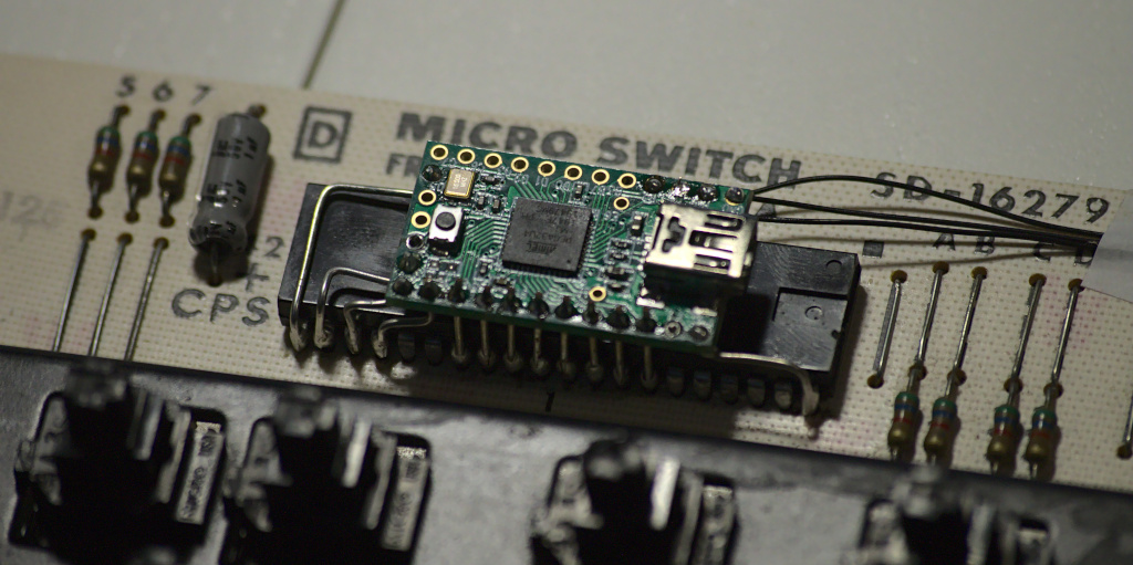

Teensy 2.0 spying on the 8048 controller:
I desoldered the LED on D6. The Teensy has enough inputs anyway, but the physical location of D6 was practical. The board is powered via USB, I think it is about 4-500 mA. Strictly speaking the Teensy doesn't tell the host it needs more than 100 mA (the USB enumeration business), but for a hobby project I'm happy.

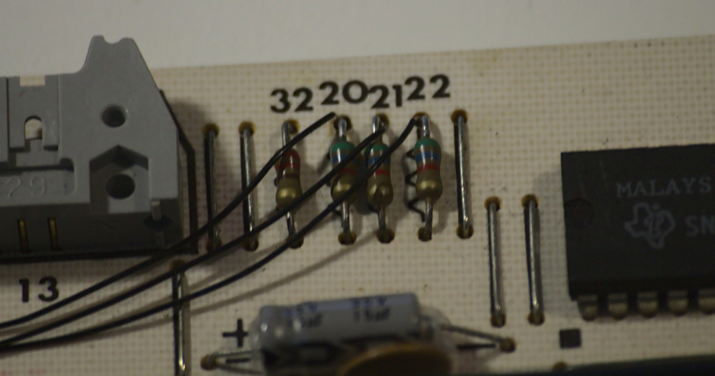

And here is were it picks up the 3 special keys that are "outside the matrix":
