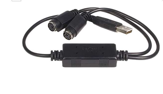

Sorry, I thought that my adapter was passive, but now I see that in the description it is probably active.
Anyway I had the blinking leds problem on all the usb ports. It happens about two times a day.
https://www.amazon.com/StarTech-USB-PS- ... B00028OP2Y
"StarTech.com USB to PS/2 Adapter for Keyboard and Mouse - Keyboard / mouse adapter - USB - USBPS2PC, Black "
