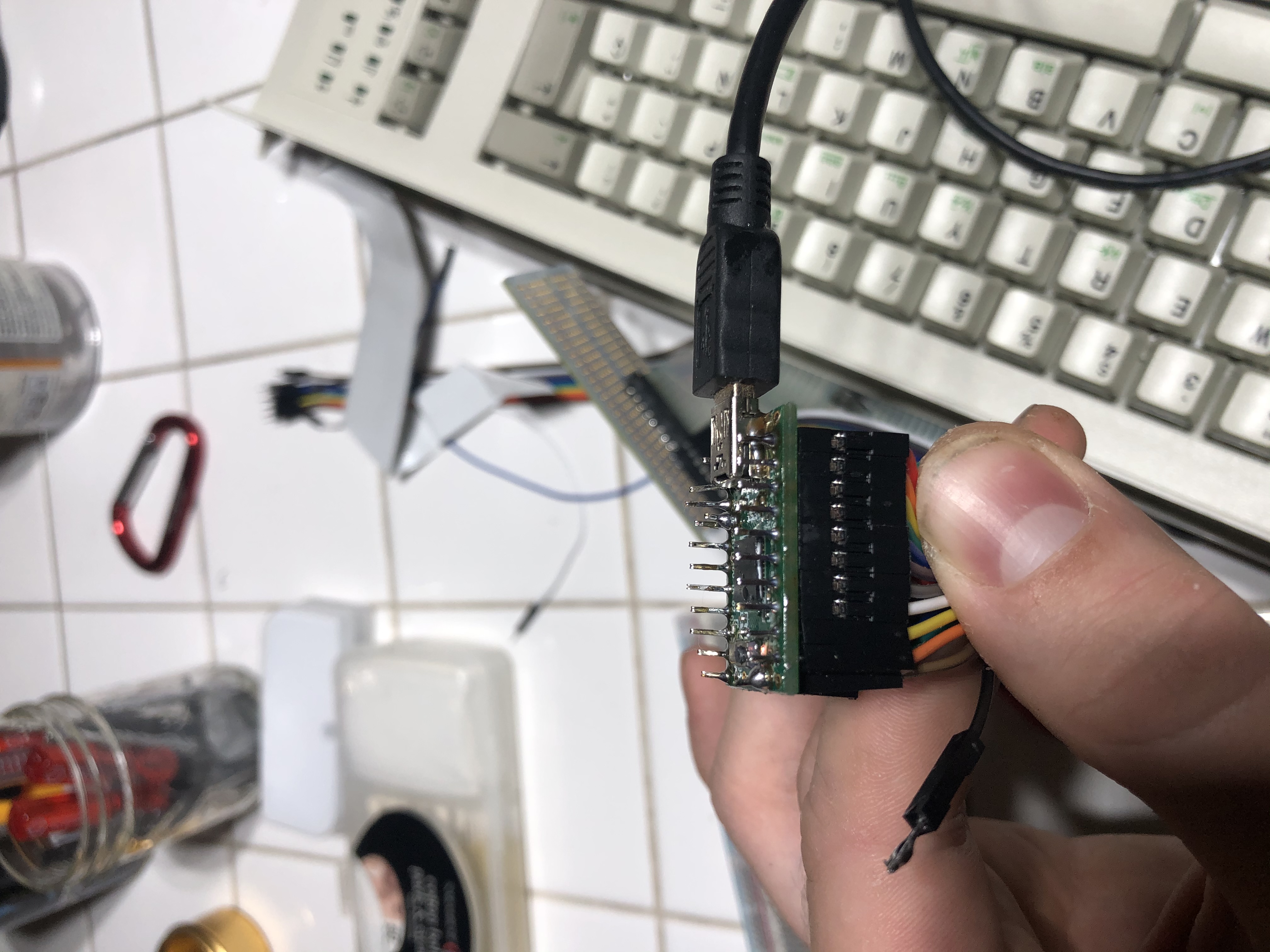

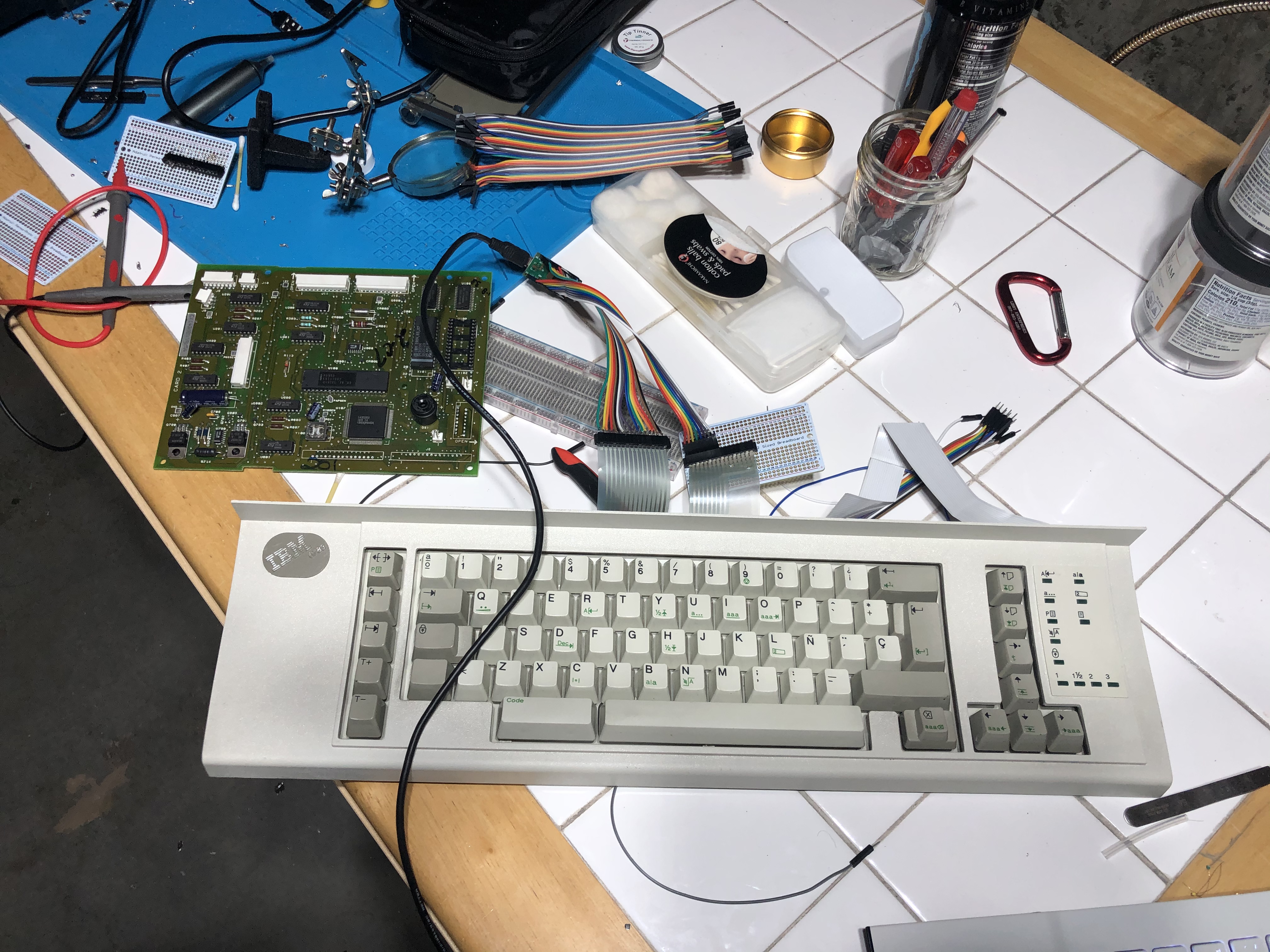

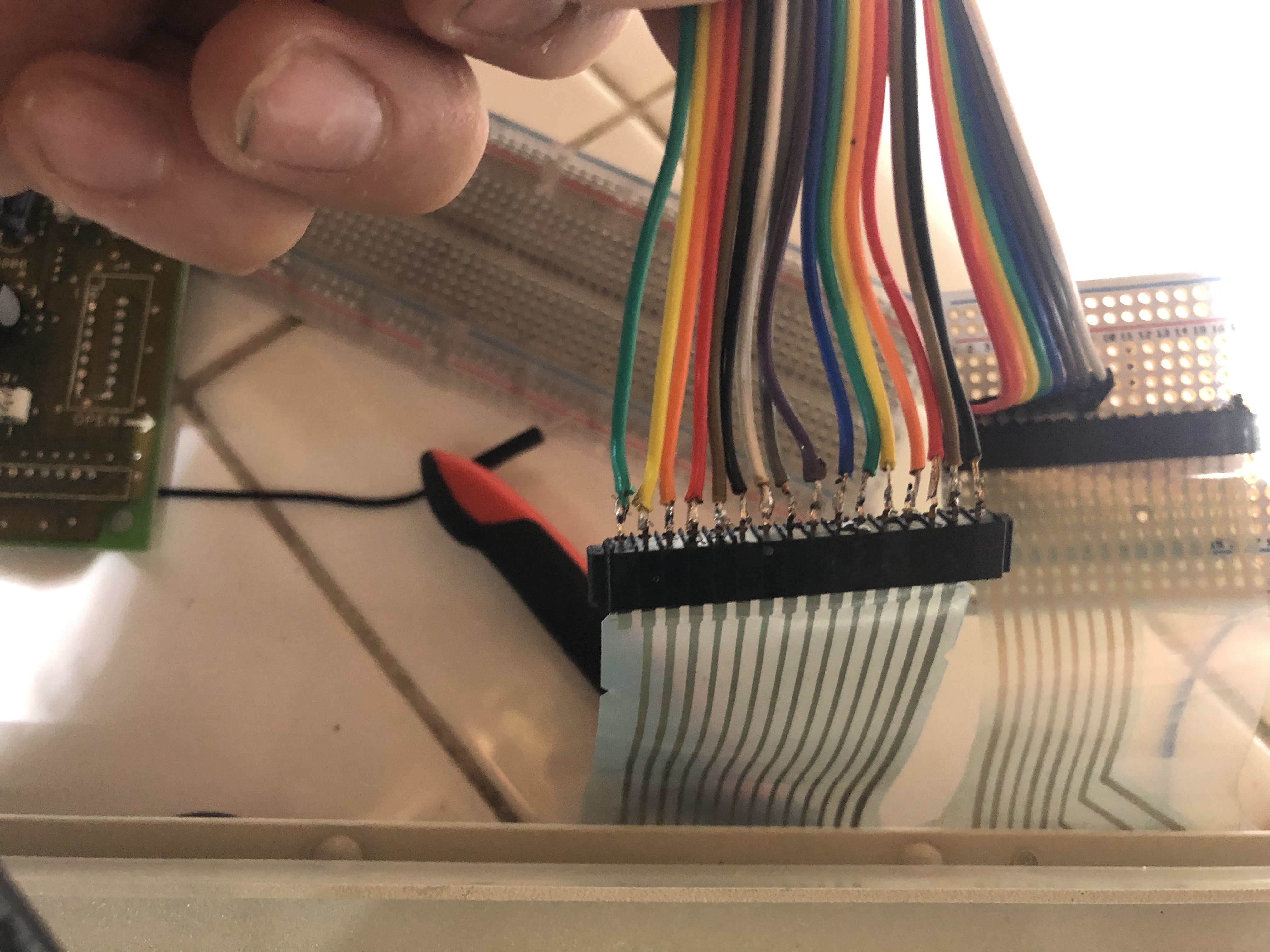

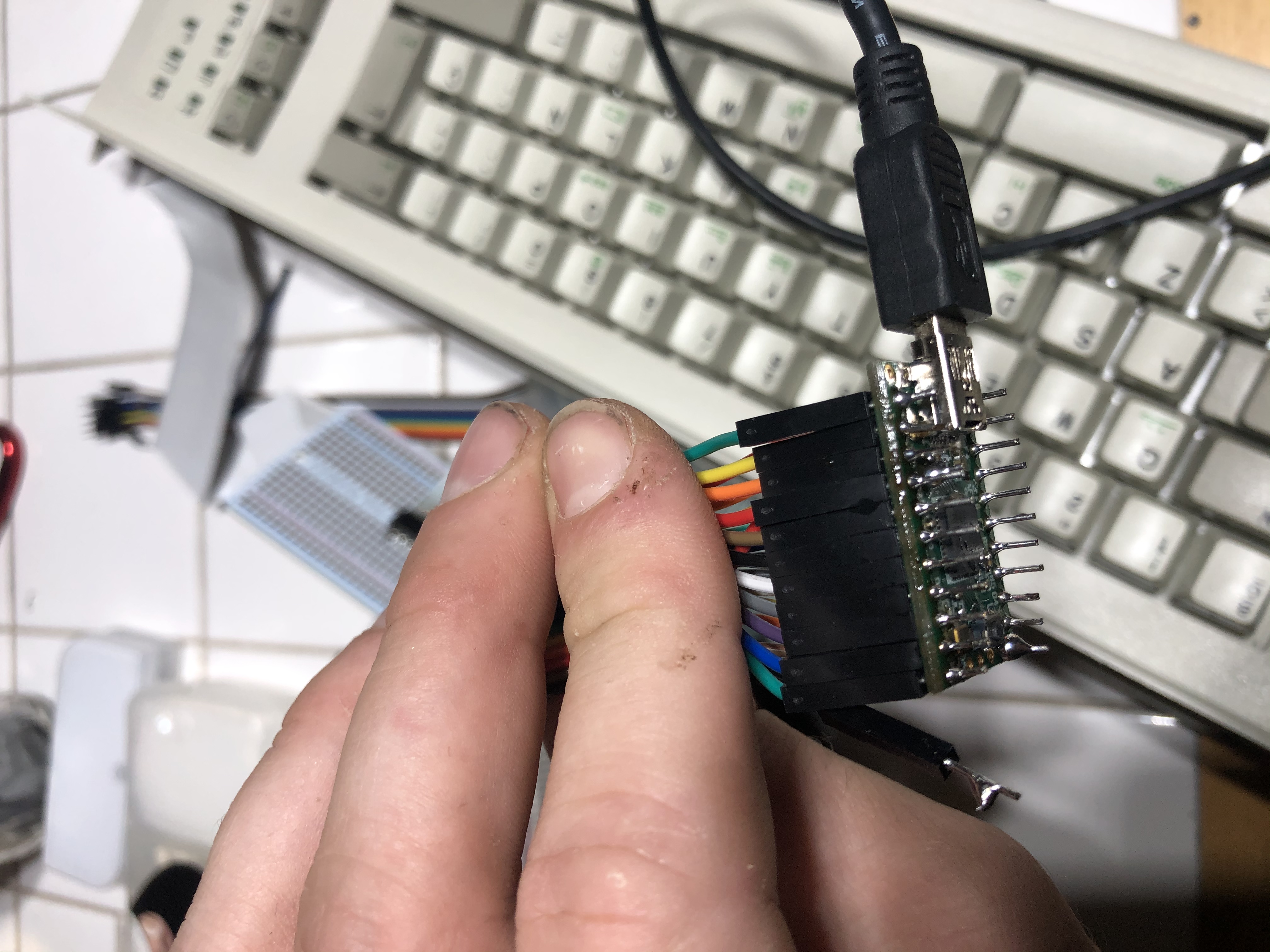

I found a nice little wheelwriter and I am in the process of following a guide to convert it USB. I am new to teensy, but I believe that I have everything all correct. The strange thing is that none of the buttons work correctly. Most don't work at all and the ones that do have the wrong letter or command. I am confident in my soldering connections on the teensy 2.0. so I am not really sure what I should do from here. I could really use some advice on what I should do from here on.

That pin close to the switch has a scary large blob of solder, is that shorting anything?
Does the controller respond as expected if you test positions in your matrix by directly shorting them?
