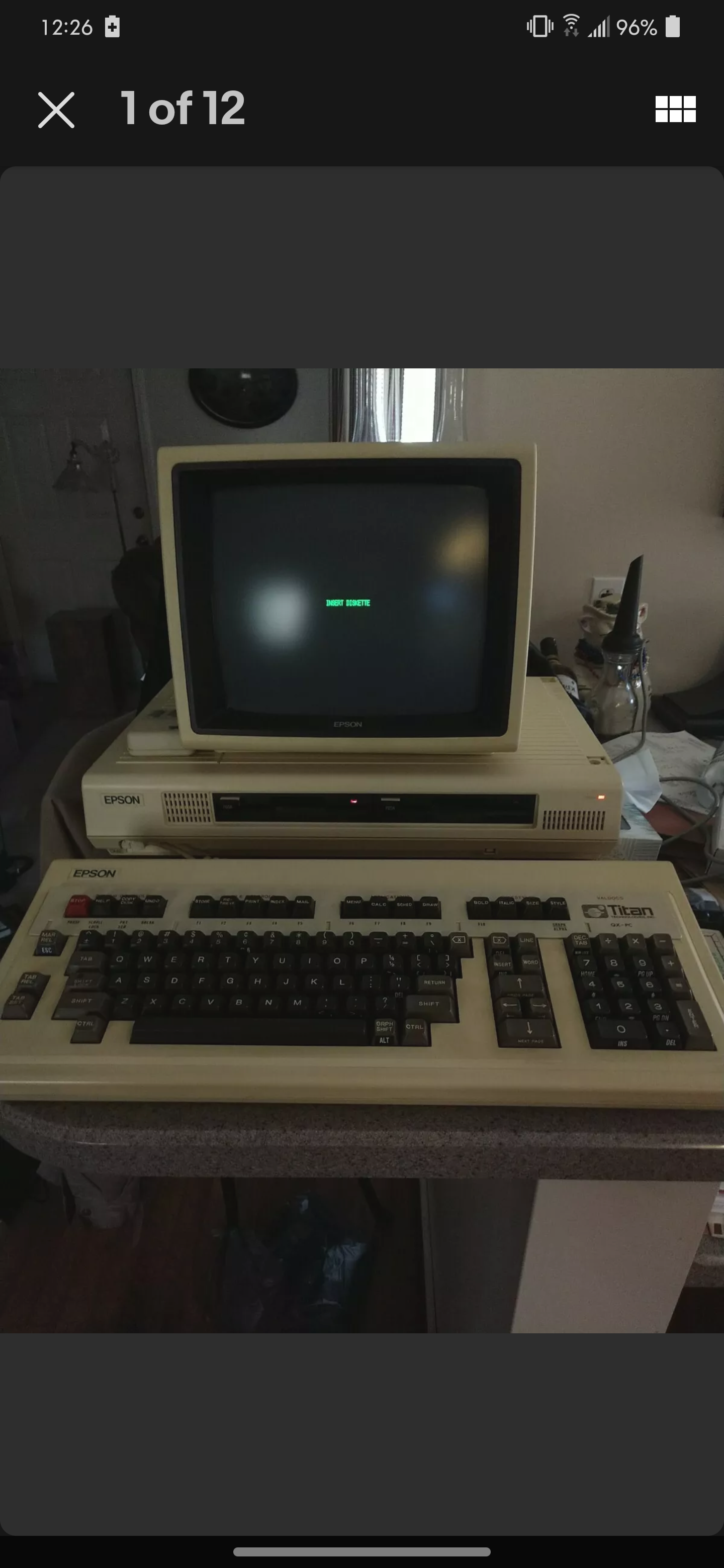

Hello everyone! I recently acquired an Epson QX-10 system off of eBay with the keyboard seemingly in pristine condition. I am looking to convert it to USB, but I have 0 experience with even soldering and have no equipment.
People in a local discord suggested that instead of inserting diodes into the traces and replacing the controller, the board could he handwired by connecting the new MCU straight to the switch pins. Not sure if this sounds about right, I really have no idea.
So I was hoping I would be able to find someone who is willing to take on a project like this, to convert a FLS board to USB with NKRO. An added bonus would be preserved compatibility with the existing system, although I anticipate this would be extremely difficult. Obviously I would he paying for this service. Thanks for your help!
