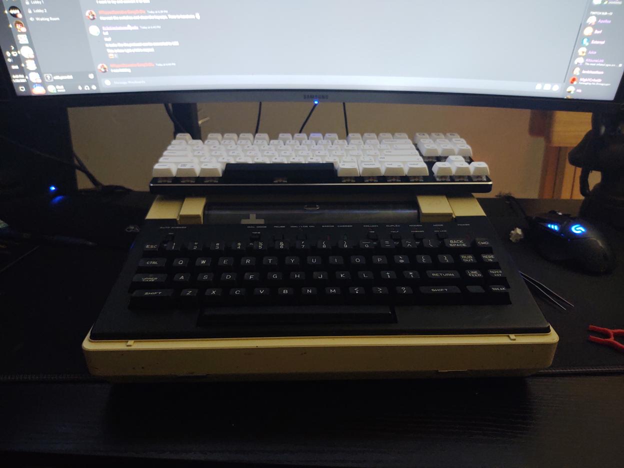

I recently found the stated KX-D4910D with Alps SKCC Creams at a thrift store for twenty dollars, with its original carry-case/handle thing, cables, and some of the documentation. With this being the first vintage that I've ever tried, it OBVIOUSLY blows any of the linears I've owned up to this point out of the water (even with it being dirty as it is), so I'd love to be able to convert it to USB and use it with my PC.
It uses an EIA RS232 25-pin connector (I'm still not sure if EIA is the actual protocol, or just something pertaining to the design of the connector, as vintage terminal keyboards are not something I am well versed in). I'm fairly certain that its internal PSU is shot (I got it to power up once, but now it won't again). Most of the switches feel fine, if a bit stiff since the SKCC Creams actuate at the same force as my daily driver switches bottom out at. Still, just doing some random typing on it feel s extremely satisfying and I'd love to get it working over USB, or at least working so I can use it with its built in thermal printer as an electronic typewriter of sorts.
But as I said, vintage keyboards are not something I know anything about, so I have no idea what direction to turn to as far as restoration or conversion goes. Any help would be greatly appreciated! I made this Deskthority account just to try and learn more about my find, and maybe even get it working again! Thanks again for reading.
Edit: I attached a picture, with my daily driver sitting on top of it as a size comparison.

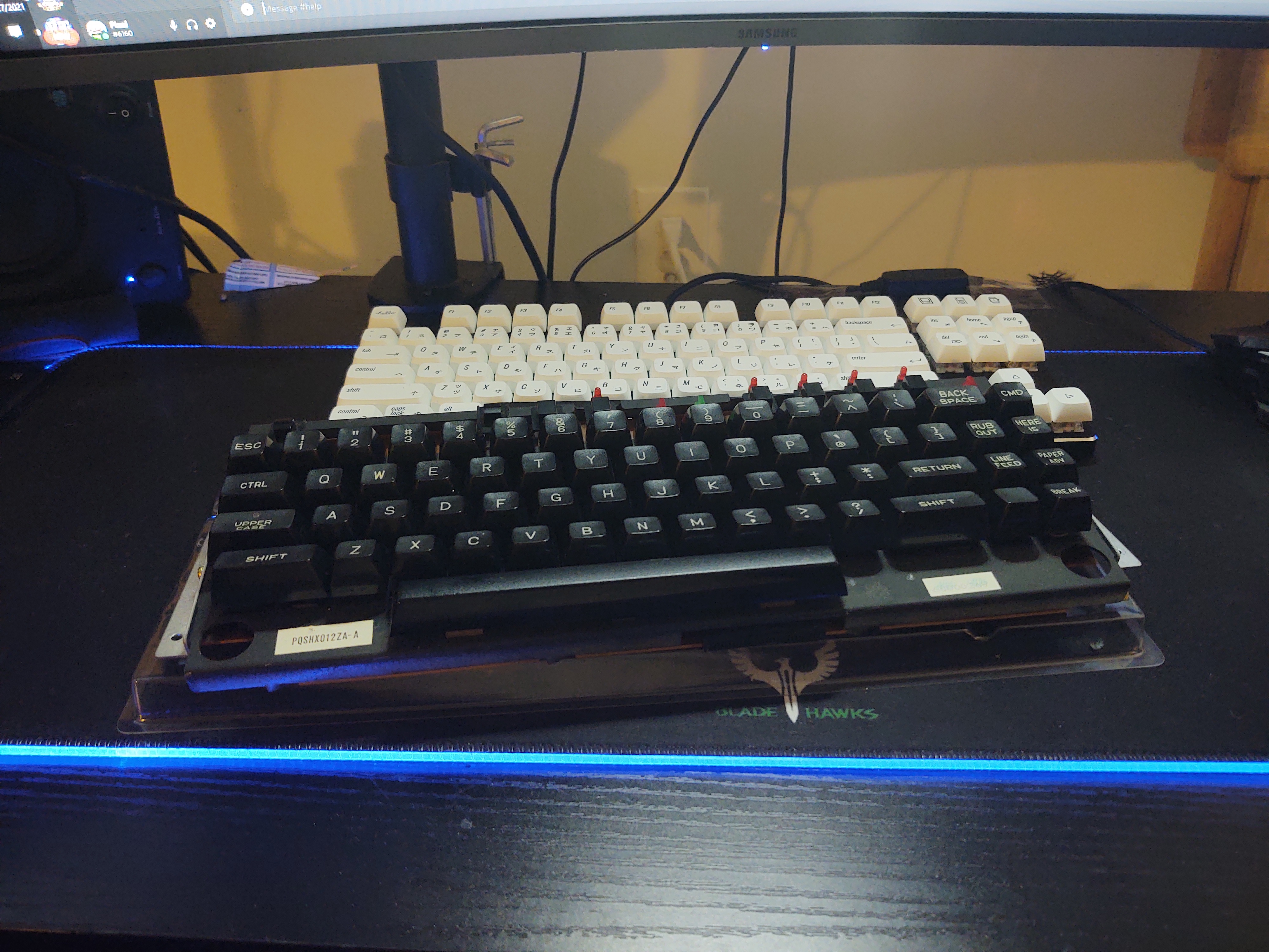

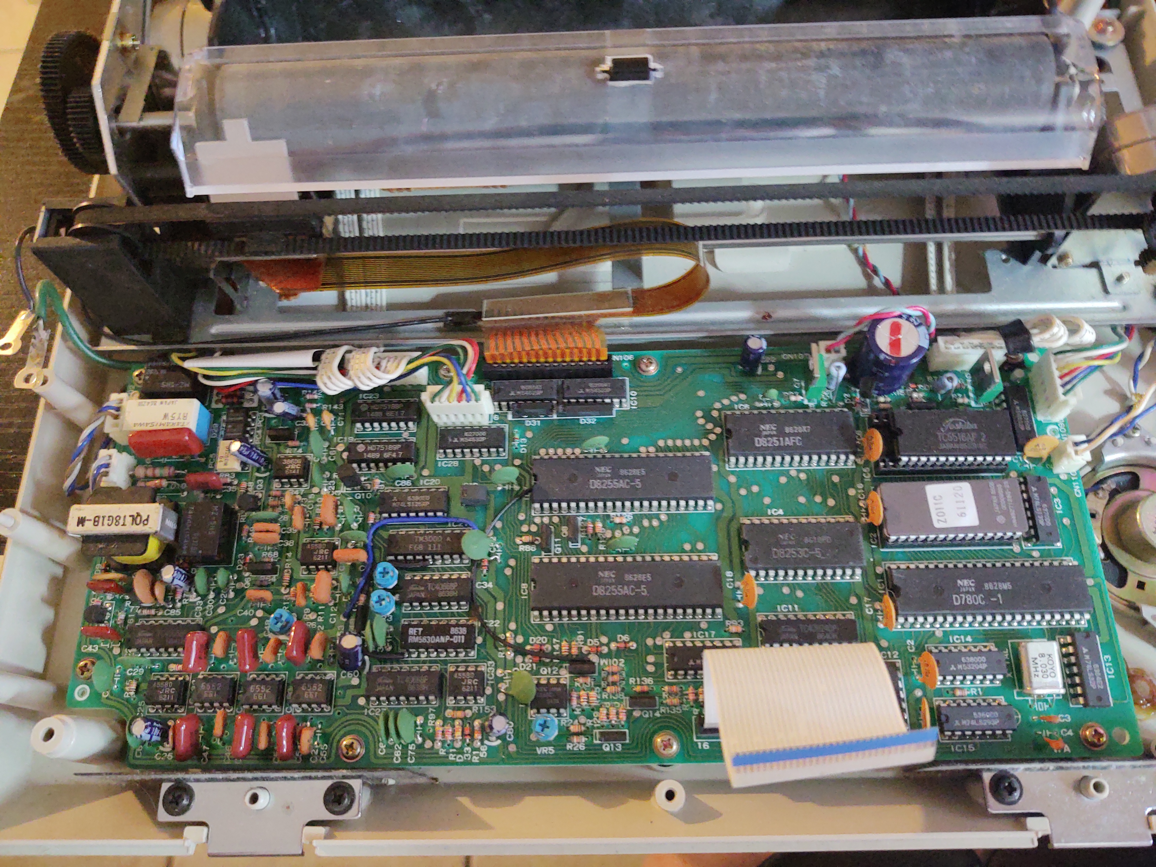

I actually just got it opened and liberated the plate and PCB! I'll take some pictures and post them here. The keyboard PCB attaches to the other one pictured via that white ribbon cable. Looks like there's a lot going on here.MMcM wrote: 28 Jan 2021, 01:51Have you opened it up yet? If so, can you post some pictures of the inside? Somebody might be able to tell from looking.PixelPlays wrote: 28 Jan 2021, 01:08 I'm not sure if it has any brains or not, since I know it's made to connect to a terminal. But it also has a built in thermal printer, so I'm not really sure.
- IMG_20210127_192951631.jpg (3.68 MiB) Viewed 5058 times
- IMG_20210127_192753166.jpg (2.72 MiB) Viewed 5058 times

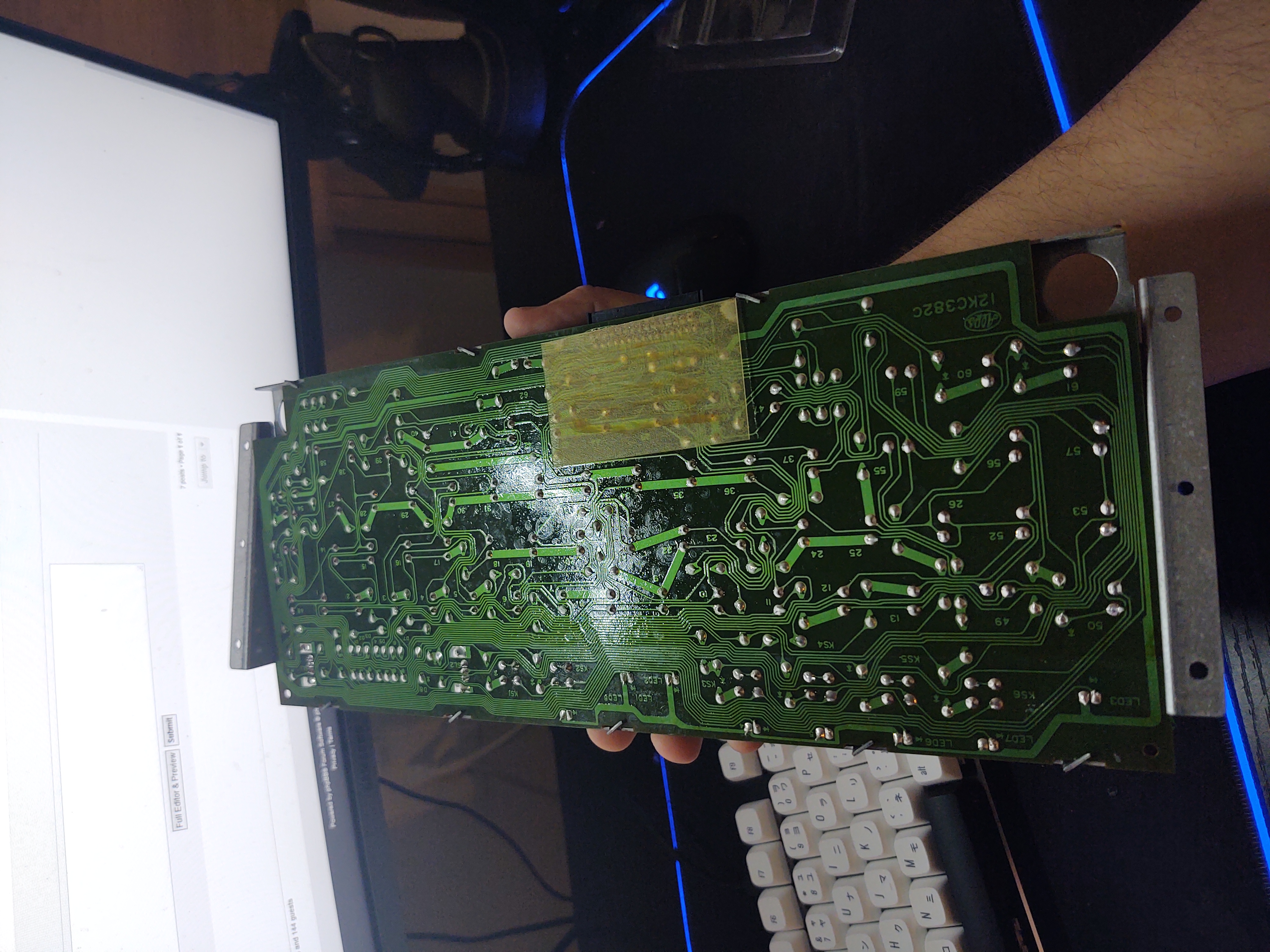

Looking at the back of the PCB, it doesn't look like the keyboard itself has any brains.
- IMG_20210127_193418552.jpg (3.09 MiB) Viewed 5051 times

So after a bit of looking, this board doesn't have any brains on it. I'm fairly certain the keyboard's matrix is either 8*8 or 9*7. I have a multimeter arriving tomorrow.zrrion wrote: 28 Jan 2021, 00:44 if the switches are clean and feel smooth the only real reason to open them up would be to swap the springs. Personally I find SKCC is easier to open than SKCM, so that is a plus. I need to make a video to demonstrate the opening process as it really is not that difficult.

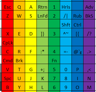

I've got the matrix mapped outzrrion wrote: 29 Jan 2021, 09:32 on the cable that comes out of the keyboard each of the wires goes to either a row or a column (the exception is for the 2 wires that go to the LED). You will need to connect all of those wires to the pins of a teensey. Once they are connected you will need to figure out which pins are rows and which pins are columns (a multimeter is helpful here). With that established you would need determine how the physical keys map to the logical matrix. With that information you set up kbfirmware and it should give you a .hex file to flash onto your teensey. If everything went right you should be able to start typing
The columns correspond to that bank of eight diodes, but the modifiers have their own diodes that lead to those same points
- 2021-01-30 19_00_01-skcc key matrix.xlsx - Excel.png (16.23 KiB) Viewed 4803 times
