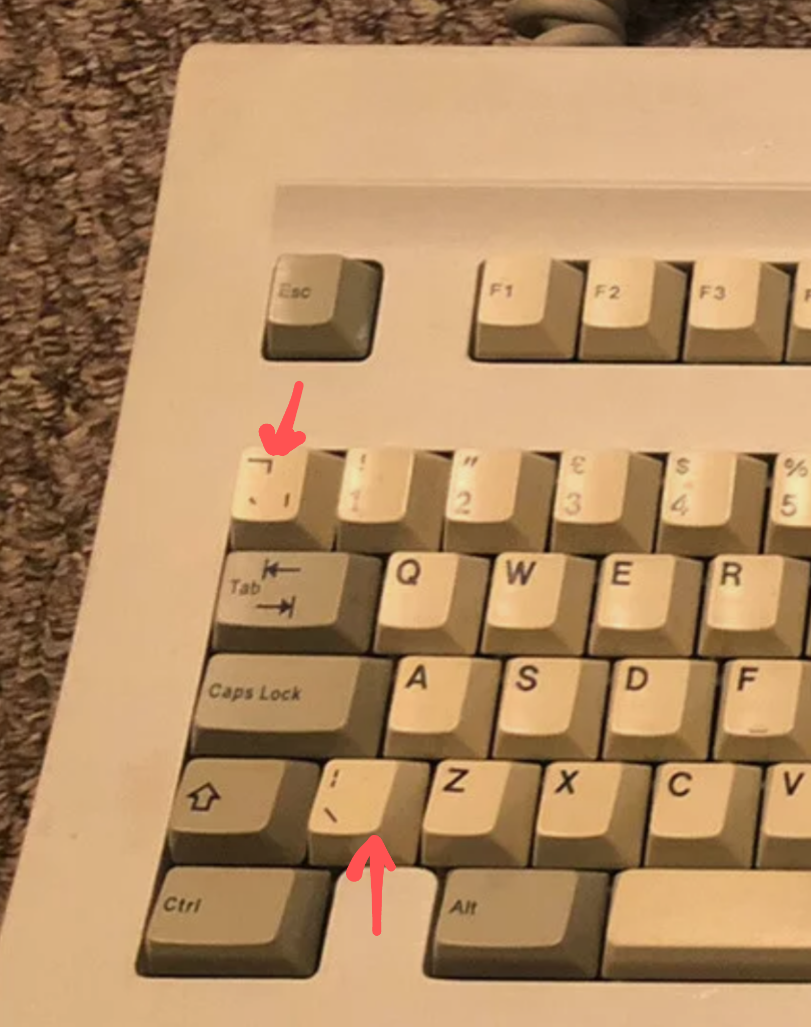

You know on a Mac, when you plug in a new keyboard, it asks you to hit the key to the right of the left shift, then to left of the right shift, so it can identify the layout? Well, the key to the right of the left shift is the backslash on this keyboard, and it doesn't register (either in normal use, or when going through this keyboard identification process). The other key I've marked doesn't register either (I've no idea what the key is called, and never use it, which probably reduces my DT points substantially). All other keys are fine. It seems unlikely, and a bit of a coincidence, that the backslash has a dead switch, so is there a way I can force my Mac to recognize it? The more annoying thing is actually that Shift+2 gives @, not the " that I'm used to, and which is printed on the key. It was actually this which led me to go to Preferences -> Keyboards and start the identification procedure. I imagine this is right up Muirium's alley, but thought a wider post would give others a chance to chip in too!

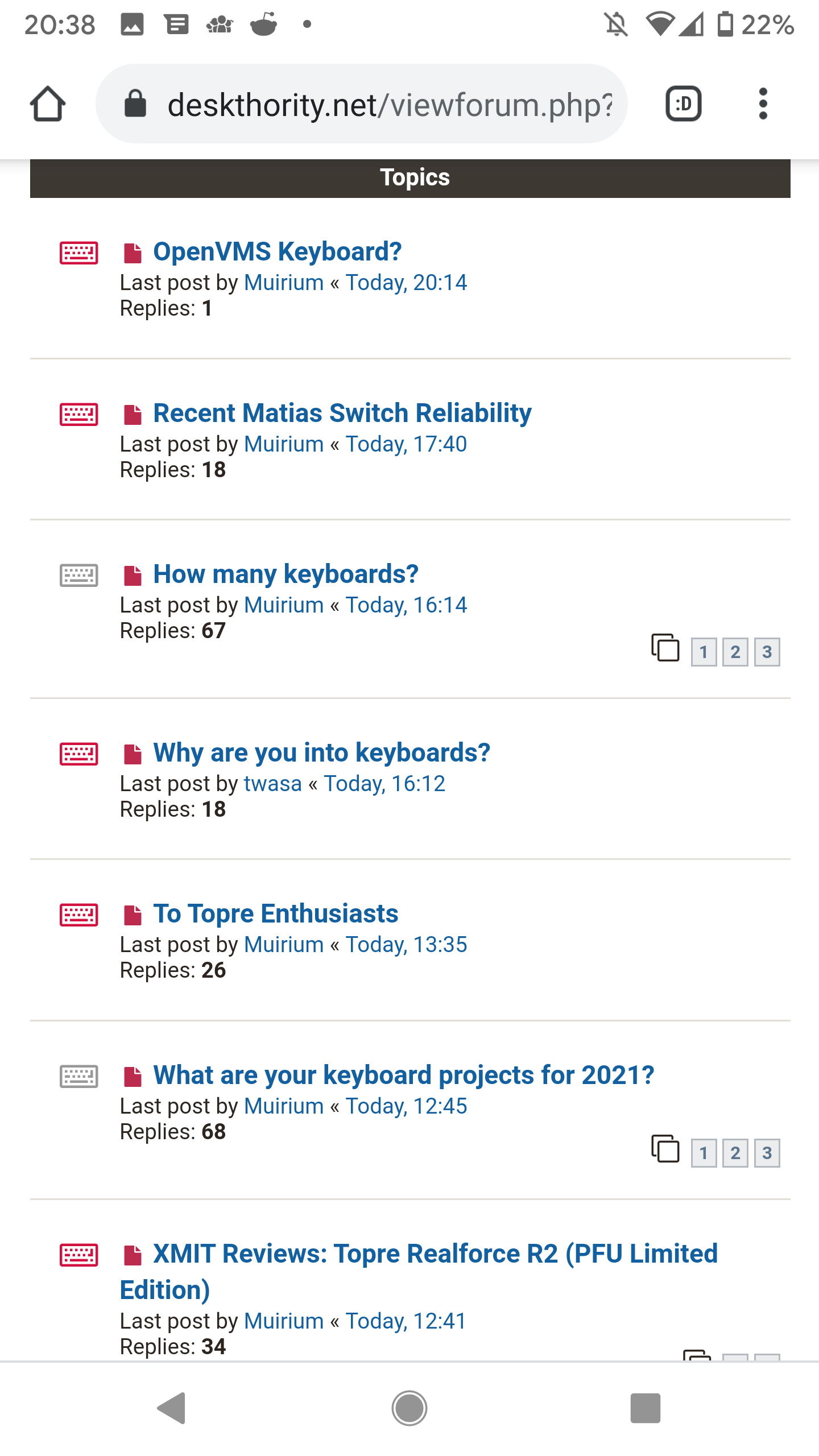

Tsk, only 7 out of 8 last posts on the top 8 topics! :o

Modern Macs only really understand USB / Bluetooth. If it's a protocol thing, it's going to be the converter. Soarer should be able to handle this no bother. If it's a USB native board, however, hmm.
That weird key is "international backslash" in Soarer's docs, off the top of my head. Let me go look it up.
Actually: Soarer calls it Europe_2. The USB HID spec name for it is 'Keyboard Non-US \ and |" and it lies on scancode 0x64. On UK Mac ISO English keyboards, it's a pretty funky looking § and ± key.
I remap my MacBook Air's to backtick / tilde as ANSI intended. One of my many Karabiner tricks I should write up sometime.

Thanks Muirium - my Soarers cable will be arriving soon which I'll then use instead of my current £3 PS2 adapter. However, the non-registering of these two keys is still puzzling.
19 Mar 2021, 23:59
Good chance all keys will work fine with Soarer. It sounds more like a converter thing than a keyboard thing.
That XT/AT switch, though: that one's the keyboard's error!

Oh, absolutely. There may even be nothing wrong with the board (besides that goof with the XT/AT switch) and your missing keys are no fault of its own.
