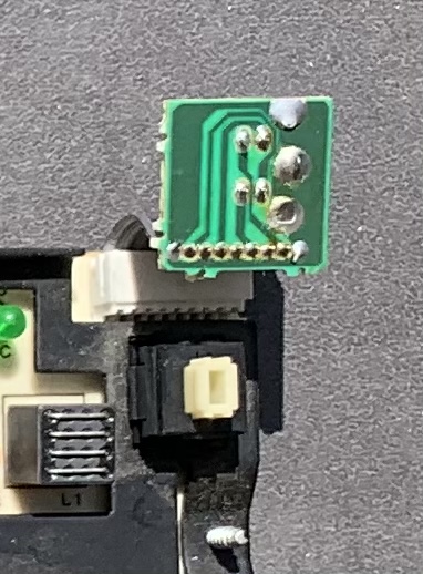

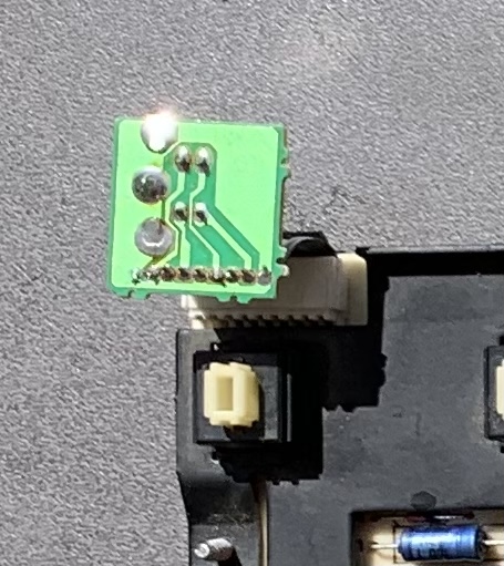

I’ve checked with the pictures of the cleaning of my AEK II. The daughterboards aren’t identical.Muirium wrote: 13 Apr 2021, 13:41 Can't remember if the daughterboards are identical or mirror imaged. It's been a while. They are at least very similar.
