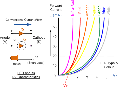

The forward current parameter does matter, but I doubt it will be an issue. The forward voltage they are rated at is (oversimplification) the voltage they will use when begin to flow current. In a keyboard there will most likely be an resistor to limit the current (you can think of it as using up the extra voltage). A good rule of dumb that I use to set the current for LEDs is (supply voltage (in a keyboard likely 5 V) - the LED's voltage) / inline resistance should be less than the max forward current.
If you want an even simpler rule of dumb (and an even bigger oversimplification) voltage of Voltage of IR LED < Red LED < Amber LED < Yellow LEDs < Green < Blue < White.
*** This is in general not to be taken as gospel ***
So, in general if you replace a lower voltage LED with a higher voltage LED you won't break anything because the current will be lower (worst case the LED will be a little dim). If you replace a higher voltage LED with a lower one you should check what the resulting current will be.

Just about every generic LED that I've ever seen has been good up to 20 mA and that should be enough to drop in for just about any other since companys rarely configure their circuits to push the max current. Even if you go over that, the LED will be fine for quite a while but will have reduced life. The reduction in life is proportional to how far over the maximum forward current.

So blue LEDs and white LEDs take up more power? Makes sense, given how excessively damn bright they are. I thought it was just an efficiency thing.
The longer wavelength colours—red, amber, yellow—are so much easier on the eyes. I suppose a simple swap from a modern blue to a modern red LED would drive the red real bright. Hmm.
