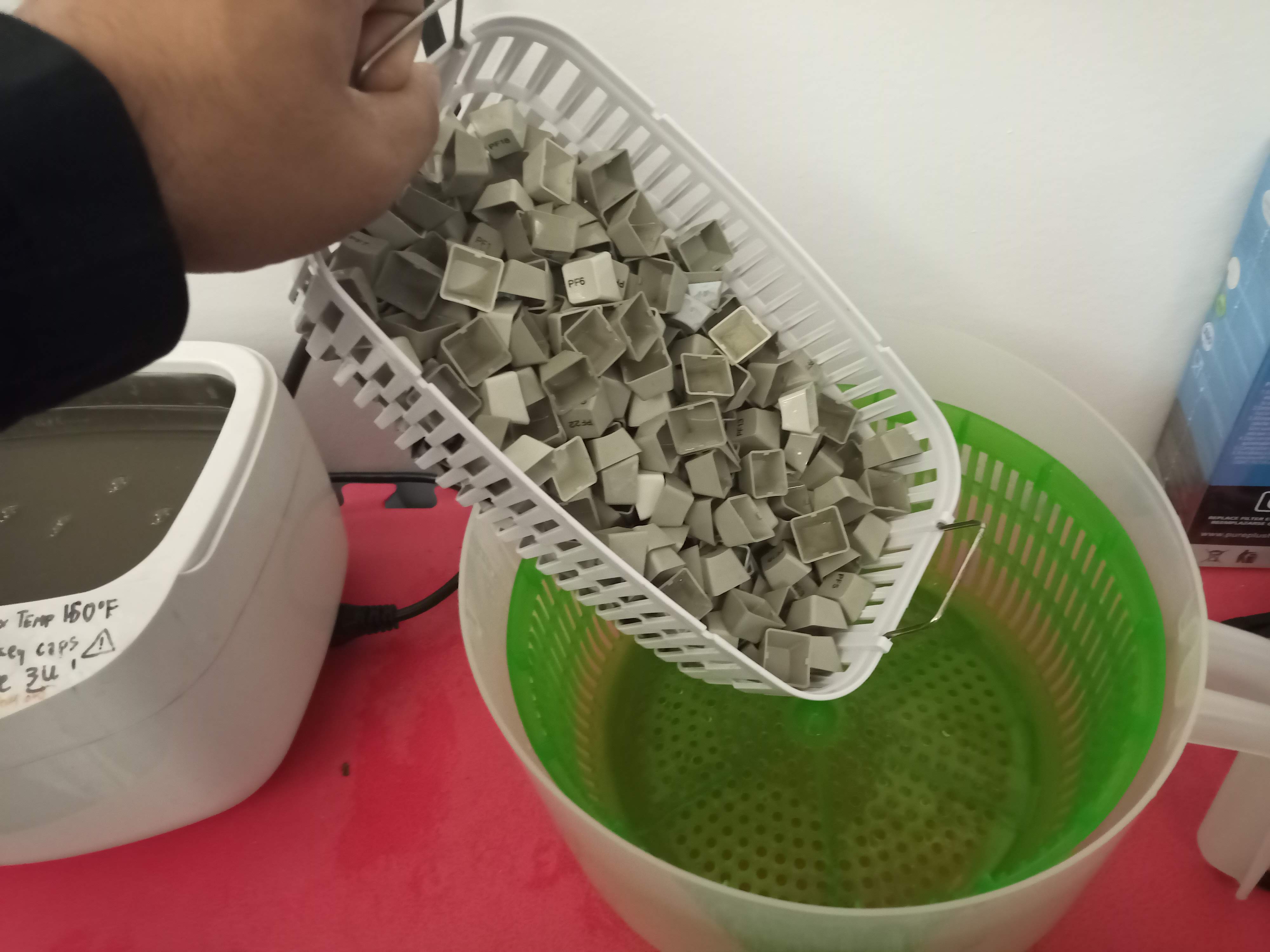

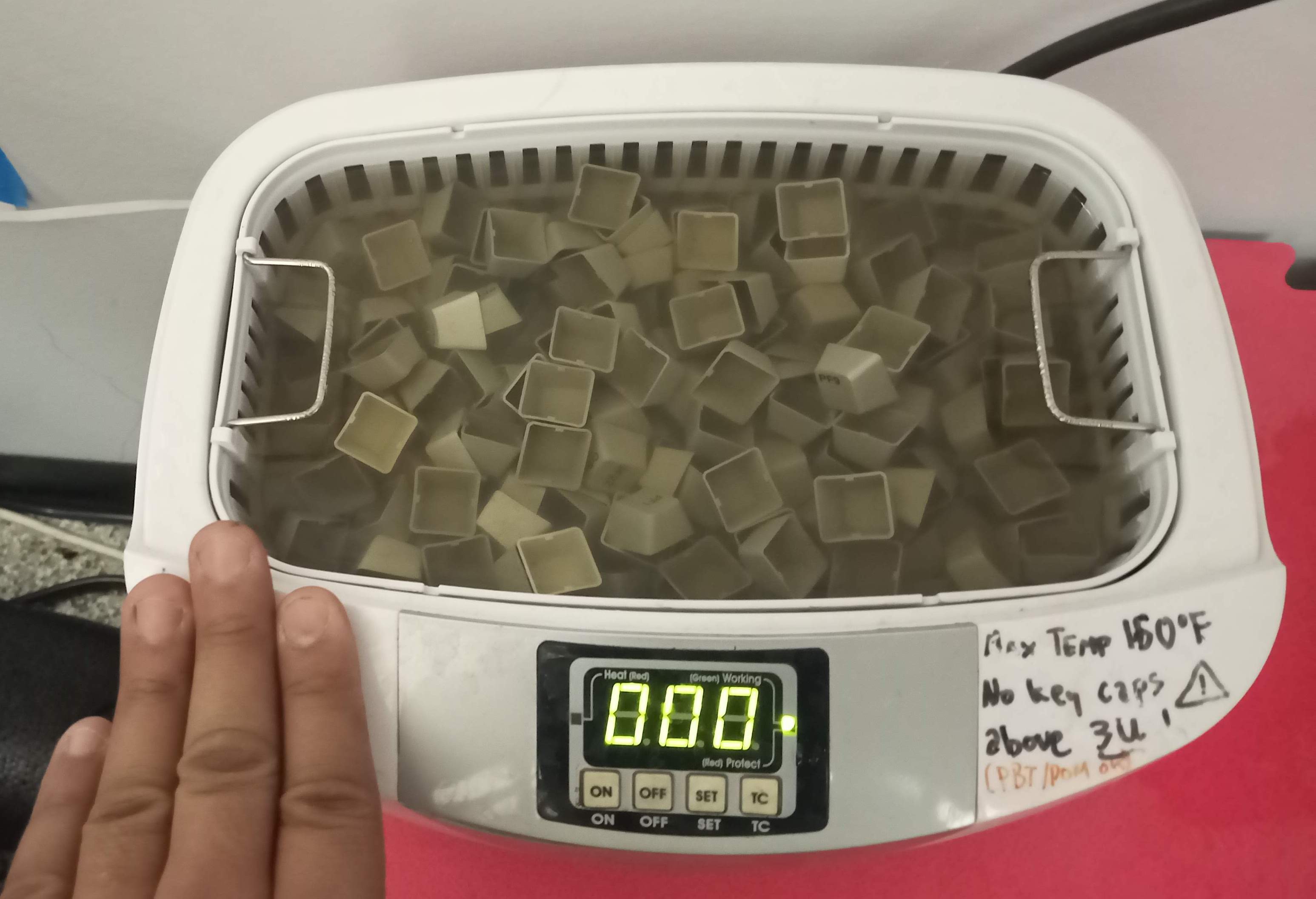

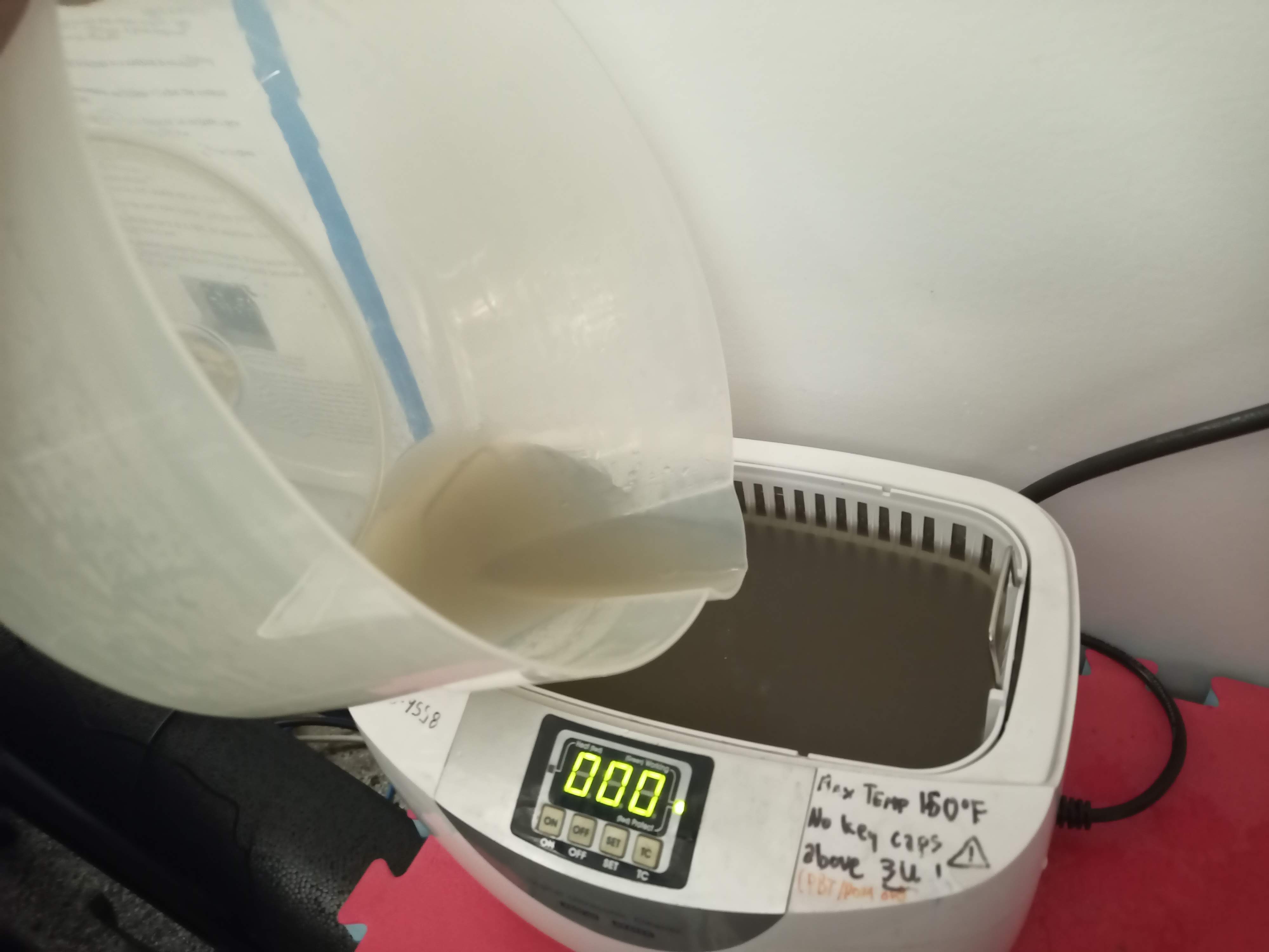

First, run key caps through the ultrasonic cleaner in the usual fashion. For PBT key caps I turn on the heat and run them for about 15 minutes total. I gently agitate a few times to help get some of the dirt moving.
Dump them out into the salad spinner:
, and spin dry. The dirty water goes back in the cleaner - even with this level of dirt it does an excellent job cleaning.

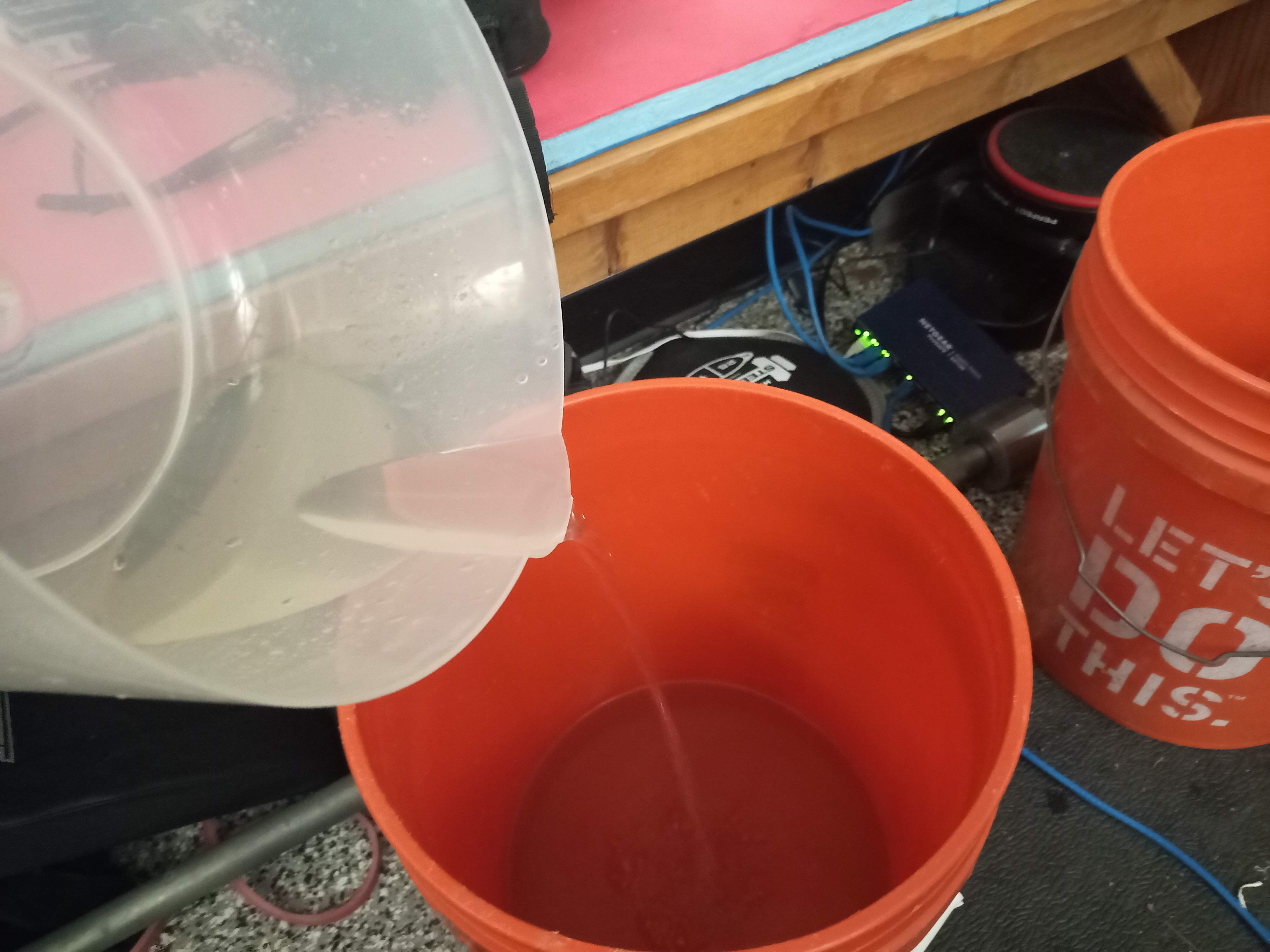

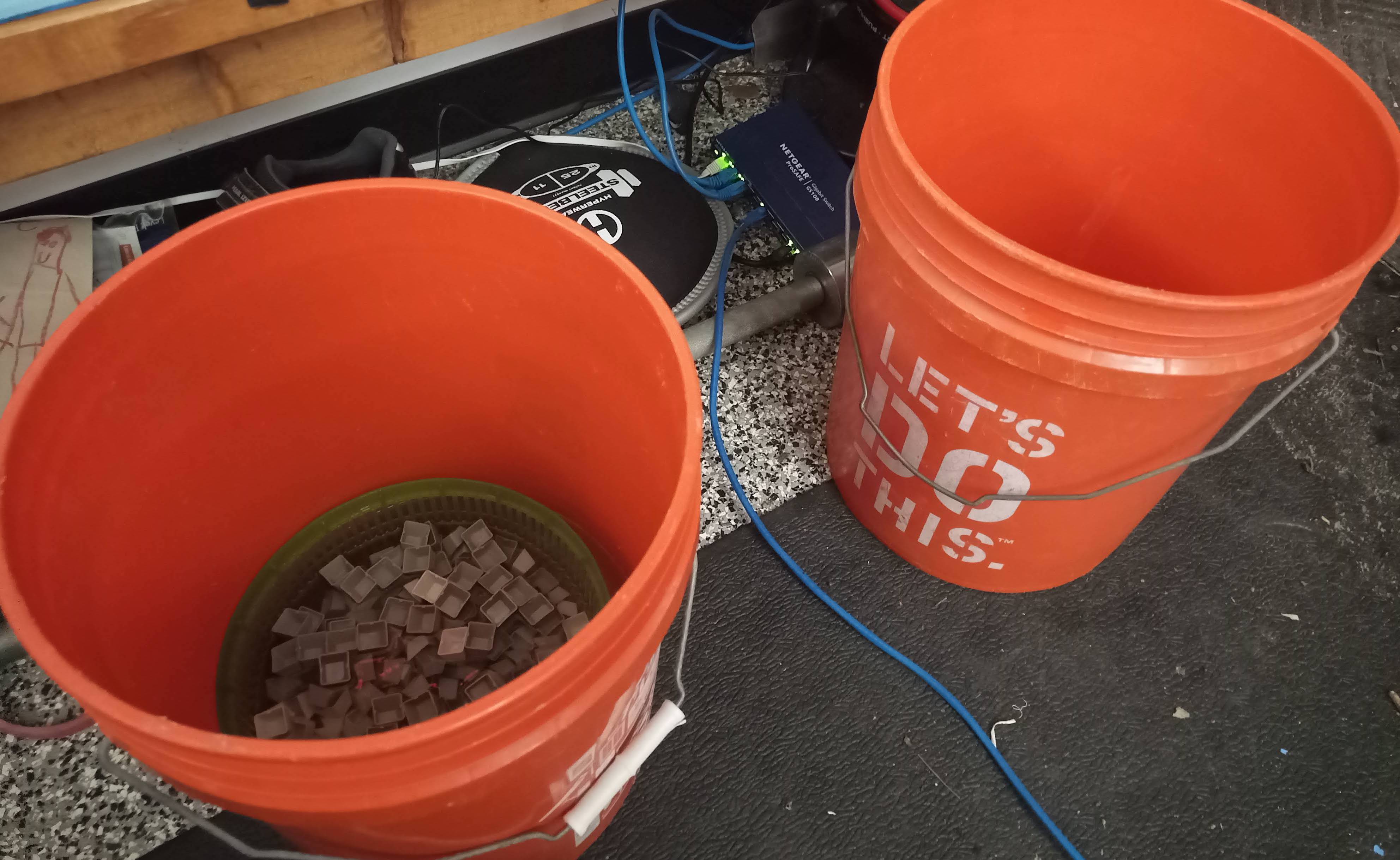

The key caps go through a rinsing pipeline: first in one bucket, then spin dry. Water goes in the first bucket, key caps in the second.
When transferring key caps to the second (cleaner) bucket, dump the water from the spin dry back into the first bucket.
Repeat: remove key caps from second bucket, spin dry, return water to second bucket.

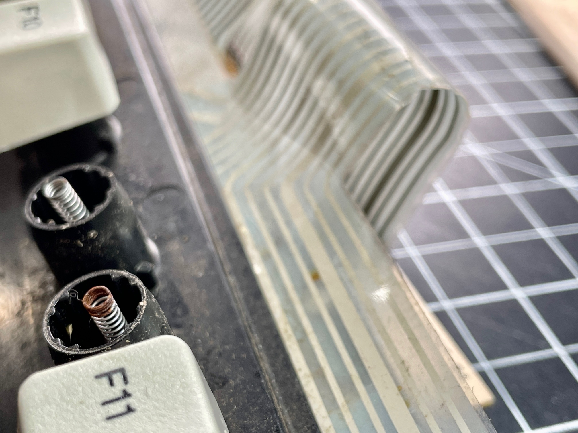

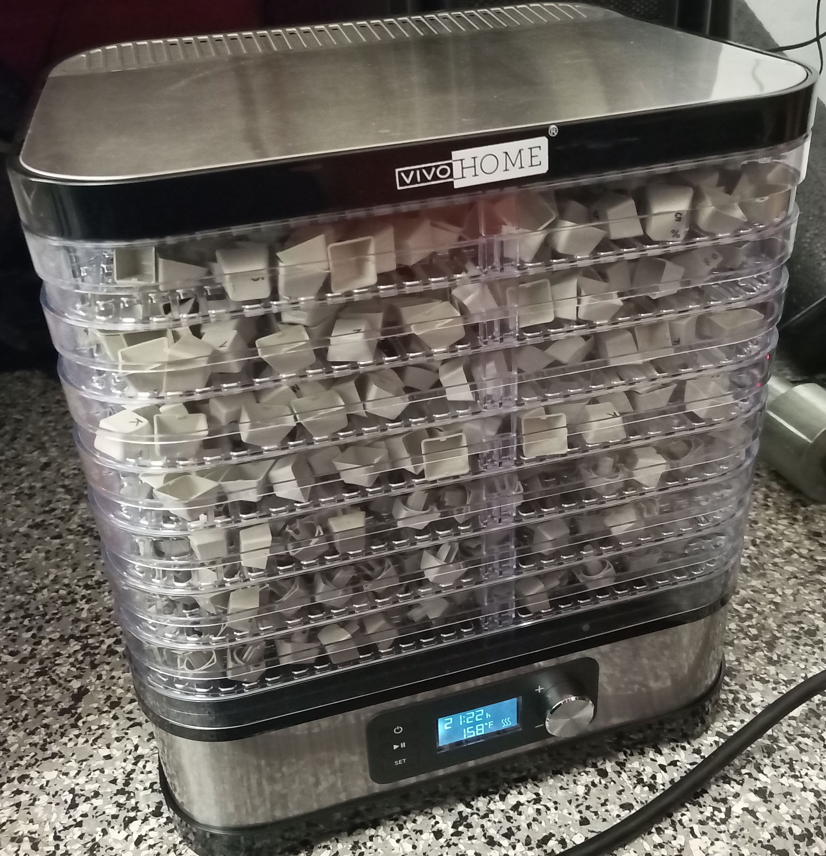

The real trick is drying! I struggled to find a solution for years. After all, the undersides of buckling spring and Cherry MX key caps have plenty of places where water can hide, eventually ruining springs. We need to get the keys completely dry. But how? I used to use a fan, towels, and time, lots of time.
But, then it hit me: food dehydrator.

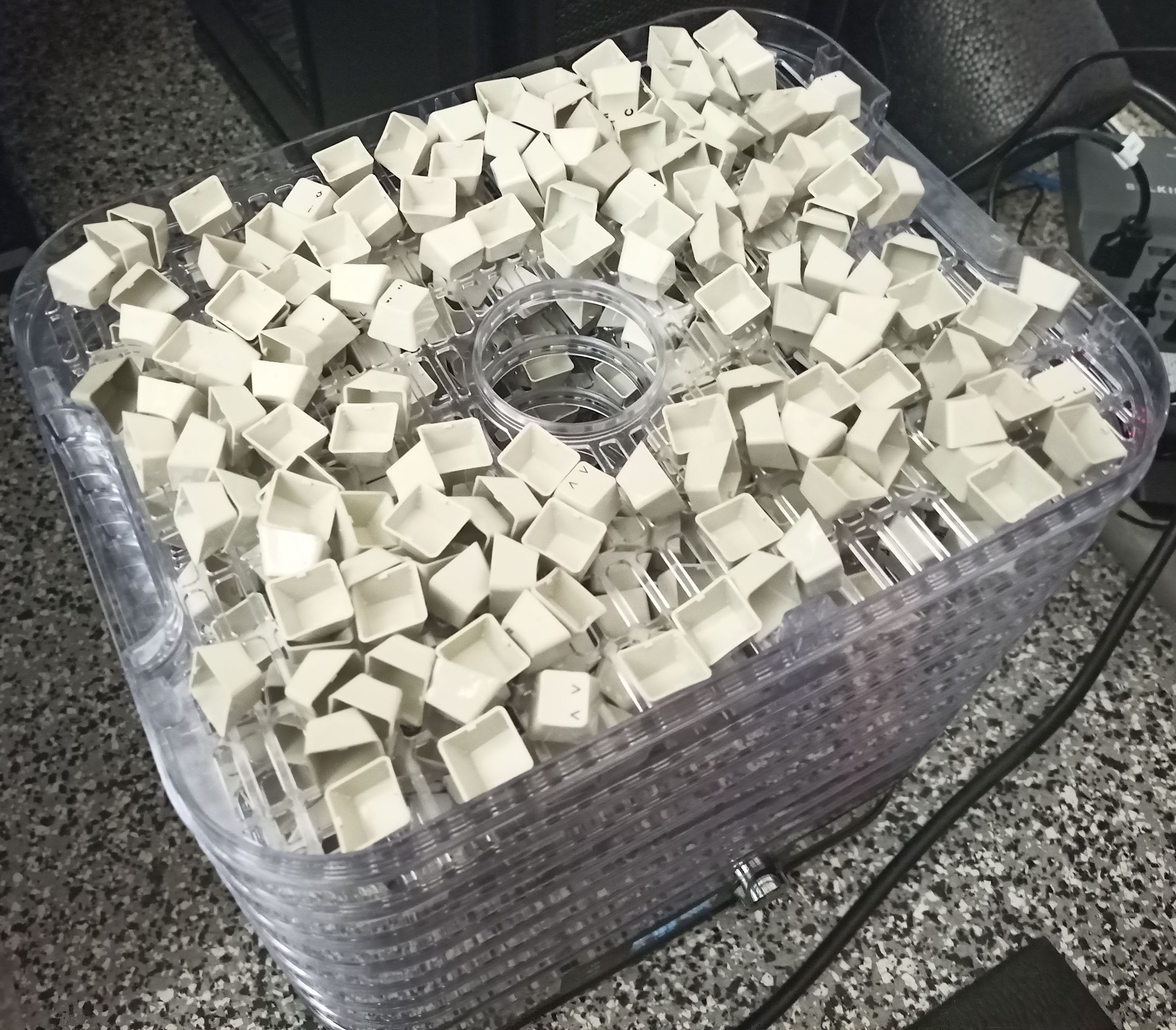

Each tray holds about one ultrasonic cleaner load of key caps. Perfect!
Key caps take an hour or so to dry. By the time the racks are full, we can loop back around and start pulling dried key caps from the dryer, keeping the chain going.

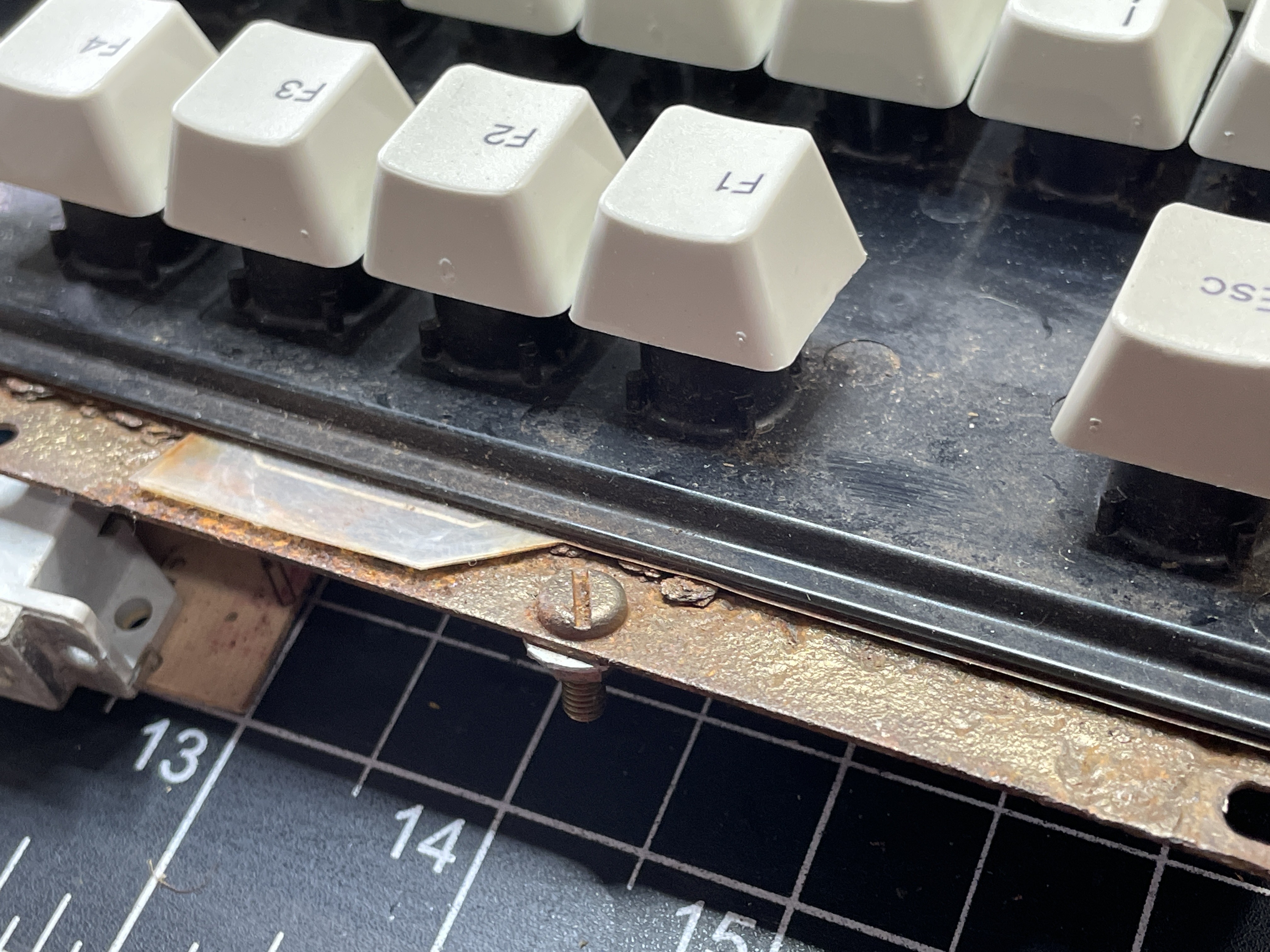

It is important that when ultrasonic cleaning or water submersion of the model M key stems to get out all the water removed from all the points where the plastic and metal are in contact.
I have seen too many cases of previous owners who followed an urban myth and "washed" their model M keyboards literally inside a kitchen dishwasher. While it might clean the external surfaces, there are many internal crevices where water will infiltrate and rust is inevitable. (Then requiring a complete teardown, conductive circuit-layer replacement, buckling-spring replacement, bolt mod to reassemble and save the model M keyboard from the landfill).

The dehydrator runs at about 60 C which is well below any temperature that can harm PBT plastics. If you were to leave them at this temperature for weeks on end it's possible the dye sublimated legends would start to bleed. I've not seen that with this drying setup.

It's not about the influence on key feel. It's about the fact that even a trace amount of water, with nowhere to go, will corrode galvanized steel springs.

vvp wrote: 01 May 2021, 19:22 Trace amounts of water will evaporated from a keycap very quickly. It will not corrode anything. It will not get into contact with springs or contacts [...] Well, maybe you have some switches which have metal parts directly touching keycaps. You have some point in such a case.
This post was directed squarely at buckling spring (IBM Model F and Model M and similar e.g. AT&T) key caps, which are a worst case in several ways. They have an area with a very high surface area to volume ratio on the underside of the key cap where water tends to collect and is difficult to see. They have two piece caps with an area between the cap sections that can wick and store water if not split. If split, there are double the key caps to dry. Plus, there are several readily exposed and minimally protected steel pieces - springs and plate - inside the case. clickykeyboards' post showed this pretty clearly.
