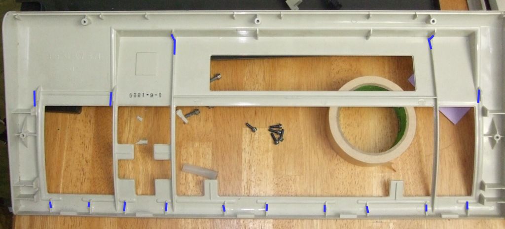

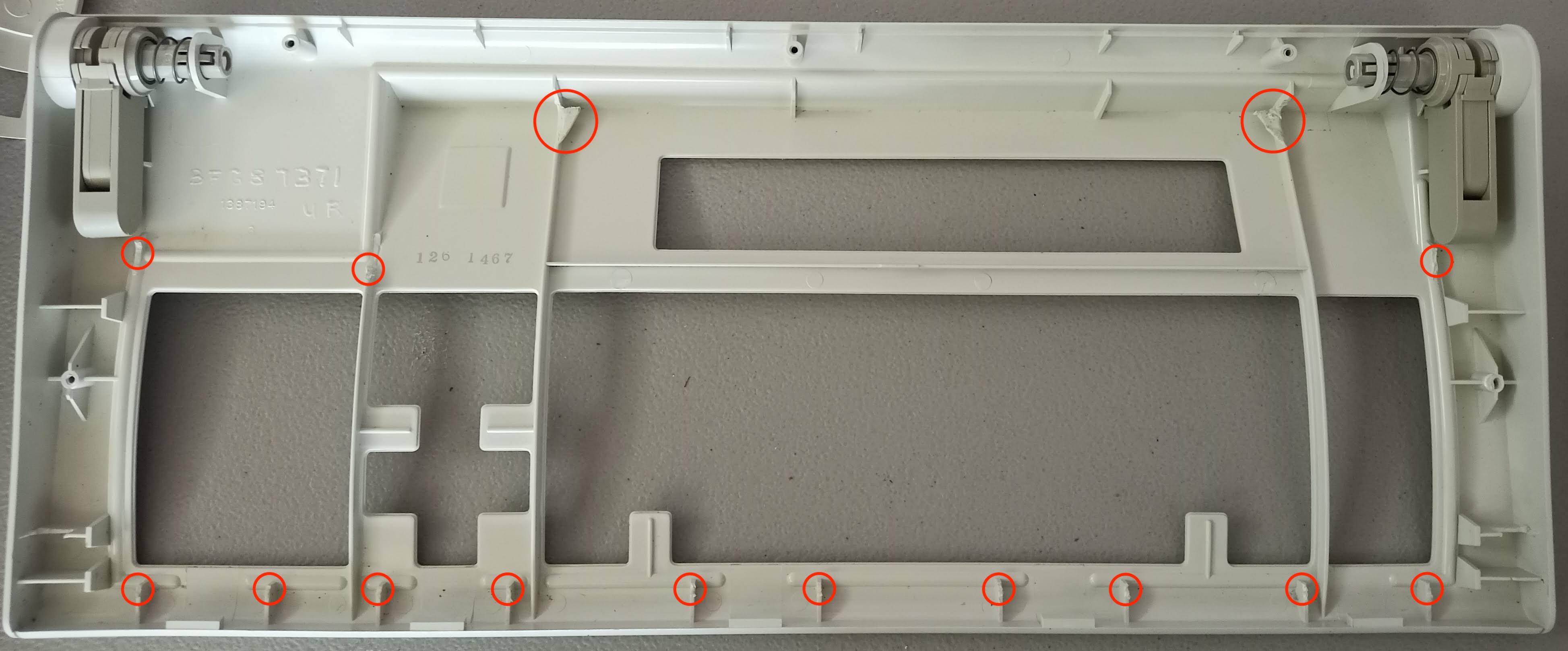

3. The M122 has additional tabs that will interfere with the F122 internals. It is necessary to remove these. I was able to remove (or possible fold over) the tabs at the specified locations using a pair of lineman's pliers.
4. Re-assemble the F122 using the M122 top case and three M122 bolts.

This works. I have done it more than once, and I don't remember there being that many interference points..
I believe that wcass pioneered a similar technique that will work with even a later generation M-122 case.
https://geekhack.org/index.php?topic=45 ... #msg939658

It looks like wcass caught the same interference points I did.
I still have a few F122s to sell with cracked cases. I'll be modding them with new top cases from donor boards.

He is using a later-generation shell.
It has been a long time, but I seem to remember that with a 1st-gen case less cutting is required, but my memory is not what it used to be ....
