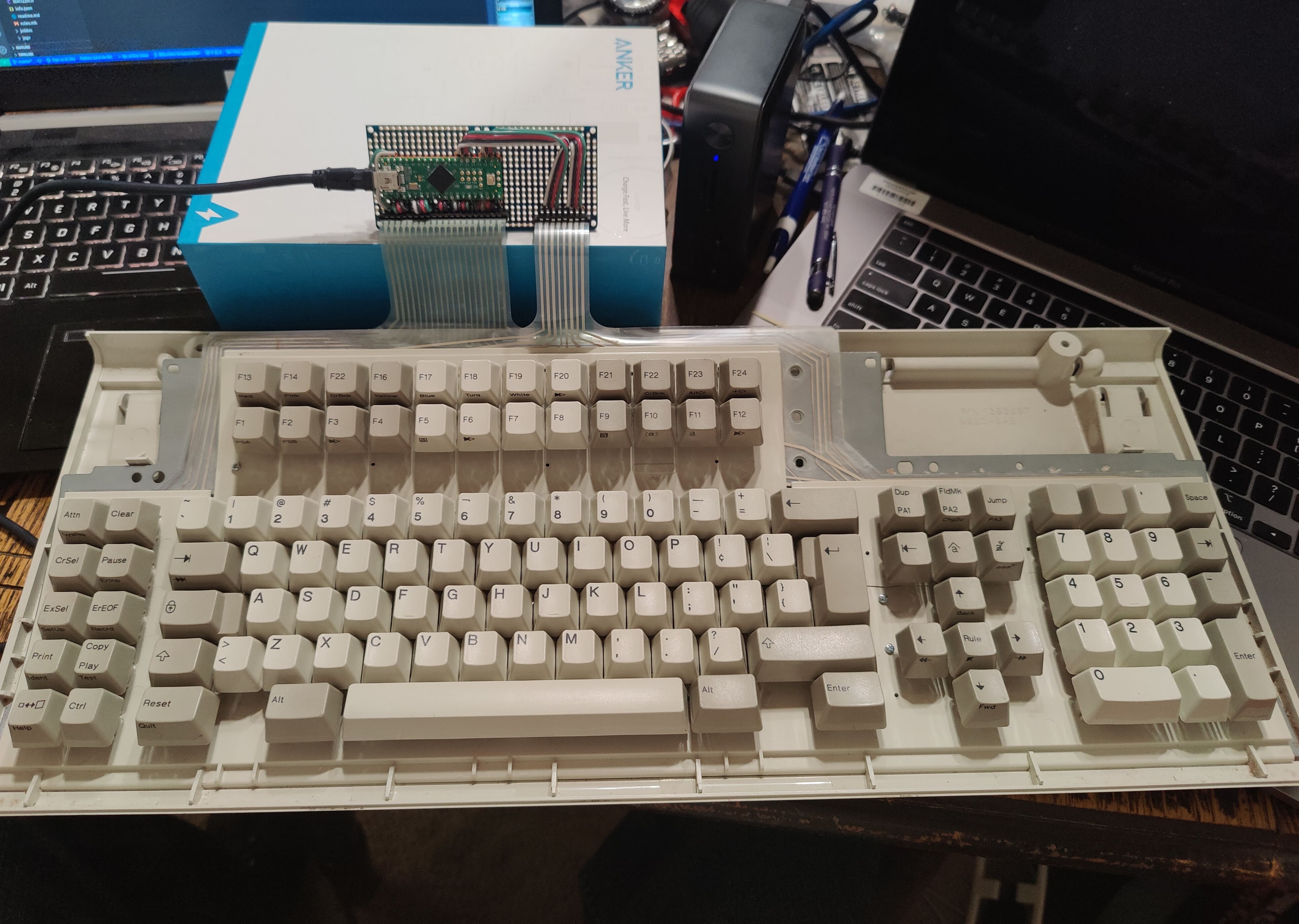

IMG_20210531_125519 (1).jpg (1.13 MiB) Viewed 3506 times
It even works with QMK! Well, mostly: the right arrow in the cluster, the home key in the cluster, and the keypad enter keys do nothing. (And yes, they're all mapped to something in QMK.) I'm not going to worry about it right now, since I know I'm going to be stripping it down and replacing the barrel plate anyway. That protoboard isn't my prettiest work, either, but it'll do the job. I might get adventurous and see about getting PCBs made.
But it's (mostly) working, yay!
zrrion
31 May 2021, 21:46
Yeah, my first bolt mod was similarly complicated (bought entirely unsuitable bolts and the plate from unicomp wasn't 100% compatible with my M) but my next bolt mod went without a hitch. If you've got another barrel coming it should go much better.
