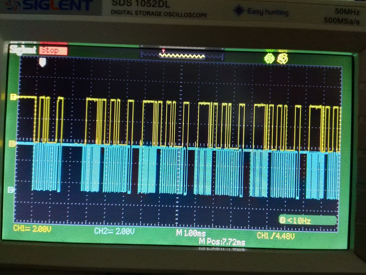

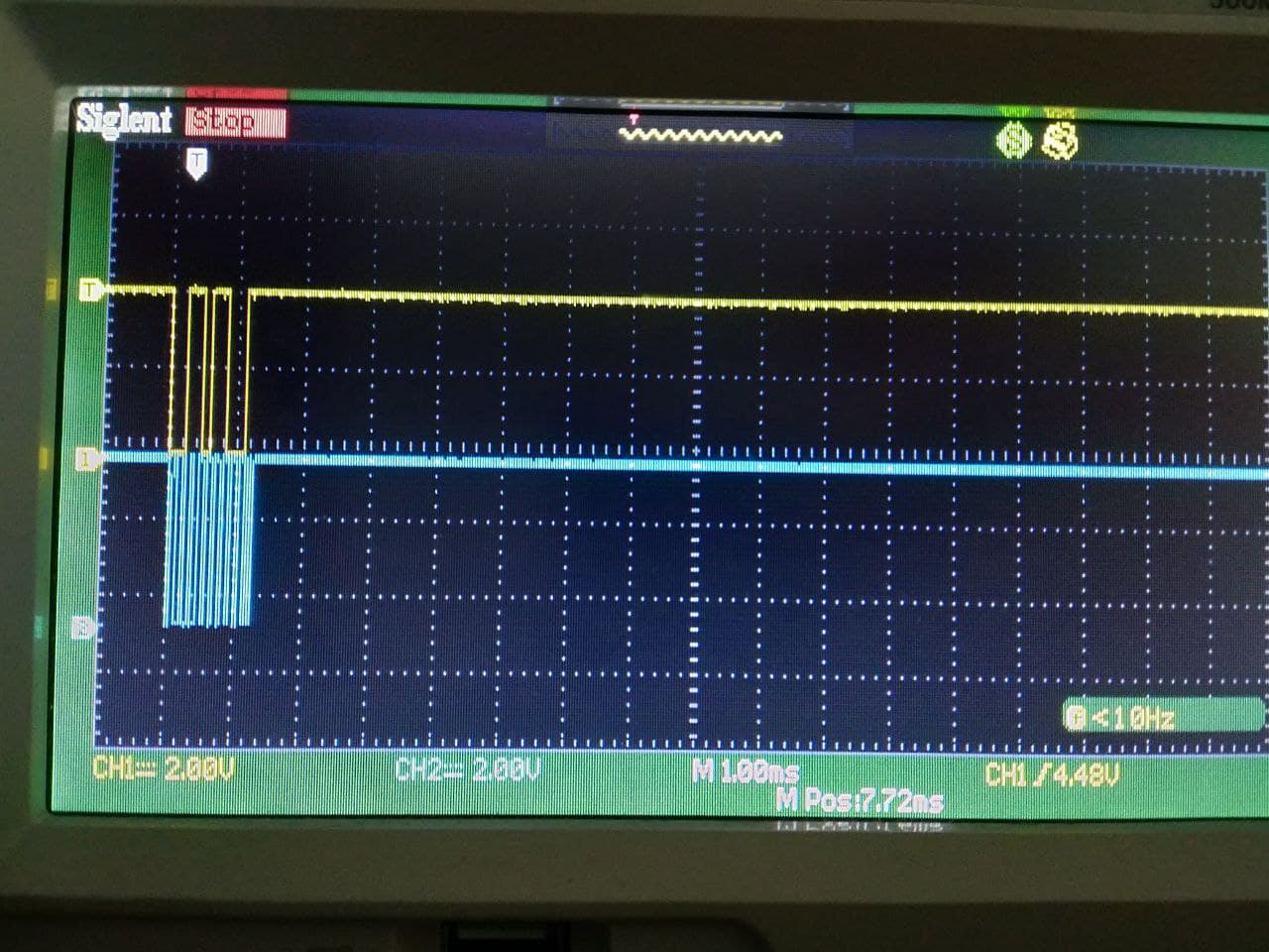

I hooked up the keyboards clock and data output lines to my oscilloscope. Here you can see what a well behaving key looks like vs a misbehaving key.
good
good
bad
bad
If you were to test this keyboard with the xev utility in linux, this would appear as a long delay between the HID press and HID release commands that the computer receives, similar to a held key. But most of the time the keyboard will release before its registered as a hold, basically just a slow key press. Sometimes they will get stuck and flood whatever text box is selected.
Now it seems the good and bad keys are grouped by some row/column configuration. For example, keys 1-4 are naughty, while keys 5-8 are good.

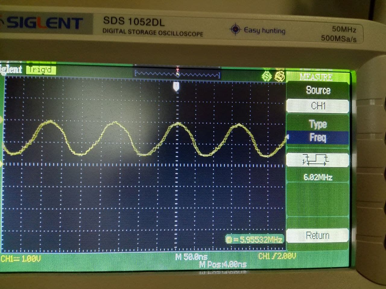

I decided to measure the oscillator circuit to see if that was faulty, sadly its not the case. Almost exactly 6Mhz.
controller oscillator circuit

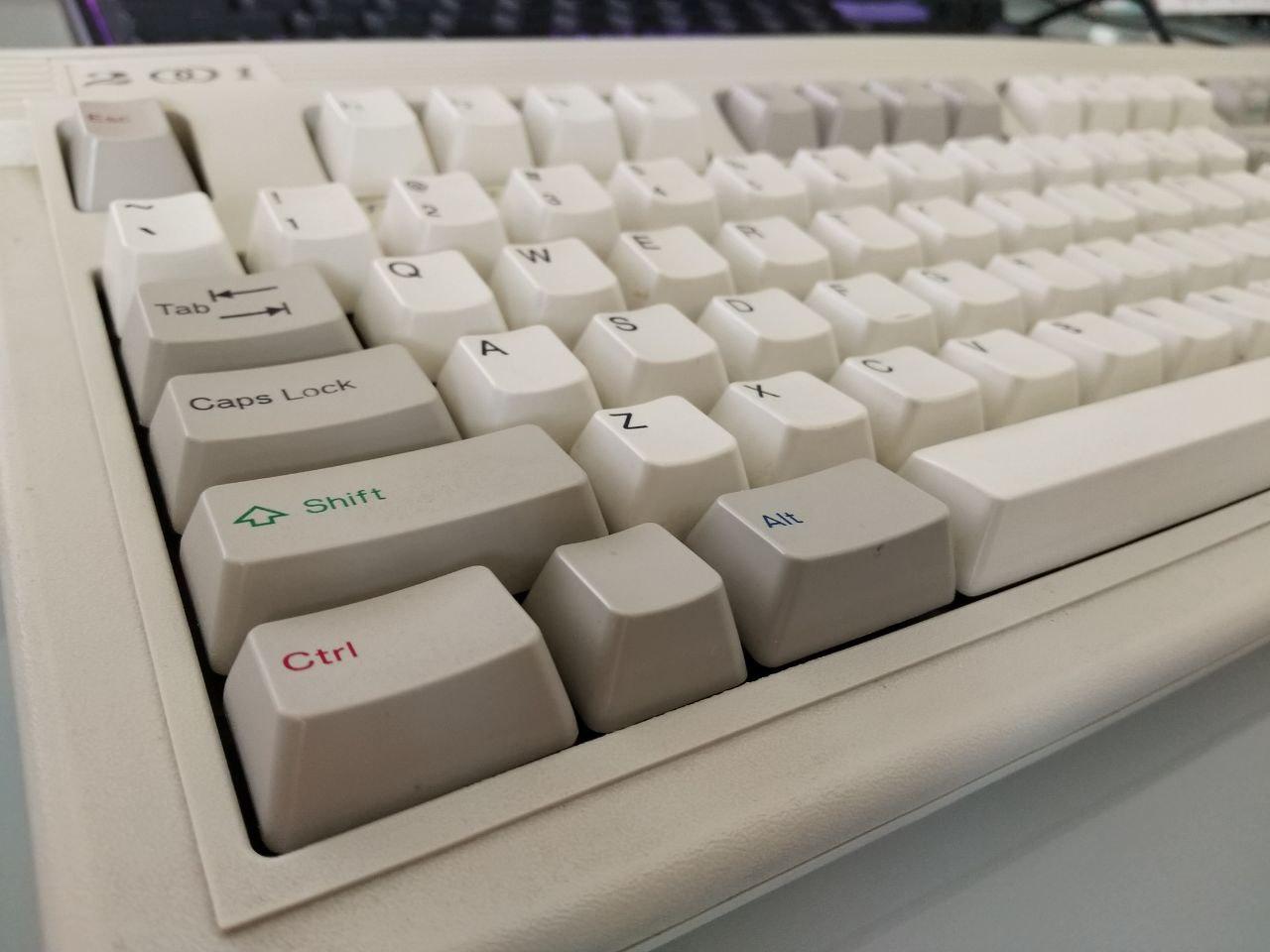

Anyway, here's a couple more pictures of the keyboard.
photo_2021-08-09_19-55-32 (2).jpg (124.1 KiB) Viewed 3633 times

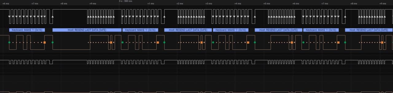

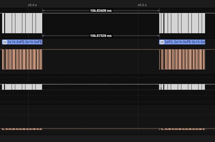

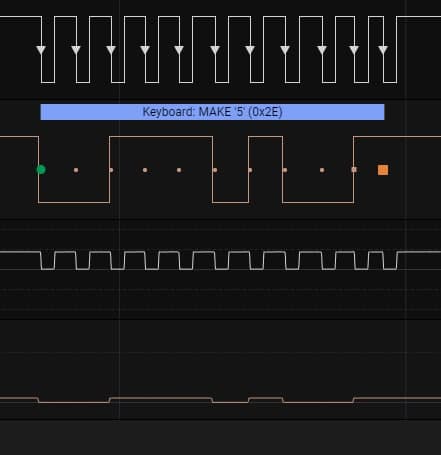

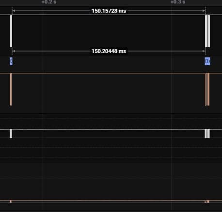

Small update, grabbed a logic analyzer and decoded the ps/2. Initial findings are somewhat concerning, but also a little confusing.
Here is a sample of a good hit:
good zoomed out
good zoomed out
good zoomed in
good zoomed in
and here's a naughty one
bad zoomed out
bad zoomed out
bad zoomed in
bad zoomed in
As you can see, the noise after the hit is actually the host communication requesting a resend of the last data.
I need to take more data to see if the messages actually are getting corrupted enough the pro-micro cant read them(but the logic analyzer can), or if this is an error on the converters end. I have a spare pro-micro to flash to test it out, its possible this one is just no good.

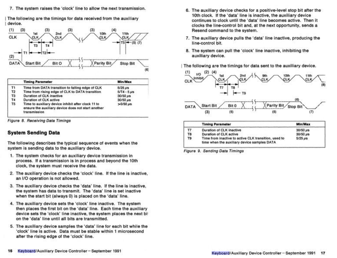

According to the PS/2 timing standard, the clock frequency range of the protocol can run from 10KHzz to 16.7KHz, so a min/max allowable clock period being around 60-100 µs.
I'll upload the standard just for documentation sake.
Now, lets look very closely at the clock line of the keyboard, shall we?
What we have is an uneven clock, with the largest active time being about 20µs too long, and overall increasing the max allowable period by 20%.
This is consistent across the good and bad keys.
So why are there some keys that work and some that dont despite the clock always being screwed up? beats me, I'm going to keep looking into it but something tells me I need to order some fancy tantalum caps with a low tolerance to get this oscillator back on track.

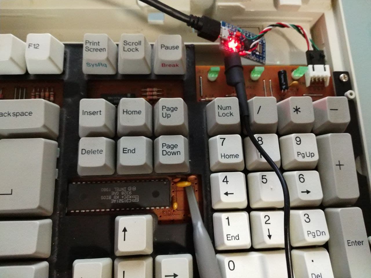

Definitely some weird behaviour. Have you checked that the board is getting enough power? From the pictures is looks like you are powering it off the Vcc pin on the pro-micro. Have you tried powering it off the RAW pin? What about a shorter USB cable/different port?
dualrange
13 Aug 2021, 03:53
jsheradin wrote: 12 Aug 2021, 20:47 Definitely some weird behaviour. Have you checked that the board is getting enough power? From the pictures is looks like you are powering it off the Vcc pin on the pro-micro. Have you tried powering it off the RAW pin? What about a shorter USB cable/different port?
I've tried a few different USB cables and have tried a few different machines.
I did not think to try the raw pin, I was under the assumption that was an input but I just looked it up and it also can be an output. I'll give that a go!
Edit: No difference. The Raw pin and VCC are both putting about 4.6-4.7v. once attached to the keyboard, around 4.5v. I do wish I had a 5pin din -> ps/2 so I could test this sans converter.

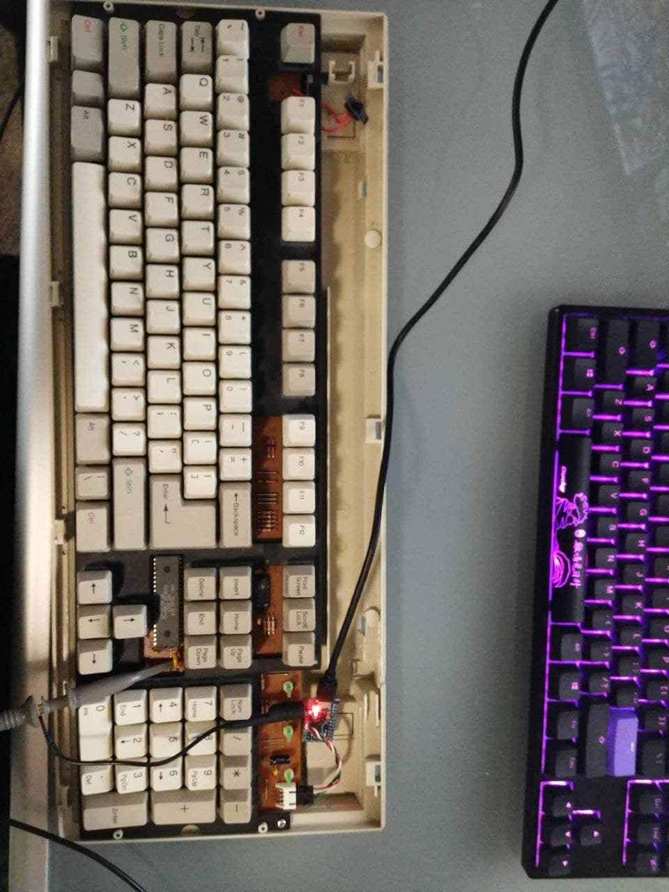

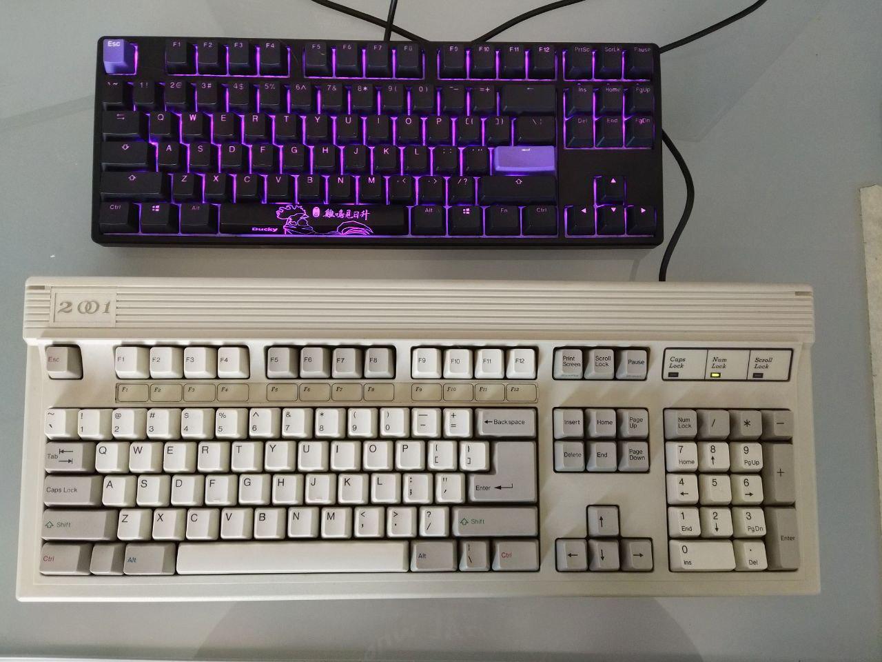

Those cool double shot color coded keys made this all worth it
Next to my  ducky tkl
photo_2021-08-14_15-49-40 (2).jpg (157.76 KiB) Viewed 3252 times
