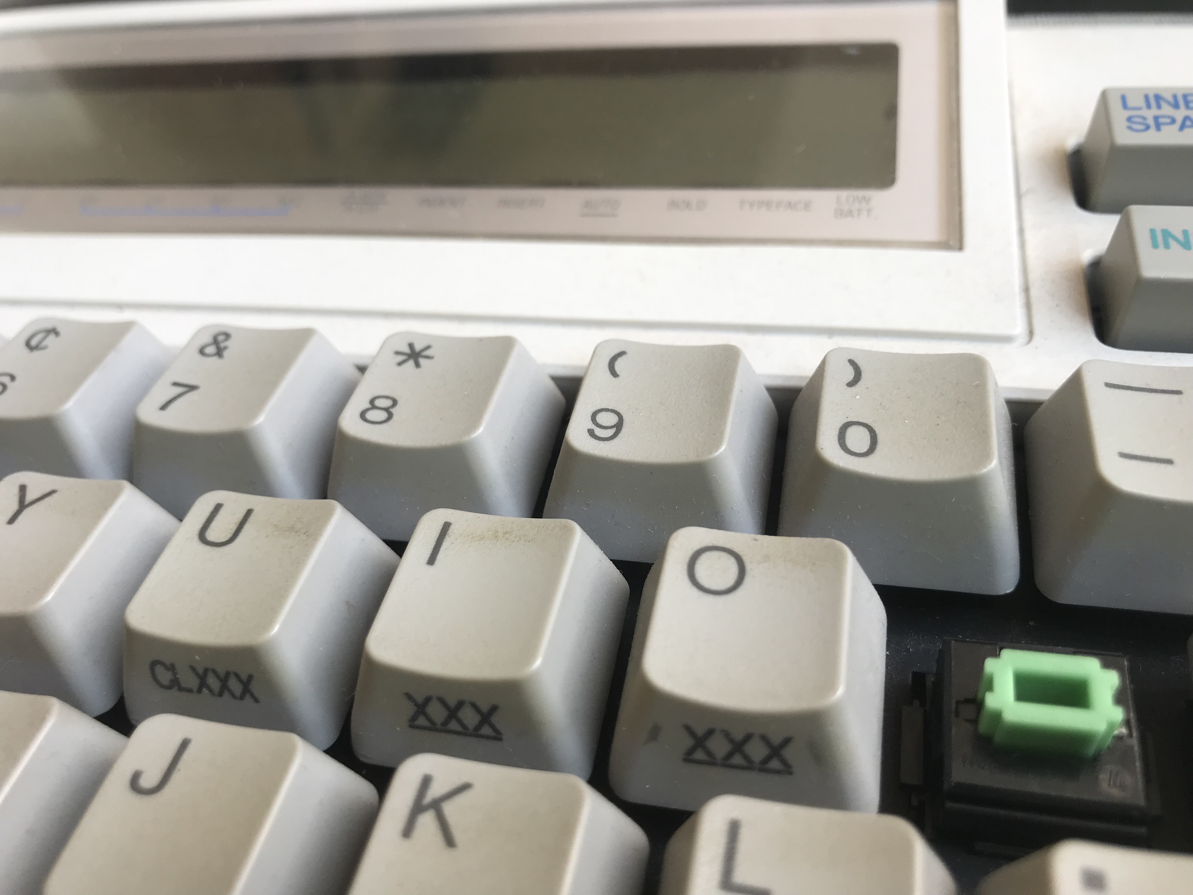

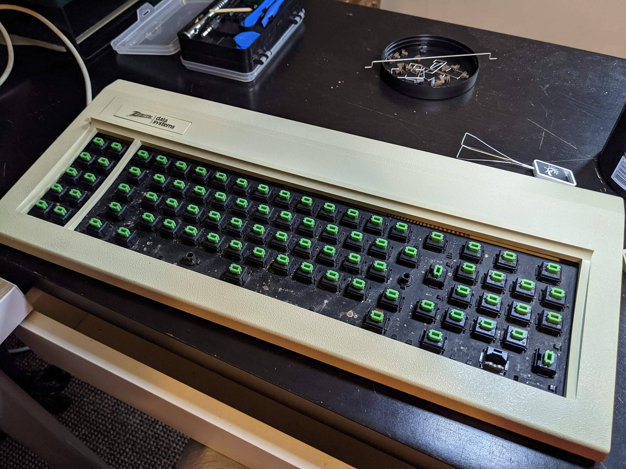

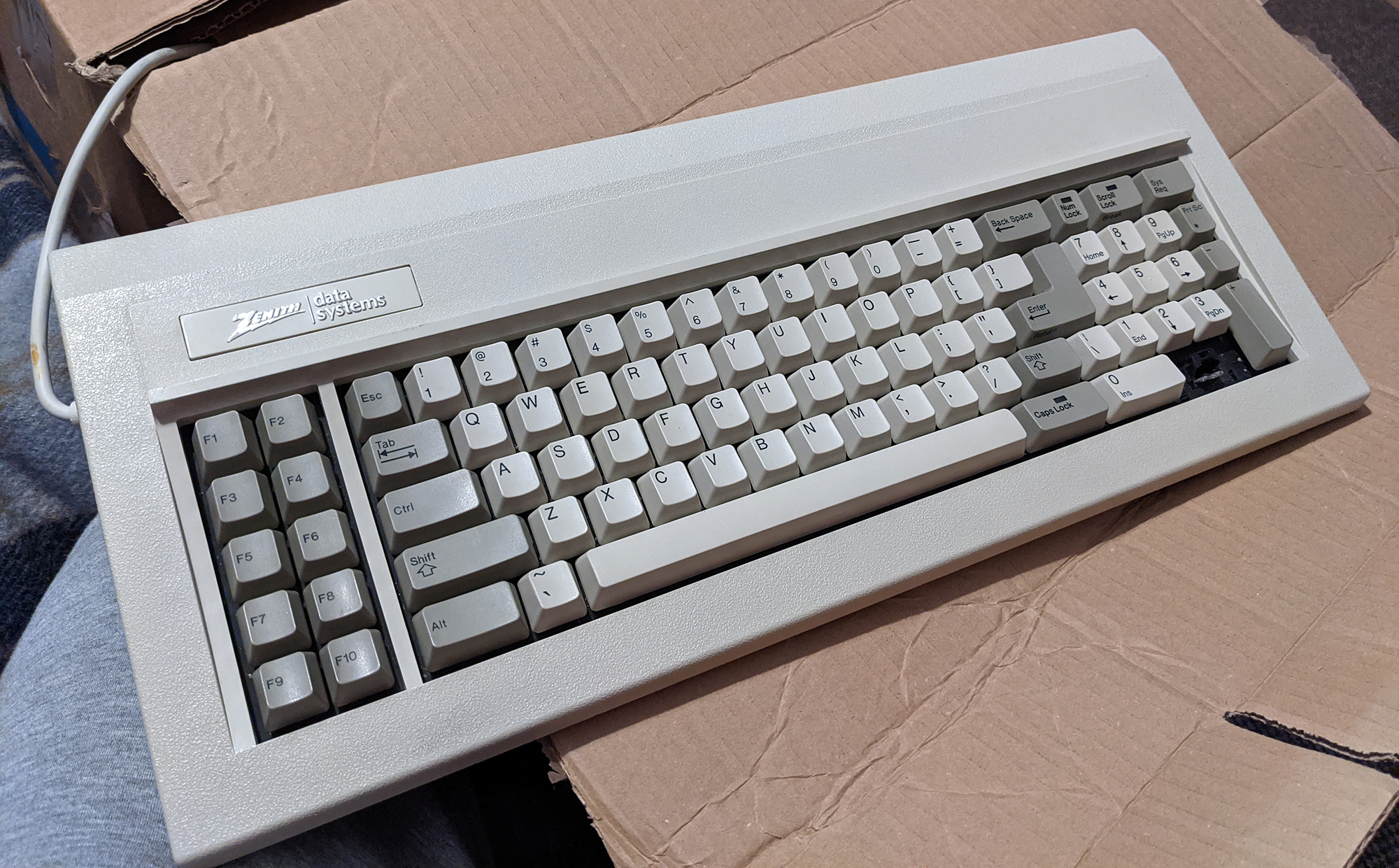

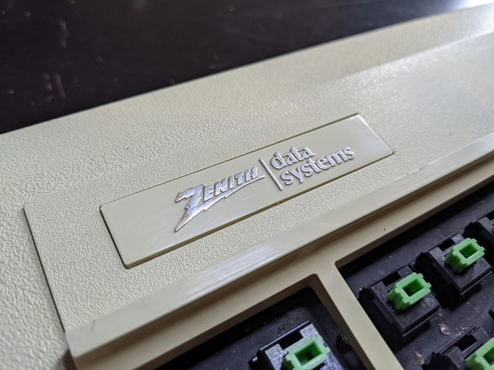

Ello, ello, ello! A fellow DT member very kindly agreed to let his Z-150 go. This maybe the prettiest keyboard I've ever laid my eyes on ...dare I say, even prettier than my FK-2000 Plus!? As far as I'm concerned, I've already reached "End Game" with my HHKB Type-S, Focus and Apex Pro; for key feel, aesthetics/sound and gaming respectively. However, this could be a serious contender in the majority of those categories if I get it right.
Z-150 Main.jpg (1.78 MiB) Viewed 12635 times
Z-150 Caps.jpg (2.13 MiB) Viewed 12635 times
Z-150 badge.jpg (1.73 MiB) Viewed 12635 times
Z-150 Switches.jpg (2.19 MiB) Viewed 12635 times

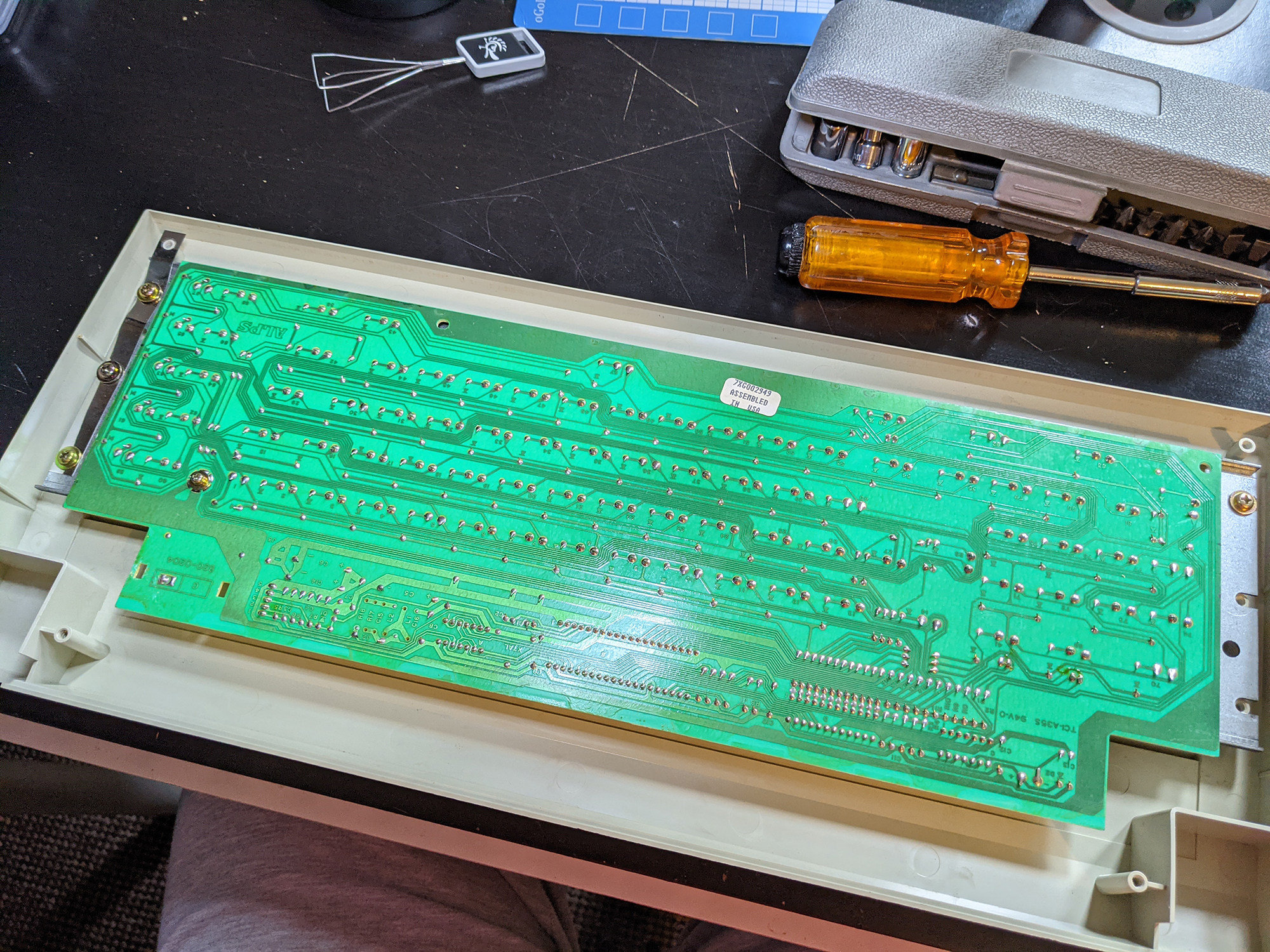

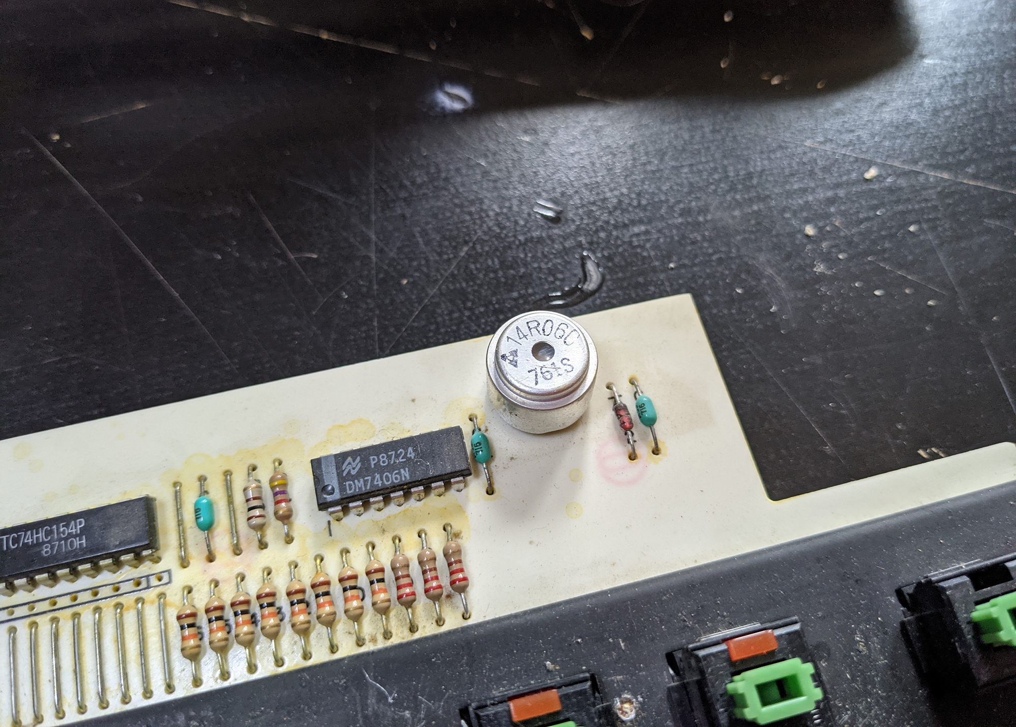

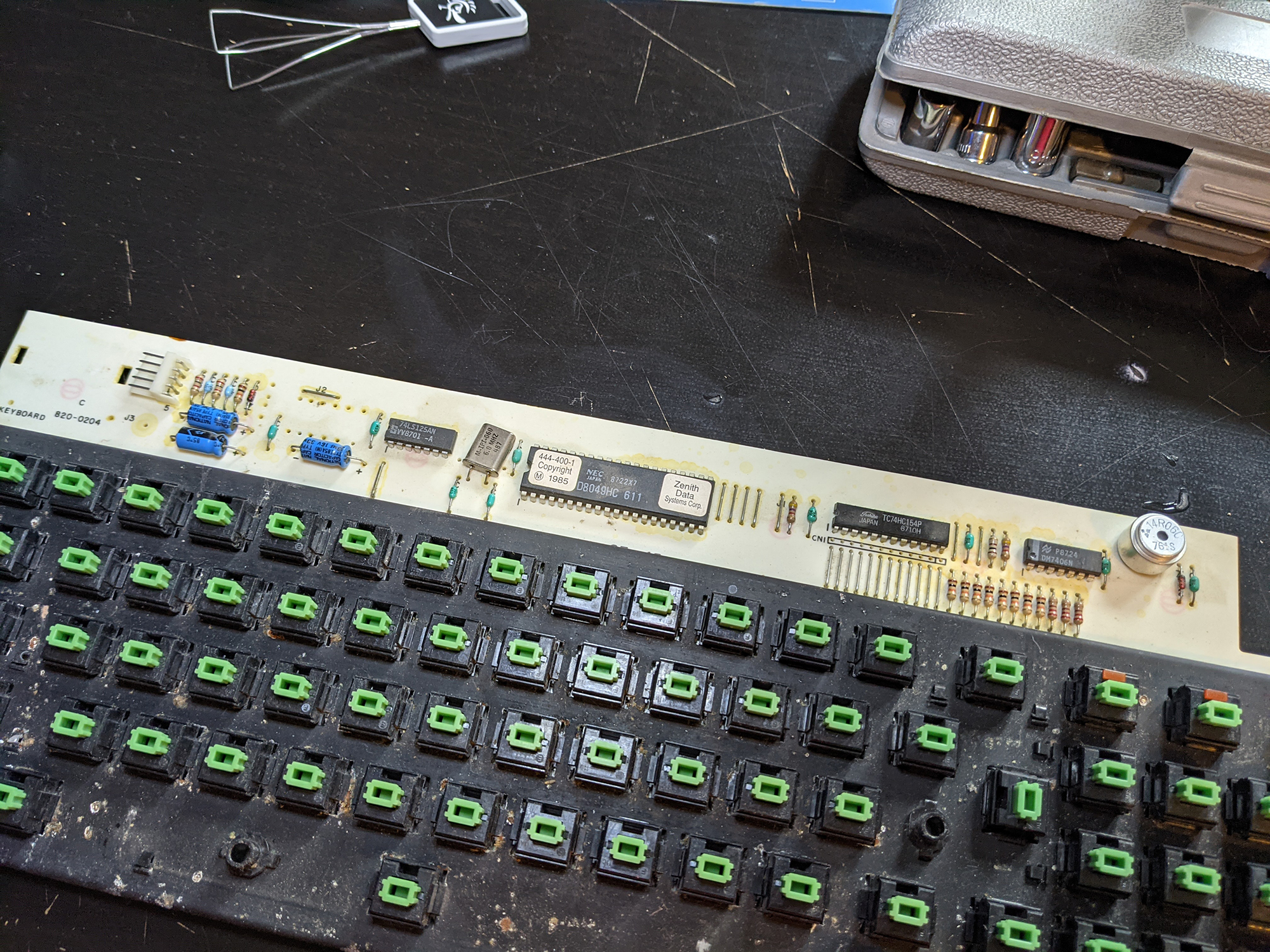

This thread will serve as a point where I can check my thinking with more learned enthusiasts, straight up ask for help and share my experience with anyone else who is lucky enough to get one of these boards but lacks the confidence of dealing with restoring such a thing, like my myself.

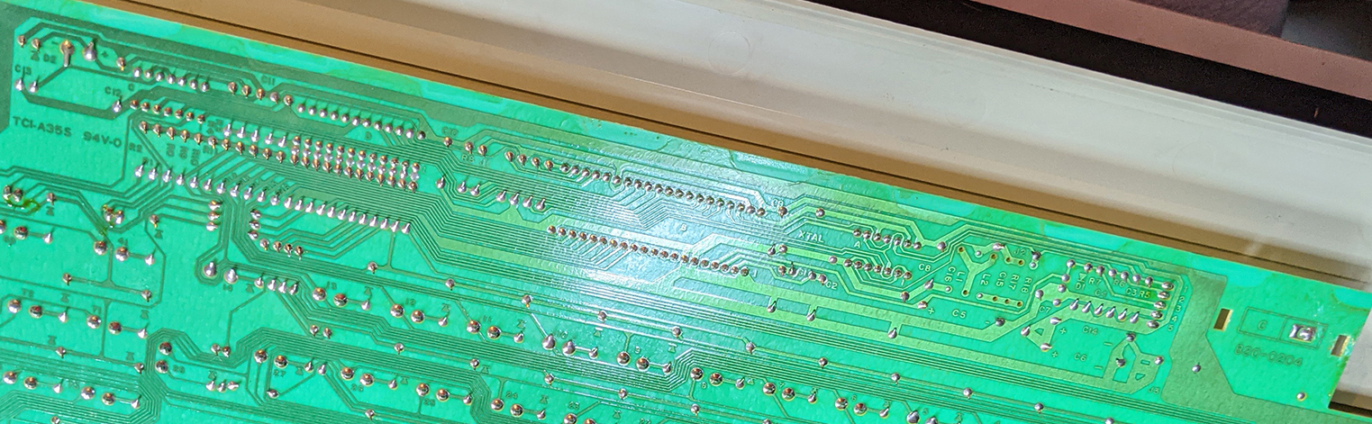

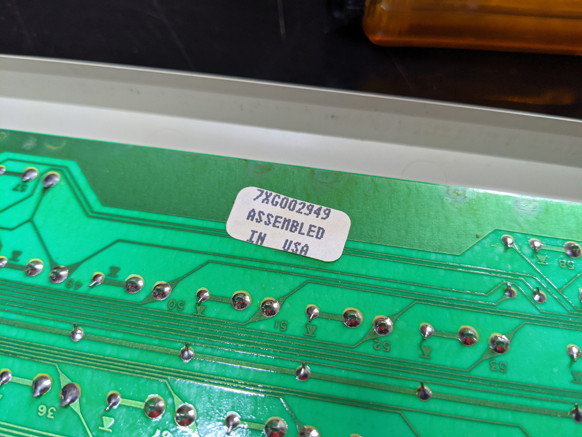

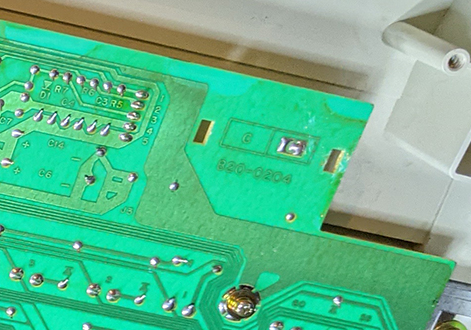

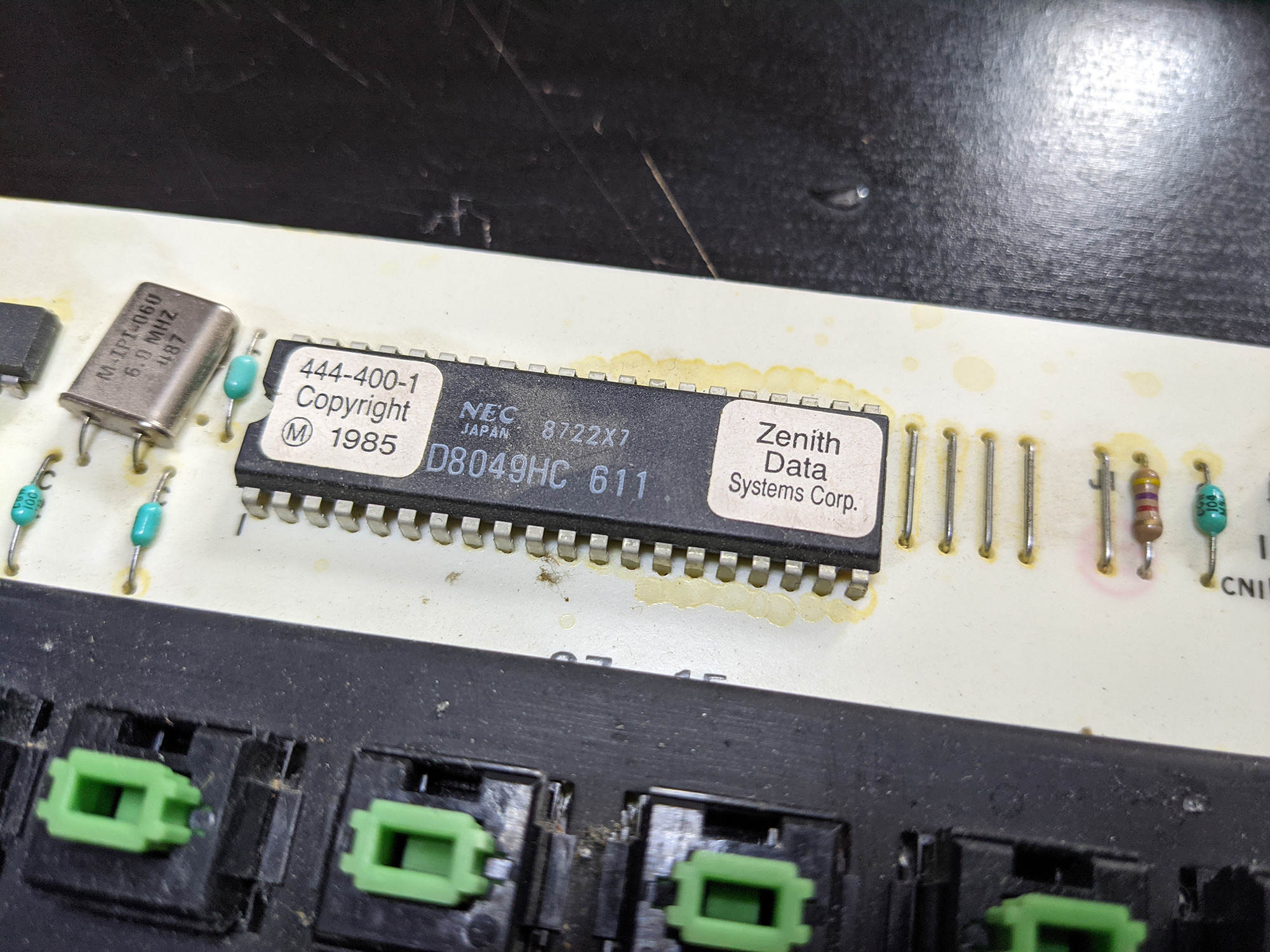

So, I've found two or three other Z-150 threads, one quite recent, regarding pin outs and what not which have helped me discern my approach somewhat. I believe this Z-150 is the AT model due to it's badge. However, the PCB more closely resembles an XT PCB from what I can gather, the presence of Greens suggests it's an older model and I am aware that there was some sort of manufacturing overlap with the XT and AT models. I realise that the presence of lock lights would indicate that it's AT but I wish to be sure. Model label: 100-1860, PCB markings: 820-0204, XTAL, TC1-A35S. The original cable is missing, so before considering my next move, is there anyone that can confirm whether this is AT or XT?
Z-150 PCB (1).jpg (2.66 MiB) Viewed 12635 times
Z-150 PCB (4).jpg (808.04 KiB) Viewed 12635 times
Z-150 PCB (2).jpg (2 MiB) Viewed 12635 times
Z-150 Guts (3).jpg (2.33 MiB) Viewed 12635 times
Z-150 PCB (3).jpg (207.42 KiB) Viewed 12635 times
Z-150 Guts (1).jpg (1.87 MiB) Viewed 12635 times

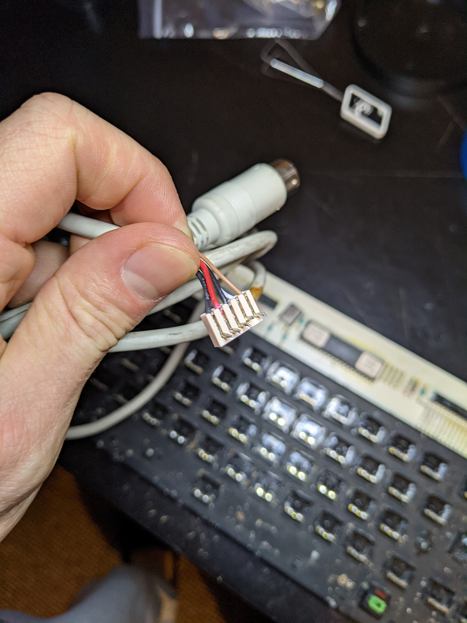

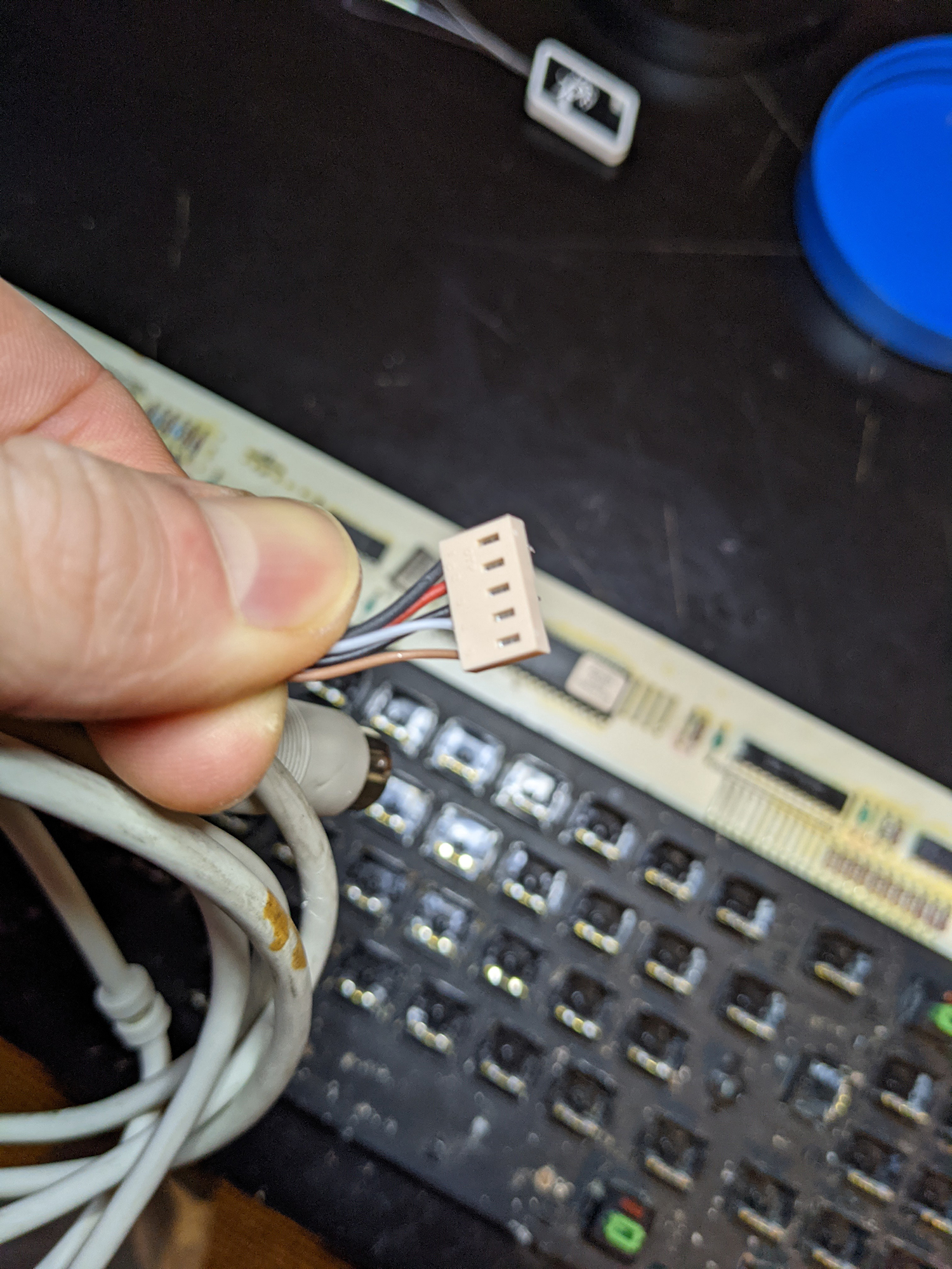

If it's AT, I'm going to try and keep it as original as possible. The seller very kindly included a spare DIN cable that I was considering soldering on to the board to get this thing up and running but I kinda want a big dong, beige coil impractically sticking out the side, like a Zenith should have! My PC has native PS2 support so finding an original coiled AT cable (or something similar) would be my primary goal. Though, if it speaks XT, I may save myself the hunt and go for an internal Teensy conversion instead.
Z-150 Cable (1).jpg (1.76 MiB) Viewed 12635 times
Z-150 Cable (2).jpg (1.82 MiB) Viewed 12635 times

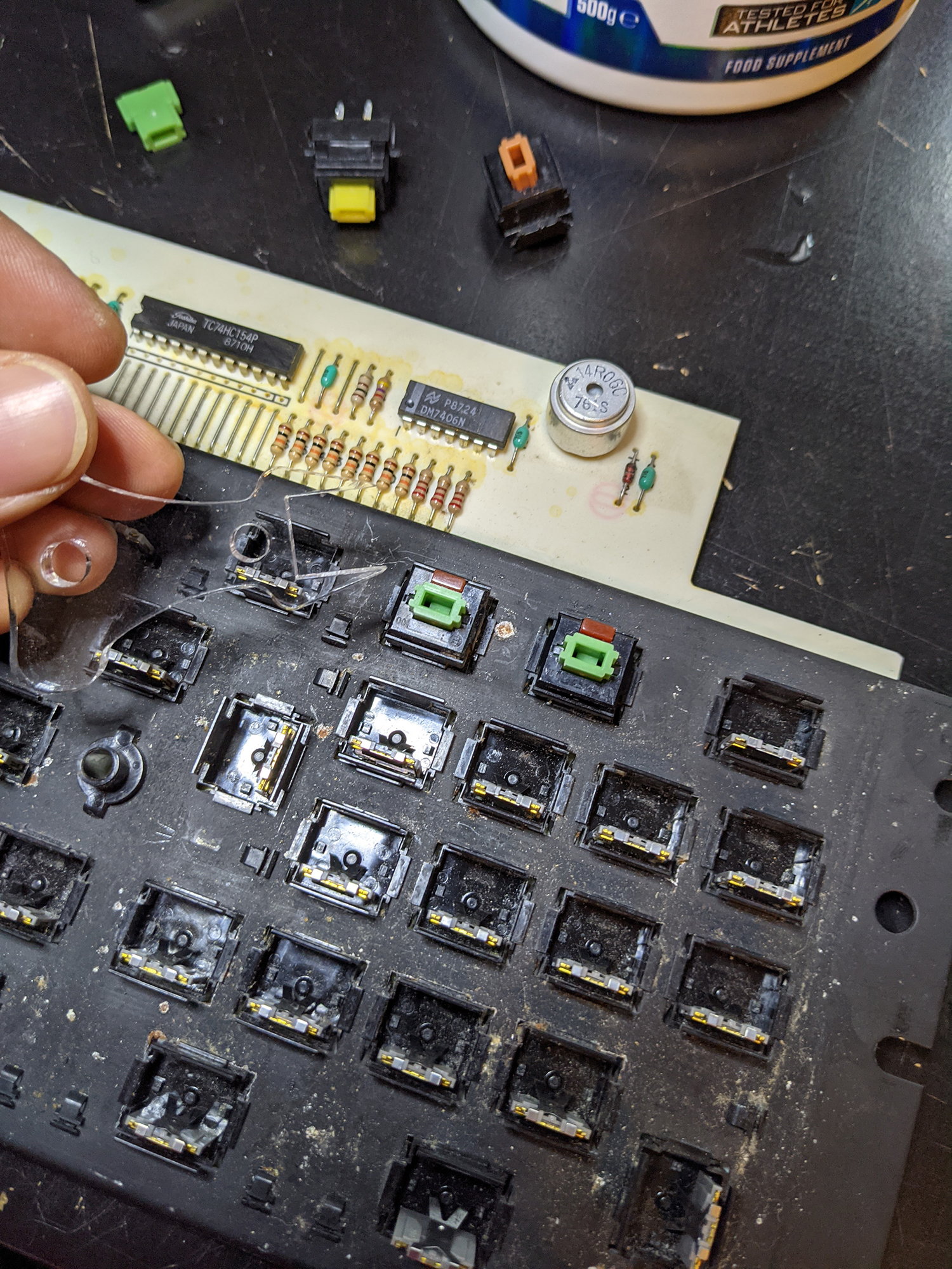

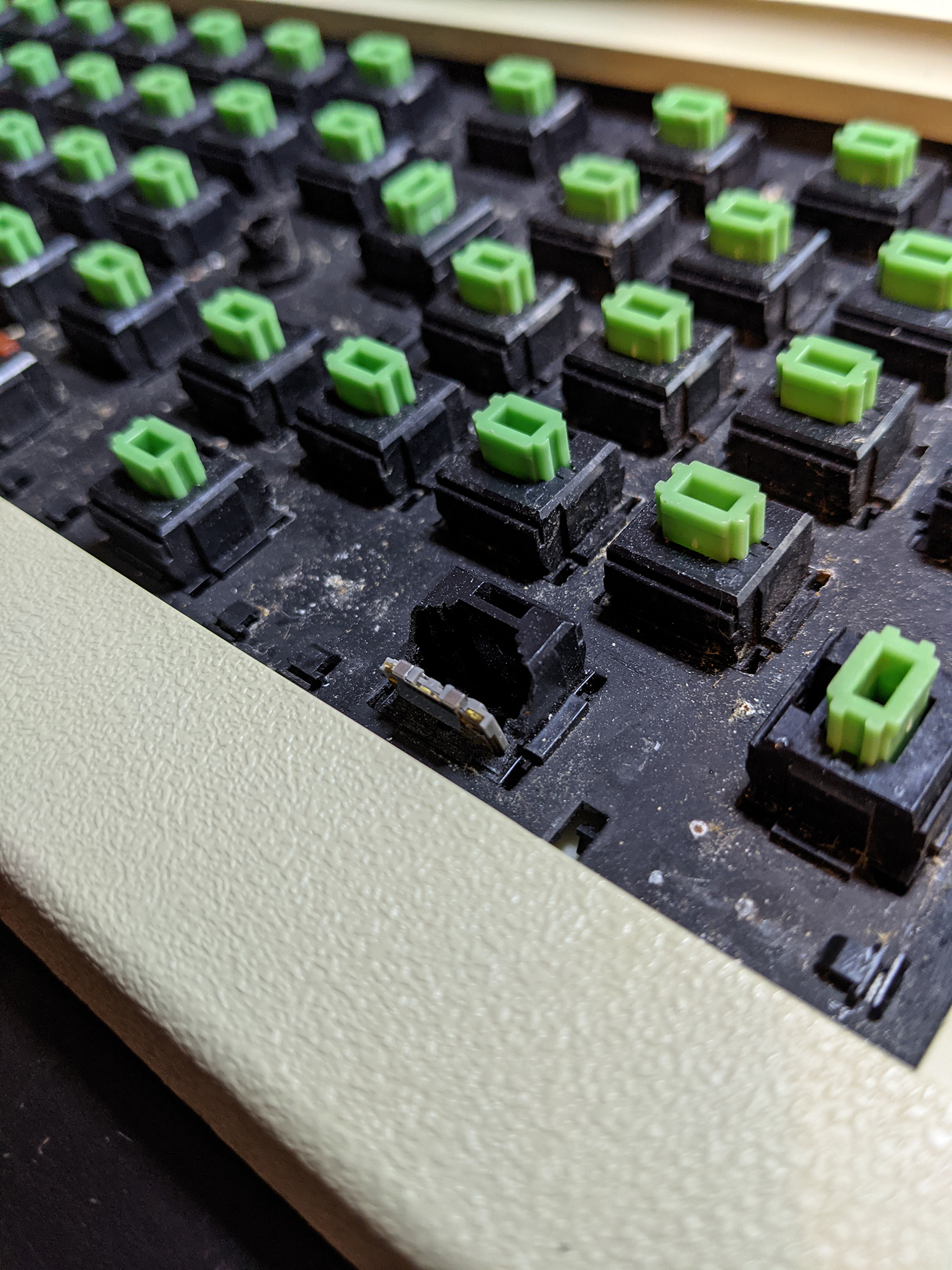

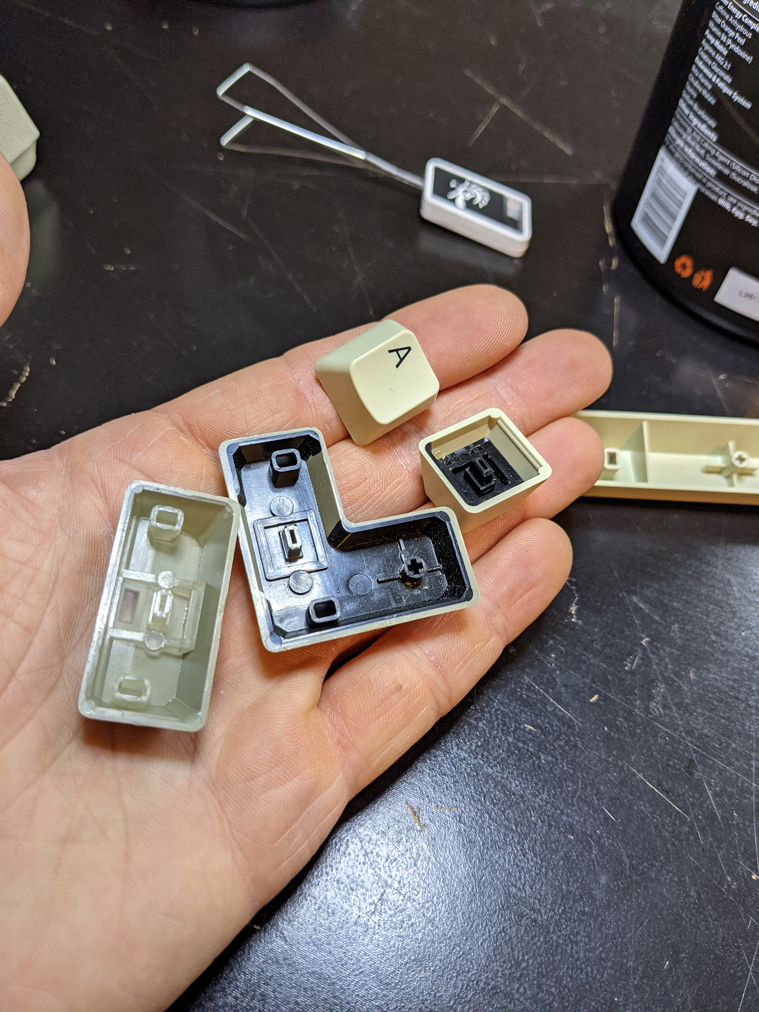

While I take my time to figure out how to get this talking again, I've begun the cleaning process. These Greens do need the full job. I plan to leave them soldered (apart from the one broken on the Num Pad), clean the bottom housings and plate in situ, and have already bathed the top housings and sliders. After watching a great Twitch stream where a fellow DT member experimented with one of the most recent Alps lubrication techniques, I'm pretty sold on the boiling water/paraffin method. However, there is something that may be simple that I first need help on. After searching the forum and the Wiki, I couldn't spot any tips ...how the bloody hell can you remove SKCL Green top housings when the switches have LEDs in them!? I have the Orihalcon Alps Tool (worth every penny BTW), but the top housings don't seem to budge! Do they just require greater force? Is there a trick to it?
Z-150 LED Switch.jpg (2.24 MiB) Viewed 12635 times
Z-150 repair.jpg (1.9 MiB) Viewed 12635 times

* The LEDs in the switches are soldered to the PCB. You can't remove them without de-soldering the switch AND the LED.
* If you can get the keyboard to work, please, please, PLEASE share whatever wiring you do for a converter or even if you try to convert another cable. The conversion info on DT is mostly for the XT version.
* I think Orihalcon mentions that the opener tool you have -- I've currently got two from him -- works "better" on de-soldered switches. I think that should be, "Only works on de-soldered switches." :D

hellothere wrote: 10 Oct 2021, 19:17 * The LEDs in the switches are soldered to the PCB. You can't remove them without de-soldering the switch AND the LED.
So I can't get into the switch/remove the top housings without desoldering the whole switch and LED?
Top housing just slides over the LED, so the tops should be removable. The side with the LED is a little tricky though. I don't have one of Orihalcon's openers since I always had good results with simple cocktail sticks.

Go-Kart wrote: So I can't get into the switch/remove the top housings without desoldering the whole switch and LED?
Well, unless you're somewhat masochistic. De-soldering and re-soldering 4 pins is going to be easier, based on my massive experience of one Z-150 that has green Alps :D.
TNT, one of the reasons that both Go-Kart and I have a problem is because we have cut keyboard cables and the pinouts listed are for the cable end, not the keyboard end. That being said, I hadn't, until this thread, seen anyone say that there are some XT versions of the Z-150 with the white badge.
I will eventually try to wire up a TMK and play with the wiring, but it's not my top priority.

I read a couple of pages that say that the XT versions of the Z-150 have rounded corners on the PCB. Mine has. Go-Kart, yours doesn't. I also have a different part number for the PCB, 1 (might be "L" or "I," but I can Google the part number if I start with 1) 2KC564B. Mine also has the old style Alps logo. Yours has the block caps. So, I can't tell what protocol your Z-150 speaks. I also have double-shot caps, which are supposed to be newer.
* I found a service manual for the Z-150. It's here (PDF). ​Keyboard stuff starts at page 40.
* There's a user's guide here (PDF).
* It may have been posted elsewhere, but here's a Zenith Z-150 Personal Computer Desktop System pamphlet (black label; PDF). If you Google "www.1000bit.it/ad/bro/zenith," you'll find some more ads (don't add the comma, but do add the quotation marks).
* The micro controller in my Z-150 is a 40 pin NEC D8049HC. A full pin diagram is listed online.
* The "secondary" controller on my Z-150 is a 14 pin Texas Instruments sn74ls125an. The part's even still available.
