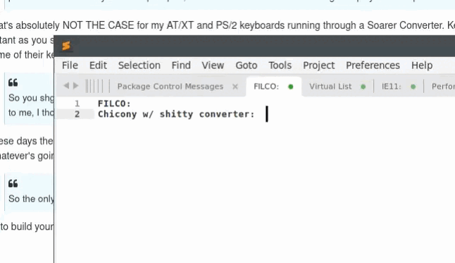

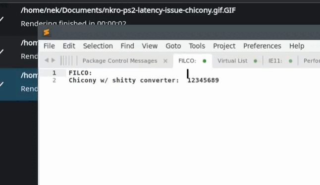

However, just to be clear in what I am talking about, here is a gif animation of my Filco Majestouch with USB and a Chicony 5162 using my shitty ps2 converter (os is LINUX):
Filco Majestouch Chicony 5162
I don't want to lose time in building one, I want one for the work place and would love an orihalcon one, which looks nice and ordinary and not like a science project, which is probably what I will end up making.

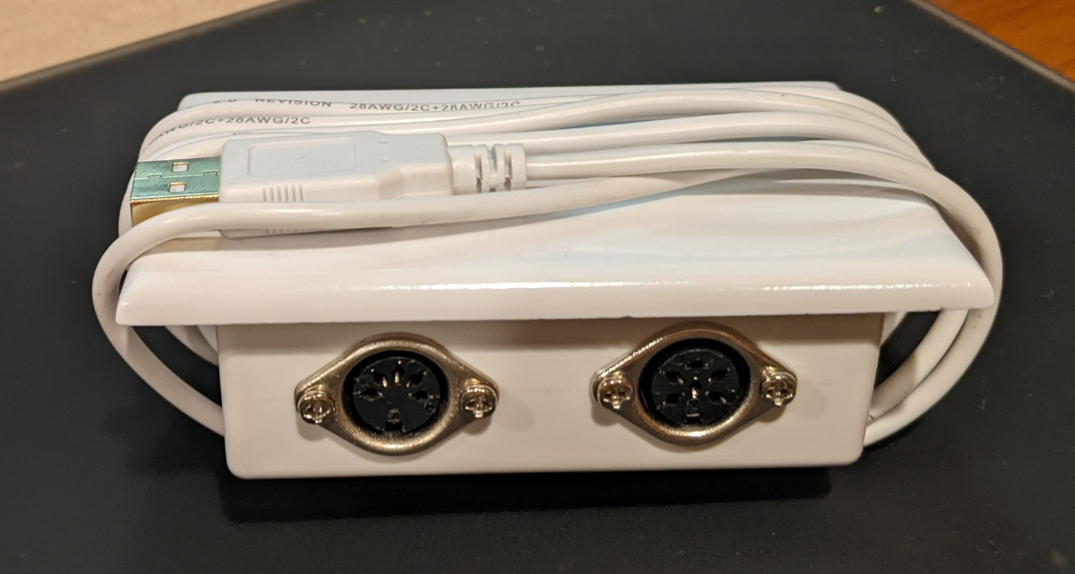

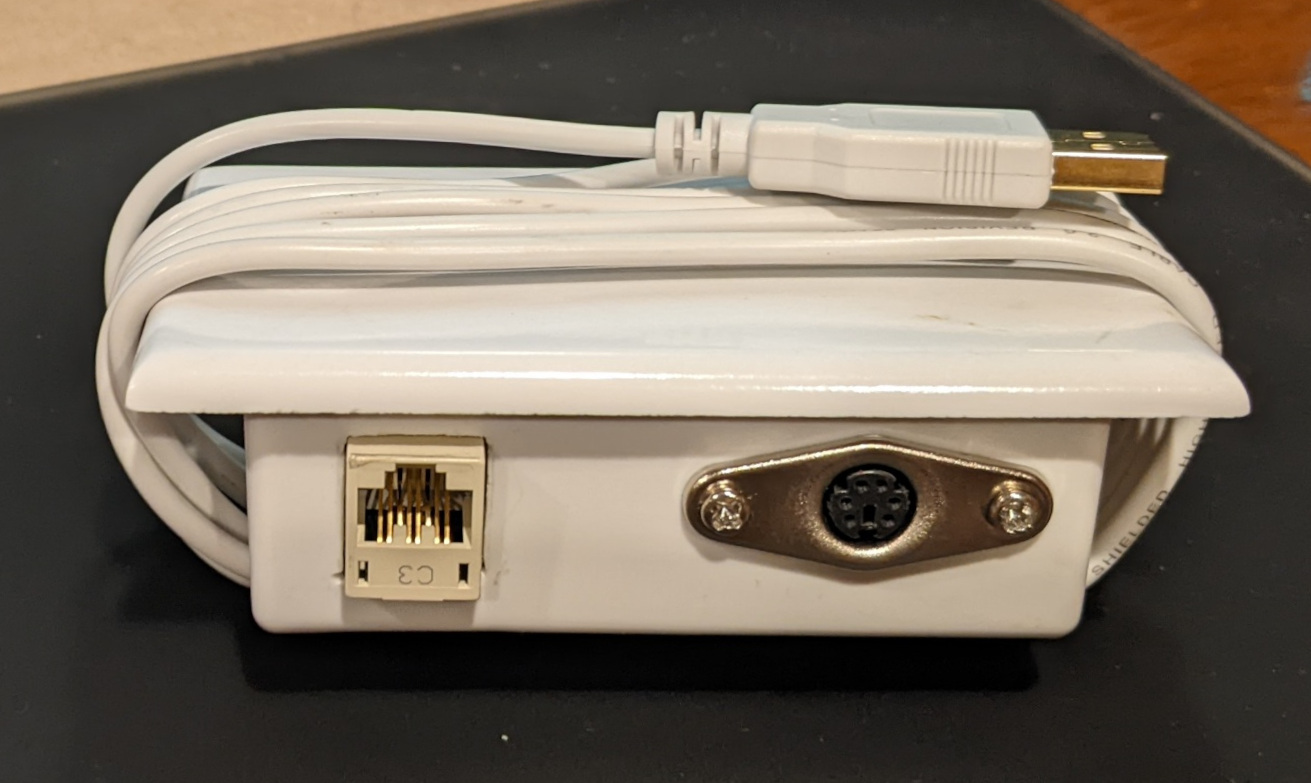

Orihalcon's cable are very clean and look great, but he builds them himself and that is obviously not his "real job"NeK wrote: 08 Dec 2021, 14:30
would love an orihalcon one which will look ordinary and not like a science project
You made me laugh with the "science project" comment. Years ago I posted a guide that was crude but worked great.
https://geekhack.org/index.php?topic=58 ... msg1348717
Later I made a much cleaner version and it is extremely useful if you mess around with old keyboards.
- USB-converter-AT-DIN240.jpg (260.03 KiB) Viewed 5002 times
- USB-converter-PS2-RJ45.jpg (205.87 KiB) Viewed 5002 times
