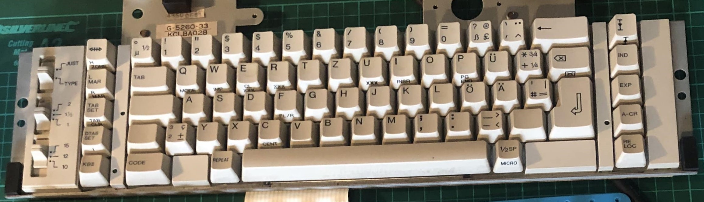

Since very early on in my mechanical keyboard journey I´ve been fascinated by electric typewriters.
They came right at that moment in time, where pc´s became widespread and got gradually replaced by them, fading slowly into irrelevance.
There are many interesting / beloved components / mechanisms to be found here , like Alps , BS , beautifully looking high quality keycaps and more. I like to get my hands on their keyboard modules and over time, get all of them usable via USB to a computer.
Eventually with (3d printed) cases and everything.
I´ve managed to find some examples that I liked a lot over the time in the hobby mosten so through luck / chance.
Models include: Canon AP 800 (Cream ) , Sharp ZX-330 (Green), Sharp XQ-380 with veeeery mushy SKEW , a TA SE 505 with lovely dye subs but funky wiki/Cherry_MX-M8_Adapter Switches.
From IBM I've got a 6787 and a Model 95 on the way. :)
Recently friends of my grandparents offered "some old typewriter" in their attic and voila , it was a AP 150.
I had way too many before , but now it is getting out of hand :?
With more time on my hands now with my exams being over, I wanted to get some of them sorted out.

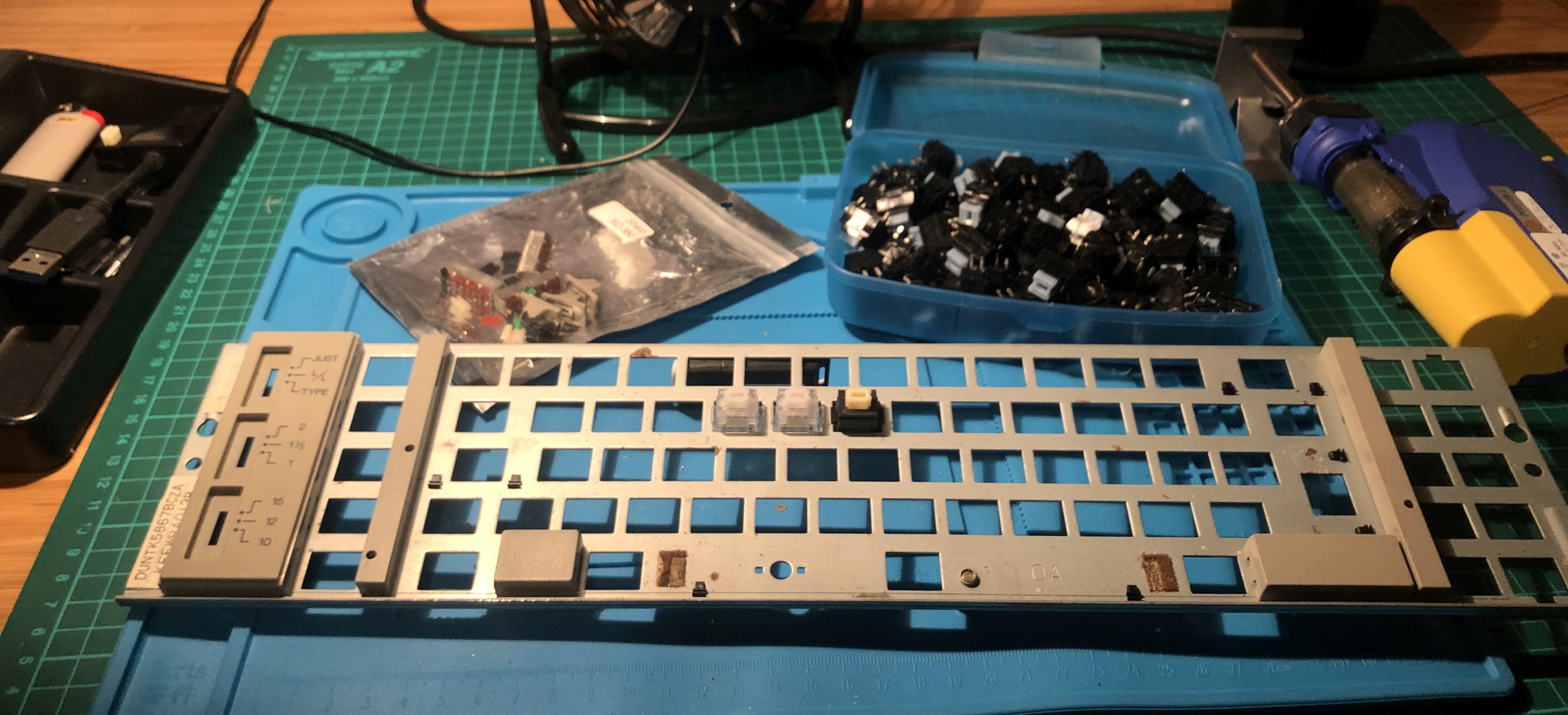

Starting with cleaning keycaps and desoldering some switches. ( SKEW plates fit SKCL / SKCM no problem )

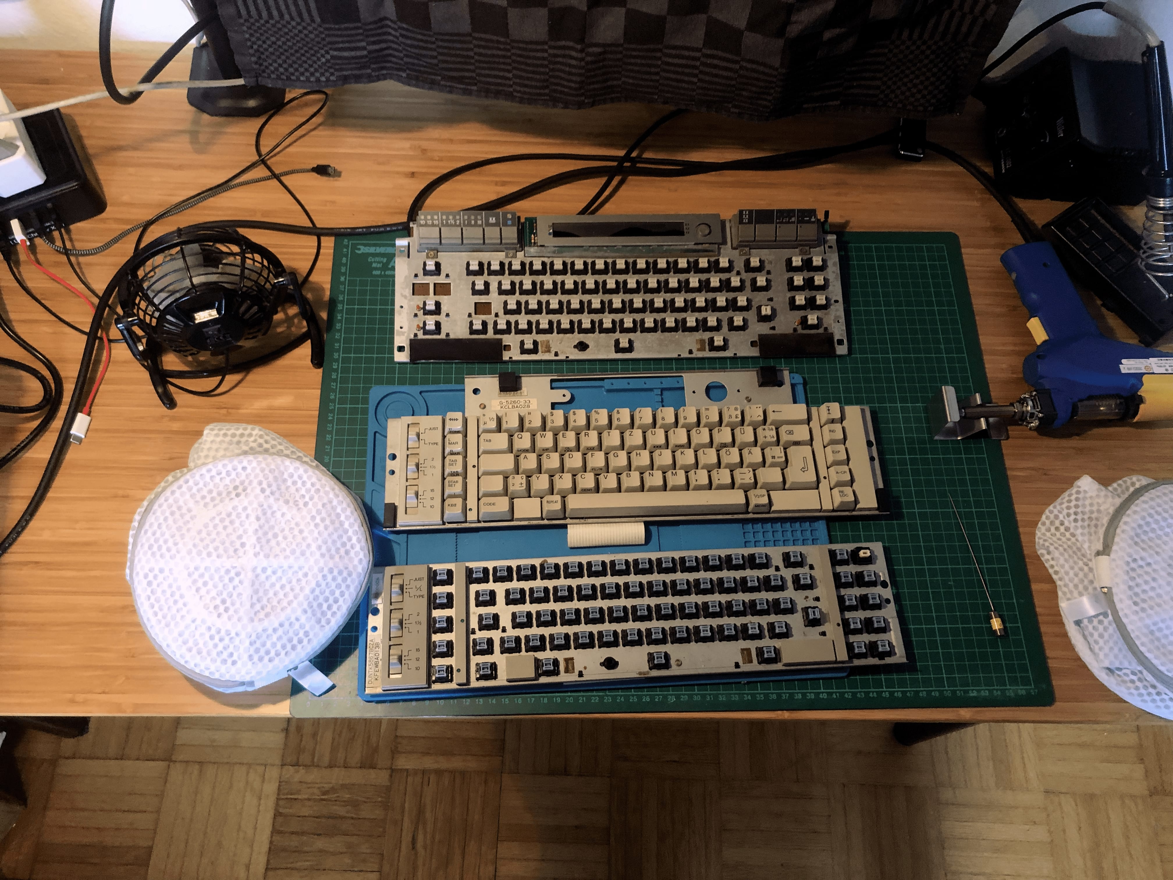

So here is some of my progress from today in images.

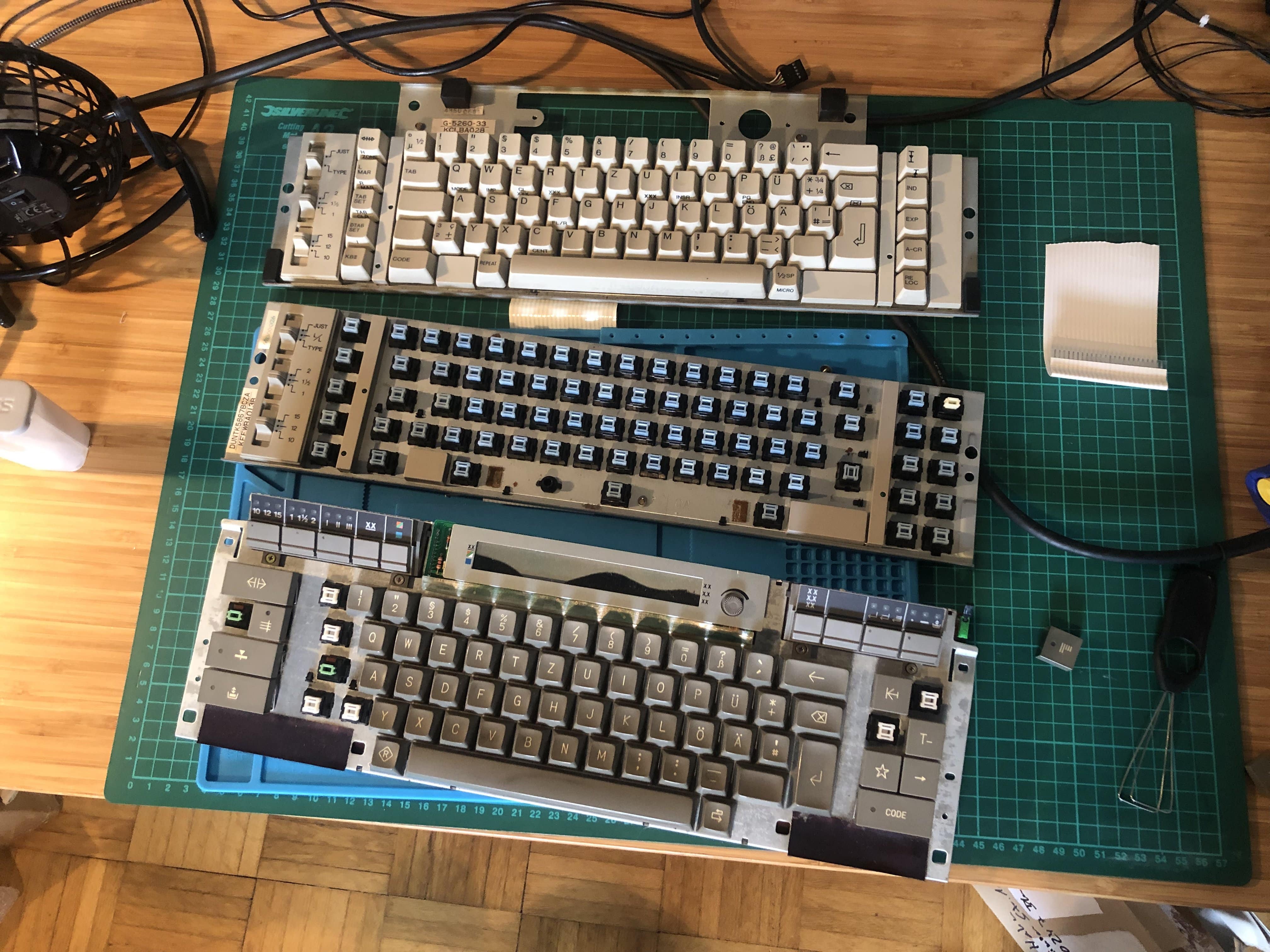

zx 330 , xq 380, ap 150 , top to bottom

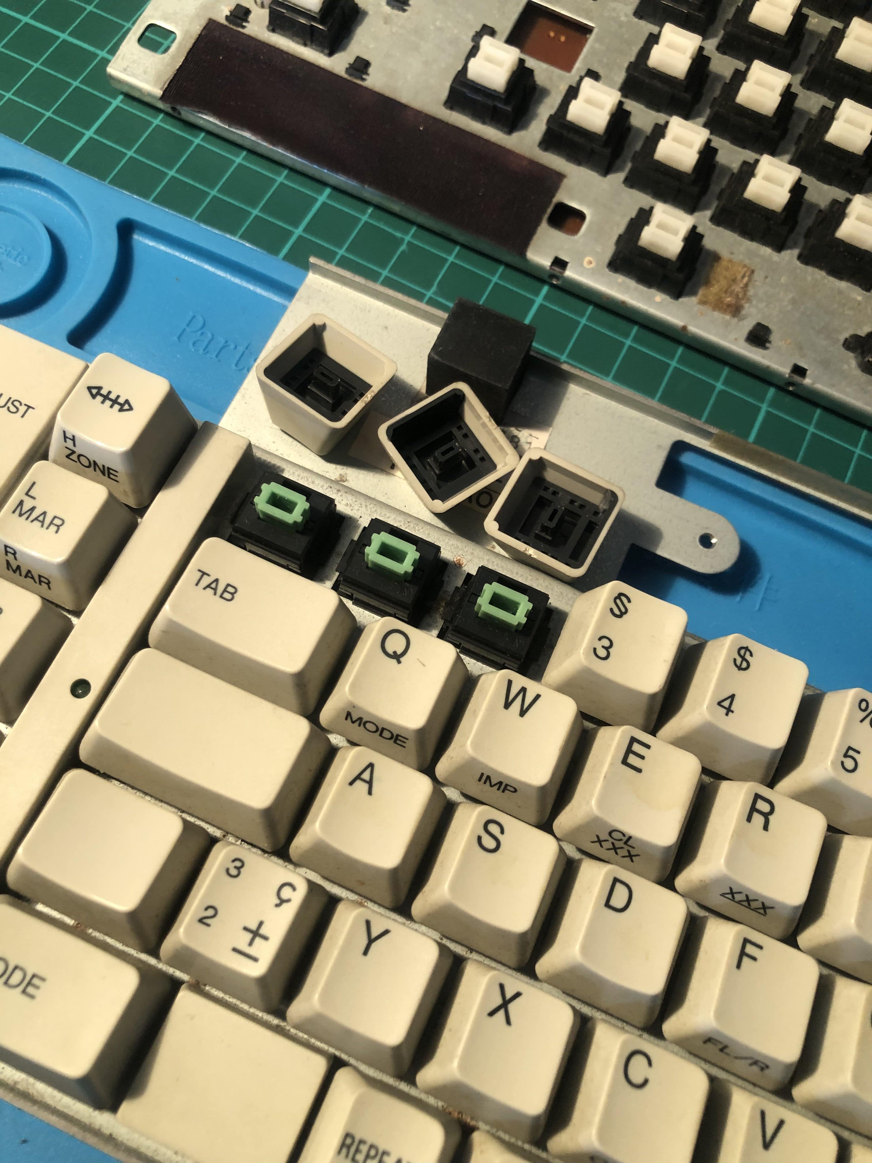

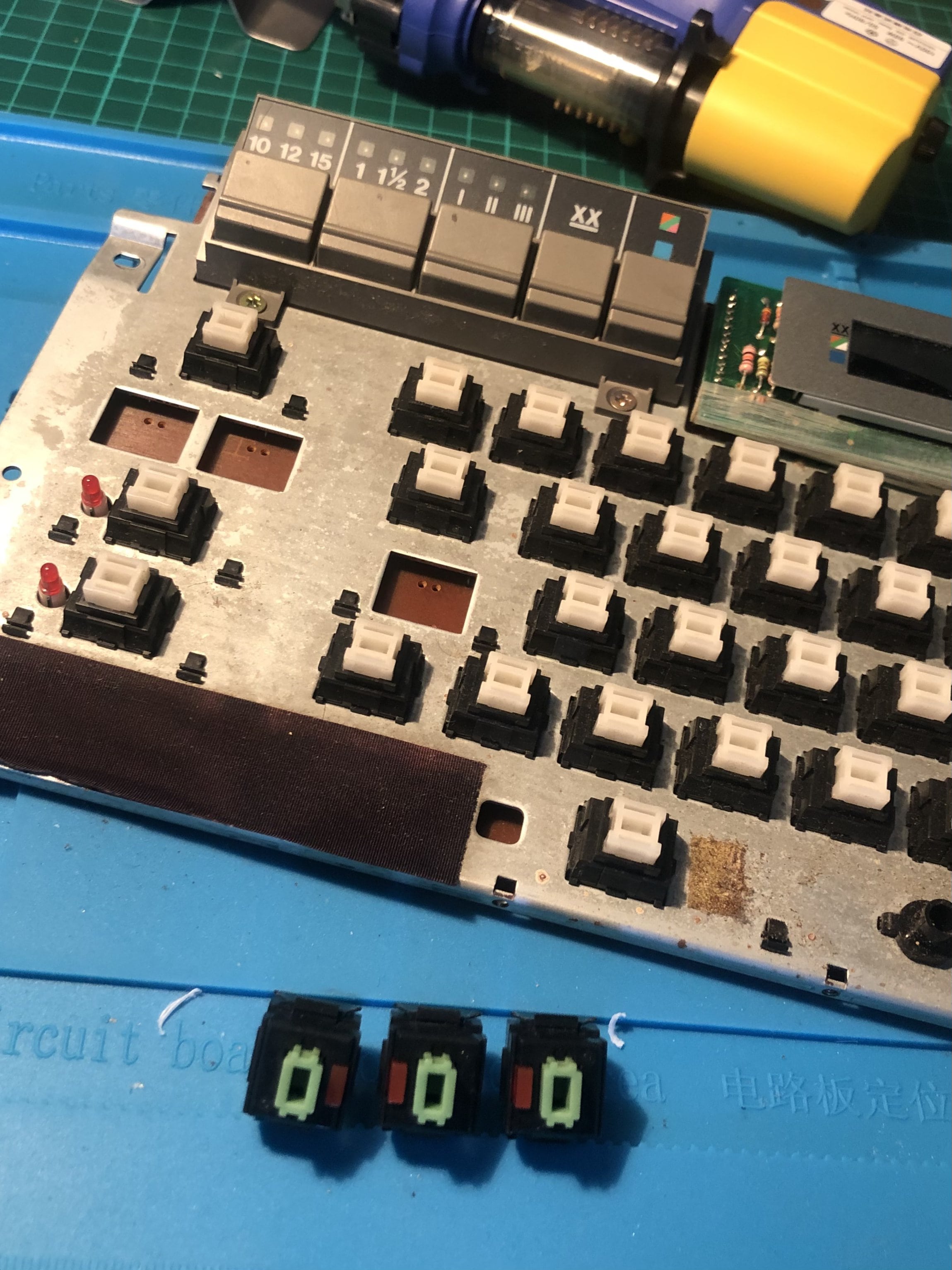

the 3 greens stolen from the ap 150

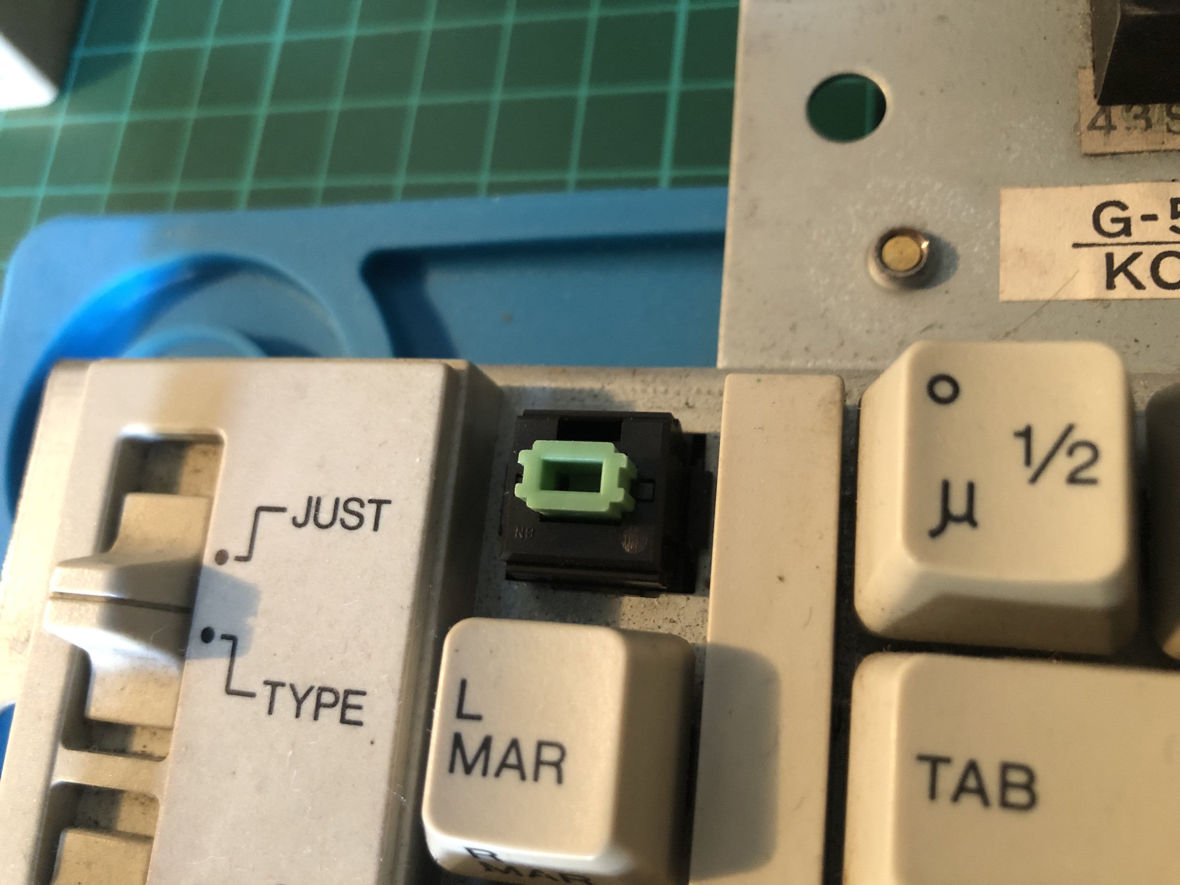

leafy greens on the zx 330

green closeup
green closeup
Update:
Plates fits Matias and Alps SKCM Cream Dampened without Problems.
A bit rusty though...

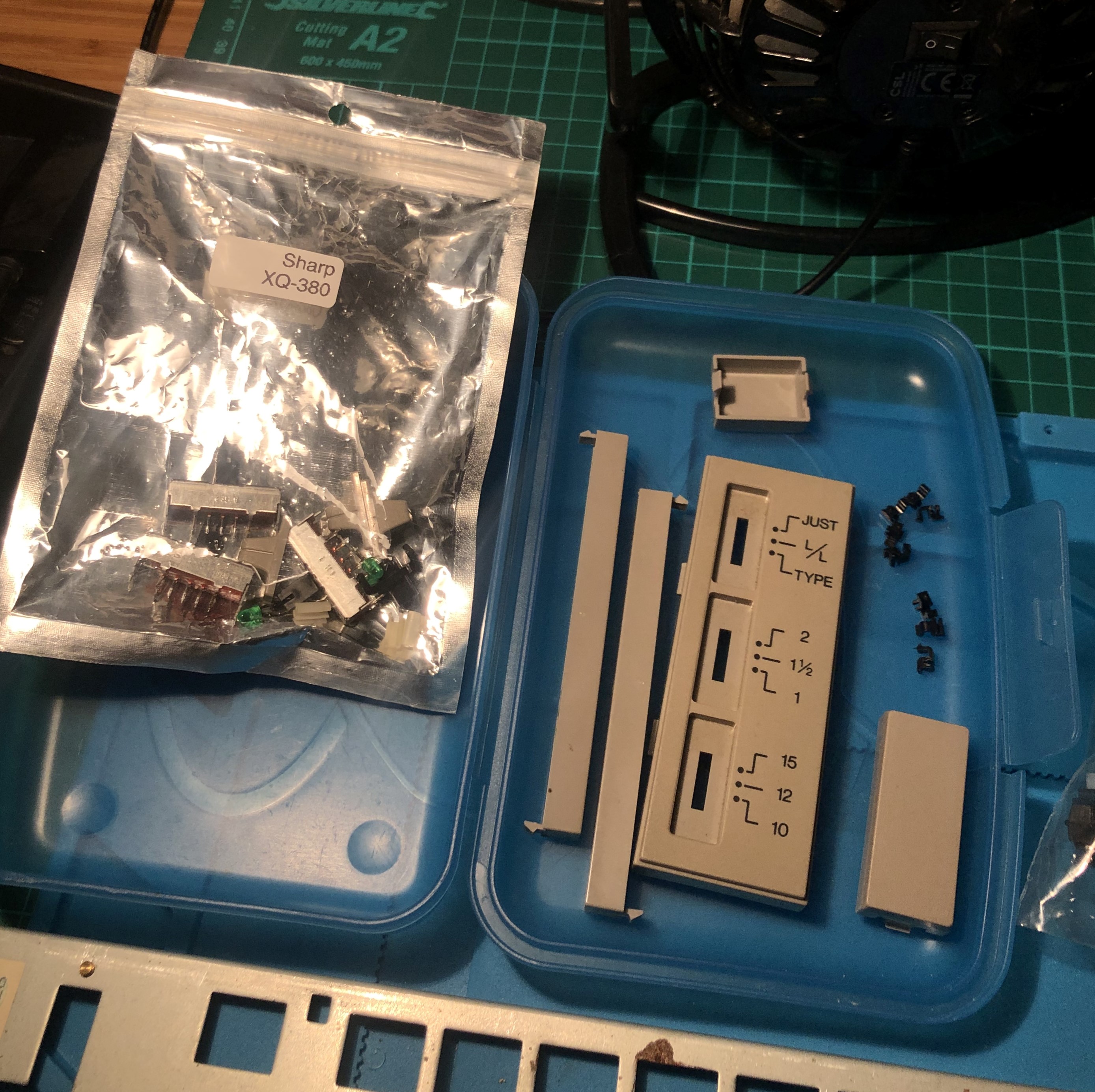

All of the plastic parts removed

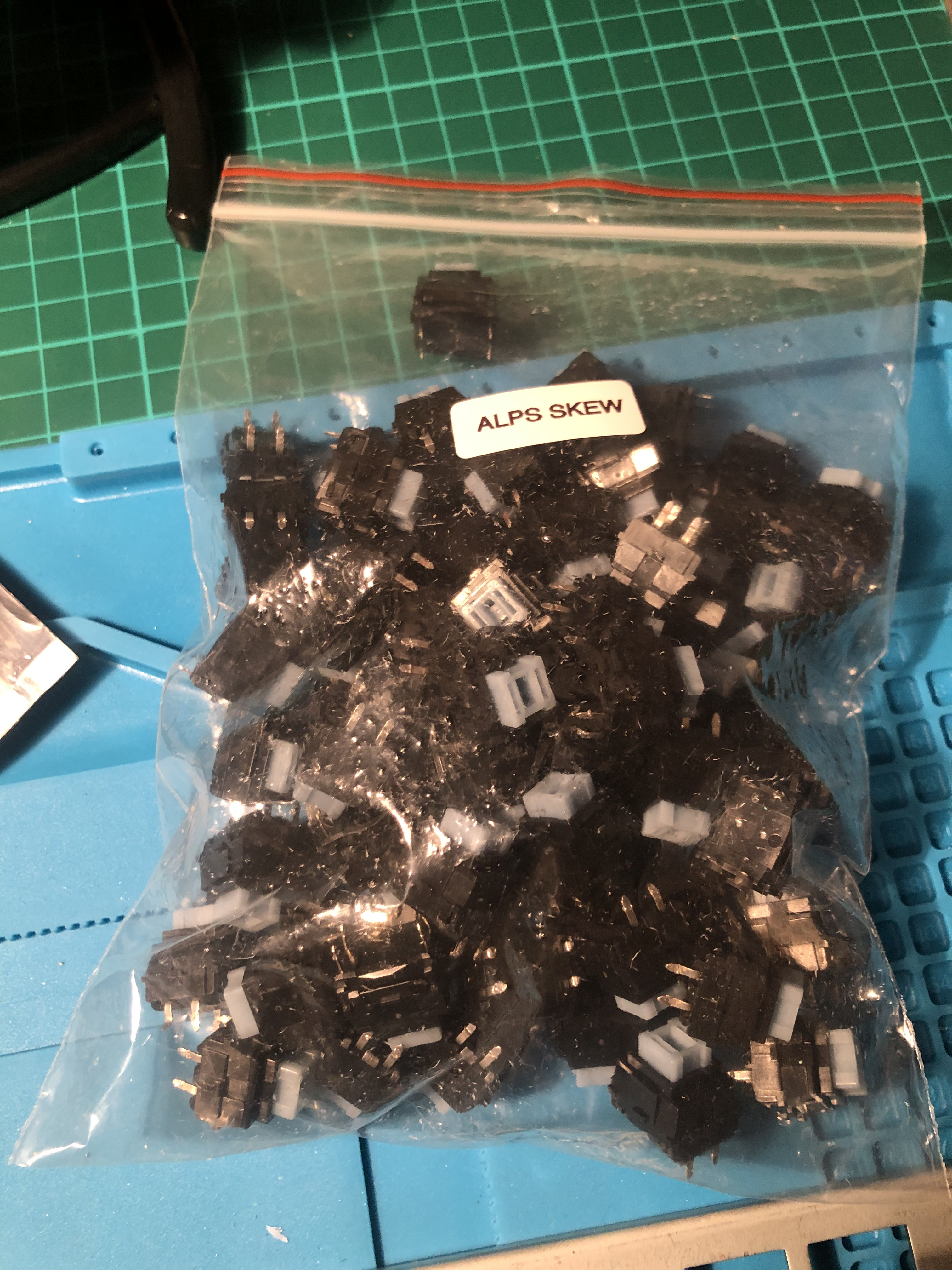

The desoldered SKEW Switches.... one of the worst switches i´ve ever tried .... no worries, they will be replaced

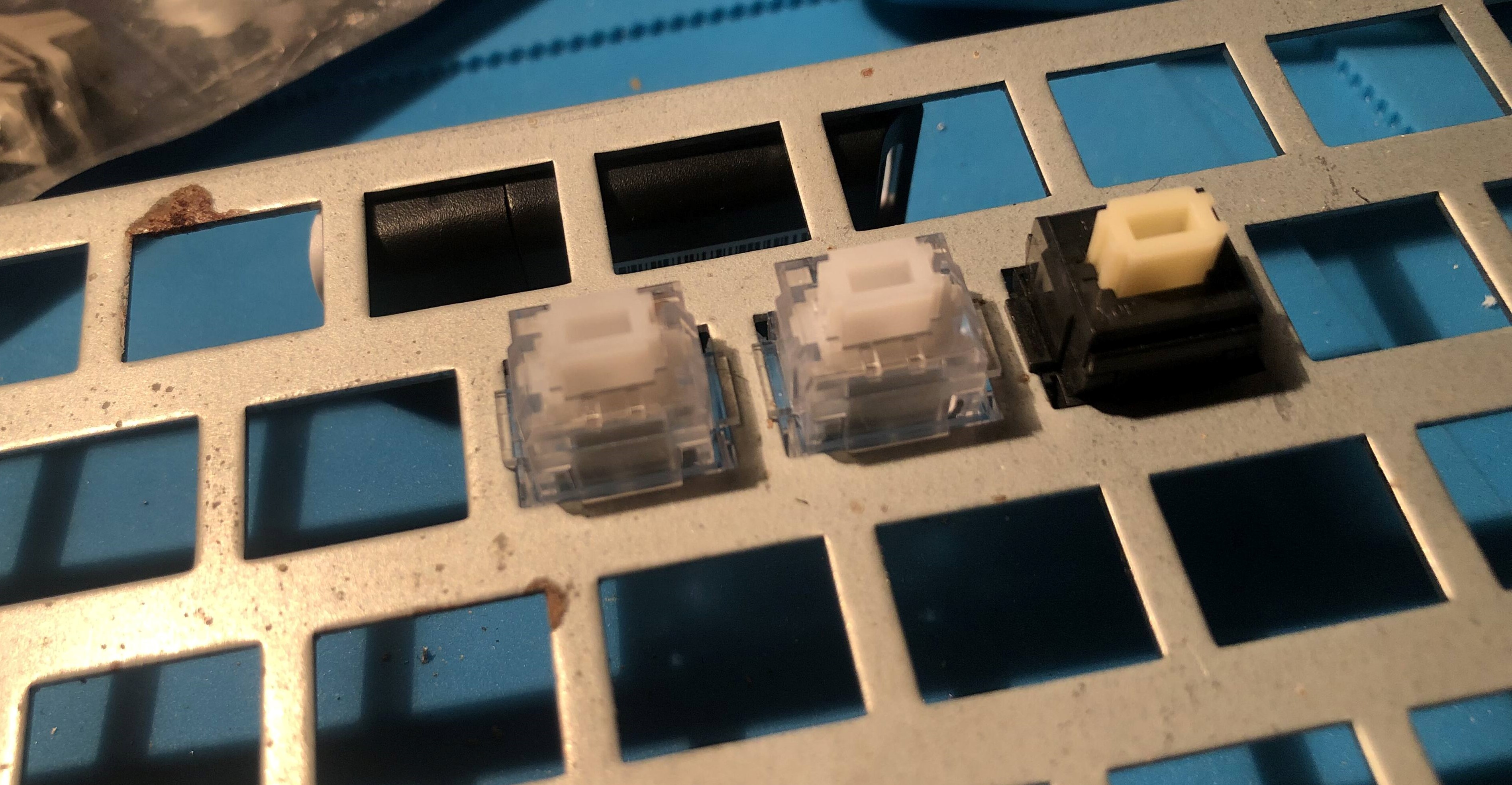

Is that a lonely Alps latching switch on the xq 380?
I really commend your efforts! After the first of my enthusiasm faded away I decided to just scrap the two Canon units I had for switches and caps. I kept the Marquardts tho, but they're still waiting to get a case. Have you ever tried hacking up the old machine's housings to build a case out of?
guidemetothelight
25 Apr 2023, 21:50
TNT wrote: 25 Apr 2023, 18:56 Is that a lonely Alps latching switch on the xq 380?
Nope , a single Cream that I put there to test plate compatibility.

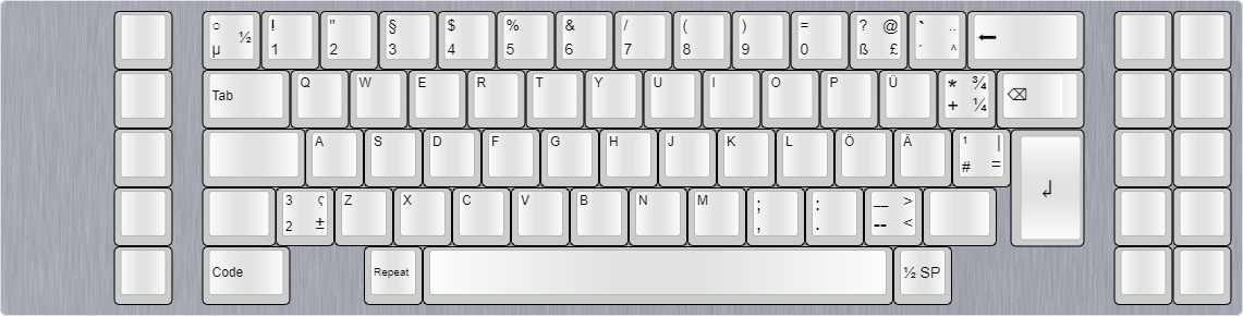

Is that F-cluster still WIP, or some kind of solution for incorporating those sliders on the left?
No experience with the Layout Editor, unfortunately. Couldn't you just place a vertikal 2u key, leave a gap and call it a day?
guidemetothelight
29 Apr 2023, 09:13
TNT wrote: 29 Apr 2023, 00:06 Is that F-cluster still WIP ?
Now it is :D I simply put it on the wrong side of the board. The XQ-380 has one more row of extra keys, but on the right not the left. On the ZX-330 there is only one row , the other one does NOT have cutouts in the plate for switches , but one more plastic cover.
TNT wrote: 29 Apr 2023, 00:06 Couldn't you just place a vertikal 2u key, leave a gap and call it a day?
Probably yes. I still wonder how to get the programm to understand that the switch needs to be rotated 90 degree in order for the weird enter key to work ...

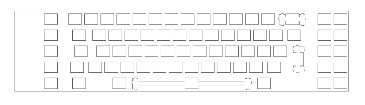

Since I regained my itch to work on the ZXQ project, I mapped the layout in KLE & will try to testprint the file in the following days to see if it matches the current plate. If so, the next step would be pcb design. Since I have never done that, I wanted to ask for you guys input on that to see of you have got ressources where you can learn keyboard oriented pcb design.
What tools / programms do you use ? What tricks do you have ?
The ZX 330 has green alps, but only one column of function keys on the right.
The XQ 380 uses the same plate but comes with SKEW switches. But, it comes with those additional F keys.
I wanna be able to use both models for the conversion, so the optional switches need to be accommodated for.
I put the kle layout in swillkb´s plate builder and it looks to be correct. I wont need a custom plate for the project though, since I want to reuse the one from the typewriter itself, as it already has all of the correct stab position´s cut out and ready to use. Also the two holes on each side make a perfect spot for top mounting the plate into the case (that I still need to design) with some rubber bushings or grommets.
