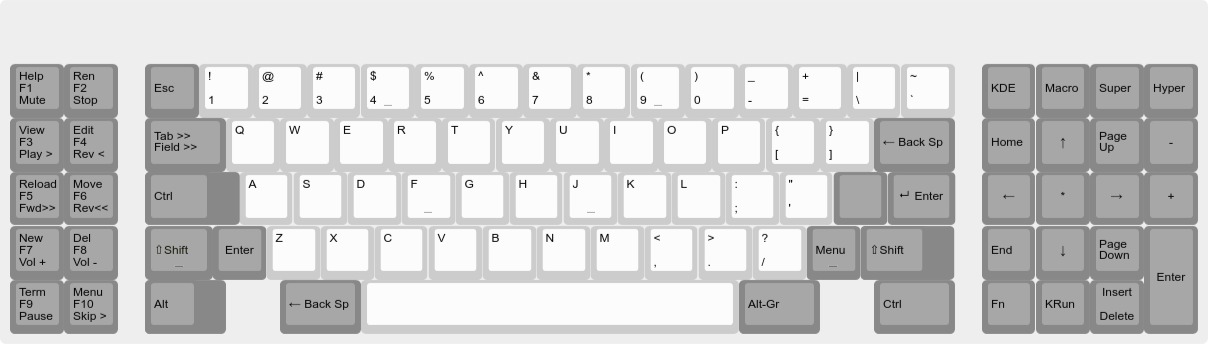

I've gone beyond that; I'm using a 1.25u Enter key, which let me recover two useable key barrels. And I split both Shift keys and the Insert key, too. I don't have any flippers for them in my daily-driver keyboard yet, though.
The left "M alt" key will be an extra Backspace, Colemak-style. The right will be Alt-Gr. I already have the keycaps for that, and an M spacebar, and now that the spare keyboard is apart, that should happen Real Soon Now.
Except for the M alt keys, it looks pretty much like the picture below.

That's quite an interesting layout, I actually wonder how having an extra backspace where Alt would traditionally go on a modern Keyboard would feel. As for the nav layer on your numpad, I couldn't recommend enough mimicking the traditional nav cluster over the layer.

Indeed. The inverted T of arrow keys at least:
My AT’s a compromise between that T and maintaining a numpad; which I toggle between numeric and mouse keys, by hitting our good friend Vladimir Ilyich!
Another, probably more sensible way to do it is a T topped by a full-on navigation six-pack right above it. You’d have a 1u rim to the top and right left over, though. My own solution to the problem spared all that, as I care a touch too much about the looks.

It's hard for me to express how much I hate the inverted-T thing. Going back to a proper cursor pad was the main reason I finally went back to the AT keyboard. The F107 has the arrow keys laid out properly, but exiles the Home, End, and Pg?? keys off into Siberia. I do a *lot* of text editing, and I make extensive use of the AT cursor pad layout. Everything is right there; no need to reach for another block of keys all the time.
The other problem with the inverted-T is the "cramp factor." It's painful to use. It took me a long time to realize that's because keyboards in general were designed when any kind of keyboarding was "women's work", and therefore they were designed for 75th-percentile *female* hands. I have about 90th-percentile male hands; all standard keyboards are already a size too small to be optimal.
I'm not entirely sure about the PC/AT, but the PC and PC/XT defaulted to cursor pad; you had to hit the shift or numlock key to make it a number pad. I never had any use for the number pad; I'm left-handed, and it's faster to use the top row than to peck at the shifted cursor pad with my right hand.

Personally, I’ve got bigger hands than most, and I use 60% keyboards so HHKB diamond navigation keys most of the time. I prefer them. But I much prefer an inverse T arrow cluster to the arrows-in-a-numpad that IBM inflicted on the world with the XT and AT. What point is there in the key in the middle? The (male dominated home PC) world embraced inverted T with the Model M and never looked back.
If you prefer the PG PC way of doing it, no problemo: there it is just as you like it, in this case. Separating Page Up and… just a sec… Page Down etc. as well as Left and… be right back… Right arrows seems eccentric to say the least but 1981 IBM did it (before they fixed it) so it must be right.

On the PC/AT cursor pad, my ring finger does Home-Up-PgUp-Left and my little finger does Right, PgDn, End, and Del, as well as "-" and "+".
After remapping the cursor pad, the little finger also does Enter and "*".
I swapped all the keycaps with Model M ones, including Enter. I had Unicomp make me a 1u "+". Now my cursor pad is number-free.
