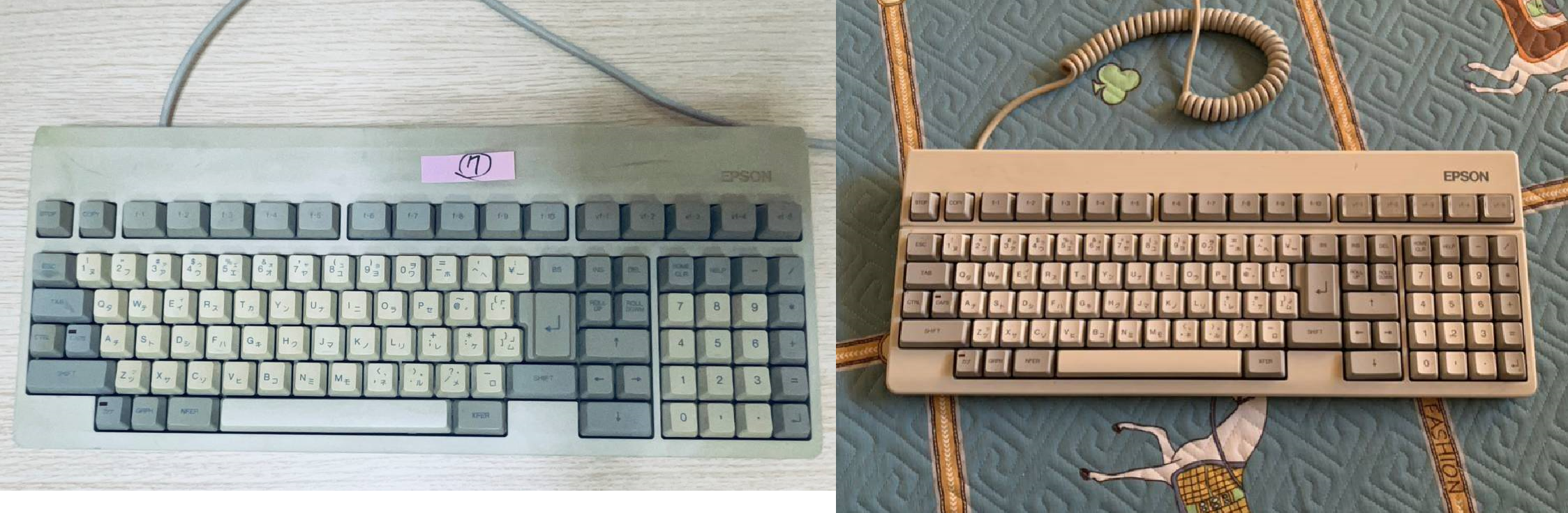

I recently found an Epson AP1003a with Alps SKCL Brown and likely an amber alps spacebar. Not exactly in new condition, but switches are quite smooth for the condition that the board is in.

Update: I tried connecting it to my PC using a DIN to PS/2 and PS/2 to USB setup, but it did not work, only random codes and inputs were put in. Does anyone know if the board is XT class or if it uses a weird protocol? The lock lights light up when I press the Caps Lock or Num Lock key, but this is not registered by my computer. Also, this keyboard lacks a SysRq key, leading me to further suspect that this is XT class. I will try to do some of my own research.

First of all, very nice find! The locklight thing sounds suspiciously like with all the XT boards that handled that board-sided... (As in, whenever the key is pressed, the locklight's state changes). Same thing with the Zenith Z-150 XT, for example. Can you try it with a converter of some sorts?

What a beautiful find ! Epson boards are pretty cool. This is is by far the coolest, though they have some other nice contenders.
I want to get one with Topre or SKCL Alps someday, but finding info is pretty hard. Wiki only has 4 boards listed, while there are many more "unidentified" boards out there.
Anyone has information on those two ? I think they are the same board, just slightly different case.
I hoped they maybe are from the same line as wiki/Epson_Business_Full_Keyboard or the wiki/Epson_Q103A .
Is it possible to tell from the lock lights which switches are used ? location doesnt match alps switches as far as I know

Funnily enough, however, the mounting plate was completely clean and most of the switches are pretty smooth. After dusting off and cleaning the mounting plate, the plate looks awesome. Also found one switch - I think it's the E key - which has some pink marker on it. I'm pretty sure this is was DT wiki refers to as lipstick switch but I have no idea what purpose it serves or why it is there. You can see it in the picture. I have not taken the spacebar off to check out the spacebar, but I'm pretty sure its amber alps according to other reports.
I'm glad to report that with a Soarer's converter, all of the switches work properly! Weird that it has an AT layout but XT protocol.
From the same place, I got a few other boards, including a Omnikey 101, a Laser 2269 keyboard without the laser branding with SMK clicky MX mount, and a vintage SKCL green Texas Instruments keyboard. I think out of all the boards I got from that place, the Epson is the cleanest, though. Does anyone know if this board was built by Alps Electric? It looks nearly identical to the Packard Bell keyboard with SKCL Brown switches, along with some other alps-built keyboards like the OEMMAX MCK-860. The plastic clips on the back remind me of those used on Dell boards, but maybe it's a stretch. idk.

guidemetothelight wrote: 19 Jul 2023, 10:28 Is it possible to tell from the lock lights which switches are used ? location doesnt match alps switches as far as I know
Both boards look like they have the same style lock lights as that of Fujitsu Peerless keyboards, but I can't be for sure. While I was at the location where I got this board I found another Epson board which felt like it could have had Peerless switches, so it might be possible. From what I have heard, Epson keyboards are pretty rare.
