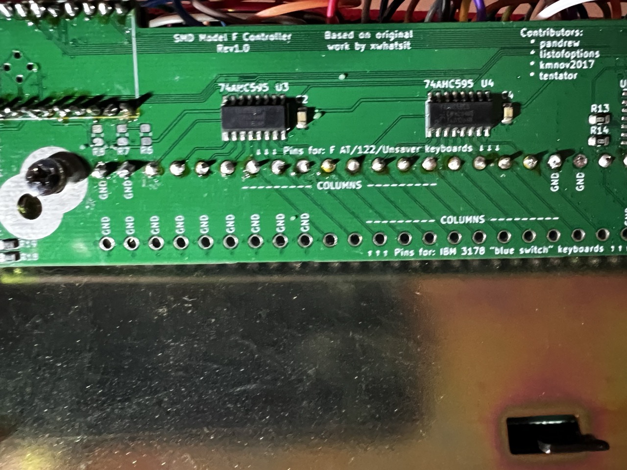

Hi,
I restored an old IBM F122 keyboard but sadly the original controller does not work so I cannot use a Soarer converter like I did on my other Model M or F XT keyboards.
But I have an SMD Model F Controller Rev. 1.0 which works, but I do not know how to configure it. I read through a lot of guides and threads but I am not sure which firmware is the correct one, there are so many. I read pandrew firmware is very good for the F122 but the threads are already old. I also read that VIA would be simpler to configure, but I do not know if this works well on the old F122.
Maybe someone could help where to find the correct firmware and tools to flash and configure. Thanks very much :-)

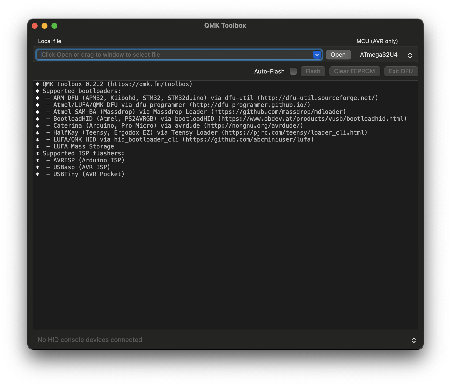

Edit: QMK Toolbox says: No HID device connected but I am typing on the F122...

QMK Toolbox is all about flashing a new firmware. You’re not in Device Firmware Update mode so it has nothing to report.
Do you know which firmware your controller came preloaded with? It must be running something, or you couldn’t type with it. ;)

I think it is this board: viewtopic.php?f=7&t=24597
I did buy it online together with the keyboard from a vintage keyboard guy here in Germany.
17 Nov 2023, 21:03
Well, that’s Pandrew’s thread so my guess is it’s running (his capsense port of) QMK. Doesn’t actually matter which firmware, as you’ll need to replace it to modify the layout, which is presumably your goal.

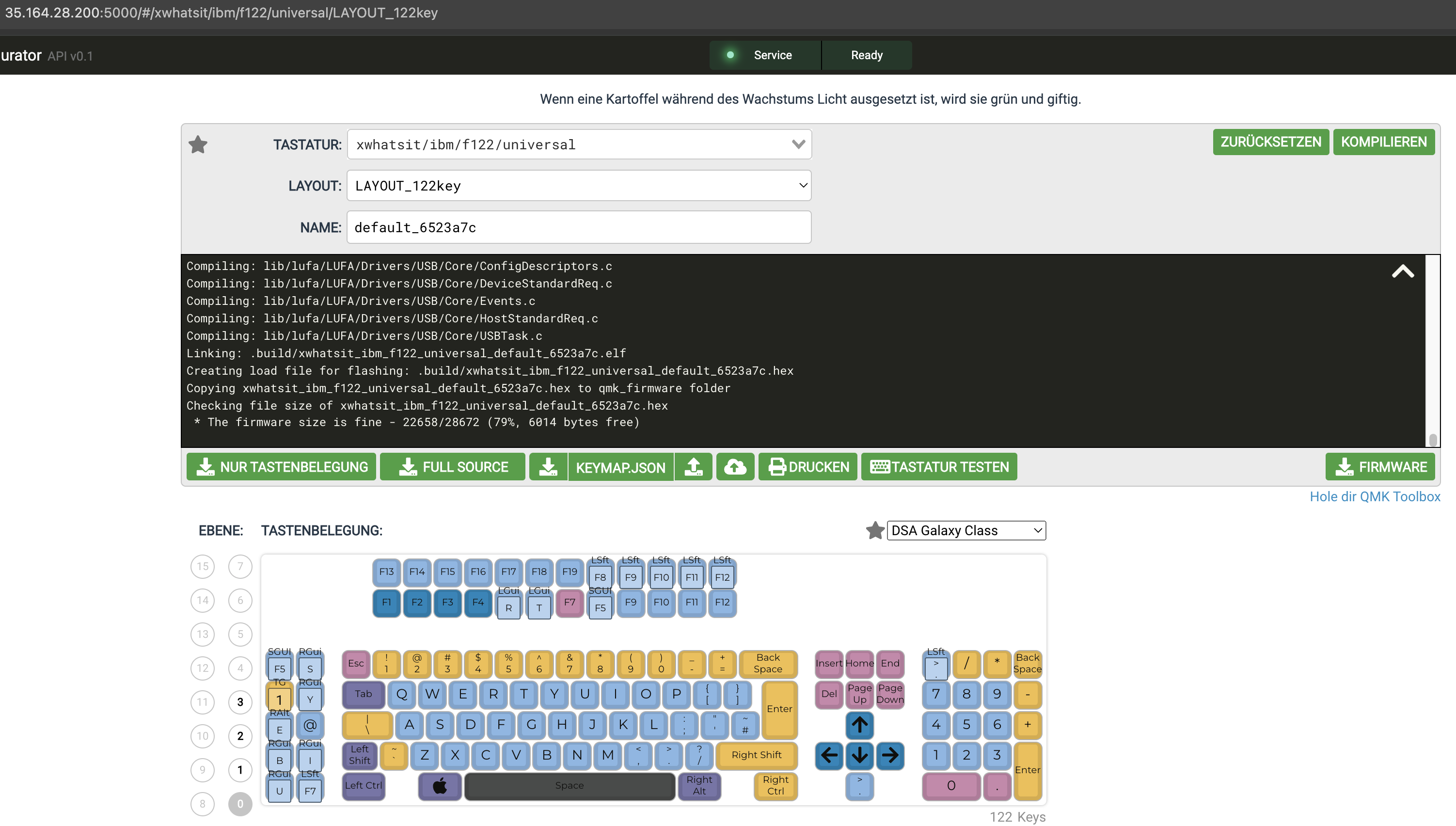

I found pandew config yesterday in another thread but now I am more certain that I can flash it. It has the F122 universal firmware I need to use.

I did the config with Pandrew Config and flashed it with QMK Toolbox.
Here a screenshot for other people with the same problem.

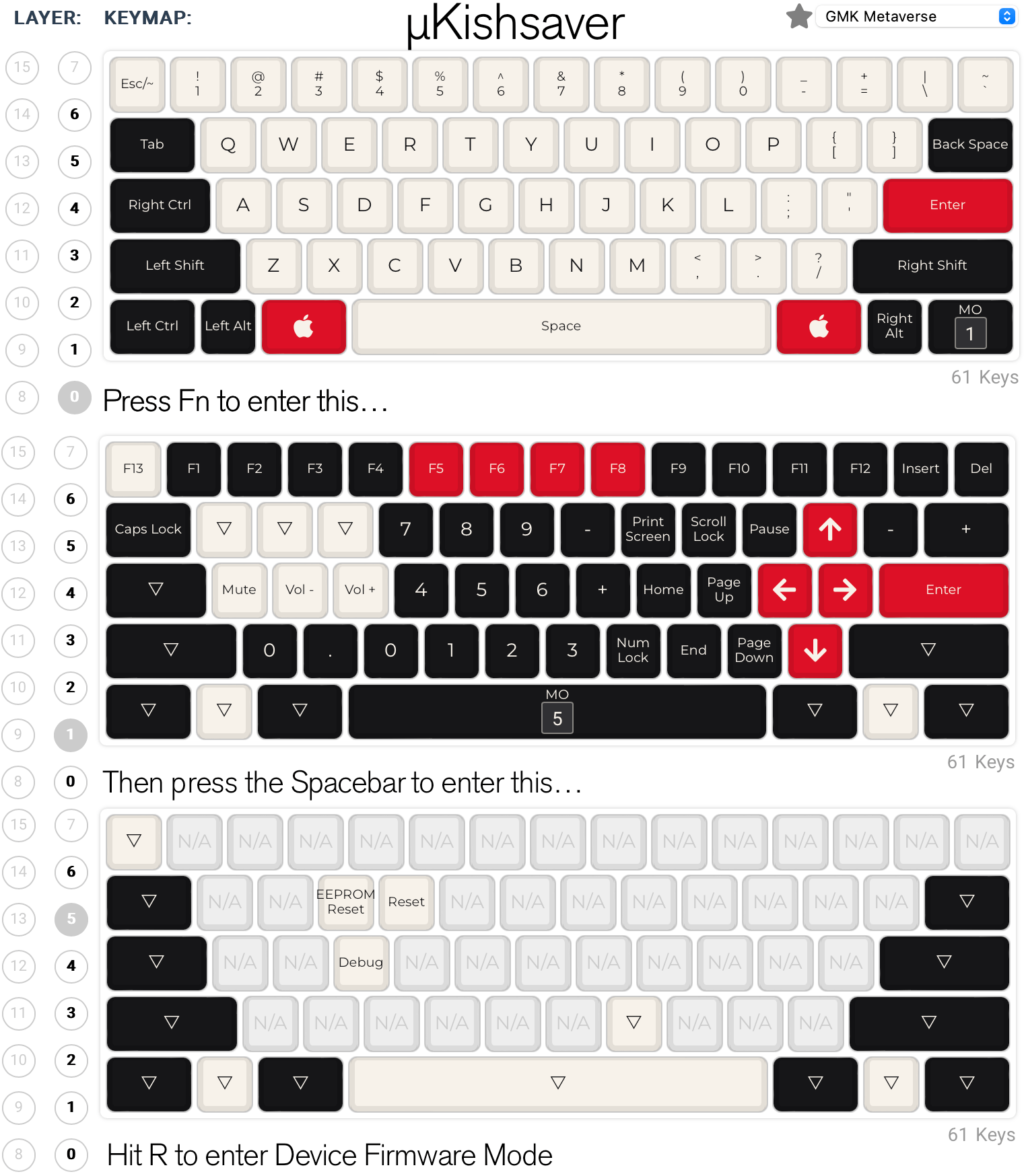

Here's how I do it on my Kishsaver, where every key is hot real estate!
µKishsaver Reset Sequence.png (121.93 KiB) Viewed 10058 times
µKishsaver.json.zip
(2.1 KiB) Downloaded 179 times
I think I learned the "hide a layer behind Fn + Spacebar" trick from the QMK configurator's default layouts, actually. It's a good one. This way Reset needs 3 keys held down simultaneously: Fn Space R, which simply never happens in regular use. You don't want Reset putting your keyboard under you when you're working.
