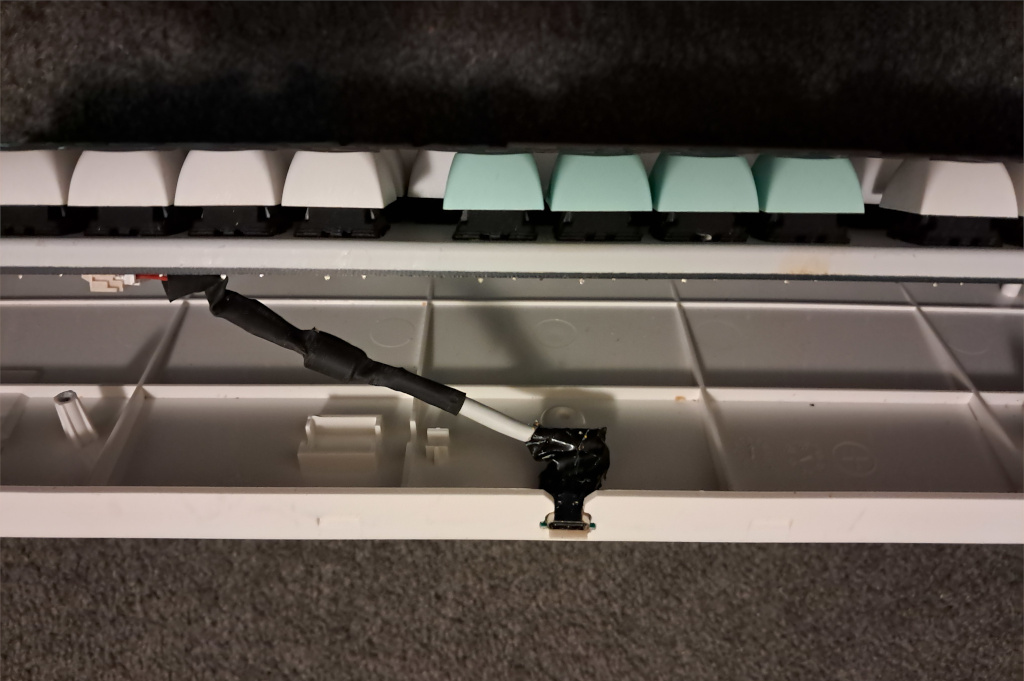

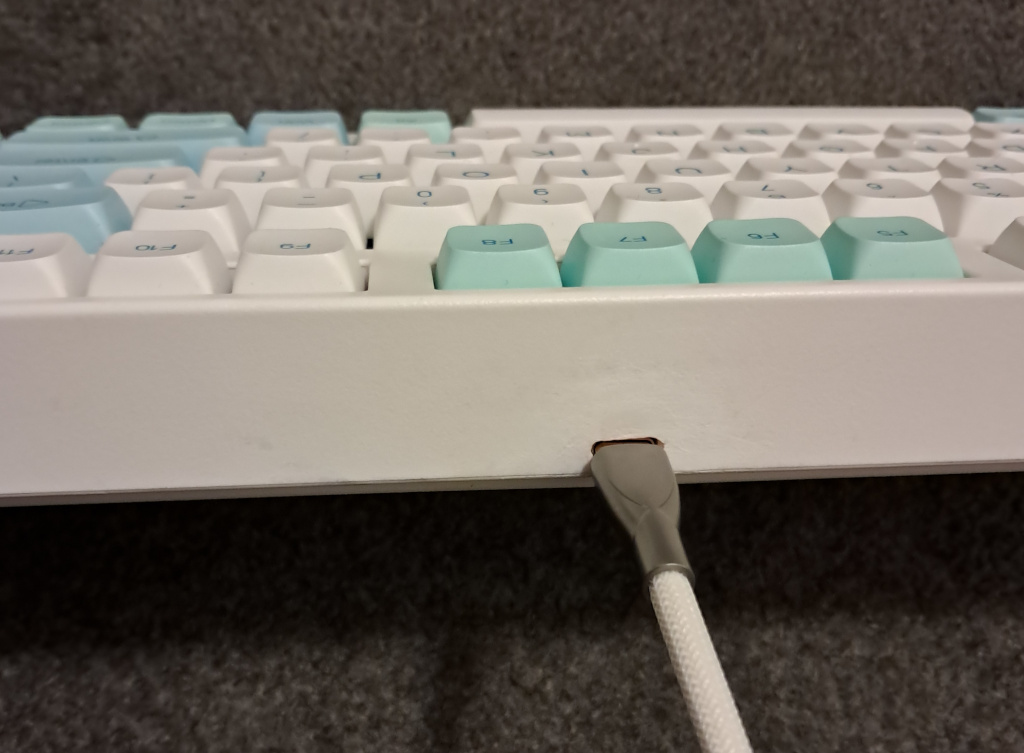

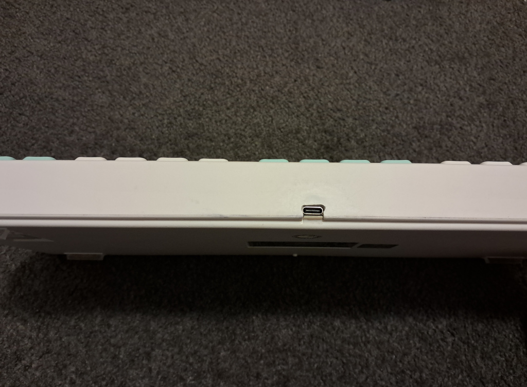

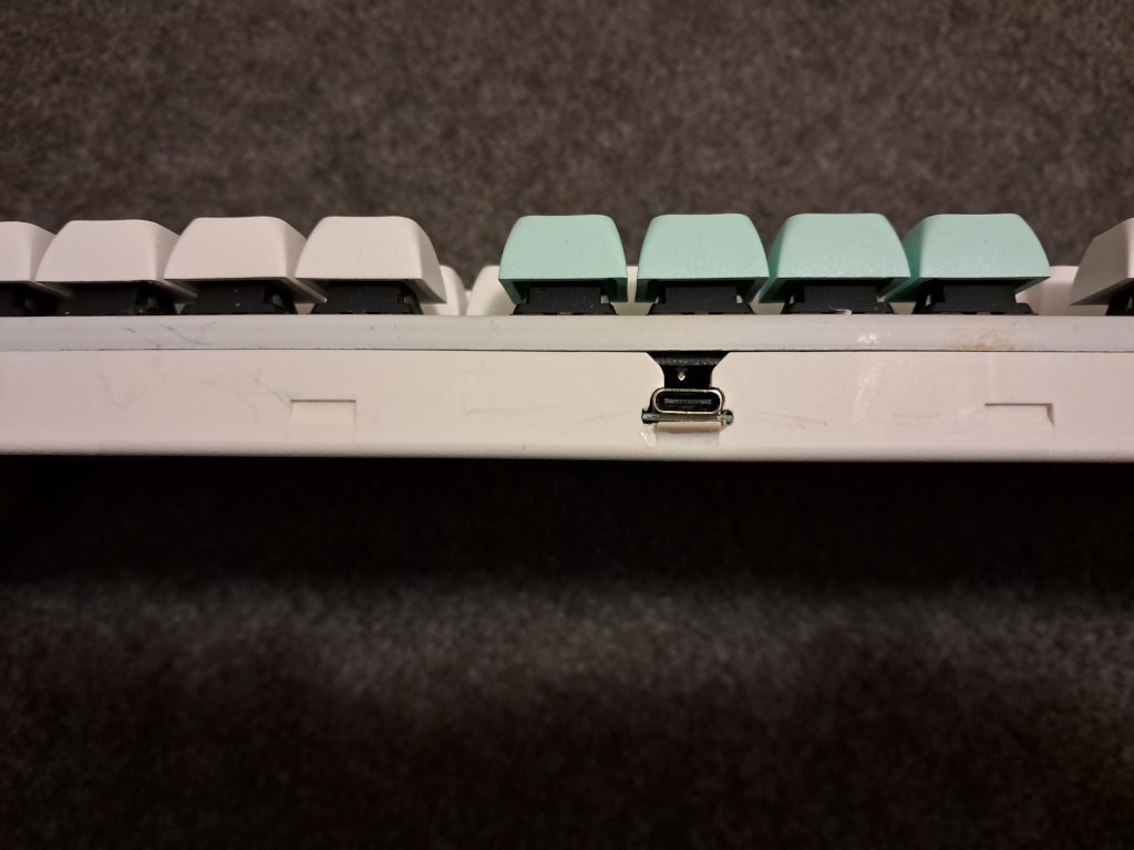

I actually made this very modification to a Filco Majestouch 2 Hakua that I purchased second hand a few years ago. I cut the cable and soldered on a USB-C female port. I got the instructions to do so from a youtube video. It's taken me a few days to find the link again, but here it is :
https://www.youtube.com/watch?v=e0O0fFIrijA
The results aren't perfect cosmetically, but it works :
I unfortunately wrapped the internals of the USB-C port in gaffer tape at the time, so the wires connected to it are not visible.
I used jewellery files to gradually enlarge the hole originally used by the cable to run out of the case until it was large enough to fit the USB-C female port. Note that the USB-C female port I used itself slightly protrudes from the small circuit board it comes with, which is how I was able to do this.
The USB-C female port is held in place by epoxy putty. Some sanding and painting was needed. As the epoxy putty is grey, it was a bit hard to paint over it.
The result is a recessed female USB-C port but it is still shallow enough for me to plug in my USB cable. It works, but isn't too pretty. Should you go this route, you'll probably do a better job than this.
