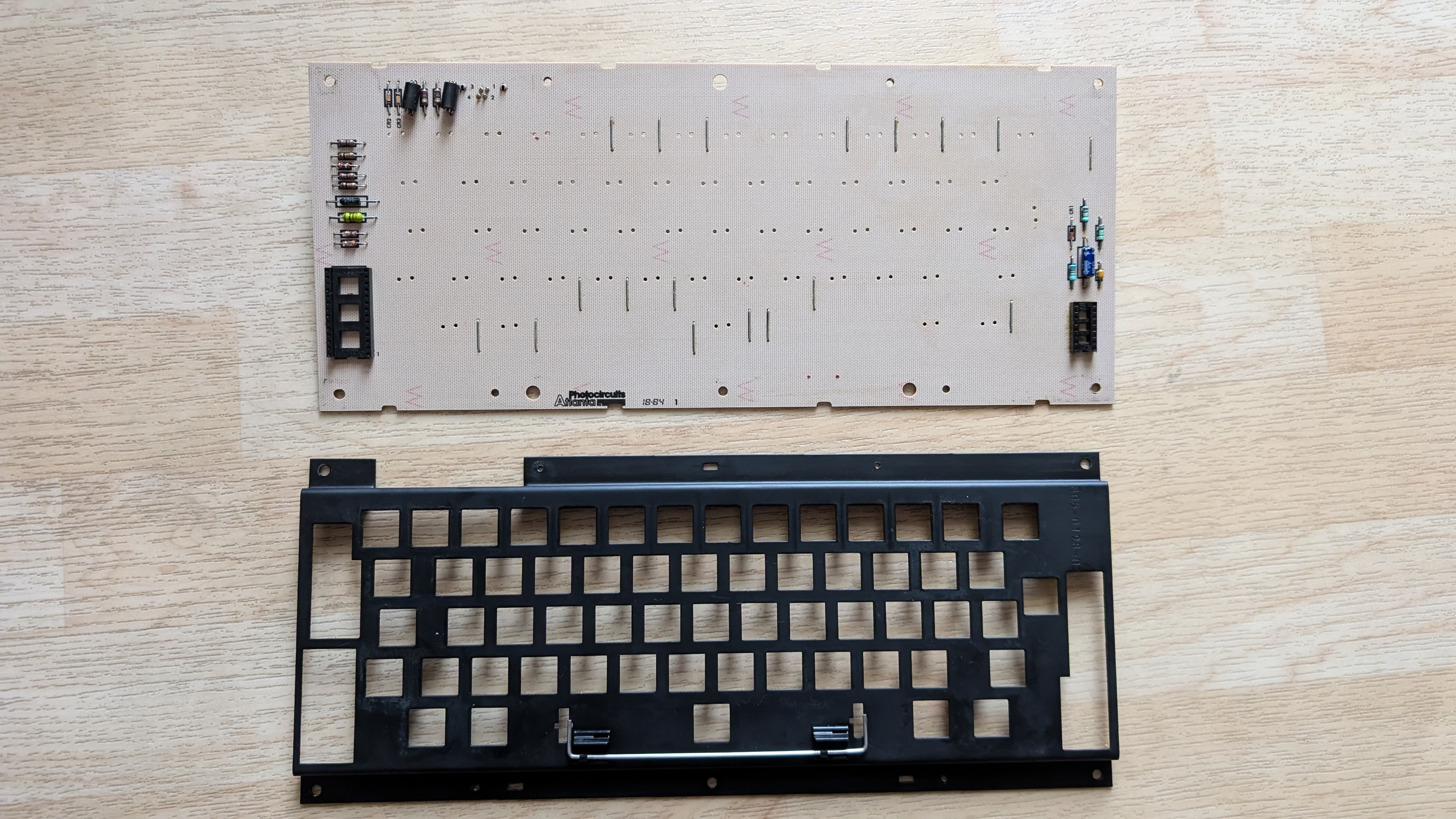

I have two (identical) M0110 PCBs/Keyboards. One with an Intel 8021 keyboard controller which works partially, due to a bunch of bad switches. Another PCB with an Phillips MAB8021P keyboard controller. It does not work at all. I cross-switched the controllers around. The Phillips IC does not work in the Intel PCB and the Intel IC does not work in the Phillips PCB. There must be some unknown difference between the two boards. I have to compare the passive components, resistor values, ....

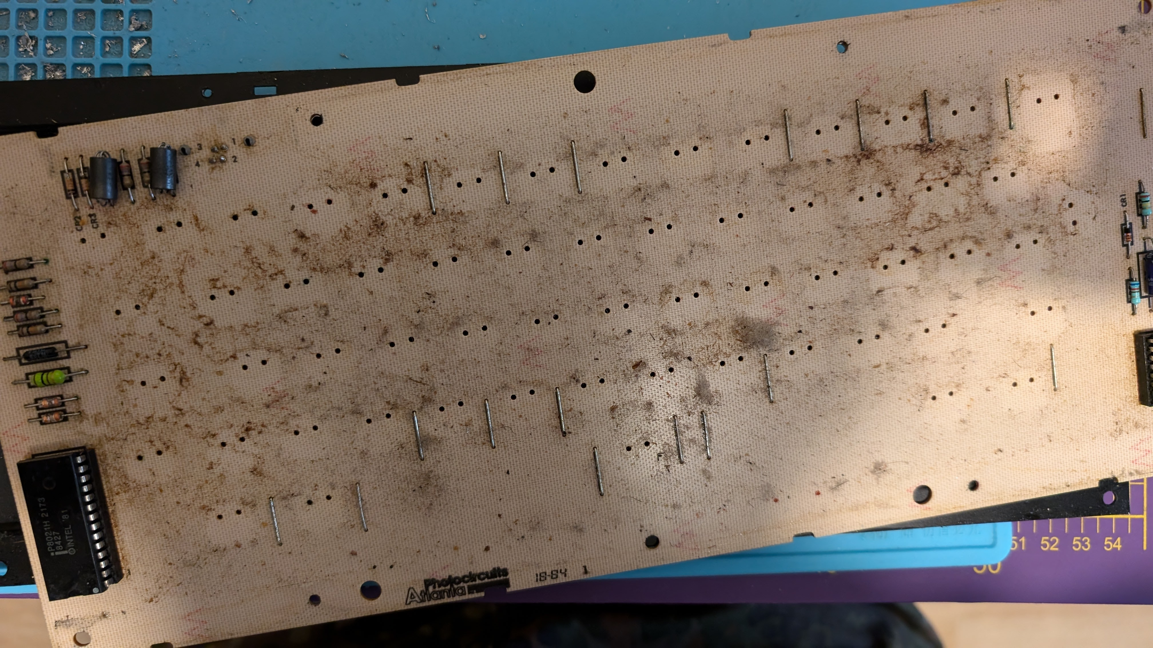

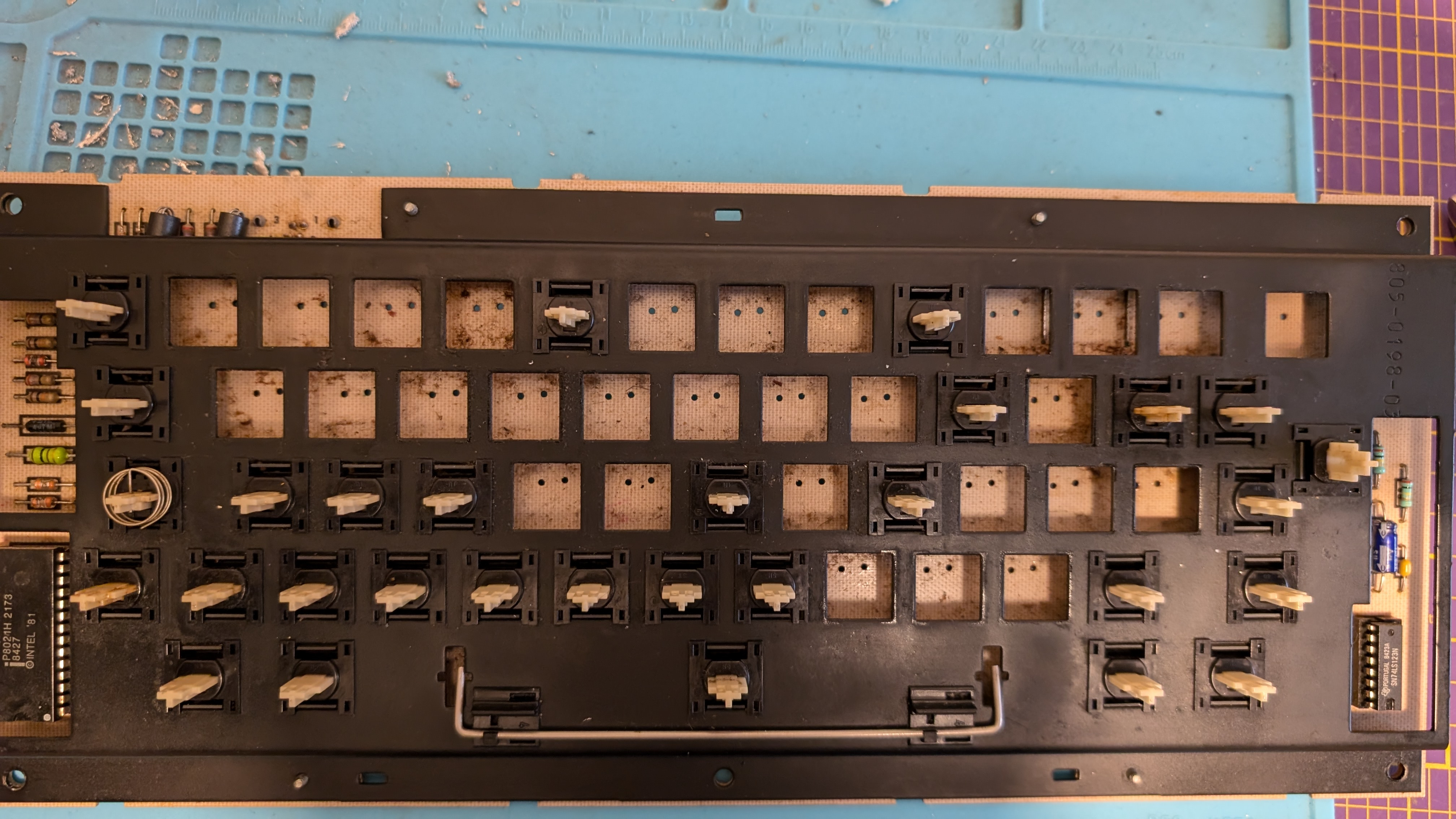

To get further I desoldered all switches from the Intel PCB. I checked all switches and 12 are dead. They dont conduct when checked with a multimeter. I took the opportunity and deep cleaned the PCB. Its worth it. I'll grab the missing switches from the Phillips PCB, but it would be a waste to declare it a parts donor. :-| Maybe there is a way to revive the bad switches and some way of replacing the possible dead keyboard controller.
