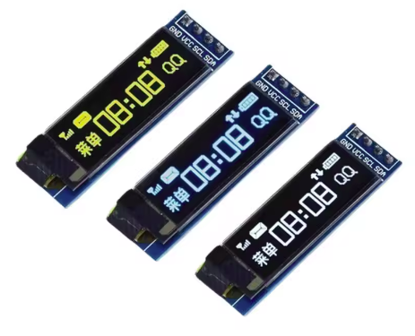

I have been using one of these in my projects
The interface is I2C which makes it easy to integrate with the Leyden Jar controller.
The actual selected OLED mainly influences the case design as a hole to display its content is needed. A clever case design would allow an additional part to be added as an option in case is used. It would also allow to add different versions provided that the interface of the controller is standard I2C.
