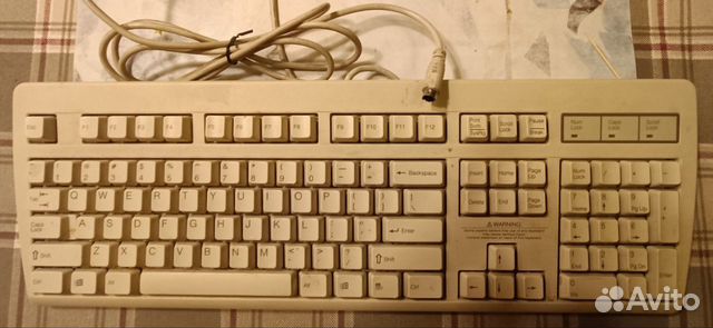

Found this on Russian eBay... What is it?
denis6627321
02 Jan 2026, 13:24

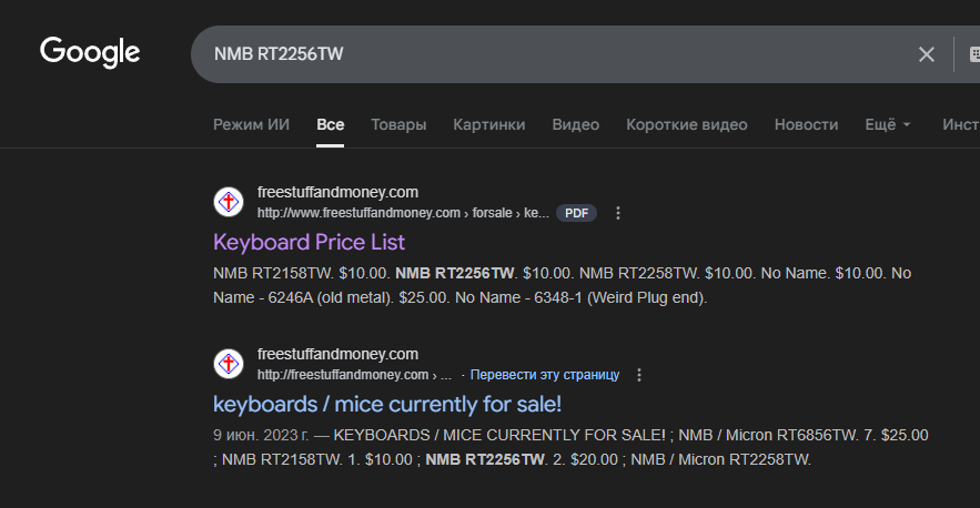

Googling the model name only gives one result, seller claims it's mechanical, can anyone confirm that? It's only $25 so I'm not afraid to take the risk and find out :D
04 Jan 2026, 19:29

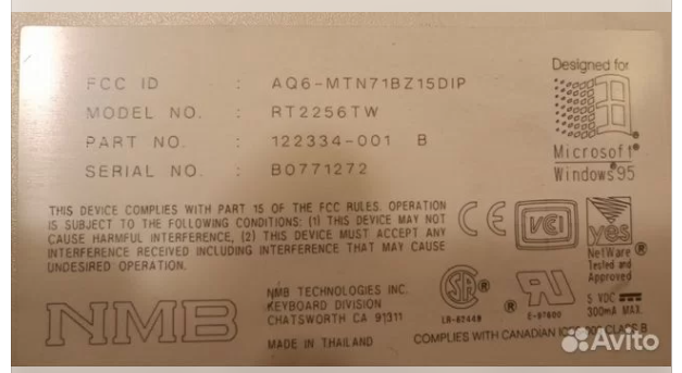

I don't know specifically about that one, but the RT2258TW looks identical from the top and has NMB dome with slider.
xxhellfirexx
05 Jan 2026, 02:04
MTN in the FCC ID indicates a dome with slider.
