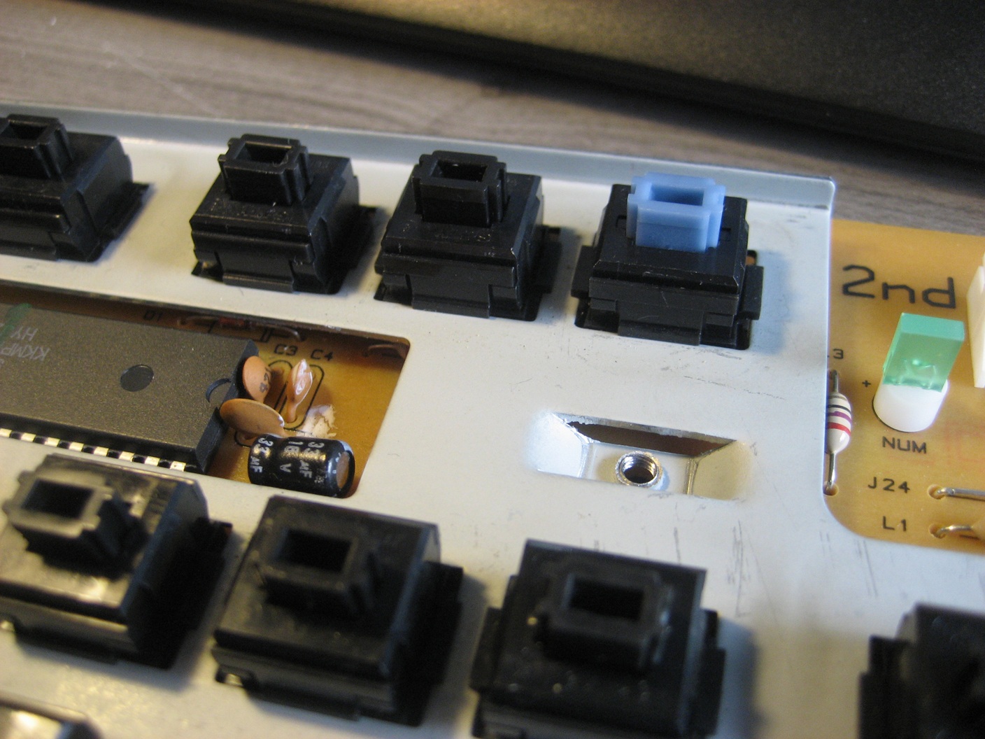

Hi guys,
I'm currently swapping my black ALPS switches with some blue ones but I was wondering if just replacing the stems, springs and leaves (so only the top part) would have the same result as desoldering everything from one keyboard and solder it back to the other.
Because it seems as though the bottom part is also slightly different, which would mean it's not a "true' blue ALPS switch anymore. I watched this guy to see how I can remove them: http://www.youtube.com/watch?v=AafYXUk413g
I can't say for sure that I notice the difference in just the top part being swapped, only a slight sound difference, which could be because they are two different keyboards..
If anyone has any wisdom in this matter, please do share!

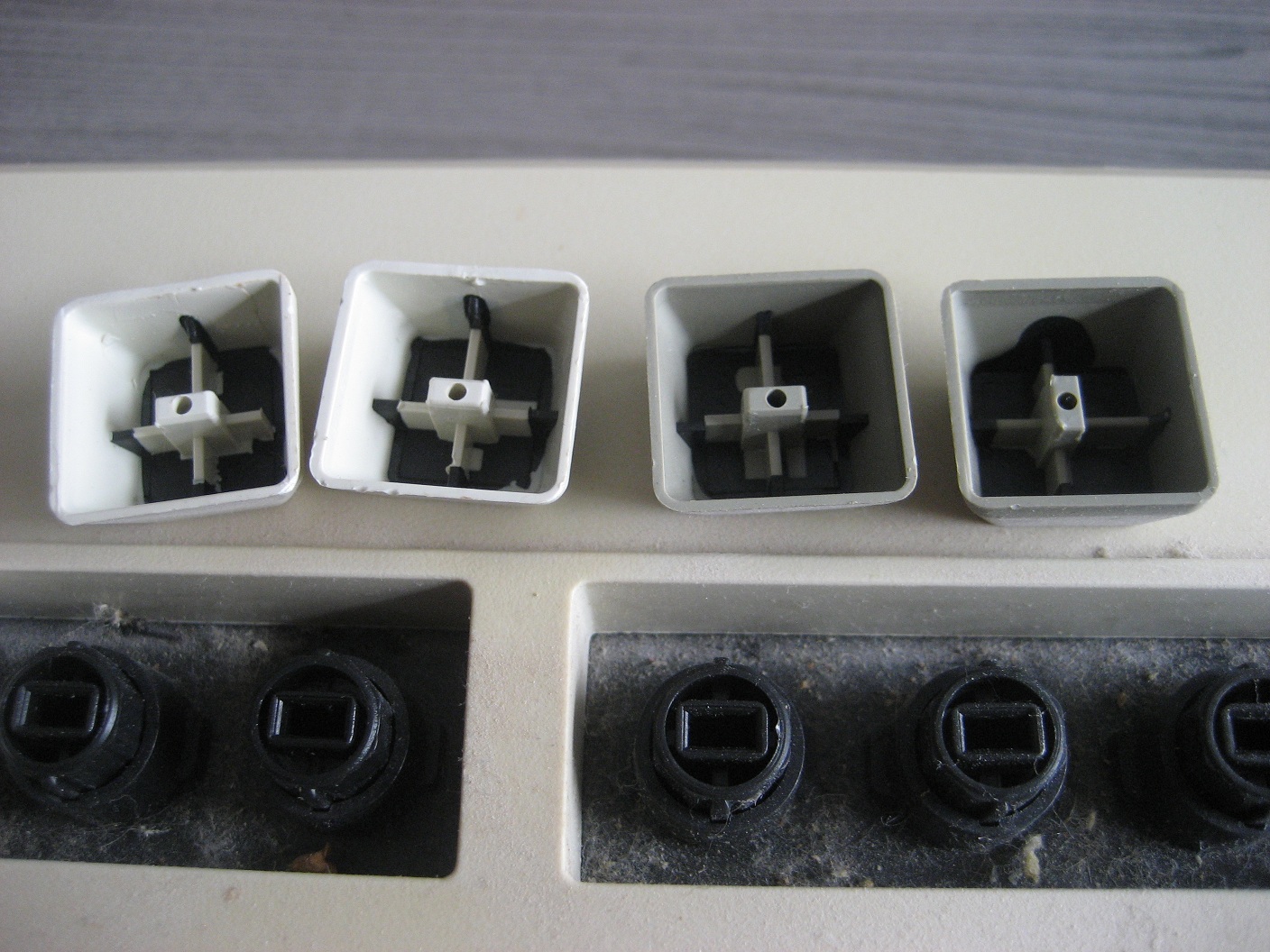

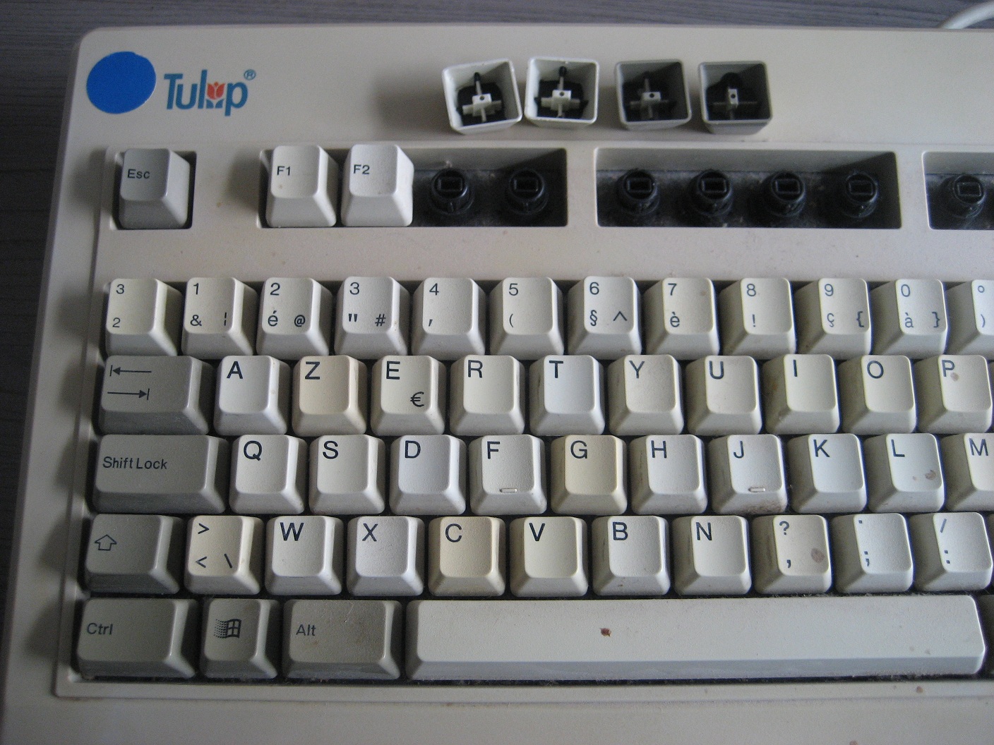

I got this dirty keyboard and it seems to me that this could be doubleshot ALPS keycaps. Can anyone verify this? It's a Tulip 11-500032-01. Here are some pics:
After some searching I found another one of these on the internet claiming to be a french layout keyboard. But that doesn't look anything like a french azerty in my opinion. Unless they have some underground layouts in france :p
Can anybody tell me what layout this really is and would anyone be interested in those if they are indeed doubleshots? Then I can contact the seller and get them, because I can't use all of those keys.

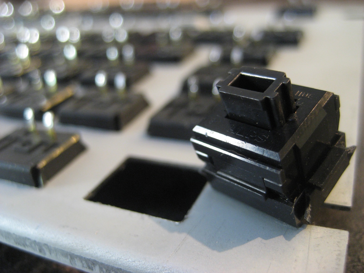

Blue ALPS usually do not have an ALPS logo on the top of the housing.

I also replaced the black ALPS on my Dell with white complicated ones.
You should also swap the top housing. The Logo in NOT the only difference, the parts of the top housing hit by the stem are also different. On a blue/white switche it makes the sound more 'deep'

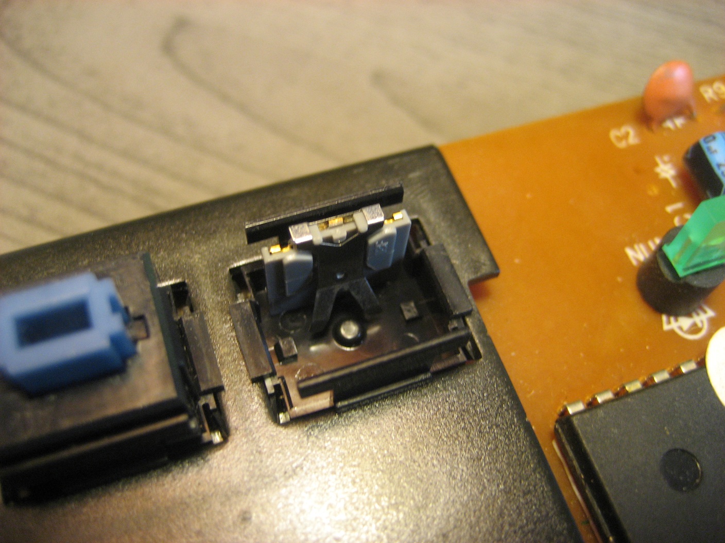

@hasu: I've tested them a little bit and I'm not quite sure what my impressions are. I would say when I use the grey contact plates it requires a tiny bit less force than when I use the white ones.
black alps - white plate
blue alps - grey plate
black on grey
black on grey
blue on white
blue on white

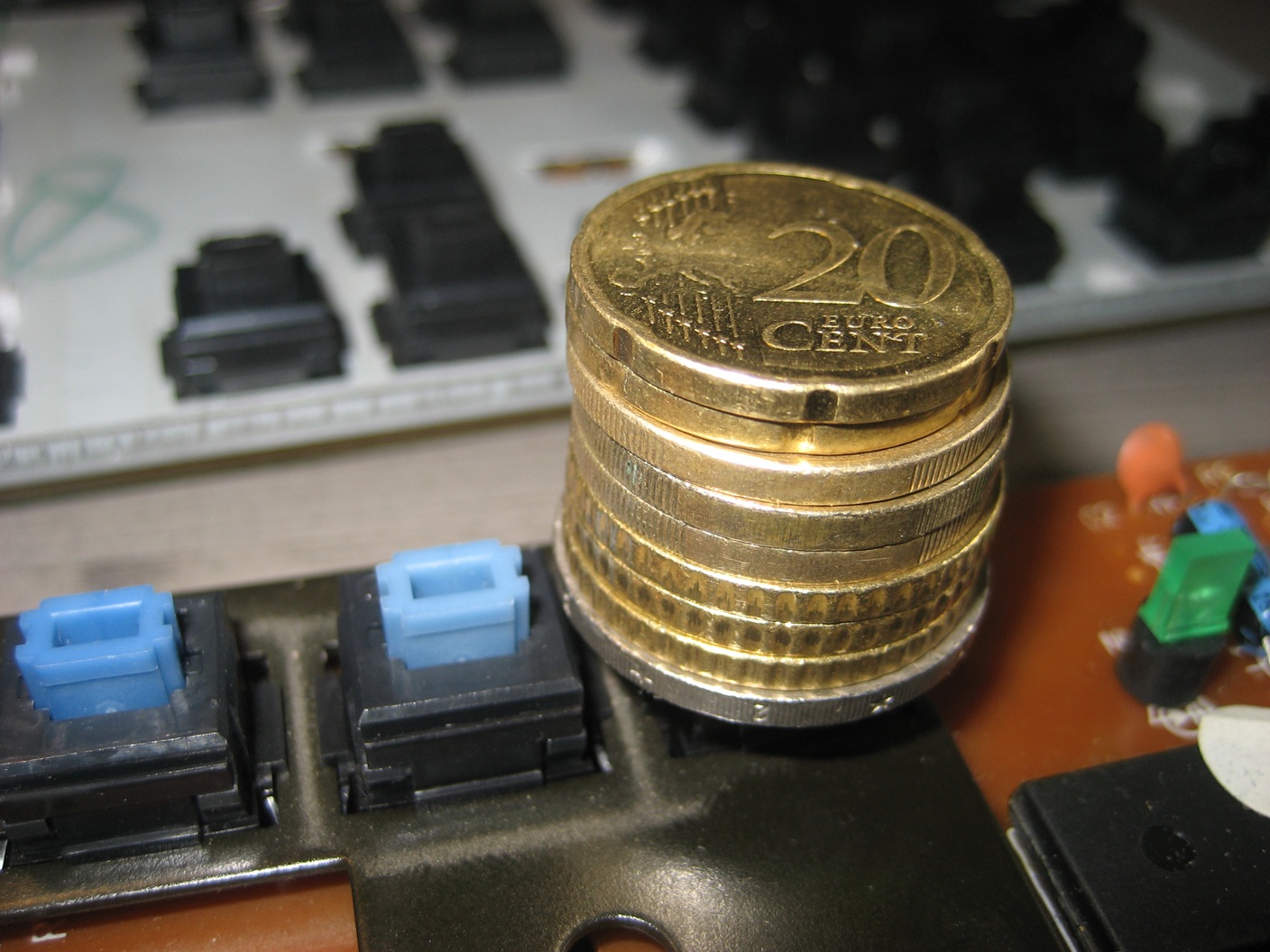

putting some coins on it
I've taken some pictures and tested it with some euro coins, although I would say that it's not very accurate since I noticed that some keys were easier to press than others (must be from the age and dust).
Here are the conclusions I made, which are not to be taken as correct measurements but just a little test:
black on white: 1x€2, 3x€0.5, 4x€1, 2x€0.2 = ~73 gr
black on grey: 1x€2, 3x€0.5, 3x€1, 2x€0.2 = ~65gr
blue on white: 1x€2, 3x€0.5, 4x€1, 2x€0.2 = ~73gr
blue on grey: 1x€2, 3x€0.5, 4x€1, 1x€0.2 = ~67gr

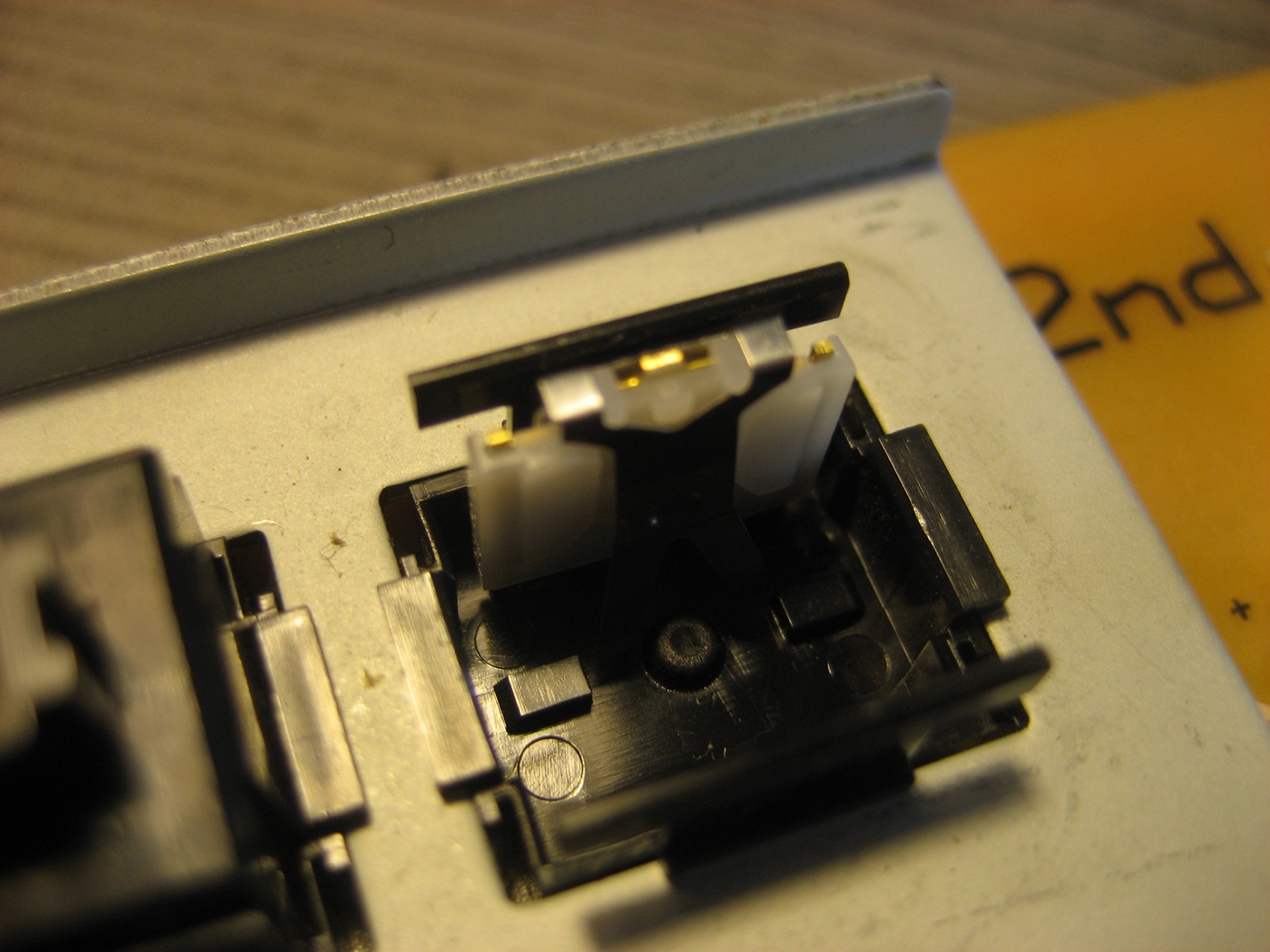

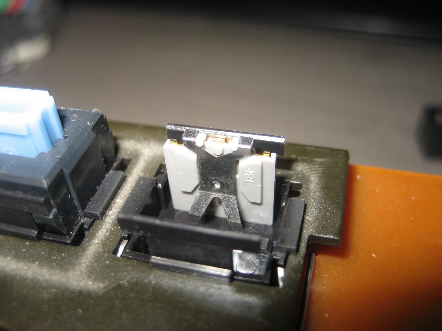

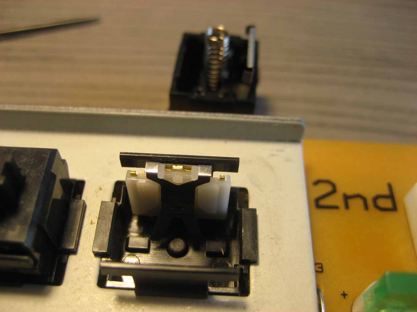

@ndp: What do you mean with the top housing? Do you mean the part that's connected to the plate?
white plate bottom
white plate bottom
grey plate bottom
grey plate bottom
I did in fact see a difference there from the beginning and also noticed a difference in sound. But then again, I also notice a difference in sound with different keys on one keyboard as well :)

Also small update on top: doubleshot keycaps or not? That's the question!

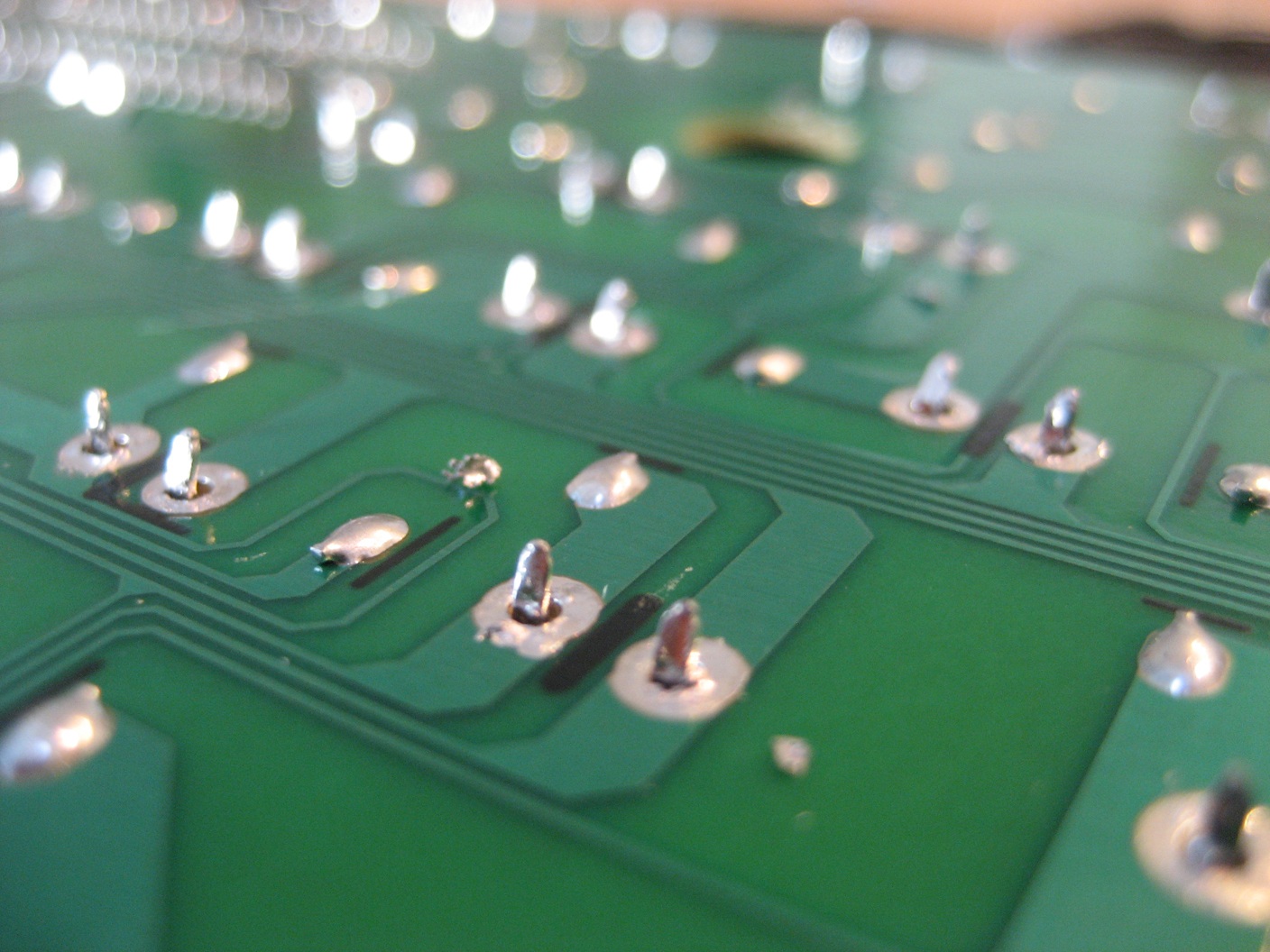

Paranoid
19 Jul 2012, 10:34

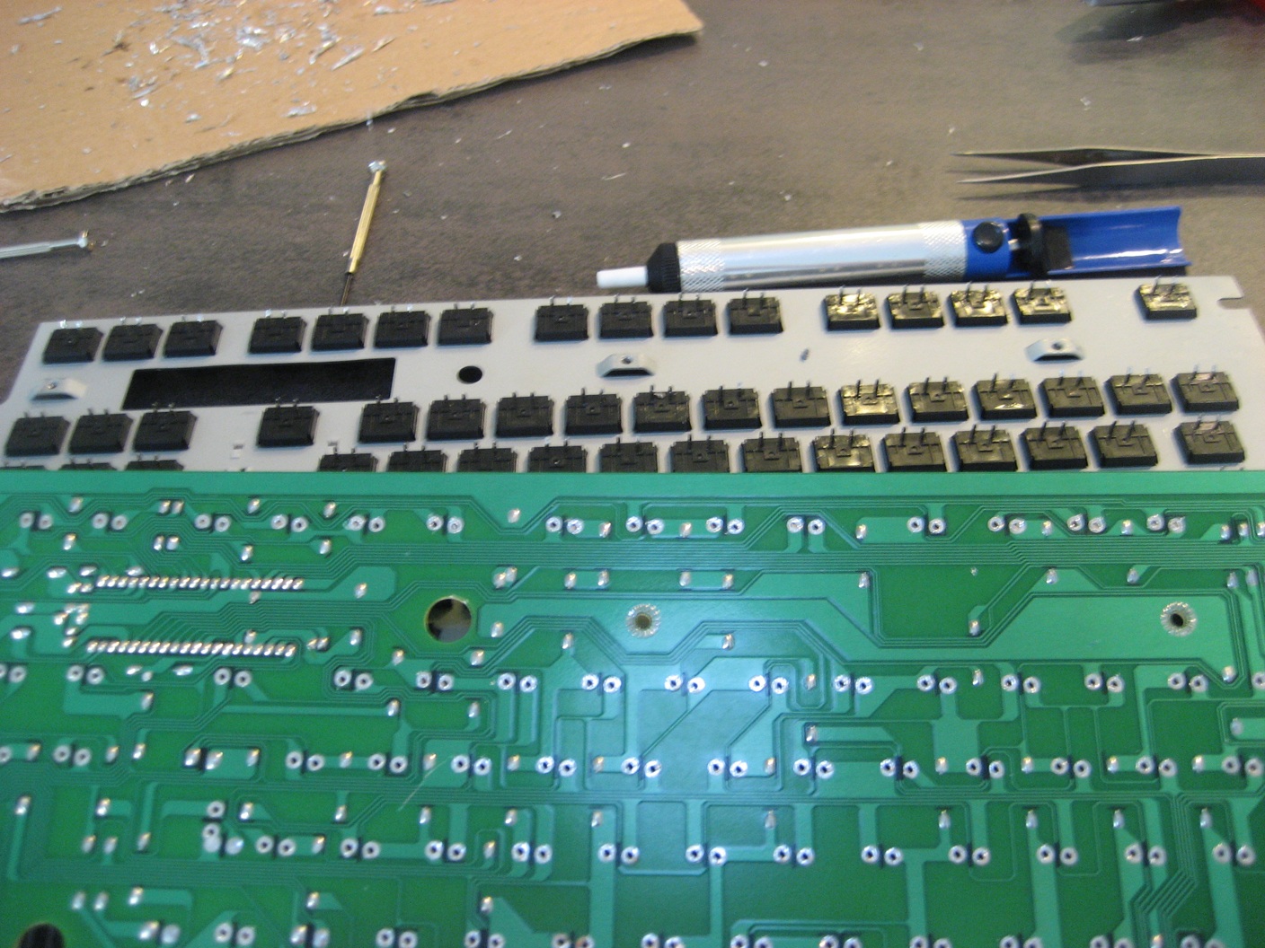

Well I got some solderwick yesterday but it didn't take too well with the solder that was on the boards. Could be the solder, the wick or the iron or the user :p But doesn't matter because I learned how to use the desoldering pump and it worked really well.
I desoldered two boards, folded the pins straight, took the circuit board off and took all the switches out. Desoldering took about half an hour per board once I got in the groove. In total the dissassembly took about an hour. The folding of the pins and getting every switch out one by one took some time :) next part is putting everything back in and soldering :p
I took some pictures of the process for anyone needing them. I'll post them tonight.
****Does anyone have a response wether those caps are doubleshot or not? And if they are woth something to ALPS users? Because I can get another one of those if anyone would be interested :)
Icarium
19 Jul 2012, 12:36
They are doubleshot but I doubt that there will be much interest in them.
Paranoid
19 Jul 2012, 20:03
Icarium wrote:They are doubleshot but I doubt that there will be much interest in them.
Alrighty then. I thought with all the doubleshot madness for MX some ALPS fans would enjoy them as well :)

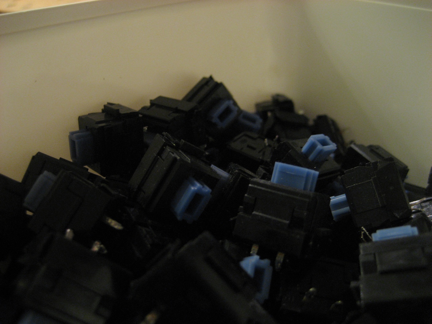

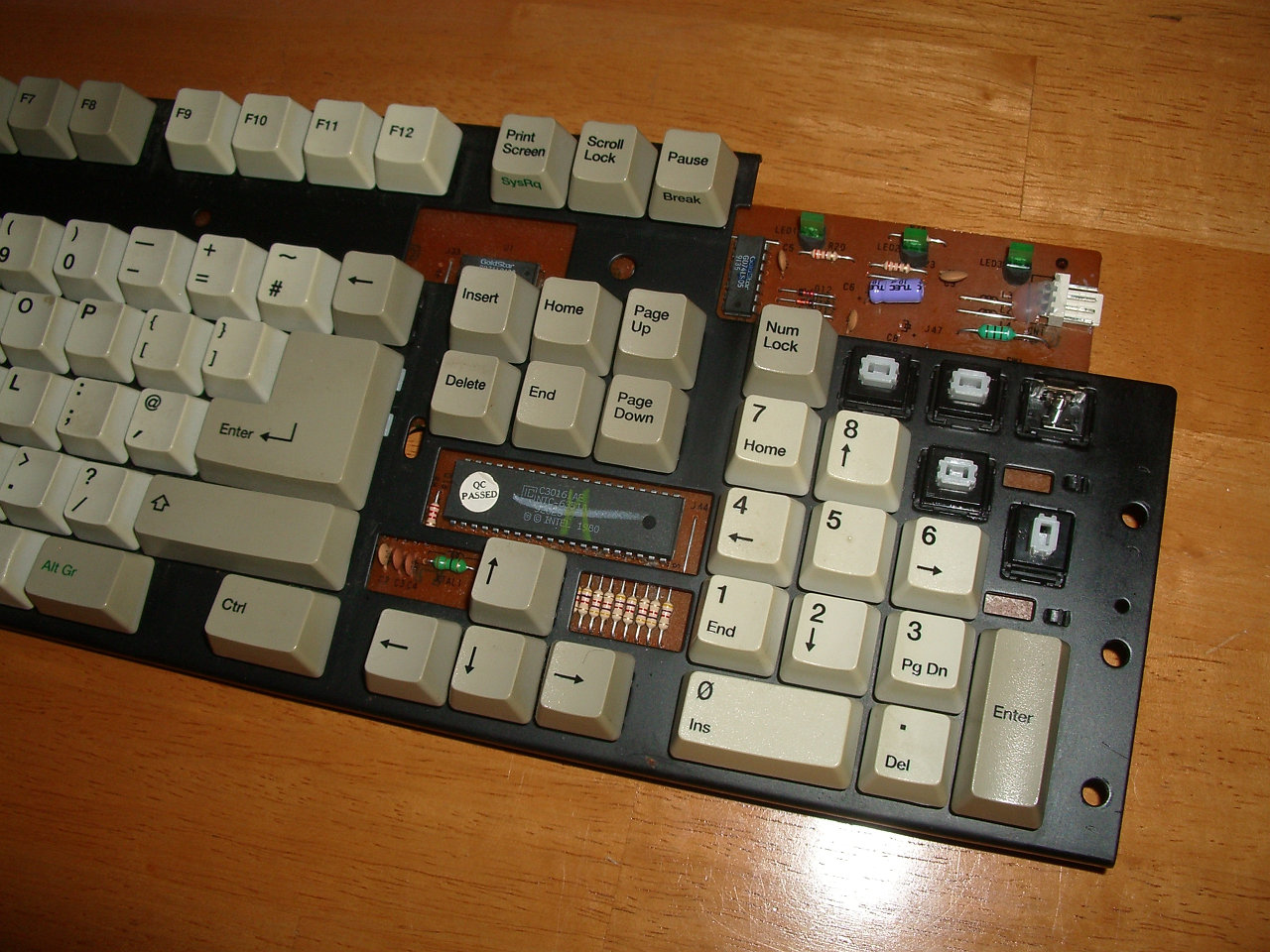

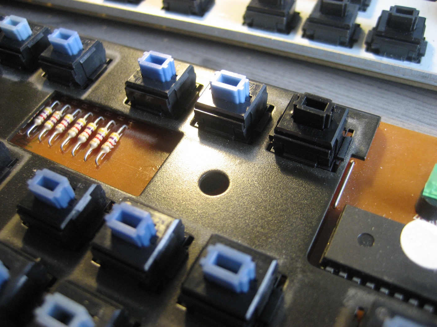

Anyway, here are the promised pics from the demontage of my Dell AT102W board. In the end you can also see the blue ones which came from a NanTan.
Solder removed and pins straightened
circuit board removed
switch removed
switch removed

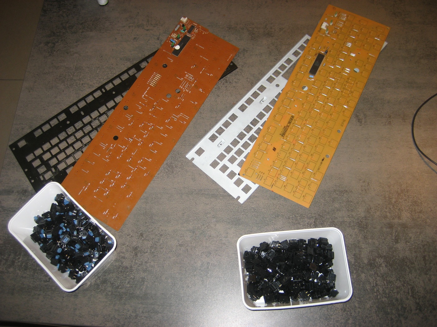

both boards desoldered

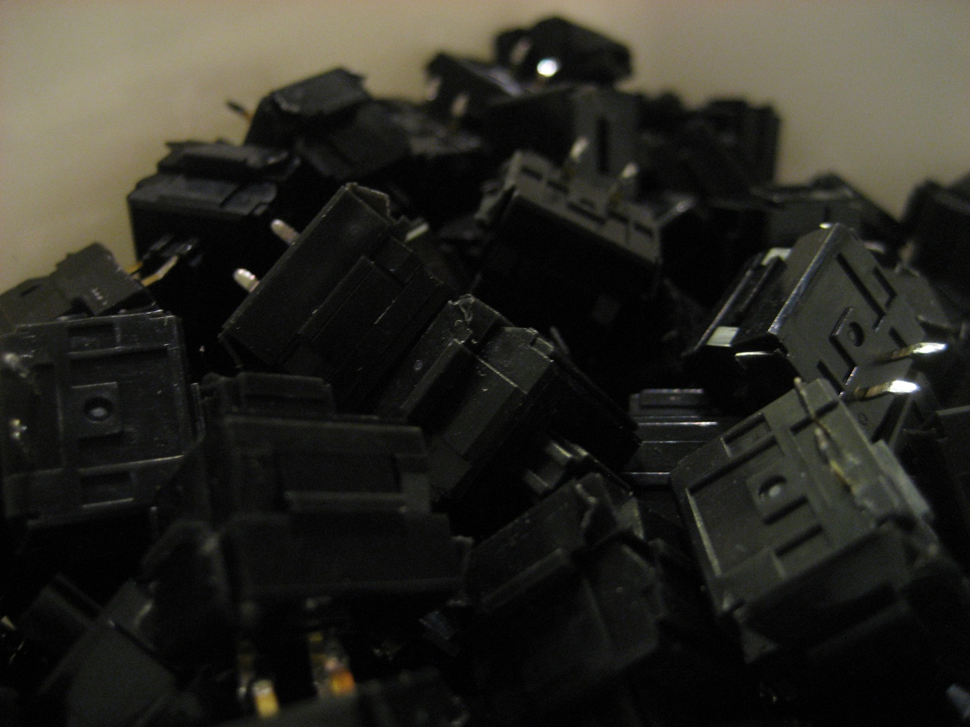

bucket of black alps
bucket of blue alps
bucket of blue alps

well, for desoldering I would highly recommend a desoldering pump. You can't get the solder off easier any other way. What you do is you place your iron on the soldered contact, wait untill it melts and then suck it up with your pump. You have to do this for all of the contacts of course.
After you've desoldered everything you probably have to fold the pins in an upward position (I guess this depends on the board but for an AT102/101(w) they are folded down against the motherboard). I used a simple tweeser to do this. One thing you have to be careful with is when the solder is not completely gone you could damage a small bit of the round circuit where you solder the contact on. Just be careful that you don't completely destroy that area so that you can still solder your new switches in. But normally it shouldn't be that much of a problem, just a heads up :)
The pins themselve are pretty though so you don't have to worry about it. At least I haven't broken any pins yet (I can't say the same for switch housings :p)
Double check if you have desoldered all pins. If you don't and you pull the pcb off, you break it. It happened to me once so there ;)
Now carefully pull off the circuit board, you don't want to break it in half. Depending if you have plate mounted switches or not you'll also have to remove each switch from the plate. You can do this by pushing back the small plastic flaps that you'll see are on the switch overlapping with the plate.
After that you have to do everything in reverse. Place the switches in the plate (in the correct position, check this on your pcb). Make sure your pins are pretty straight so you can easily put the pcb back on. Adjust the pins accordingly if they don't fit right away, don't force it. You can choose if you want to fold the pins back or not. And if so, if you do it before or after the soldering.
When soldering them back, make sure the switches are pressed against the pcb so that you don't have a wavy pcb or gaps here or there. Not that it really matters when you put it in the case, but just to put everything back together as you should and to make sure things fit again nicely.
Then to solder it, place your iron on the contact/round soldering area, wait untill it gets hot (don't wait too long, a couple of seconds tops) and push some solder against it so it melts nicely into place. If you do a couple of these you'll quickly see how it works and you'll get the hang of it.
It will take some time desoldering and soldering everything back together so there is no need to rush.
I would recommend doing it over some ventilation or the kitchen fan (hood?) to avoid those smelly unhealthy fumes. And also be careful not to stick yourself with the soldering iron, that's not so fun :p
If you want some visual stuff you can always Youtube it :D

It's not a question of colour (white vs grey), the difference is whether the switchplate (the plastic block that contains the contact mechanism) reaches the bottom of the switch housing. The original switchplate did, later ones did not. Typically the full-height switchplate was grey and the short ones white, but that's not the case for every batch of switches.
I don't actually understand what it is about the longer switchplate that is supposed to improve the feel, because the slider doesn't make contact with it. It's only theory. For example, Edgar Matias reported that Matias Corp had to drop the orange pigmentation in their sliders because it interfered with keyfeel. It may be that the shorter switchplate just coincided with other cost savings including a different plastic. Someone above also noted that the upper switch housing affects the sound. It's these kinds of subtleties that took Matias two years to design a switch, while companies such as XM just get it wrong every time.
As with most things Alps, the theory has not been rigorously tested. I do know that when I briefly played with a couple of vintage Macintosh keyboards (Macintosh 128k and one of the pink/orange Alps boards), they felt buttery smooth, not rough and scratchy like my NIB AT101W. However, I need a lot more evidence than a brief experience a couple of years ago to be sure (can't believe I didn't snap up that latter Mac board).
Interestingly, your black plate looks to be identical to the plate in my NTC 6153EN Type IV simplified board, while the PCB is completely different:
