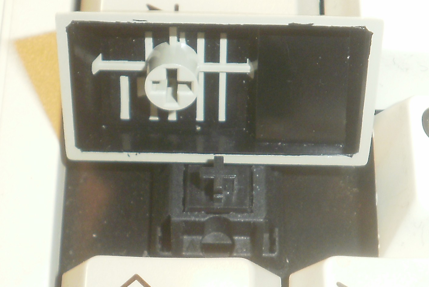

Wouldn't it be possible to make an adapter to fit off-center stemmed caps on center stemmed keyboards?
I compared the two and it seemed like there'd be place for an adapter, though it'd have to be small and from a very strong material.
One end would be like a cherry switch, the other like a keycap.
This would be much better than hunting for specific colors of keycaps. I'm sure there'd be interest in it if it would be possible to manufacture.

csimi wrote:Wouldn't it be possible to make an adapter to fit off-center stemmed caps on center stemmed keyboards?
Interesting idea, I never thought of that. I'll try and make something to see how it would look.
damorgue
29 Aug 2012, 12:14
Did you mean something like this?
Judging by the looks, it will be weak in the thin part in between the stem and the stem fitting.
csimi
29 Aug 2012, 12:26
Something like that but a lot more complicated since the piece connecting the two parts together would block the switch from going down this way.
This probably increases the price a lot and you'd need some really strong material for it but I think being able to use all kinds of different caps locks (imsto dyesubbed stepped off-center stemmed for example) would be worth quite a few bucks.
damorgue
29 Aug 2012, 12:43
Turns out that one was very weak anyway, even with some ribs to strengthen it.
We would want to avoid it deforming or flexing since that would mush up the feel.
29 Aug 2012, 12:43
Nope, there is absolutely no room for that because the positions of a centered stem and an off-center differ by only ±5mm while the switch has a width of >10mm.
So the original stem must be removed as it will hit the top of the switch.
damorgue
29 Aug 2012, 12:45
It seems that way. I made a new one which allows the stem fitting to go into the switch housing (the previous one did not which was kind of stupid) Anyway, they are too close
29 Aug 2012, 12:51
CapsLock, center vs.jpg (167.26 KiB) Viewed 44169 times
You could could of course leave a bit of the original stem, but that wouldn't be enough to allow such a device to be affixed to it.

damorgue
29 Aug 2012, 12:55
This is about as close as they can get while still allowing the stem fitting to enter the switch housing as well as allow the fitting of the cap to not interfere with the bridge. kbdfr is right, they can't be made close enough.

Well, I guess adapters could be used where the difference is larger, say space bars, but the interest there is too low to do anything about it.

Maybe the connection can be routed at the side? There seems to be more space there.
It'd have to be made from some sort of NASA grade material though.
damorgue
29 Aug 2012, 13:25
Nope, I thought of that, but the stem itself interferes with the switch housing, even without an adapter. As pointed out by kbdfr, the distance it needs to be moved is so small that it really isn't possible without modifying/removing either the stem fitting or the switch housing since those two will clash otherwise.
