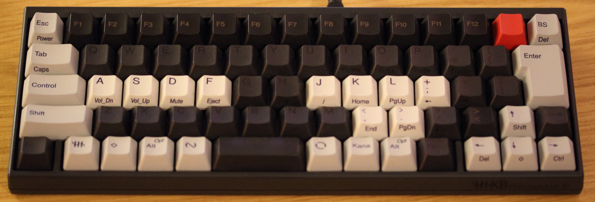

Last summer, I decided to get myself a HHKB in order to make my desk more ergonomic (HHKB + Trackball).
As I love the ISO return key (and hate its feeble ANSI counterpart), like arrow keys, and enjoy having extra keys to either type in japanese or have custom bindings... I got an HHKB Pro JP from GS4U (and they kindly made JP keysets available at my request, with a discount on the original price :mrgreen:).
Now that I've got you bored, I can unnoticeably get to the serious bits.
My HHKB
My HHKB

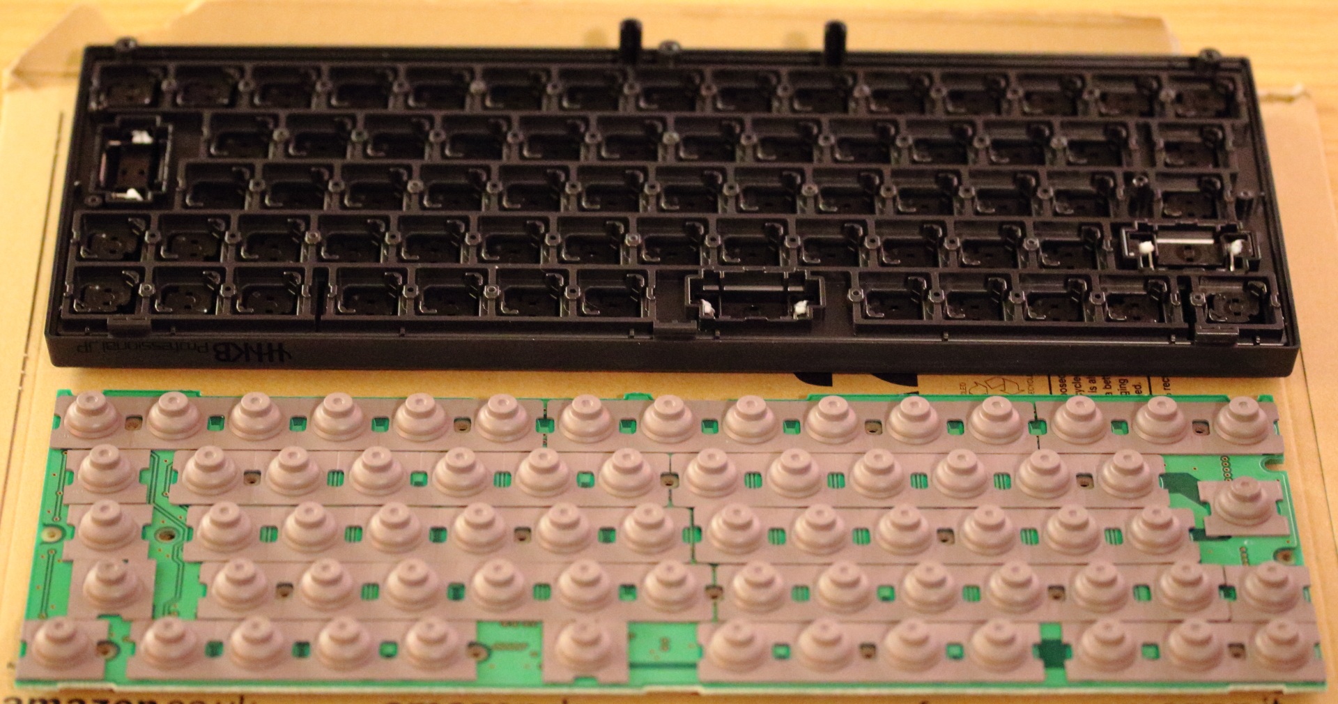

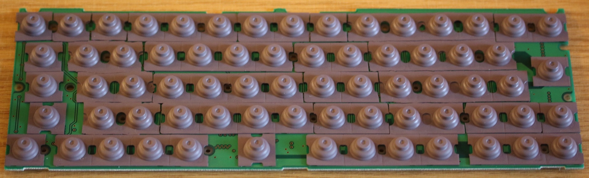

Here are the HHKB original domes, which you get to see after opening your HHKB
(gently, or you might break the controller's connector!) and unscrewing the keyboard PCB:
My HHKB's original innards
I went through each of the row halves, cutting and replacing appropriate 45g domes with the 35g and 40g cutted from the RF, building the new variable force dome layout on the plastic plate (pay attention to the springs, they can easily get caught into your sleeves and jump around):
My HHKB's new innards

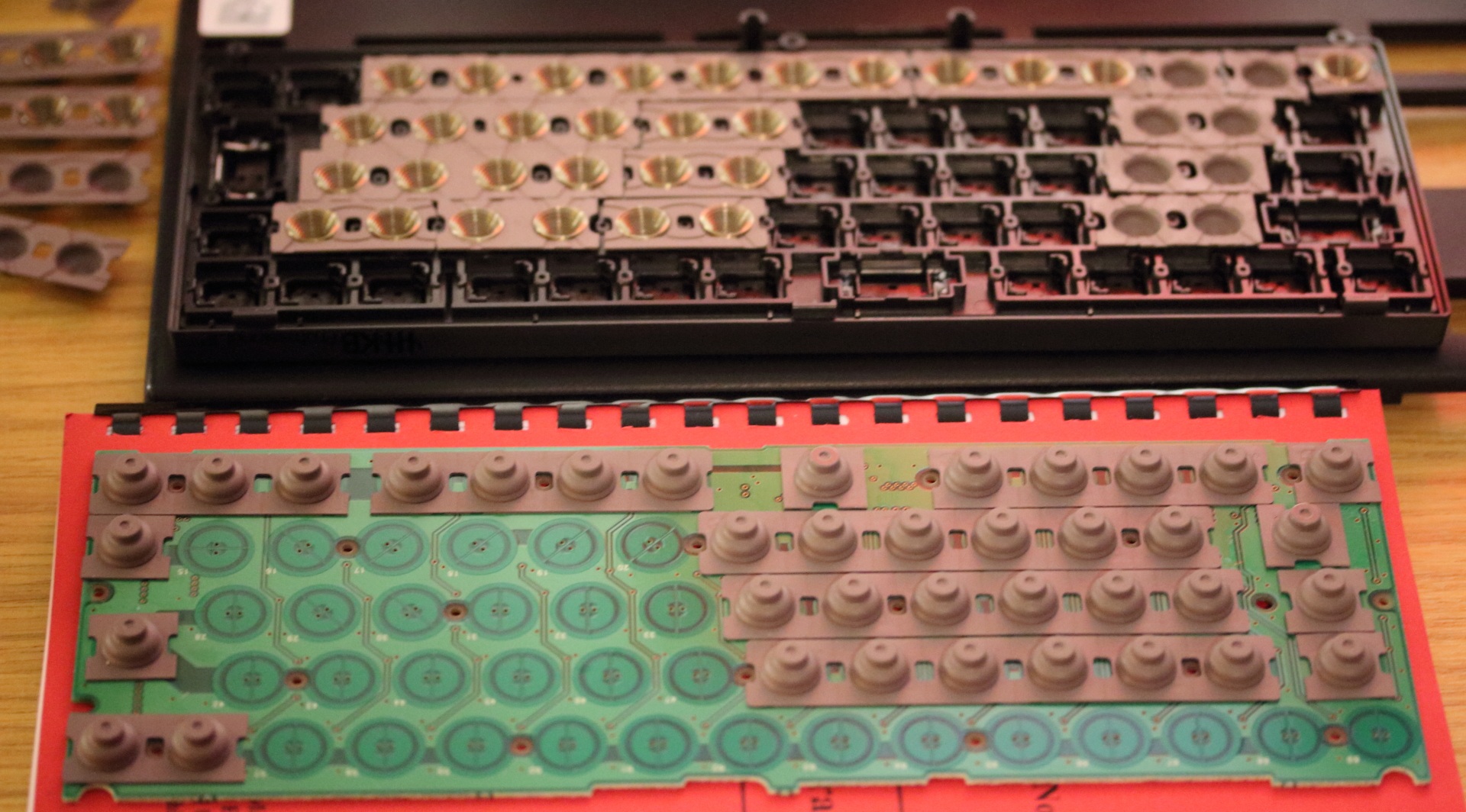

Here's a snapshot of my RF domes after the Frankenstein moment:
My RF's new innards
My RF's new innards

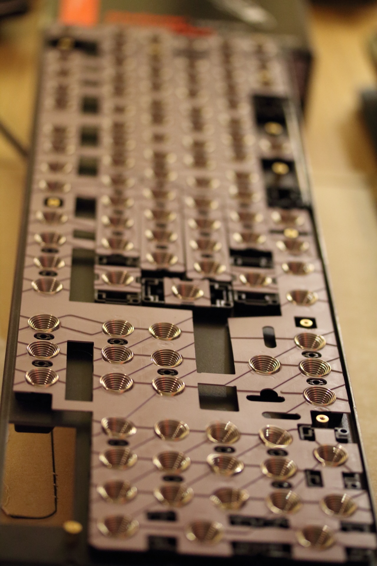

And the HHKB domes (taken after a later disassembly):
Dem sexy domes!
Dem sexy domes!

In the end, you get a variable force HHKB (35-40-45g) and a uniform Realforce (45g), both in working condition.
The HHKB felt (and still feels) as intended : fantastic — to those who like variable force, that is.

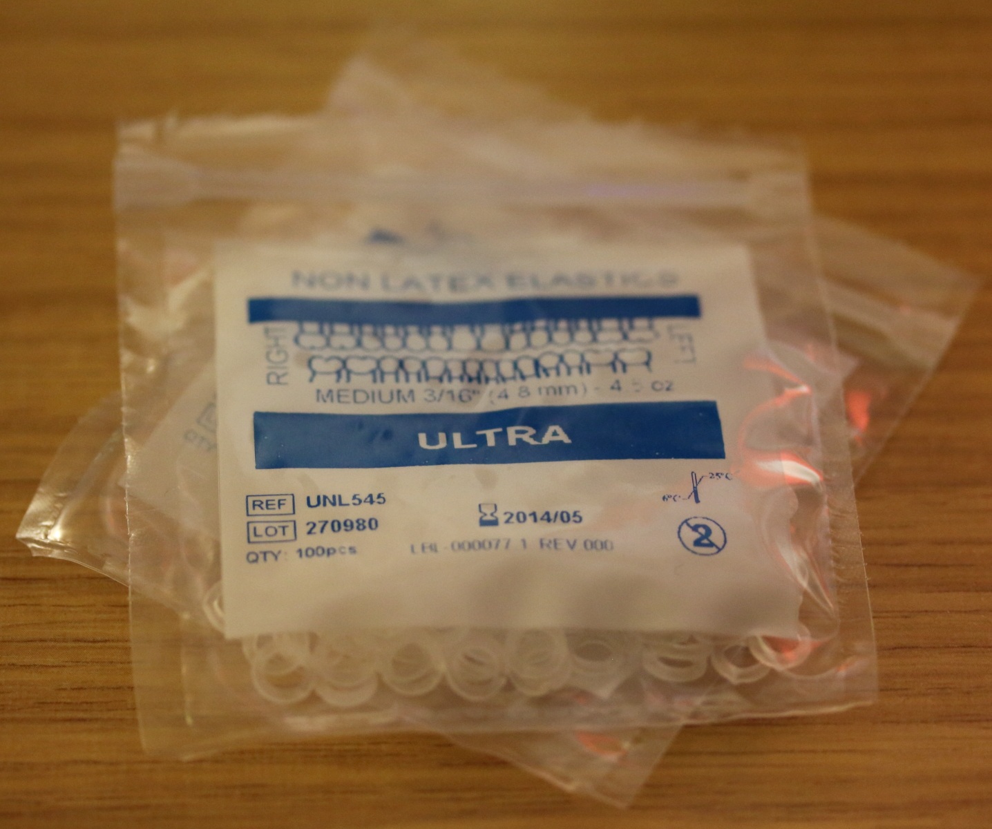

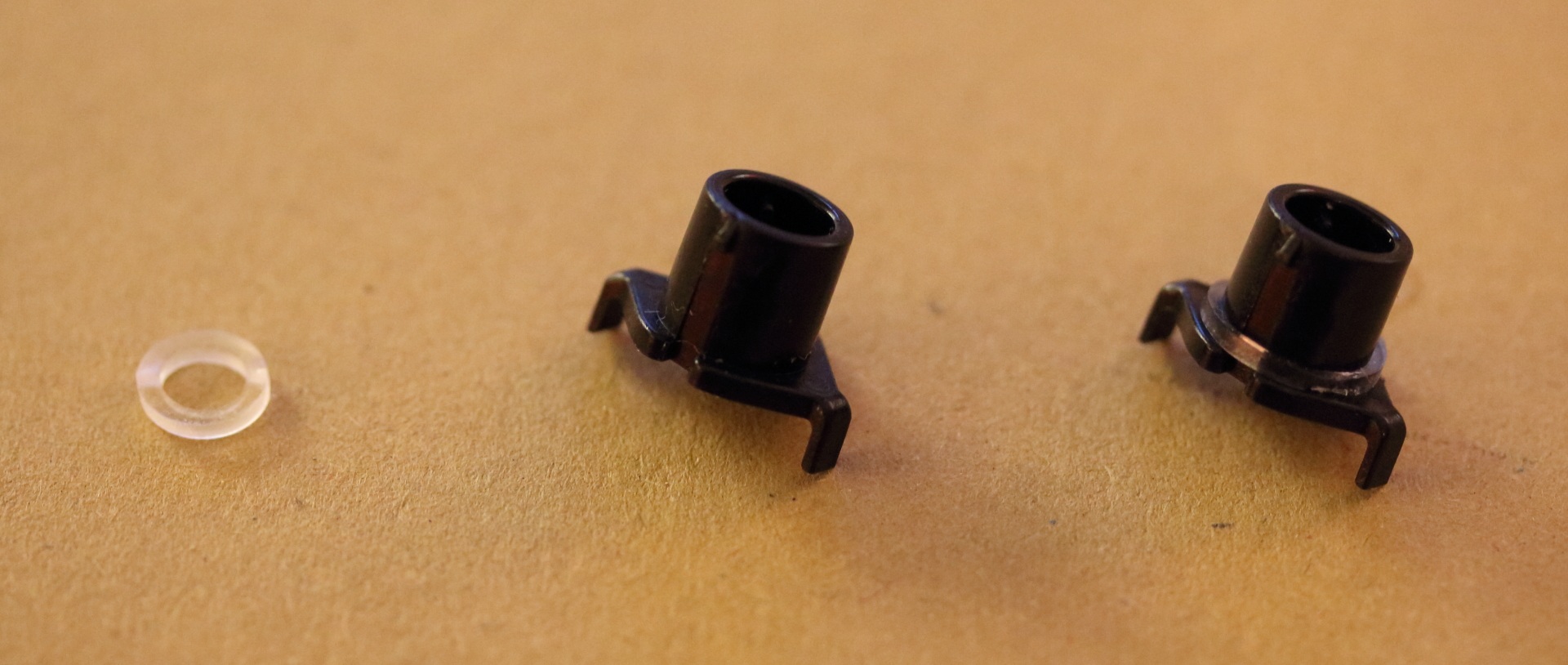

So I got non-latex orthodontic rubber bands from eBay (4.8mm diameter)
Orthodontic rubber bands
and started the funfest, removing all the keycaps and the “hammers” which push the domes down, to rubber them up :)
Hammer + Rubber = Hamber?
before putting everything back together.
The final feeling was.. okay.
Not as thrilling as I thought it would be, and I didn't quite like the way it reduced the travel distance (and thus overall feeling), though I more or less got used to it after 2 weeks.

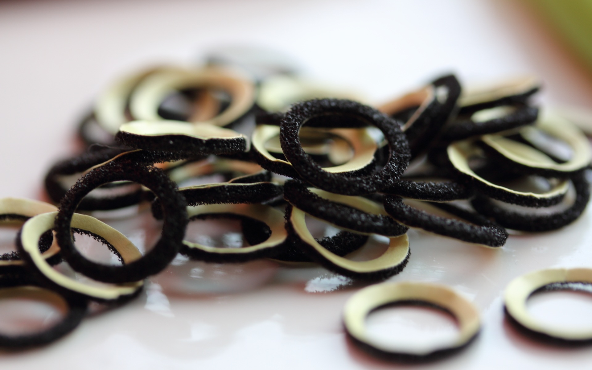

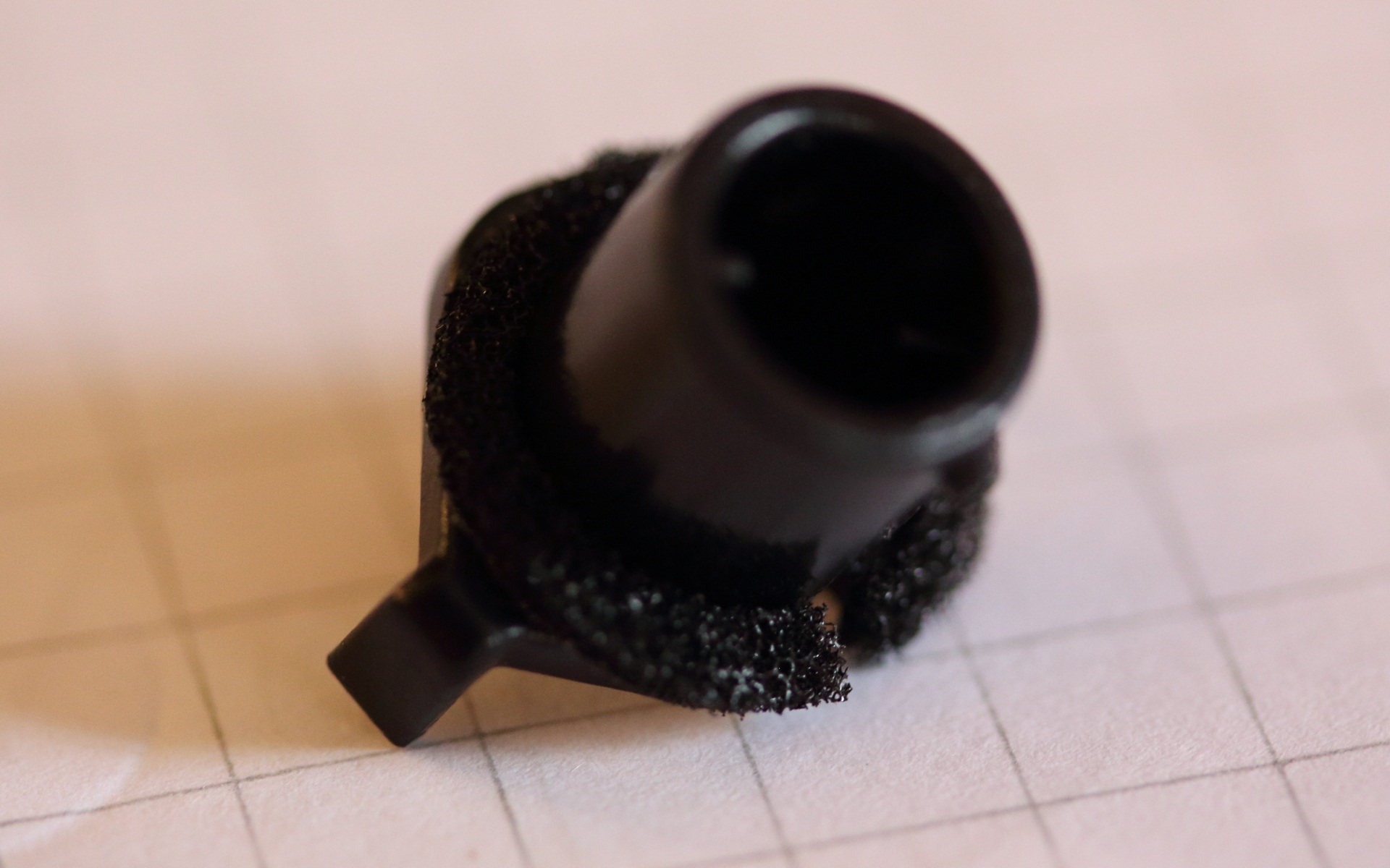

Mod #3 – Foam-based silencing
(Original idea found here: http://geekhack.org/index.php?topic=349 ... #msg663926)
I liked this idea and wanted to try it out (again!).

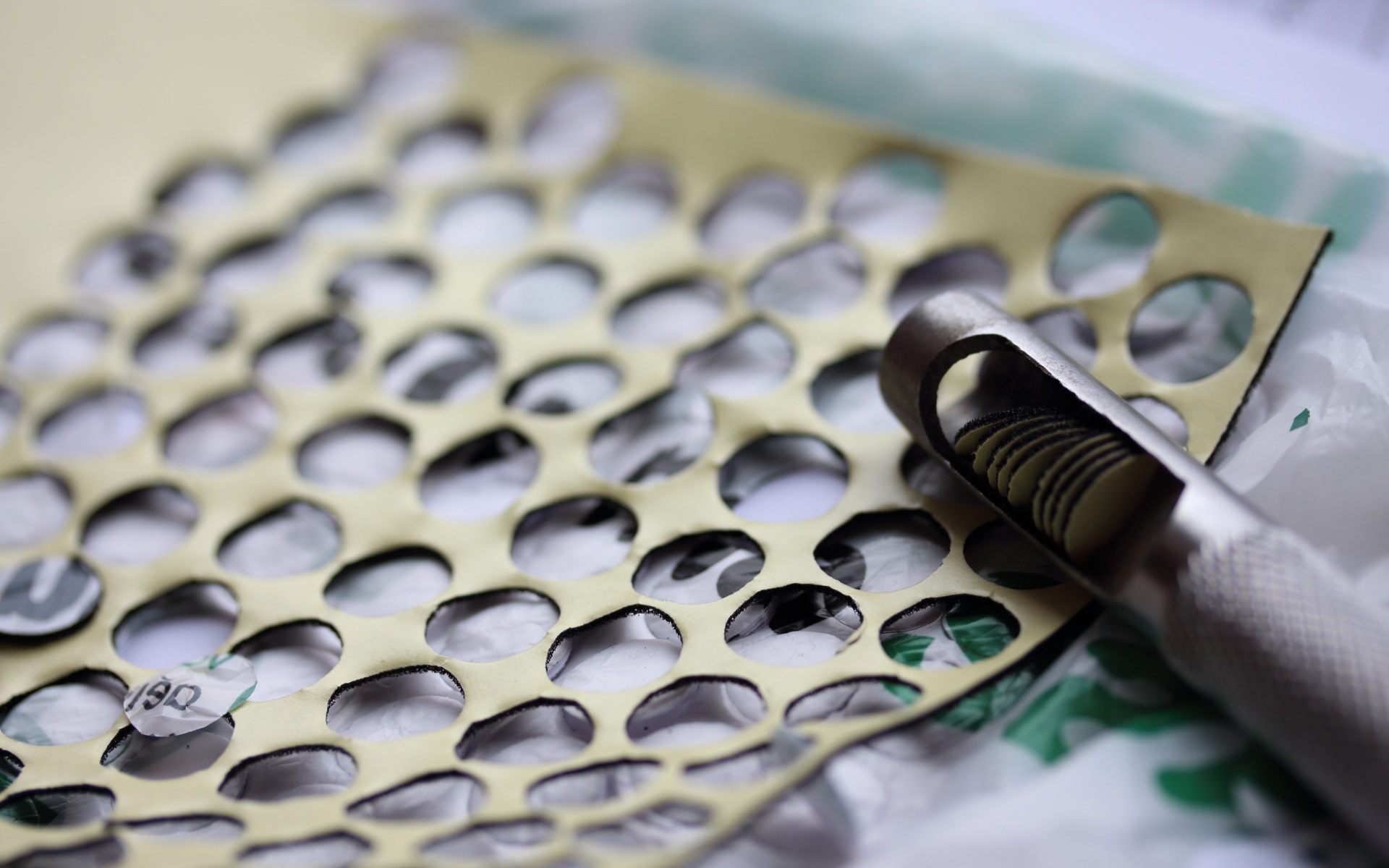

Thus, I ordered this http://www.micro-tools.de/en/Camera-Res ... -12cm.html, and some leather hole cutters (you need these sizes: 5/16" + 7/16" / 0.80cm + 1.11cm).

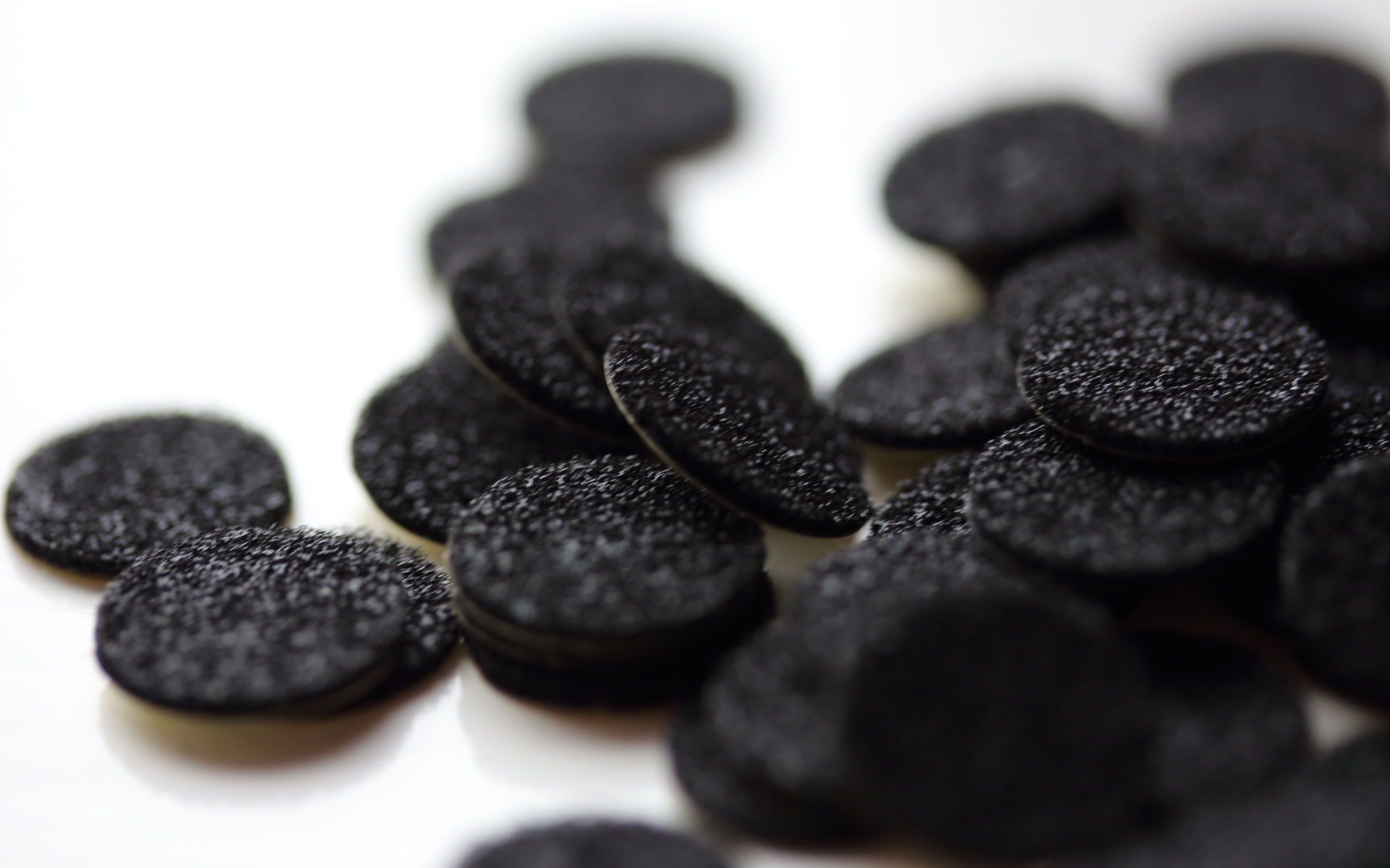

After ensuring the cutters were a good fit etc., step 1 is cutting large (7/16" / 1.11cm) foam disks.
I used (obviously) a cutter, a hammer (hit twice or thrice), some magazines underneath (something which gets cut too, making sure you cut right through the foam), and chose to put the foamy side underneath:
Large cutter
Large cutter
Foam disks
Foam disks

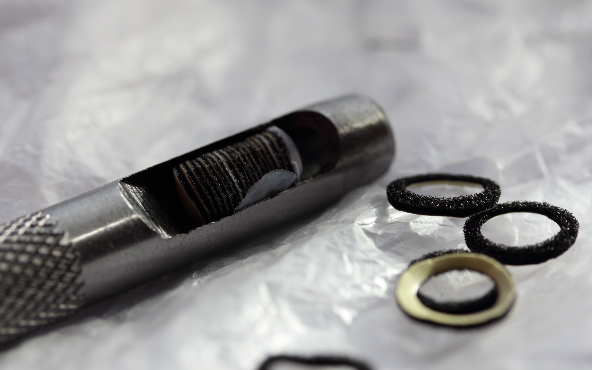

When you have enough disks (and extra ones, too, you never know), you can proceed to cutting them, again.
Used the same technique, taking extra time to make sure the small cutter was well centered on the disks.
Small cutter
Small cutter
Foam rings to rule them all, foam rings to find them, foam rings to bring them all and in the darkness bind them
If you can still feel your hand after ±400 times hitting cutters with a hammer: Congratulations !

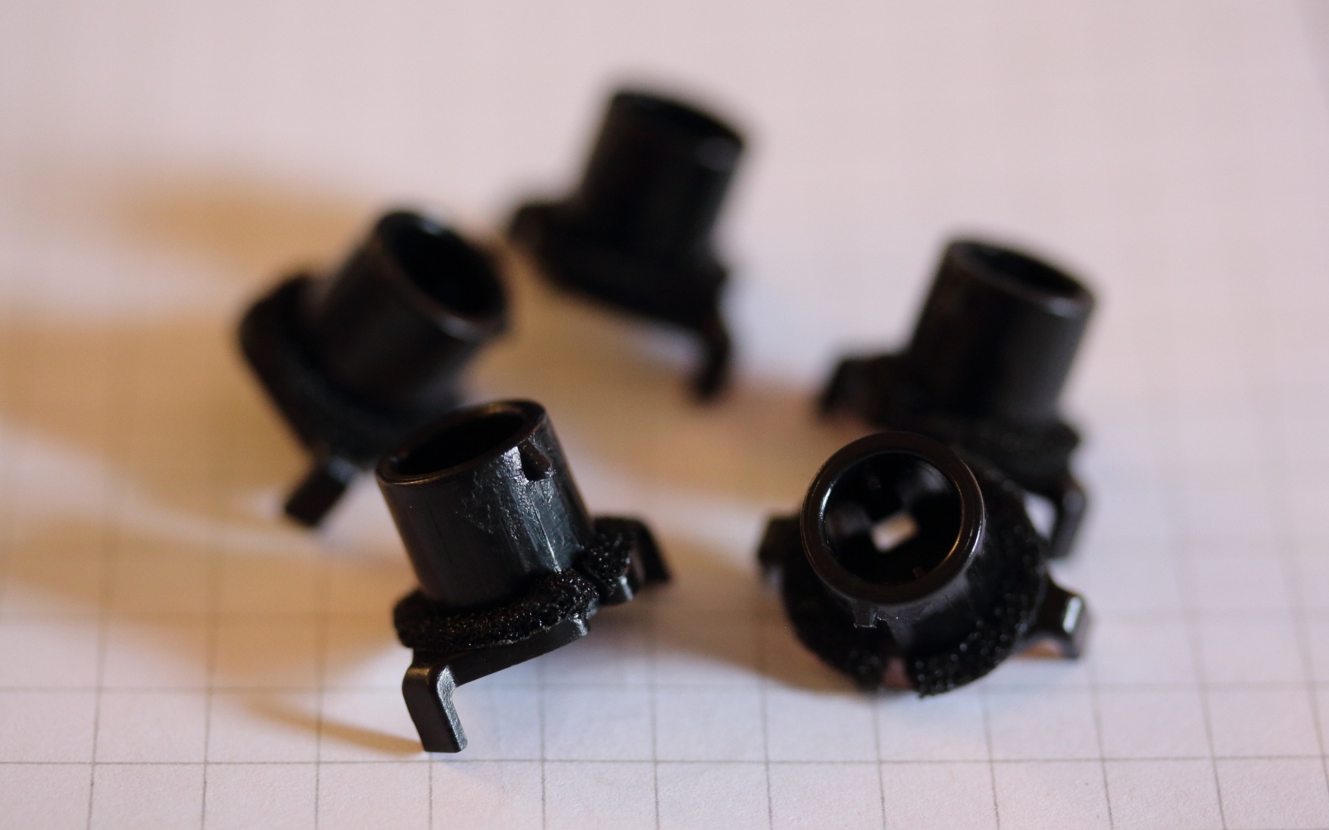

You can know open up your Topre-based keyboard, pull the keycaps, and unclip the hammers.
The next step is, of course, putting the foam onto these dome hammers.
My advice is to make a cut on each ring, with scissors or a nail clipper, because if you don't you'll probably end up stretching the ring or having it sticking everywhere (it's annoying).
I did not, however, cut the rings for keys which have large hammers (return, shift, space, …), in order to make sure the ring stays on.
Fashionable hammer wearing a foam ring
Hammers scheming world dome-ination

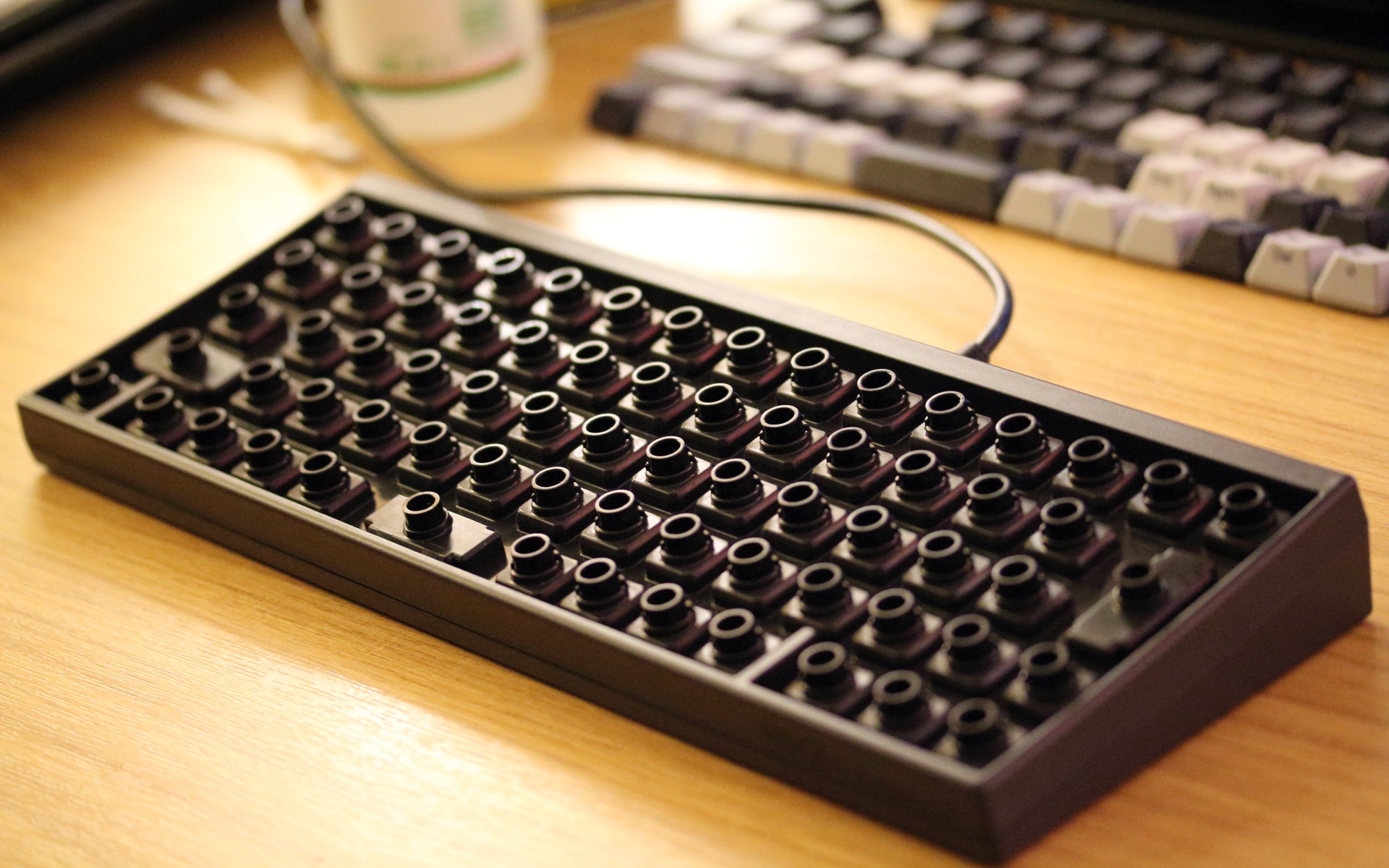

Yay! You've now spent about 4h playing with sticky foam and plastic pieces.
Take a break and enjoy some freshly brewed coffee/tea. (you have to, it's an important part of the process!)
Now, clip those hammers back, and take some time to play with each of them before putting everything back together.
Push them back and forth, turn the grid up and down, looking for hammers which get stuck or feel sticky...
I did not play enough with those, and had to disassemble everything the following day to change 5 foam rings which caused some keys to have a sticky feeling (one of the rings even got stuck to the plastic frame).
No keys, no life
No keys, no life
Finally, before putting the keycaps back on, ask yourself: do I really need those? Is my precision hardcore enough? 8-)
(I had fun typing without the keycaps on, it's not hard if you're used to your keyboard :lol:)
The final feeling is, in my humble opinion, far superior to that of the rubber bands mod:
you get a near-original travel length, a softer (kinda “hushed”) sound, and less vibrations.

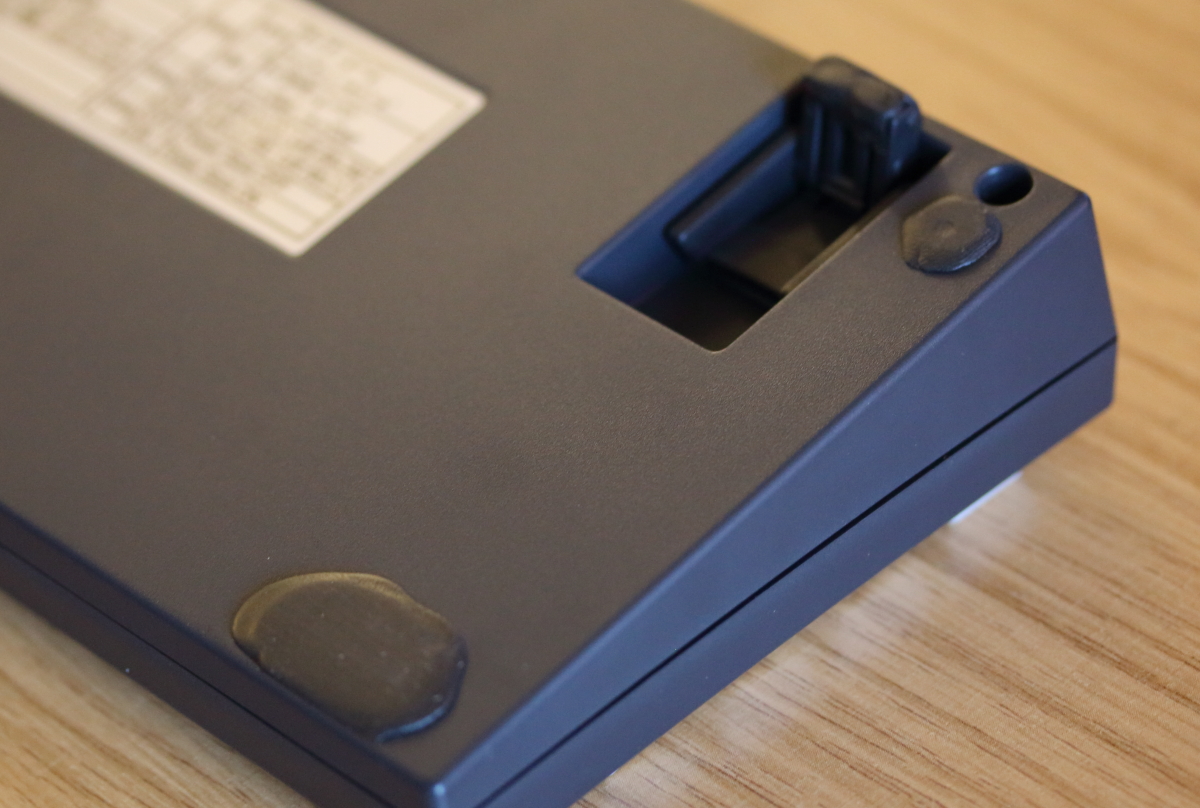

Mod #4 – Sugru feet
If you don't know what Sugru is, have a look at https://sugru.com — in short, it is an air-cured silicon paste.
I decided to have a bit of fun, and replace the rubber of my HHKB with Sugru while covering the plastic parts with it, too (in order to potentially reduce vibration transmission to my desk… well, ok, I wanted more fun).
Here's the result (not much to explain: “remove the rubber feet and apply Sugru”)
Sugru madness
Sugru madness
I know, it's not really sleek, but it does what I wanted it to : even less vibrations, and no plastic parts making noises when using my keyboard on uneven surfaces (happens).
