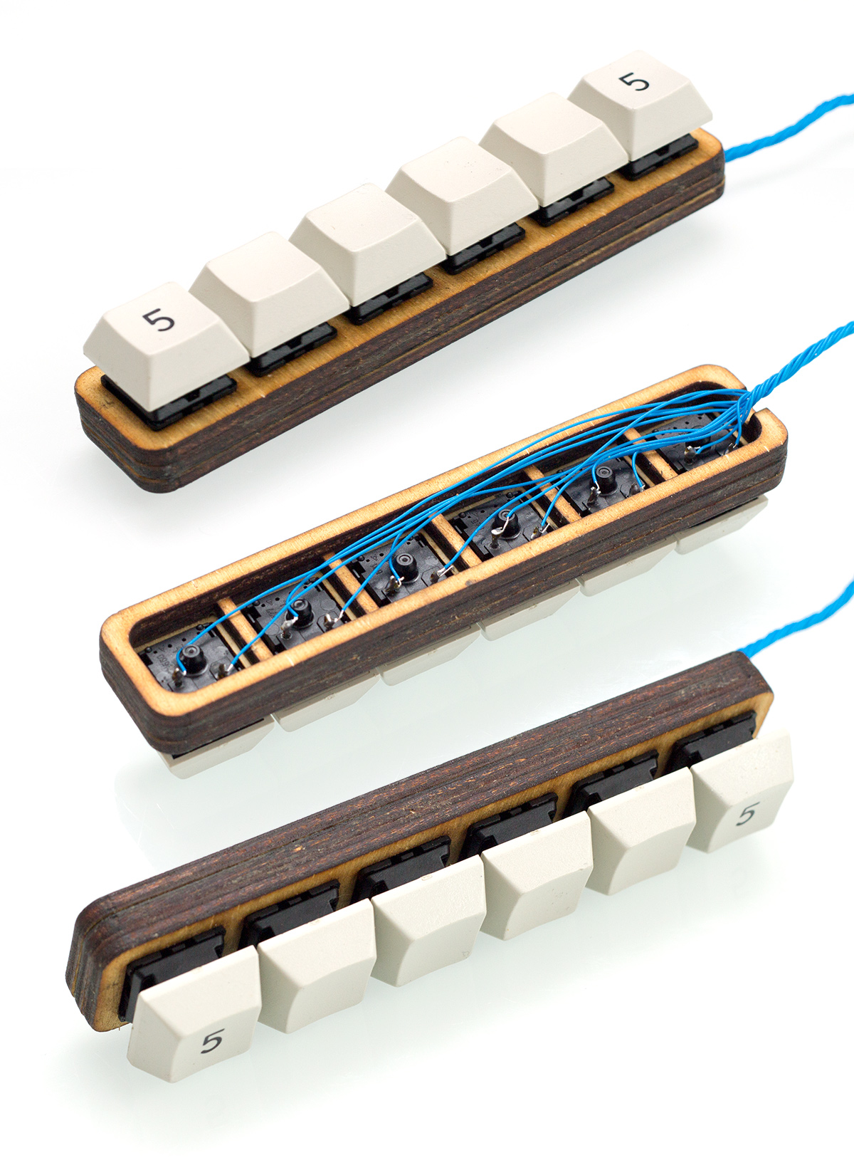

This is a small size experiment piece I made for playing around with tolerances for a cherry MX plate from laser cut wood.

Nice looking. How affordable is laser cut wood?

Very cool. I have been thinking about using laser cutting for the PCB support in my wood cases. Right now I am glueing single pieces to the bottom of the case. But a laser cut plate would be much better.
How much did your experiment cost?

Wow! It looks beautiful. How does it sound when bottoming out? I wood would guess it has a lighter, less metalic sound?

Jmneuv wrote:Nice looking. How affordable is laser cut wood?
I have access to a laser cutter via my local hackspace. This means that for me laser cutting is very cheap.
I pay about £6 for an hours use of the laser cutter. Then laserable ply costs about £2 for an A4 sized sheet.
So, for a keyboard, about A4 in width (so a 75%/ 15 unit keyboard) would cost about £12 I reckon. Note thats a cost to me, as my time is free to myself as I am the one running the laser cutter. However its pretty much the cheapest use it yourself service out there.

dirge wrote:Nice work, could do a numpad?
graboy wrote:Wow! It looks beautiful. How does it sound when bottoming out? I wood would guess it has a lighter, less metalic sound?
Yeah, you could easily do a number pad. The main thing limiting me making a full size case is that I need a PCB, something either 60% or 75% in size.
The main advantage do this method is you can add layers right down to the point that they touch the PCB. As you can see in the pictures I have an extra layer under the normal 'plate' layer that has bigger holes for the switches. This could easily be matched on the underside of the PCB as well. Which means each switch will have a wooden support clean around its perimeter. You can not do that as easily with metal due to it messing with the circuit, or damaging the PCB.
That method will result in a very solid feel, with basically no give or flex when you press down a key.
It sounds fairly light due to the nature of the wood. I did think about making it even lighter and quieter by introducing a layer of cork as one of the lower layers.

very nice overall, you could even build a keyboard without PCB.
this is more or less what we could do with the custom compact design (but with aluminum of course). It's not that bad actually, if the CNC milling turns out to be too expensive we could try with the sandwich technique.

gmjhowe wrote:This could easily be matched on the underside of the PCB as well. Which means each switch will have a wooden support clean around its perimeter. You can not do that as easily with metal due to it messing with the circuit, or damaging the PCB.
This is basically what I would like to do for my wooden cases. The rest of the case would still be none laser cut, but having a solid base for the pcb is really key to making the cases feel great.
