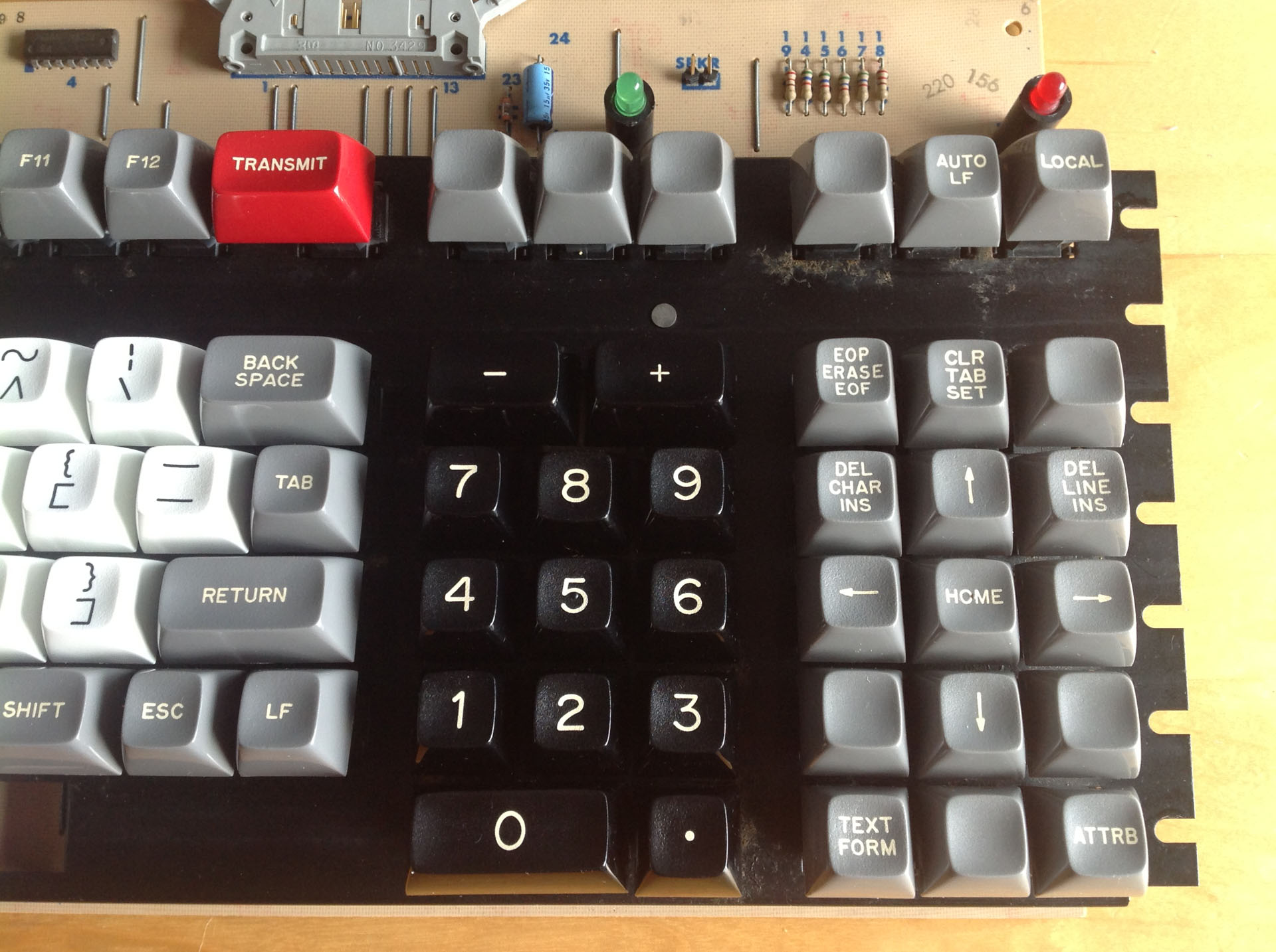

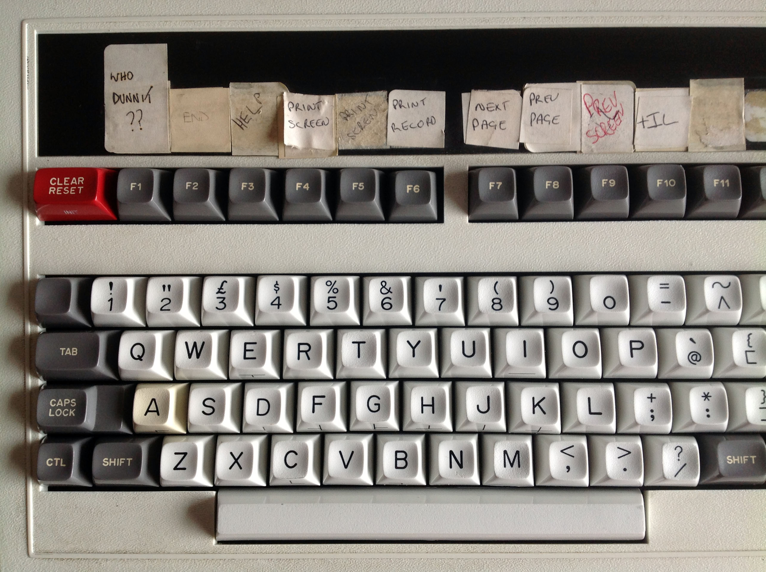

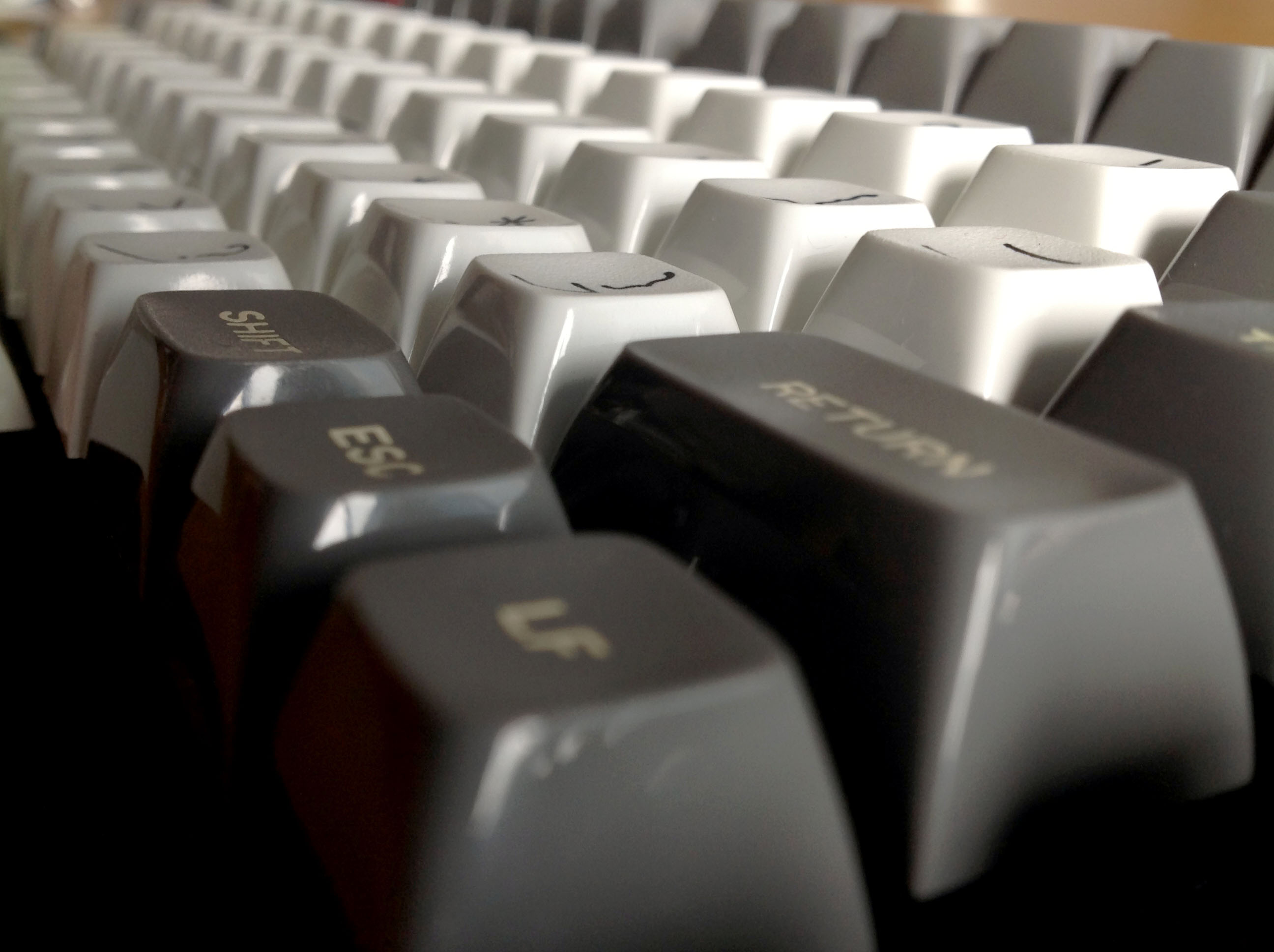

So, I have right here one Micro Switch aka Honeywell Hall Effect keyboard:
The similarity with the Space Cadet Keyboard of legend is quite striking:

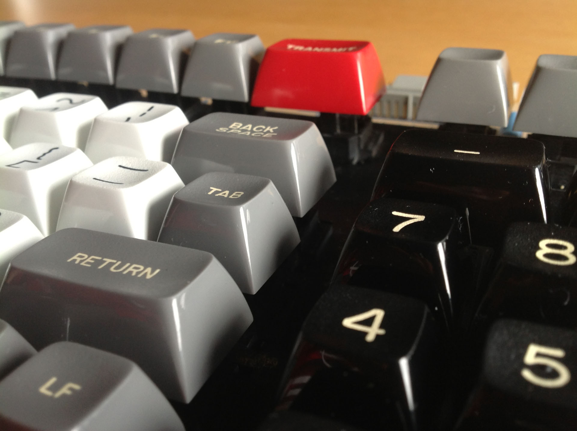

The caps are freaking huge:
Seen in their natural environment:
Their tall spherical tops retain the original texture, while the sides are silky smooth:

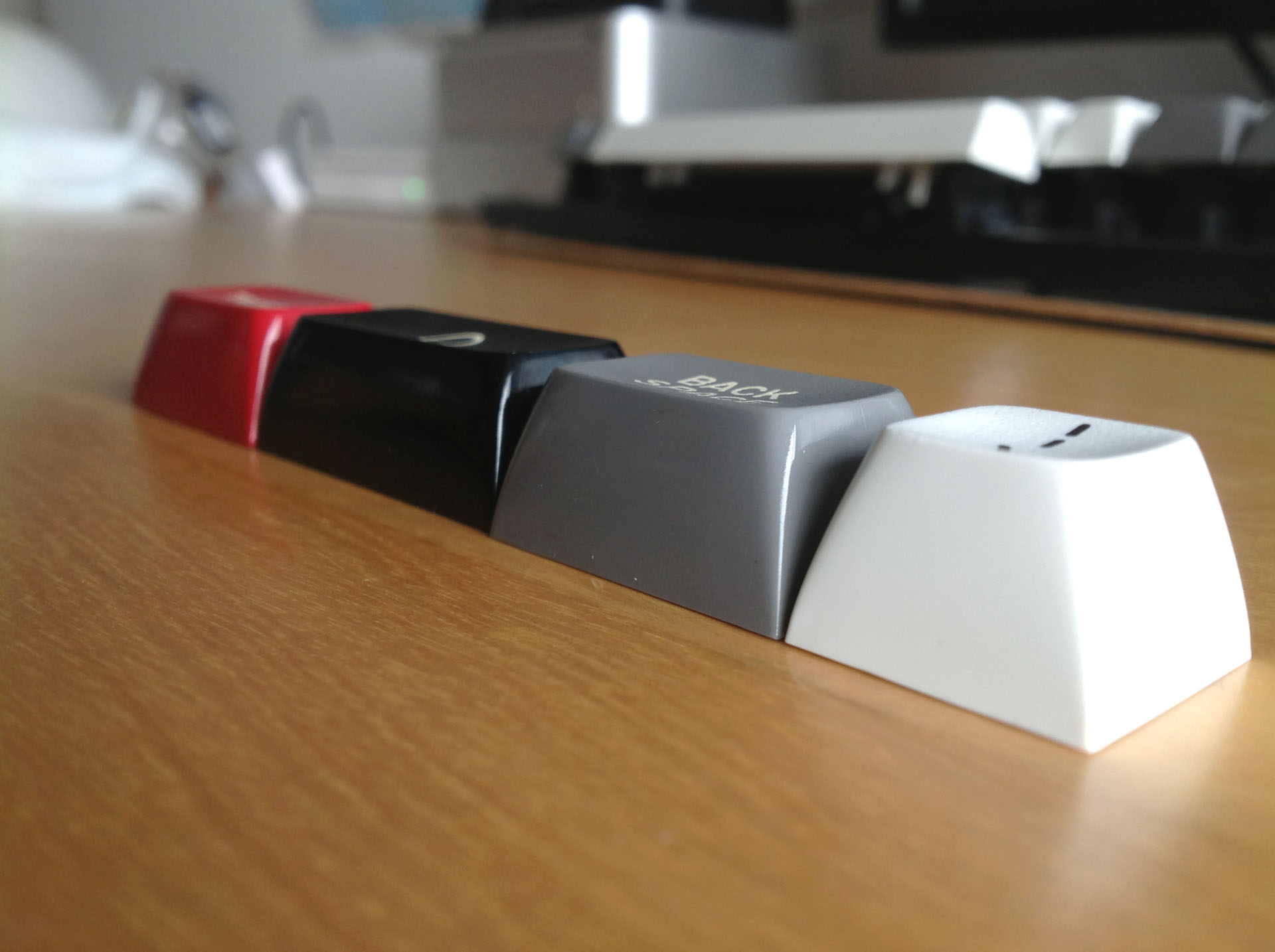

I do quite like the colour scheme. Round 5: tall spherical "Honeywell set", anyone?

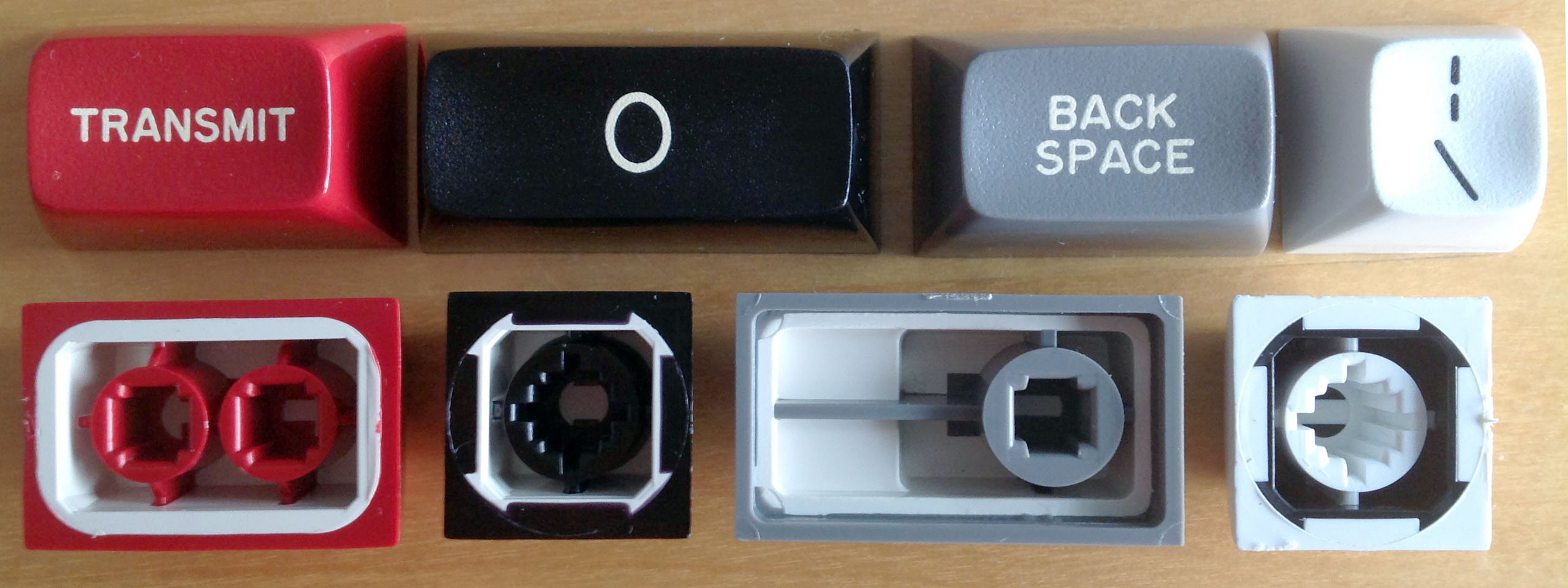

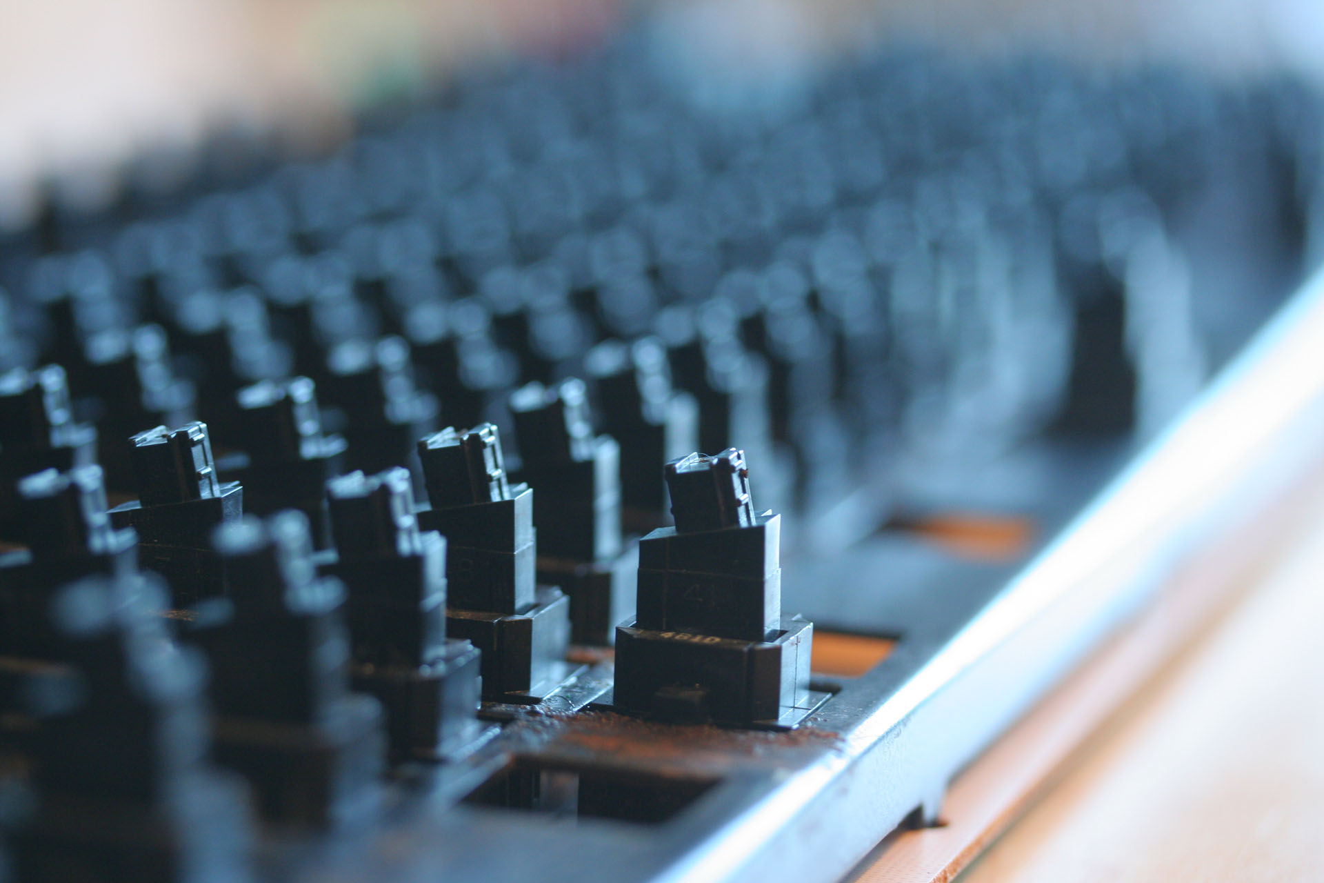

The mounts are telltale Honeywell Hall Effect:
Double shot, naturally. In fact the inner shot on these is easily thicker than the whole body of any of my regular keycaps!

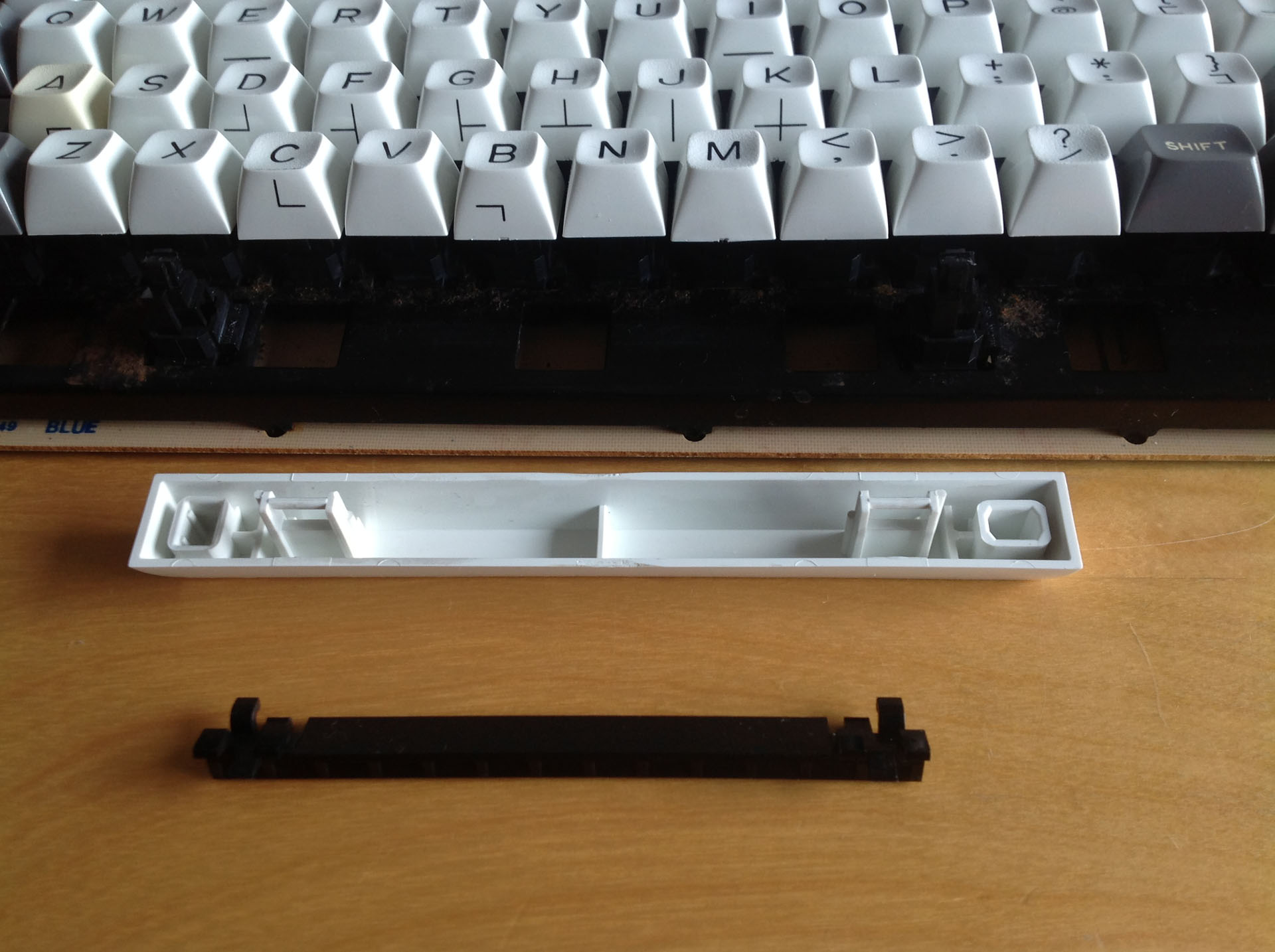

The space bar has a plastic stab. This is a key tell that this is a later model Honeywell keyboard. Also note the geometric symbols on the front of some of the keys:
While I love this keyboard, I'm not a fan of its one and only plastic stabiliser. I reassembled the board without this stab, and the space bar works much the same but feels much better. Perhaps it needs lubed. There's not a trace of the stuff anywhere to be seen.

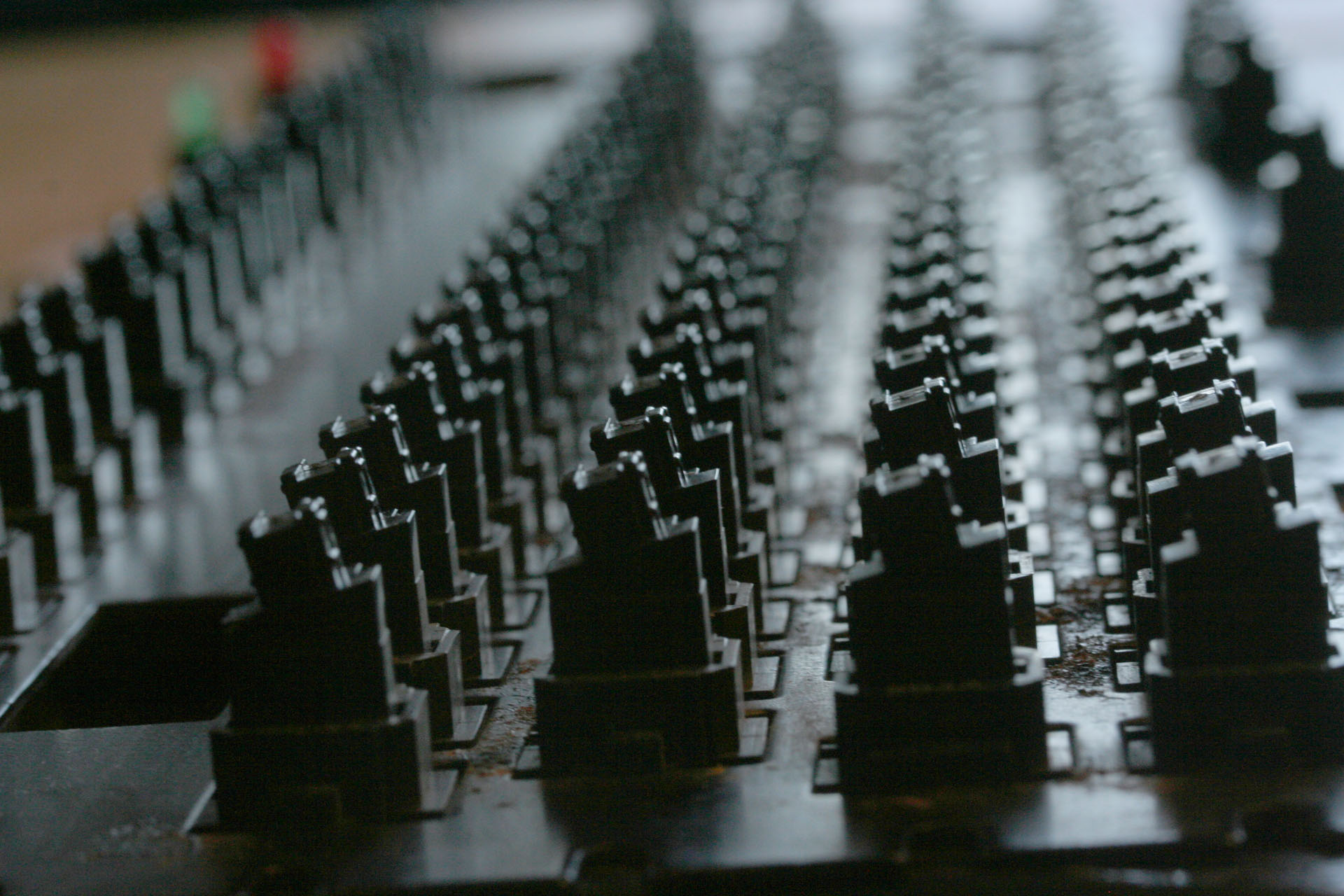

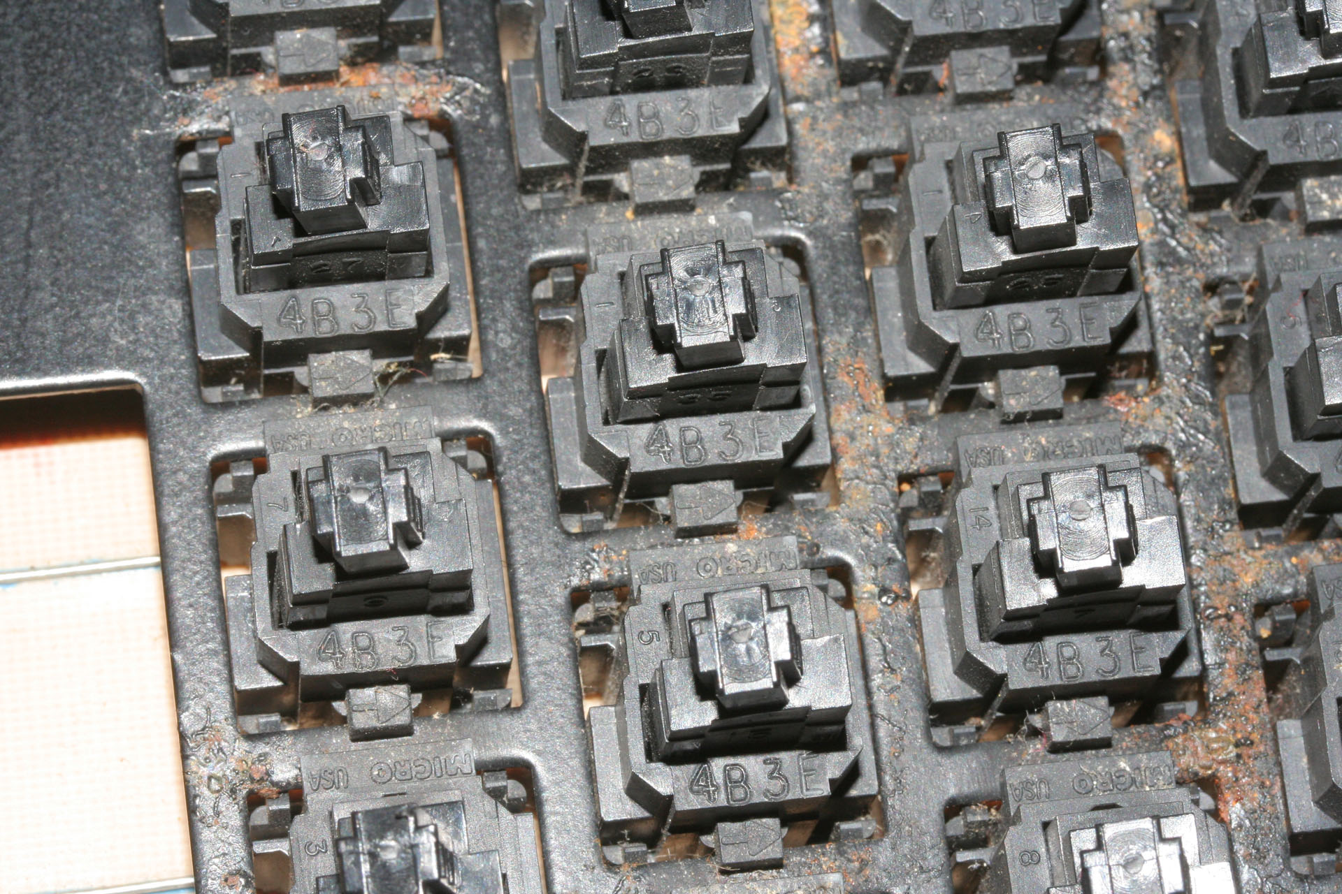

Right, now my fellow caps fetishists are happy, on to the switches. They are this keyboard's super linear stars:
Micro, USA. Accept no substitute. These are easily the smoothest switches I've ever encountered. No mechanical switching mechanism: these are solid state. That's the magic of Hall Effect. The keyboard uses two kinds of Honeywell switch. Straight 4B3E over all its keys but three. 4B3E means angled black stems, normal (78 cn) weight, three pins; the very same model as used in the Space Cadet. The exceptions are Caps Lock and the two extreme top right keys: these are latching, and use 5B3A. There are also a handful of dummy switches with felt tops, which work like Cherry stabilisers, with code 6B1D.
Here's some switch porn for a change:
I do actually have the entire keyboard. I've been showing off the insides so far because they're the good part. The outside is the mystery. Here it is:

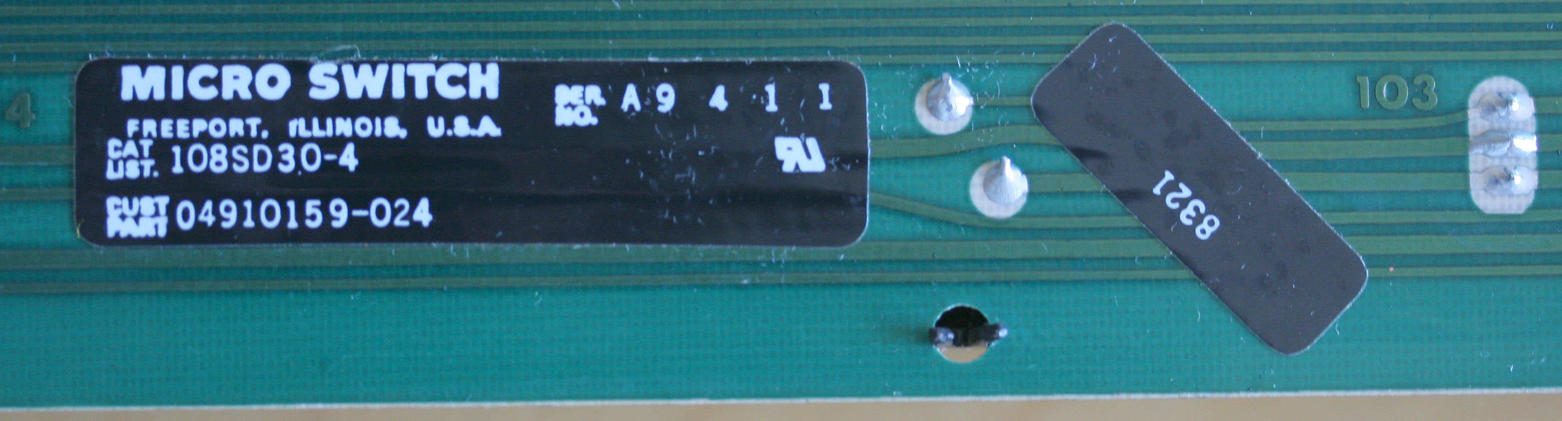

One thing I can tell from the keyboard is its year. Here's the assumed production date from the PCB:
And its serial number:
Serial A9411.jpg (322.24 KiB) Viewed 28951 times

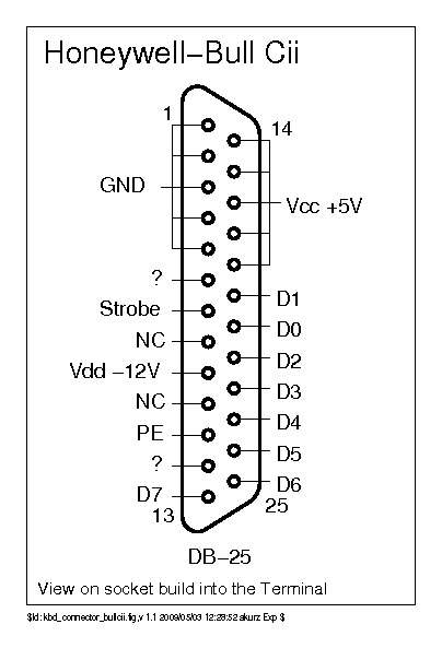

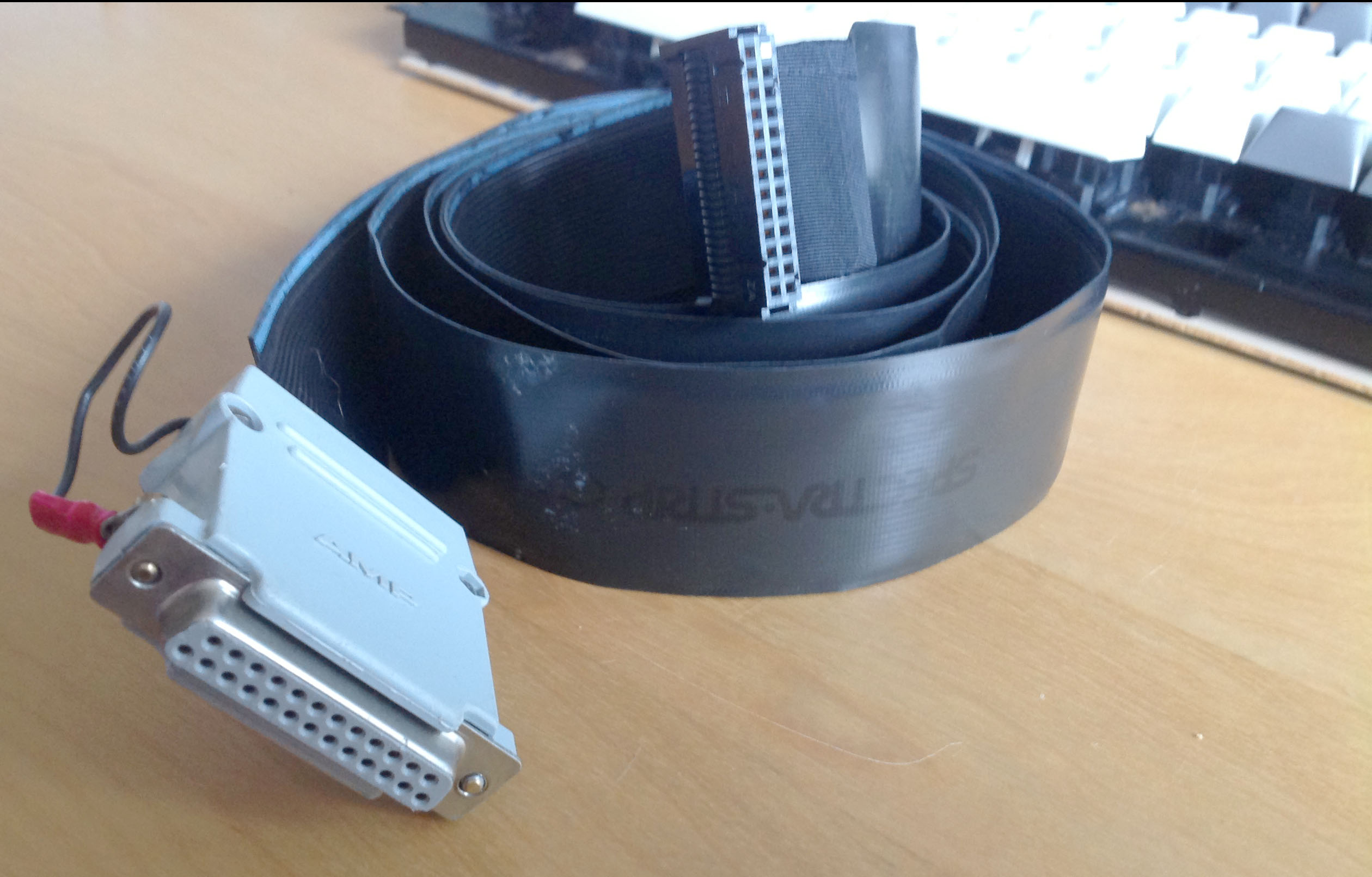

Naturally, I'm highly interested in getting this great old beast up and working over USB! So consider this a little plea for information! Here's the stuff I know.

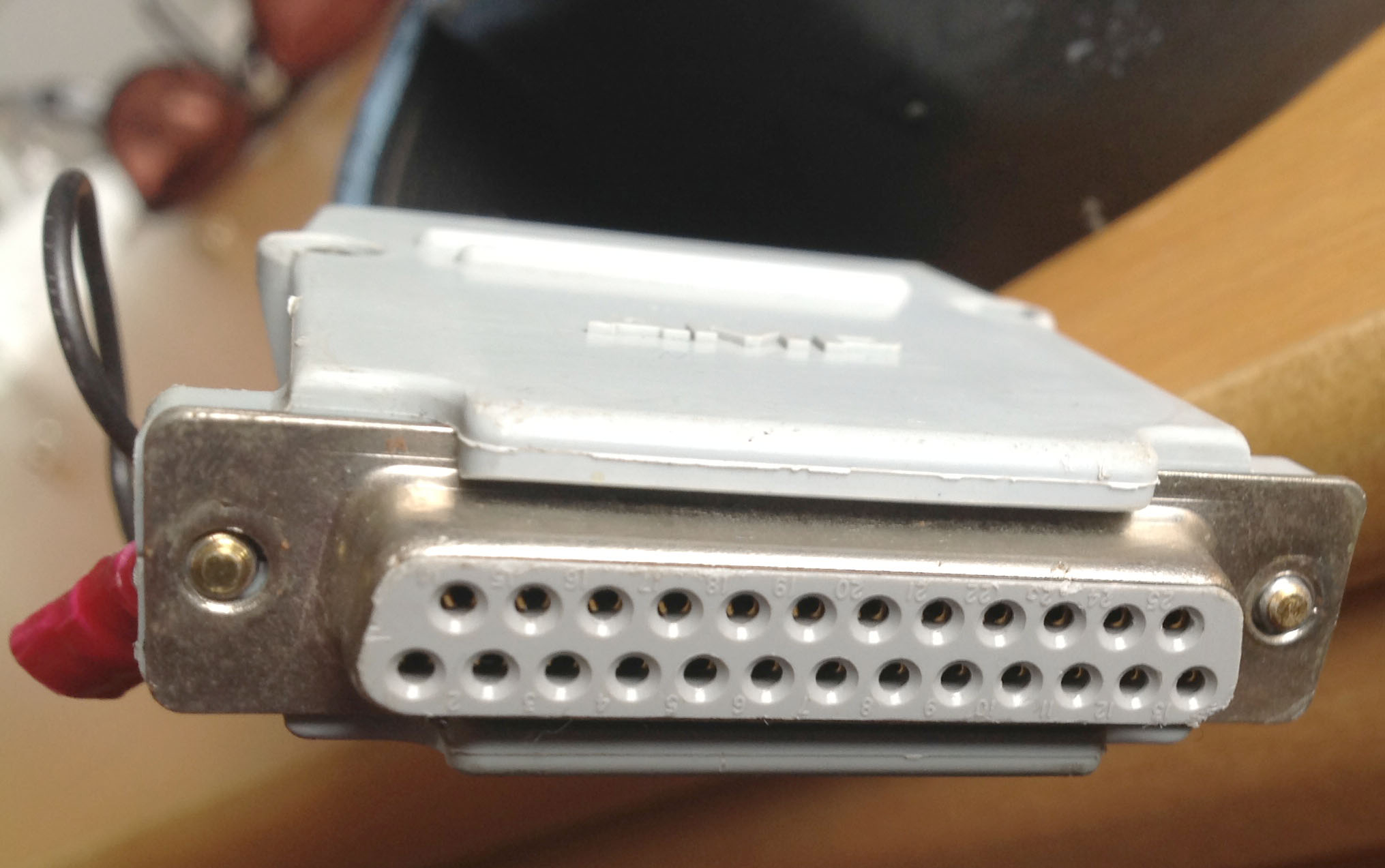

First up: the 25 pin cable:
I have a hunch this could be the pinout, via the ever useful Kbdbabel:

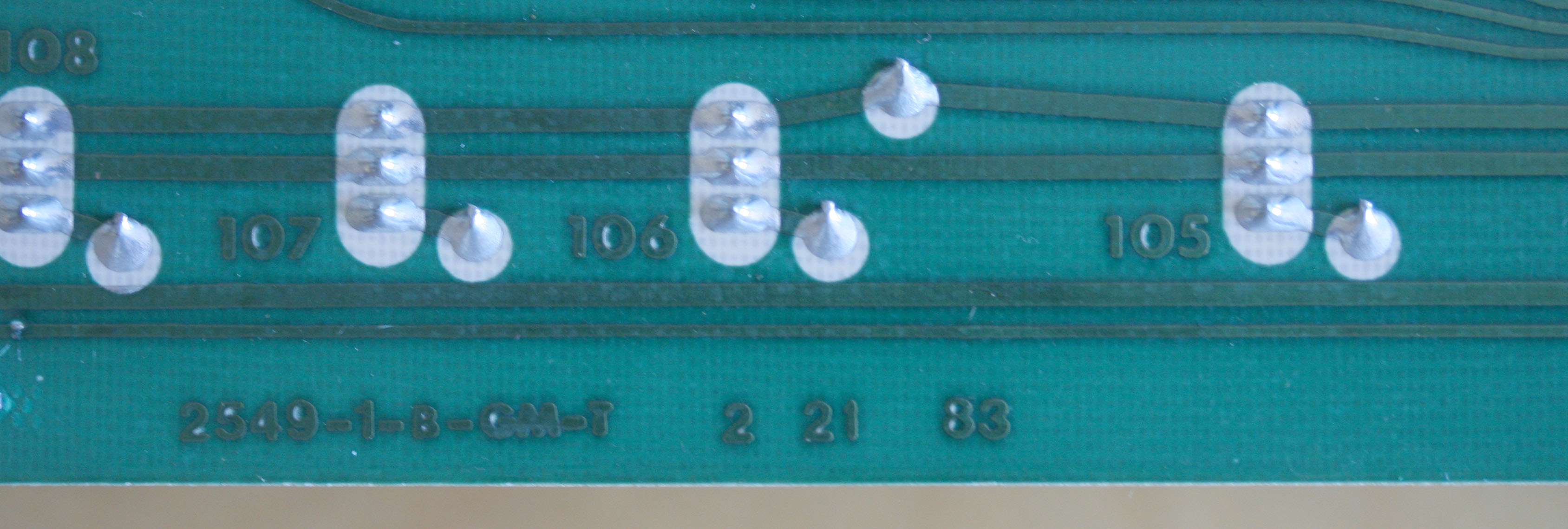

But I need to trace the pins. Incidentally: there's a full size (PC style) speaker fitted to the bottom of this keyboard's housing, which could account for the unknown pins.

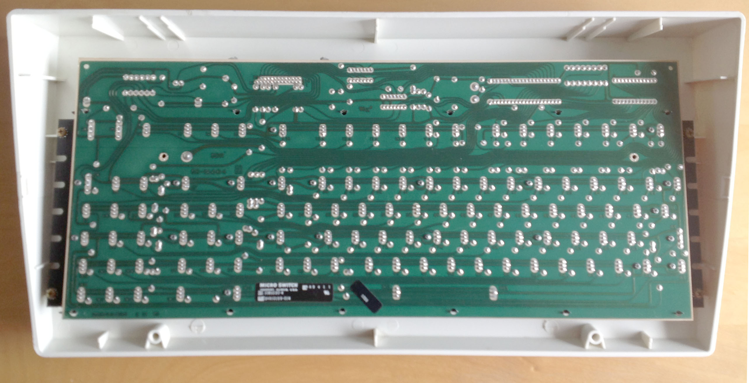

Here's the underside of the PCB as fitted into the top housing. (I'll take a nice proper sharp picture next time!)
Naturally, there's a huge waste of space in there! As was the style of the time. Perhaps a slender metal housing would make a smart pairing with a USB converter! I can only dream…

After looking closely, the Honeywell BO1810 seems to have the same layout and colourway, but it looks like the capslock has a light.
Also, I would like to announce that this keyboard has the "modern" type switches, and the "thicker" type keycaps. I have a keyboard that's "newer" (from 1993 I think) with thinner 1-unit keys and a different stem design.
You can see the differences in the stem revisions, as the "newer" stem is seen on the underside of the red keycap and the capslock, and the "older (I think?) stem is seen in the other 1x keycaps. The simpler stem is seen in many of the larger keycaps here, but only inthe 1-unit keycaps on that newer kb. More information is needed to see if there was indeed a mould change, and when it might be.
Image showing what I'm talking about (from OP)
I have a spare HE keyboard that I'd love to do a passaround for. I didn't know anyone would be interested. I'm located in the US Though.
Thanks for the tip on the spacebar stabilizers! "vintage" HE switches use a metal bar and huge metal inserts and two dummy switches, but some modern ones have the plastic bar. My PCB supports having two stabilizers with a switch in the middle, I wonder if this one does too. I will likely be converting a portion of one (or several) of these keyboards to USB.

Updated with the info I currently have on this keyboard's interface. I'll know more once I trace out the PCB.

The scanning logic does look substantially the same as the Space Cadet.
The MCU looks like a soldered 8048 instead of a socketed 8748, so that's pretty much the same, too.
If it were socketed, or you were willing to desolder the MCU, I bet driving the demux directly would work. But let's assume that's not an option.
For reference, something close to the original MCS-48 program that MIT received from MicroSwitch can be found at http://home.comcast.net/~mmcm/kbd/moon_kbd.ucode.txt. At first glance, it does not look like that's what's running here, though.
The photo of the PCB is pretty fuzzy. But it looks like Vcc goes to pins 1,2,3 of the DB25. So I also suspect that the pinout given in this post doesn't match. First step would be to use a multimeter to trace Vcc and GND on the connector. And then, of course, double check before applying any power.
The address lines A-D for the mux look to be going to P2<0:3>, which is why I don't think this is the same program. The DB parallel output of the MCU looks to go to pins 14-21 of the DB25, so that's where I'd look for the scan code or perhaps ASCII char when you press a key. There's probably some strobe signal, which might just transition when there's a key ready. And it's possible that there's some enable signal. If so, it'll be another of the GPIOs, of which only a few aren't accounted for.
And you can see where the speaker signal goes, apparently without anything other than that jumper.
16 Feb 2015, 02:07
I'll reshoot the PCB so you can have a clearer look. My electrical skills aren't amazing though. For instance, what voltage do you think this runs off? (I won't be applying anything without advice!)
What do you reckon the likely rollover of this board is? I've heard 4KRO before, which is okay, if not stellar. Just so long as it's >2KRO! I know even that can be useful on a well planned matrix (Model Ms come to mind) but can be a pain on those that aren't (certain other Model Ms!).
