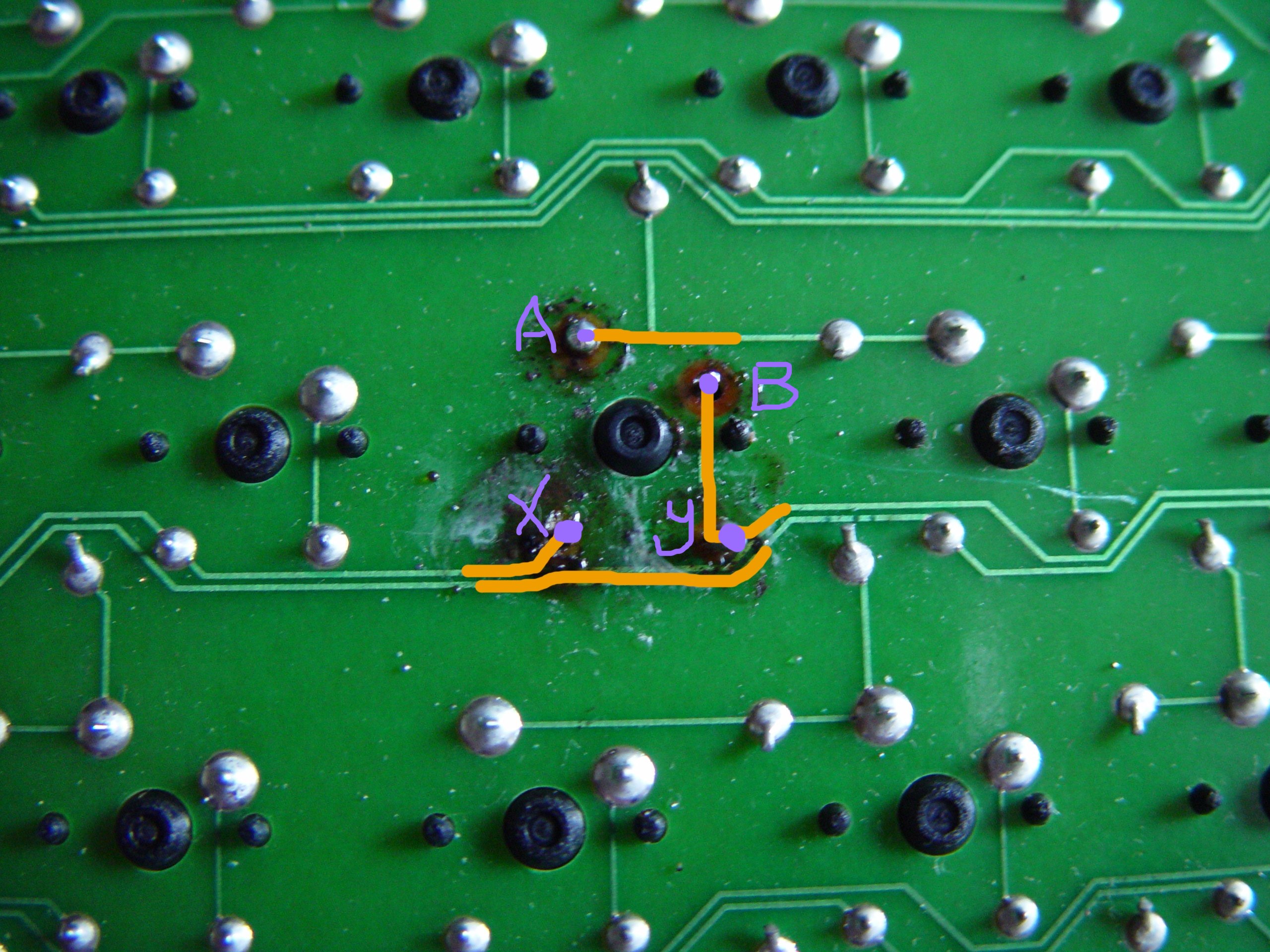

I received this poor victim today... it's all scorched and the pads are gone, traces are in bad state. I think using some wire to fix it is the best way now... but I suck at understanding matrix and I am not 100% sure where I need to use wire to jumper it... to which adjacent switch and diodes (NKRO model)?

Here's mine:
Matrix Guess.jpg (862.4 KiB) Viewed 2145 times
Functionally the same as Wheybags. Just make sure there's continuity in the half destroyed traces you rely on. Obviously A and B are the switch pins while X and Y are the diode's.

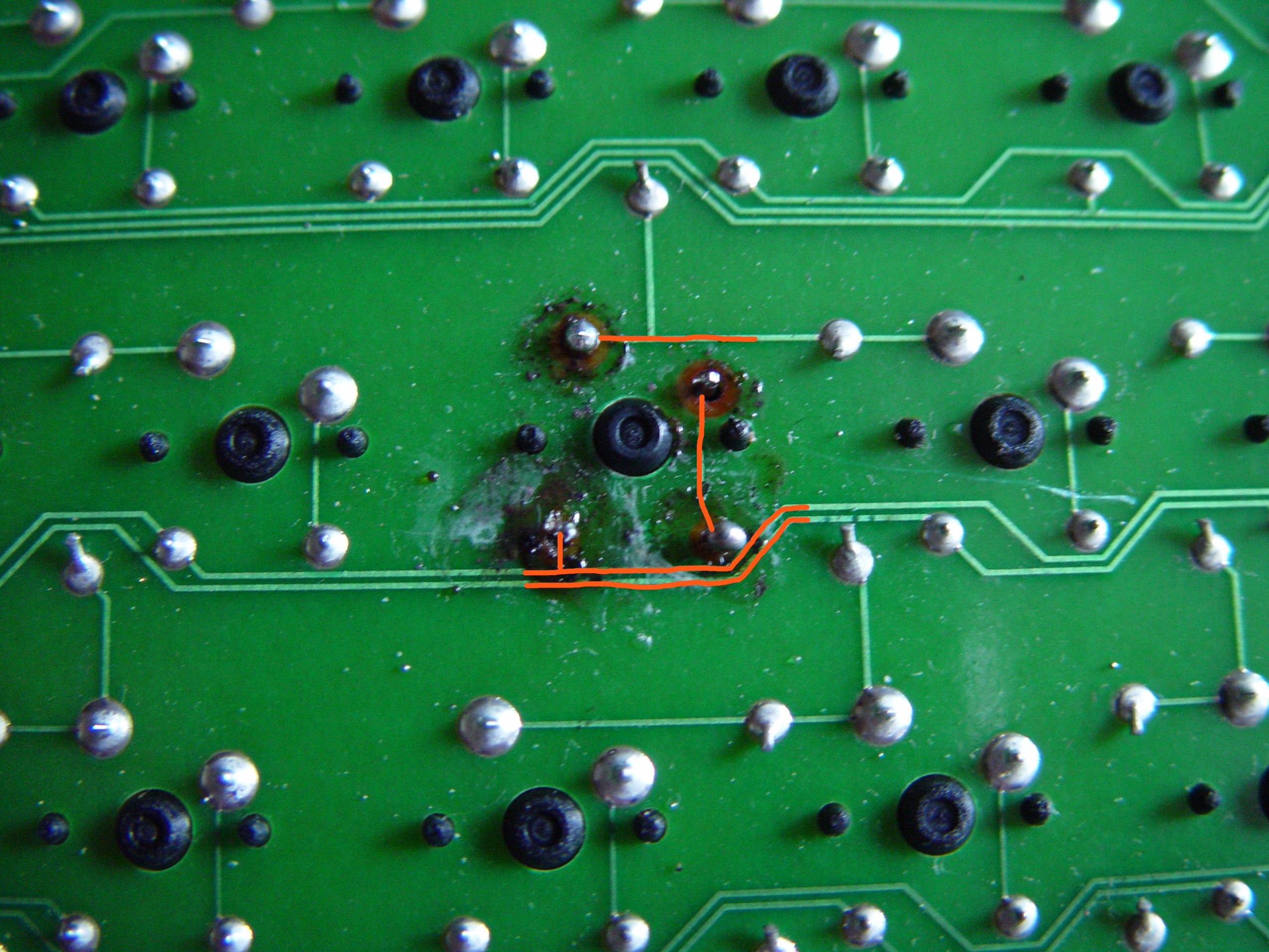

Edit: I'm wrong: B connects to Y but not to the horizontal line. That vertical trace is just there to hook the switch and diode up in series, and does not join anything else. Looks like it should be like this:

Watch out for both those horizontal rails. They need to conduct signals from other switches, while not shorting with the right hand pin of the diode.

Thanks guys. This was pretty much what I thought but I wanted to get another opinion. Definitely looking for a one shot one kill fix as I don't think the area will survive much more soldering/desoldering abuse.
