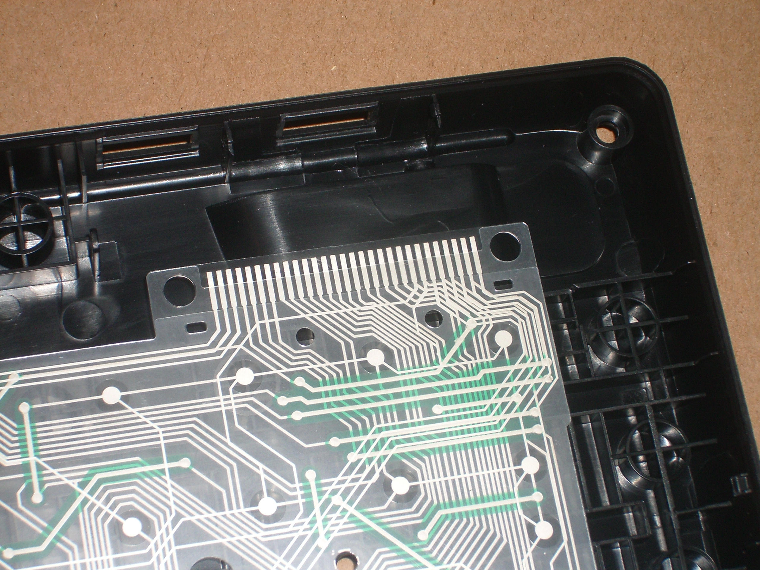

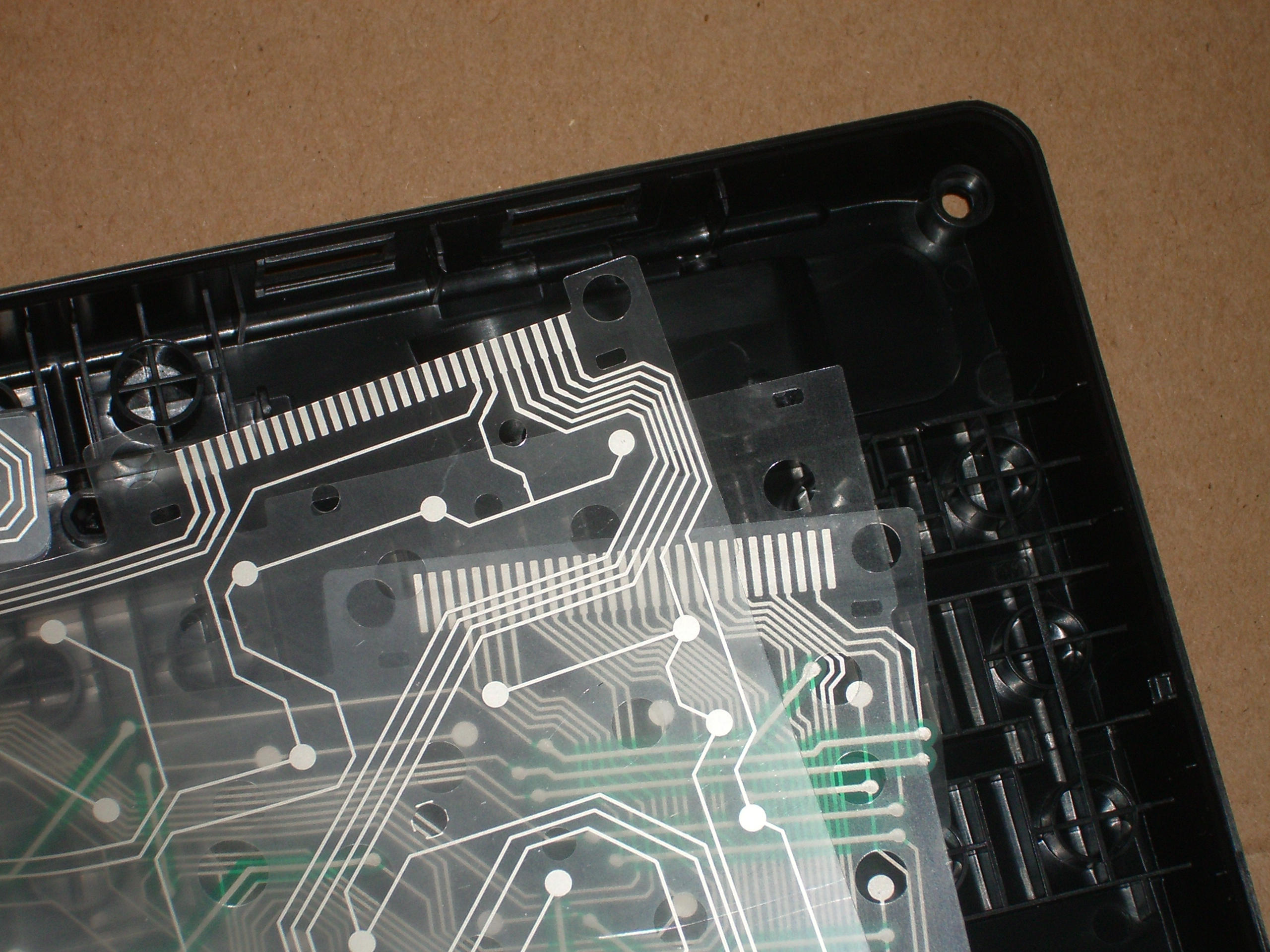

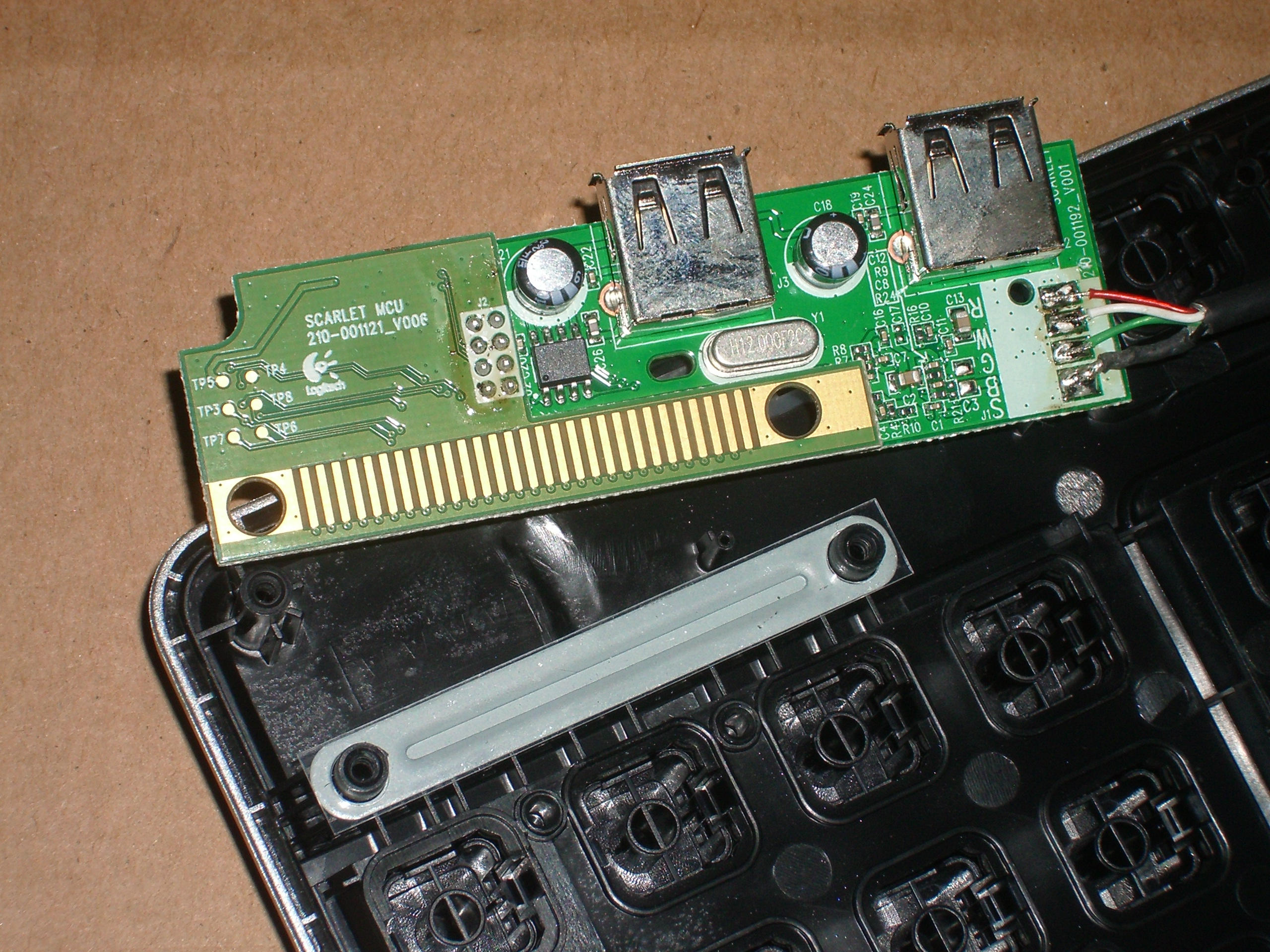

I grant you, membranes are a bit odd. This is from a Logitech "Scarlet" (Dell KB-522 multimedia keyboard) — firstly, the controller board connection:
Dell KB522 -- controller and hub PCBs.jpg (865.4 KiB) Viewed 3254 times
Both membranes overlaid:
Dell KB522 -- membrane layers.jpg (756.58 KiB) Viewed 3254 times

Notice how numerous connections to the controller are shared between the two membrane layers? I never noticed that before. I would have to dig that keyboard back out to see if I could follow what they've done there. Electronics never was my strong suit.
Modern laptop keyboards are sealed and cannot be disassembled for inspection, so I don't know for sure where any of the traces go.
It's possible that water has actually shorted rows together, or columns together. What effect this would have on a controller, I have no idea at all. It would have to be a connection between pairs of traces that would represent something other than keys being held, otherwise the controller would simply read stuck keys. After all, it's a grid of switches! That's what switches do. Bypassing a switch with a short just has the same effect as pressing it.
