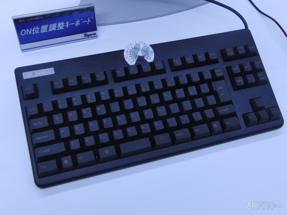

Great post! Interesting comments about the actuation points...it reminded me of a Topre prototype board with a giant dial on it which was used to alter the travel...or actuation point - I can't remember now:
-[°_°]-
10 Feb 2014, 11:19
Indeed I saw that picture on GH! So it seems it would be totally feasible. Maybe I'll try again to hack the Leopold controller in the future...

Getting ideas about variable actuation points across a single keyboard as well as weighting…
I'd love to try that dial! One of my favourite things about Topre is the shallow actuation depth. Way different experience to the hard depth of buckling spring.
But if this is really analogue sensing… goodness. Perhaps cap sense is what we need for our force / travel experiments?

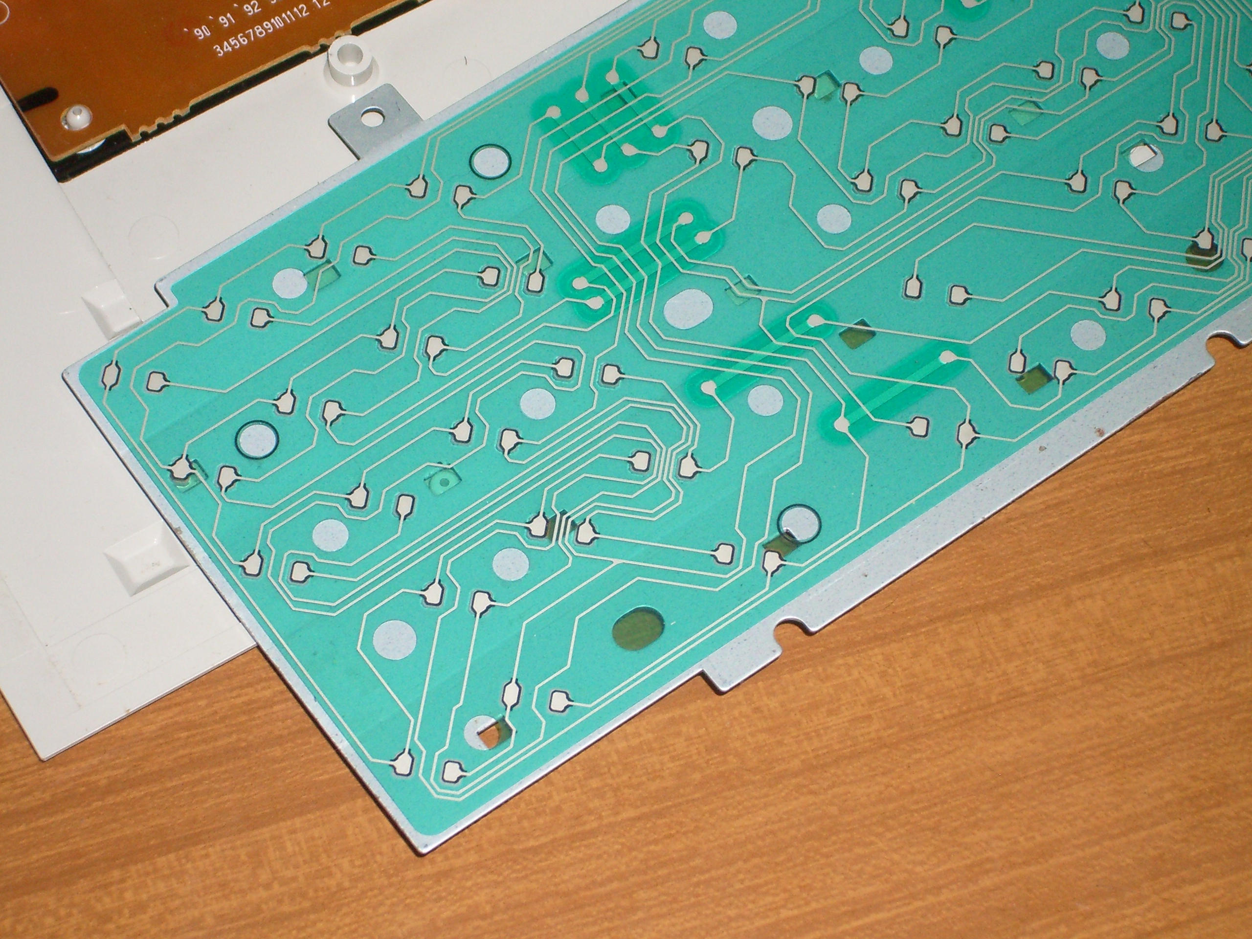

10 Feb 2014, 22:18

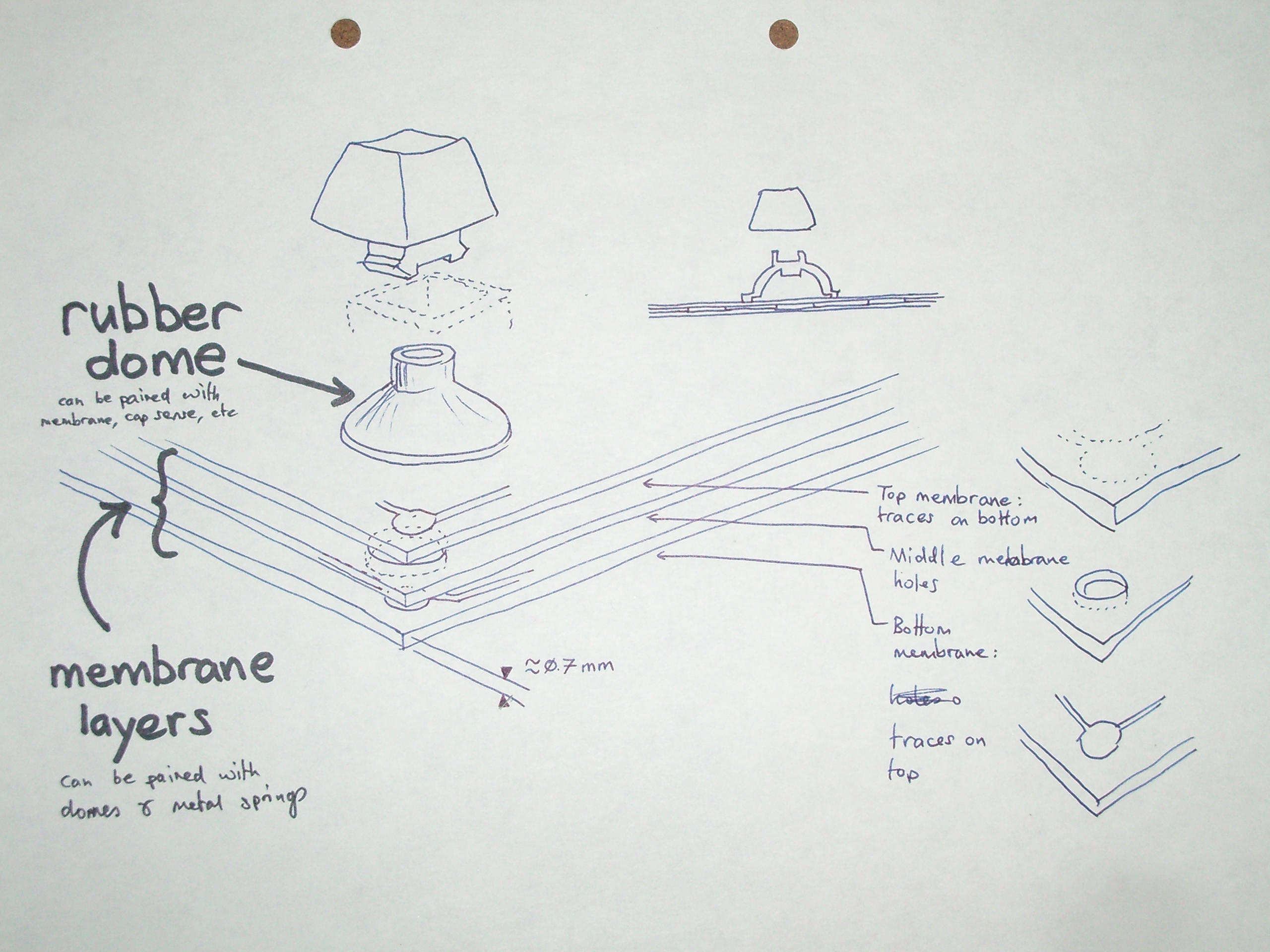

The bouncy things made of rubber are "rubber domes" (sometimes "rubber cups") or, if they are have a hole all the way through, "buckling rubber sleeve".
"Membrane" means "Any thin pliable sheet of material": generally something that is extremely thin, and flexible. A typical membrane keyboard is constructed thus:

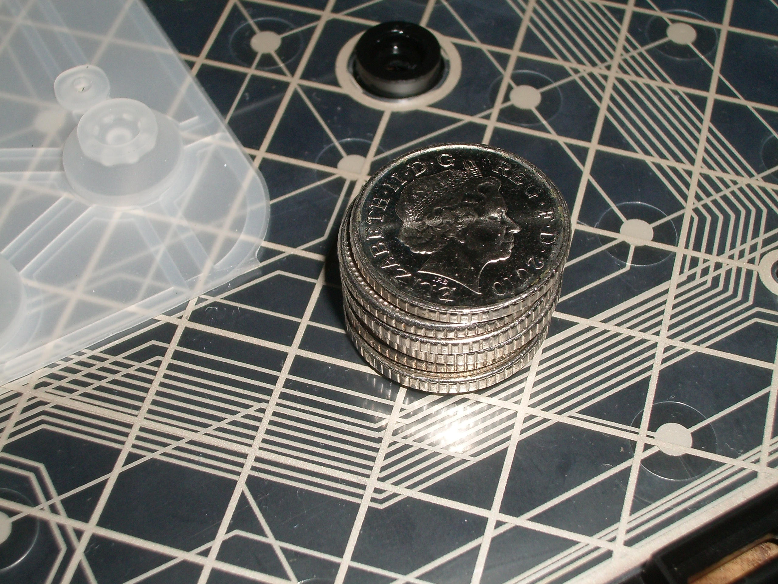

Keyboard membranes are flat sheets of transparent plastic of the same thickness as a normal sheet of paper, ca. 0.7 mm. Typical keyboards have three of these, and the outer two bear printed circuit traces, on the inside-facing surfaces. The centre layer contains holes, and the top layer is pressed down against the bottom layer by bending it through the holes. I refer to this as "pressure membrane". The pressure that brings the top layer against the bottom layer can be anything; your finger is fine. I'm estimating around 13 to 19.5 g force across 0.7 mm travel, which feels virtually no different to a resistive touchscreen:

Claims that you can "feel the membrane" in an Acer keyboard are pretty unlikely.

I call this "conductive membrane", although that's a misnomer as the membrane always has exposed conductive traces. In conductive membrane, a conductive object is brought down on top of the membrane, for example impregnated rubber. That's what Mitusmi "rubber dome on a stick" switches are (which is a very odd name, as the dome isn't on the stick)
Rubber dome and membranes are completely orthogonal concepts. You can apply pressure to a membrane with other objects than domes, and you can use domes for other purposes that dome pressure.
(Bootnote: this is DEFINITELY something that needs a dedicated set of diagrams on the wiki from someone who knows CAD, as people mix up membrane and domes so many times. Calling bog standard keyboards "membrane" is not strictly wrong, but people keep thinking that "membrane" means the domes, and don't consider what it is that the domes are there for, and how you might go about detecting current through an insulating material … Also, capacitive switches don't need rubber domes — think foam and foil (foam and plastic) and buckling spring (plastic) — no rubber in either.)
