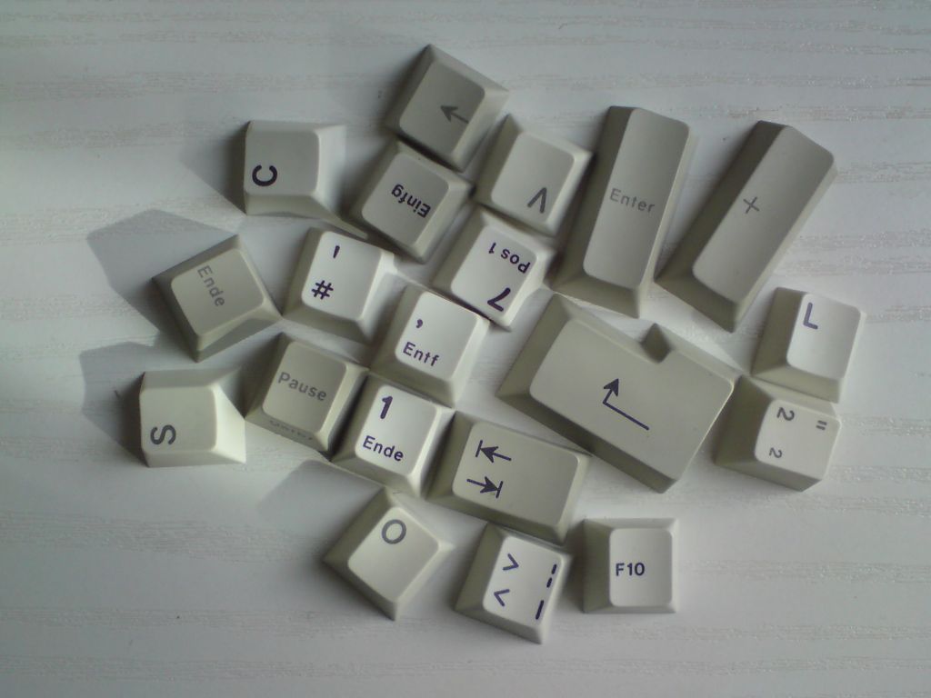

Hey guys,
I just bought an old Cherry G81 with a nice Dyesub set in very good condition. Here is a picture: Image
I would like top put the keycaps on my Ducky G2Pro with MX-Reds. But I guess that the off-centered capslock and the bottom row will not fit. Do you guys have an idea how I can find a nice solution for this problem?

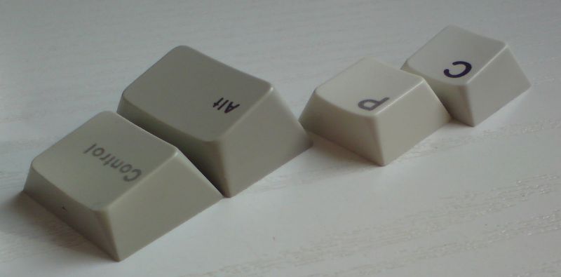

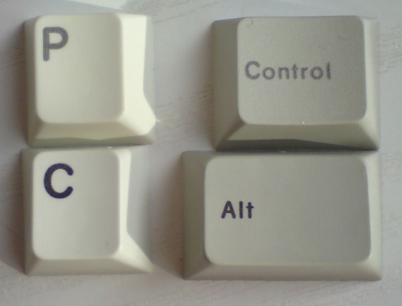

First, lasered 105key G80 with bicolour caps don't come in cheap, they tend to go for 20€ on ebay, for some (or this very) reason. Sometimes even 35, and they are not that common, rather the once every two months kind of.
Second, the colours of the lasered caps will differ quite some, as I said.
The lasered grey caps have a slightly more brownish hue, where the dyesubs have a tint with olive or grey. Depending on the light either the lasered (in bright), or the dyesubs (in dark surroundings) appear more saturated. And of course the high contrast of the legends amplify that.
The white lasered caps have a rather cream white tone, where the dyesubs again have a grey or olive tint, making them a colder white -in comparison.
Spot the dyesubs (and no cheating ;) )
Third, with colourful I meant something along the lines of these:
http://deskthority.net/marketplace-f11/ ... hilit=cmyk
http://deskthority.net/marketplace-f11/ ... ?hilit=rgb
as I tend to rather go all out than have a slightly off colour, which - depending on my mood - can be anything from, "I don't look at them anyway" to "this really ticks me off". YMMV :)

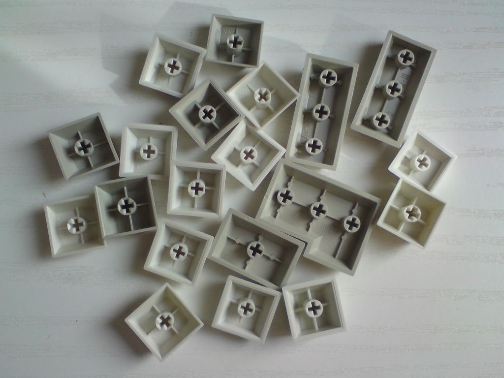

Again: G81 (as in the one with MY switches) does have an offcenter bottom row - the stems in the 1.25 mods are not centered so they won't fit any G80 board (or filco, CM, Ducky) without modification. You could do that if you want to go real cheap, at all it's the easiest way to get the center stemmed Capslock anyway.

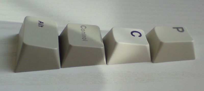

18 Feb 2014, 13:11
Yep, but I guess the bottom row would fit the Ducky. You guys said that the stems would not be centered but I cant imagine how this should look on 1.25 keycaps. Any pictures?
Because the bottom row has the right colors and sizes I think.
bazh
18 Feb 2014, 13:14
Monkay
18 Feb 2014, 13:15
Oh wow ok, that is one of the most fucked up things I saw so far. Then I will have to look for the right G80 or someone who sells a nice set of Iso modifiers that work with the dyesubs. That could take some time.
