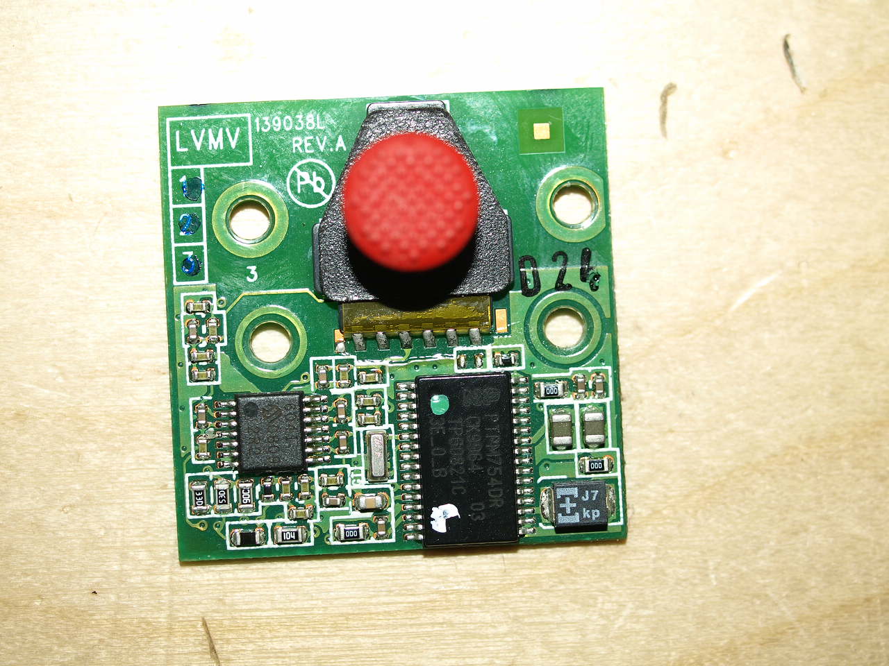

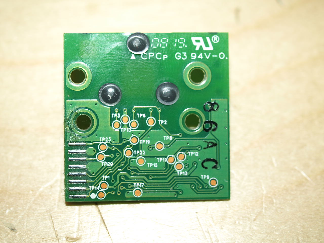

Hello,
I'd like to add a Trackpoint to a keyboard project of mine. One I could easily salvage comes from a T400 internal keyboard, P/No: 42T3109. I believe it's a PS2 controller on the chip (PTPM754DR, same chip as on other Trackpoint controllers used for keyboard hacks in this forum),. What puzzles me are the 8 lines instead of 10 I see on other trackpoints.
Does someone recognize this controller and point me to the correct Pinout for the flex wire solder points?
Attached are some pictures of the PCB.

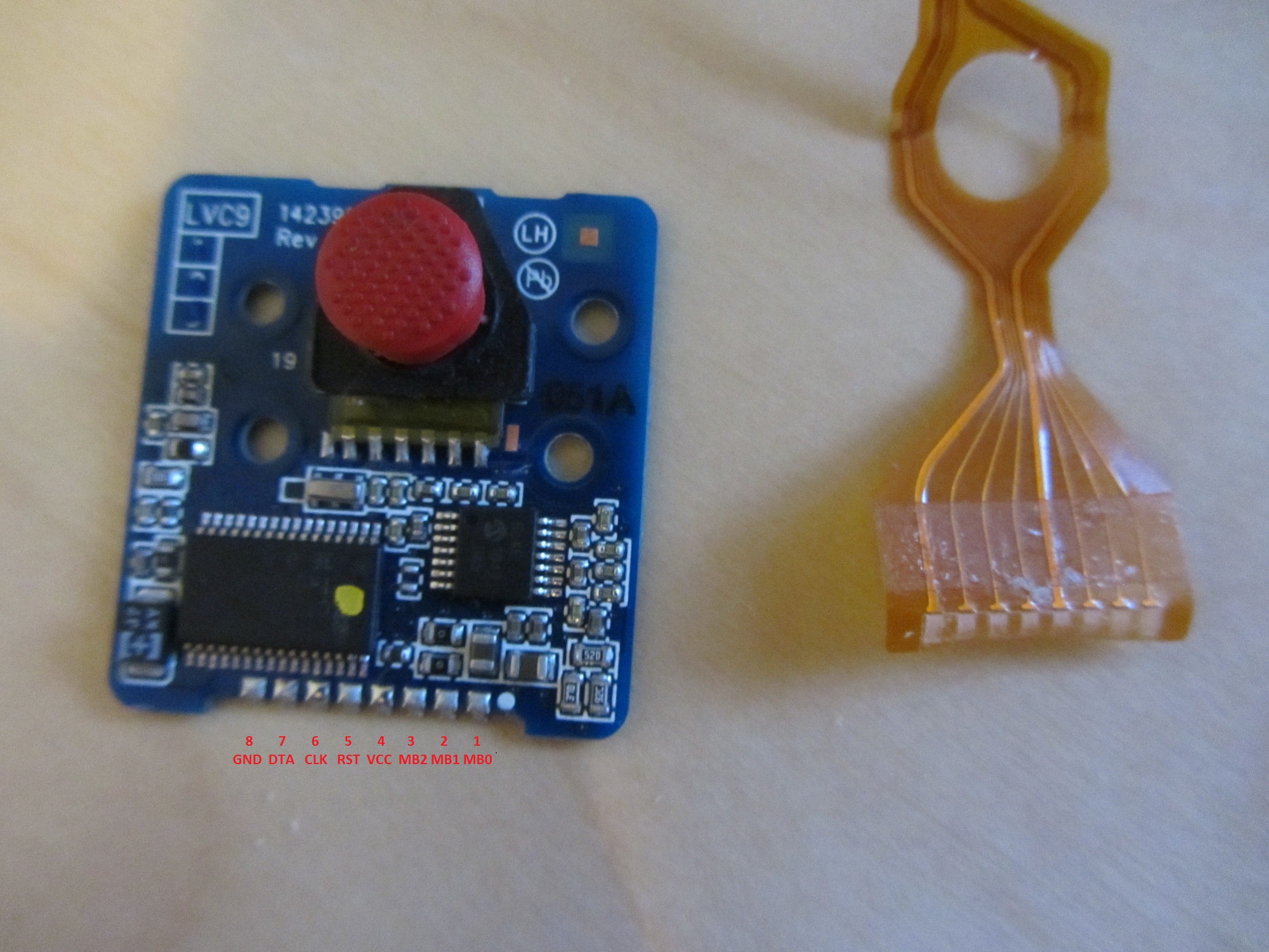

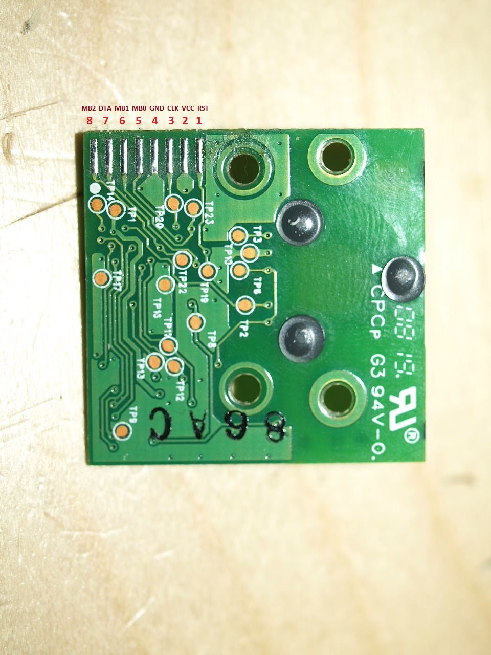

Hi,
I was finally successful in reversing this trackpoint pinout as well (starting from the pin that is highest up in your picture being the 1st pin):
1- reset (0V reading)
2- 5V
3- Clock (freq reading)
4- Ground
5- Mousebutton0
6- Mousebutton1
7- Data (5v reading)
8- Mousebutton2
Confirmed with tmk.
tent:wq
2- 5V
4- Ground
5- Mousebutton0
6- Mousebutton1
8- Mousebutton2
Confirmed with tmk.
tent:wq

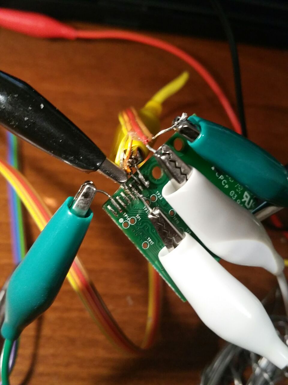

here a picture of the permutation test
the trick is:
a) make sure you have a correctly running tmk SW that supports PS2 mouse (the best is a .HEX that somebody else confirmed to be working)
b) ground and vcc are recognizable usually because they have big traces, gnd being also easy to find out with a tester then
c) mouse buttons should also be easy to trace back by following the tracks to the buttons
d) the reset when powered on is the only remaining pin that reads 0V
e) the clock and data will show 5v an easy trial or scaning for frequencies on the pins with a scope or so does the final rule-out
the trick is:

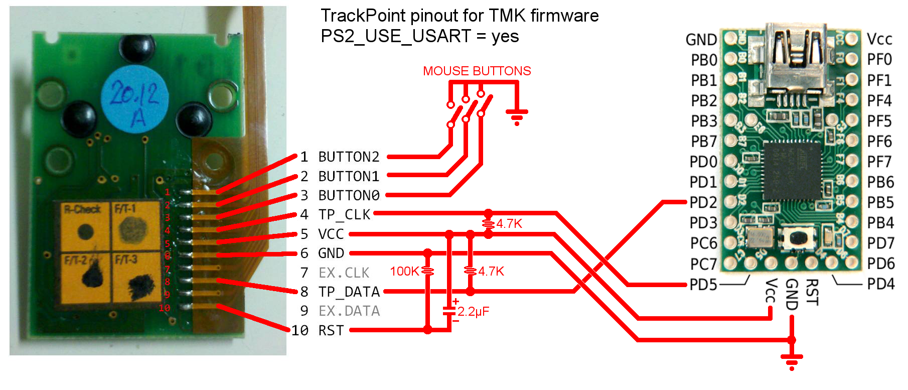

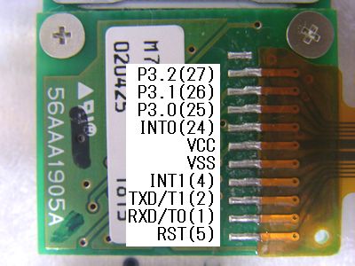

For other fellas with similar needs, I post here some pictures of the currently reversed trackpoint modules as well:
If you happen to find others feel free to post them here..

I drew the T40 schematic, feel free to post it anywhere you want - however, I shamelessly ripped the photo of the board on it from some other TrackPoint thread, either here on Deskthority or on geekhack. I don't remember which and can't speak for the photo author.

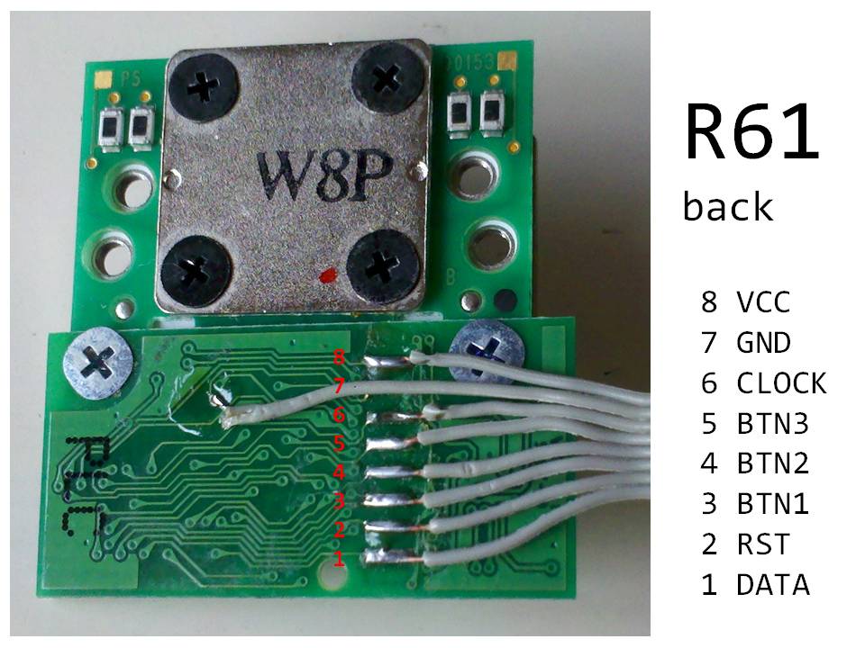

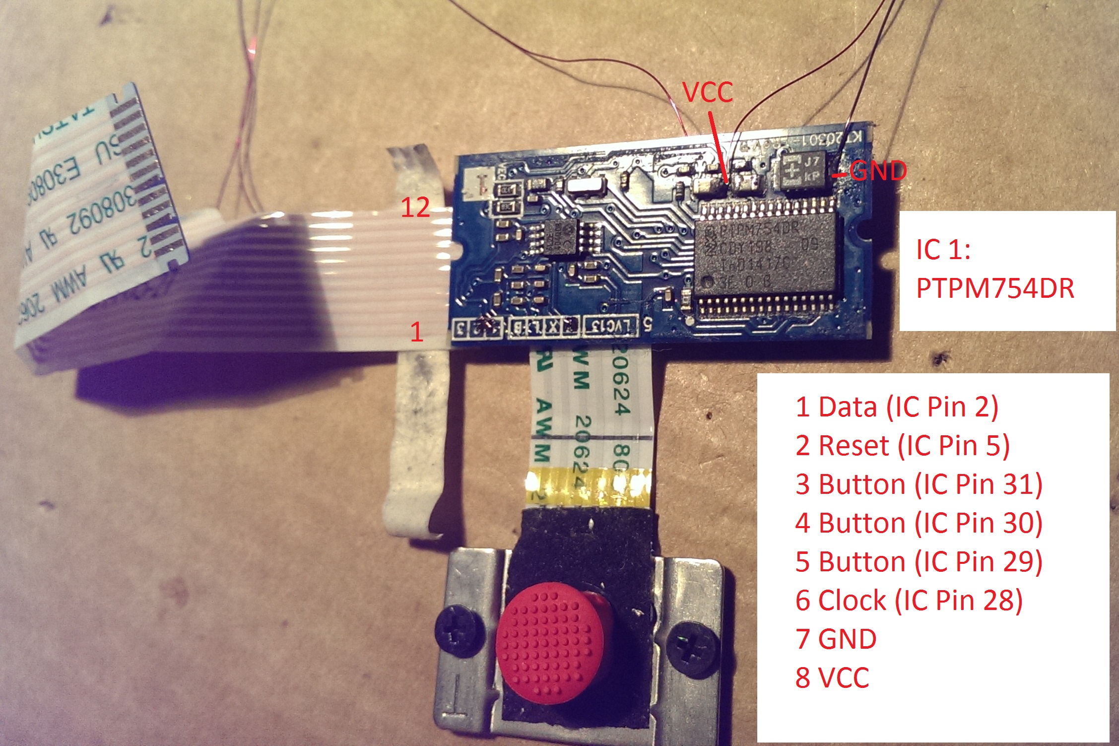

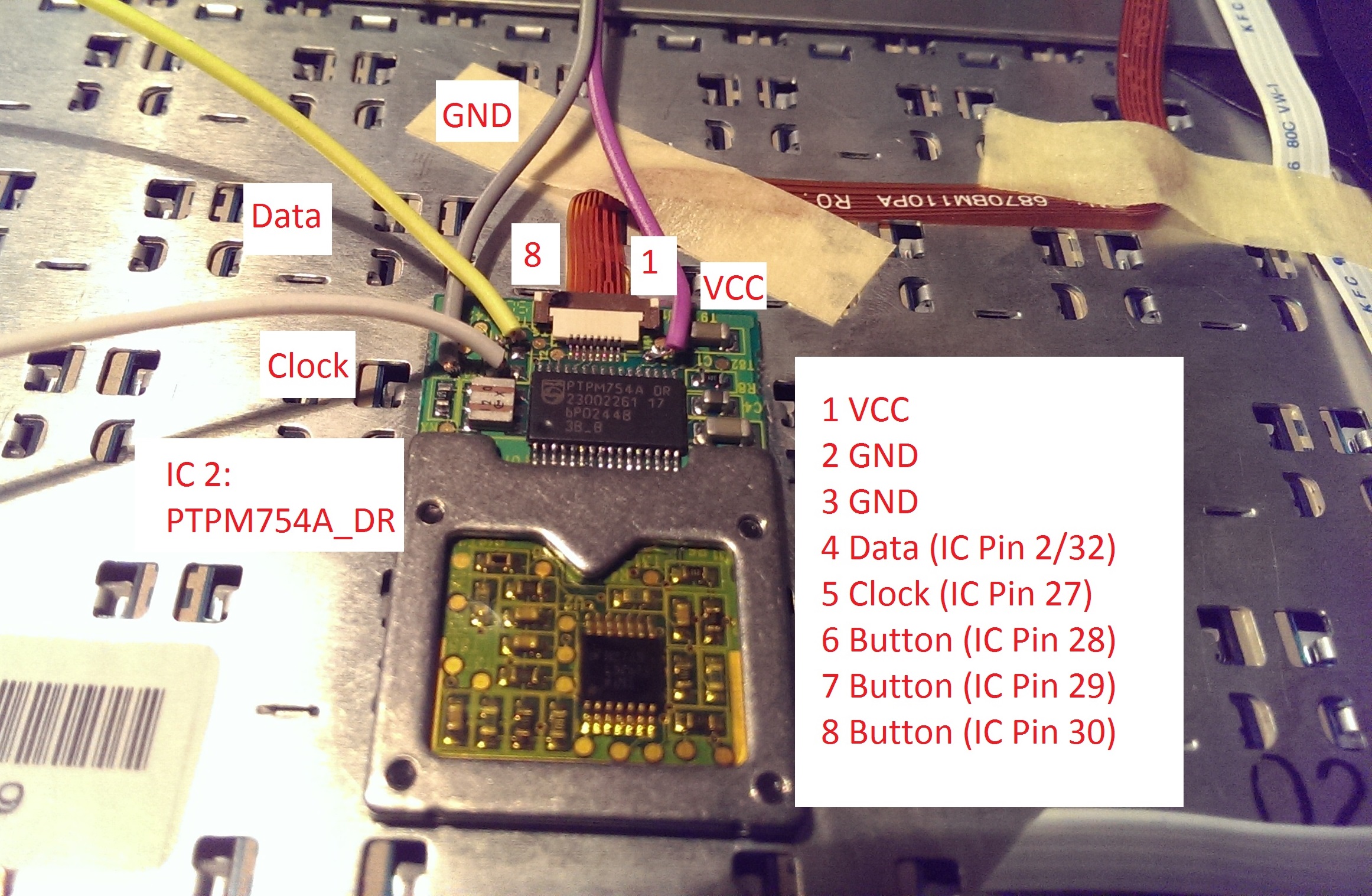

wysi
- Location: AG, CH
I found two trackpoints. I did some measurments to find the pinout. Please could some review if the following pinouts (of the ICs) are correct?
1st: IC = PTPM54DR
2 TX(DATA)
5 RESET ?
28 Clock
31 Button input 1
30 Button input 2
29 Button input 3
2nd: IC = PTPM54A DR
2 TX(DATA)
27 Clock
28 Button input 1
29 Button input 2
30 Button input 3
Correct? I think something is wrong because of the difference.
Were do I found code/ a library for AVR microcontrollers (atmega...)
Thank you for your help.
1st: IC = PTPM54DR
2 TX(DATA)
5 RESET ?
28 Clock
31 Button input 1
30 Button input 2
29 Button input 3
2 TX(DATA)
27 Clock
28 Button input 1
29 Button input 2
30 Button input 3

wysi
- Location: AG, CH
I would be interested in the pinout of the IC. With it I can measure the connections to the connector or testpoints.
I did measurements on the 2 Trackpoint boards. Now I am shure that the both ICs don't have the same pinout. But they have both 32 pins and the labeling is almost the same:
IC 1:
PTPM754DR Pinout like in the datasheet of the old IC TPM754, you have to omit the pins 15, 16, 17 and 18 of the PTPM754DR (they are connected to GND), the other pins are the same as on boh IC versions
(https://www.mikrocontroller.net/attachm ... tpm754.pdf)
IC 2: PTPM754A_DR, not the same pinout as IC 1, Data is on the same pin, Clock not
Pinout details:
IC 1:
Trackpoint Lenovo ... :
Connector PTPM54DR-Pin Function
1 2 Data
2 5 Reset
3 31 Button
4 30 Button
5 29 Button
6 28 Clock
7 GND
8 VCC
9 nc (not connected)
10 nc (not connected)
11 nc (not connected)
12 nc (not connected)
PTPM54DR Pinout:
GND: 8, 13, 15, 16, 17, 18, 32
VCC: 26
IC 2:
Trackpoint HP Compaq TC1100
Connector PTPM54A_DR-Pin Function
1 VCC
2 GND
3 GND
4 2 Data
5 27 Clock
6 28 Button
7 29 Button
8 30 Button
PTPM54A_DR Pinout
GND: 3, 9, 15
VCC: 16, 25
For IC 1 I wired the connections corresponding the schematic in this thread (4.7K pullups on Clock and Data, 2.2u and 100k on Reset).
Then I connected the circuit to an arduino uno (atmega328) with the PS/2 test sketch. But it didn't worked (the sketch should print out the mouse-data on UART/RS232)
The sketch works for an ps/2 mouse but not for this trackpoint.
Does anyone know working ps/2 mouse firmware for atmega328 or atmega2560? (or do I need a teensy?)
Does the tmk_keyboard firmware work for such a trackpoint/ ps2/mouse? (https://github.com/tmk/tmk_keyboard)
If yes, which part of this repository should I build and flash?
I think the ps/2_usb converter of the tmk_keyboard repo works only for keyboards. Am I right? (https://github.com/tmk/tmk_keyboard/tre ... er/ps2_usb)
At the moment I don't really need a firmware which works as USB-HID, I would be happy if I see some debug-info over UART/RS232.
Thanks for your help.

uhm, looks good and should work.
Try to use my fork and see: https://github.com/tentator/tmk_keyboar ... /tentboard
in practice Makefile and config.h have the interesting parts at the end included to activate trackpoint via ps2 on the tmk firmware, but of course you have to doublecheck which pin corresponds to what on the arduino.. if you use PS2 INT it should be easy to see in the arduino which are the two pins you should use as data and clock.. in usart mode they should be PIN7 and PIN23 on arduino side.. maybe better you doublecheck here the mapping between arduino and teensy: https://www.pjrc.com/teensy/card2b.pdf
And let me know,
tent:wq
