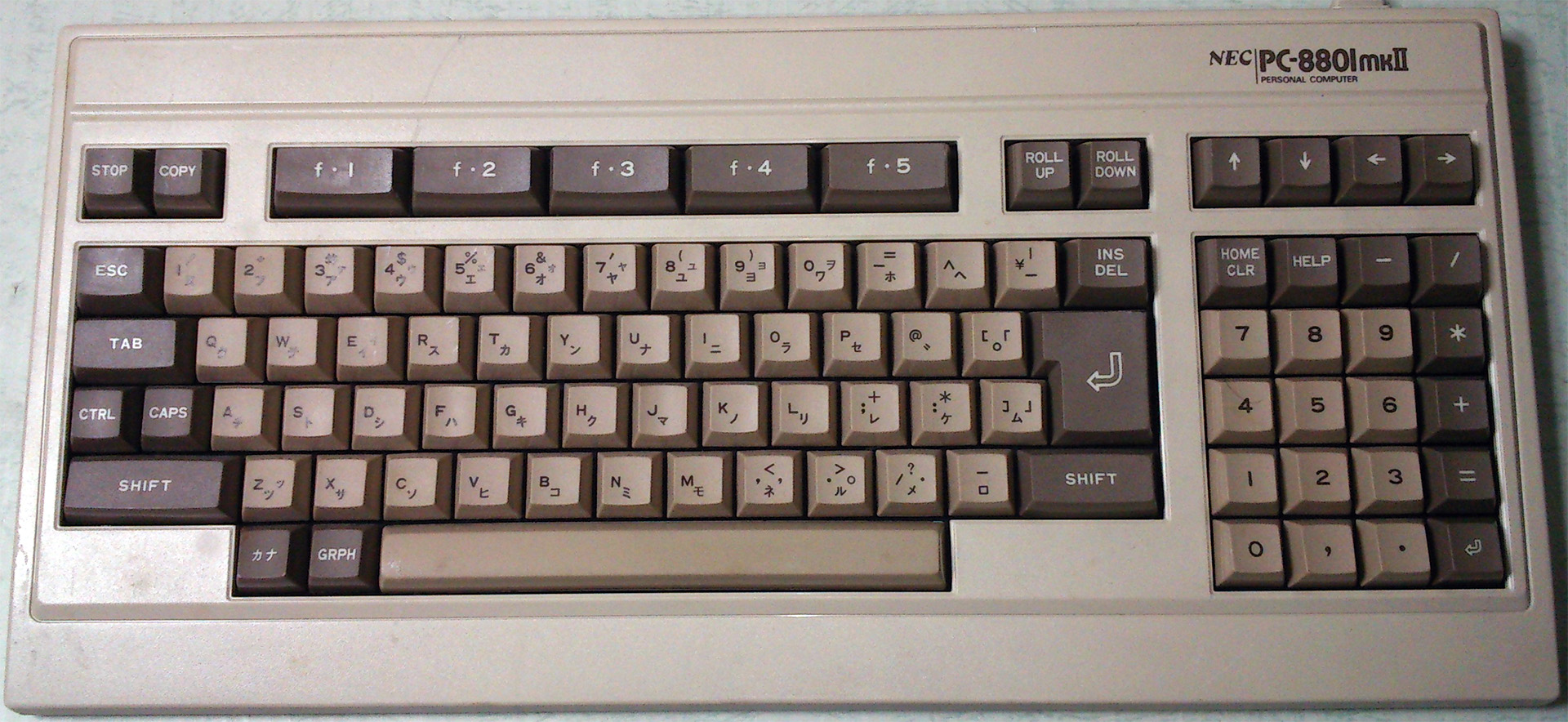

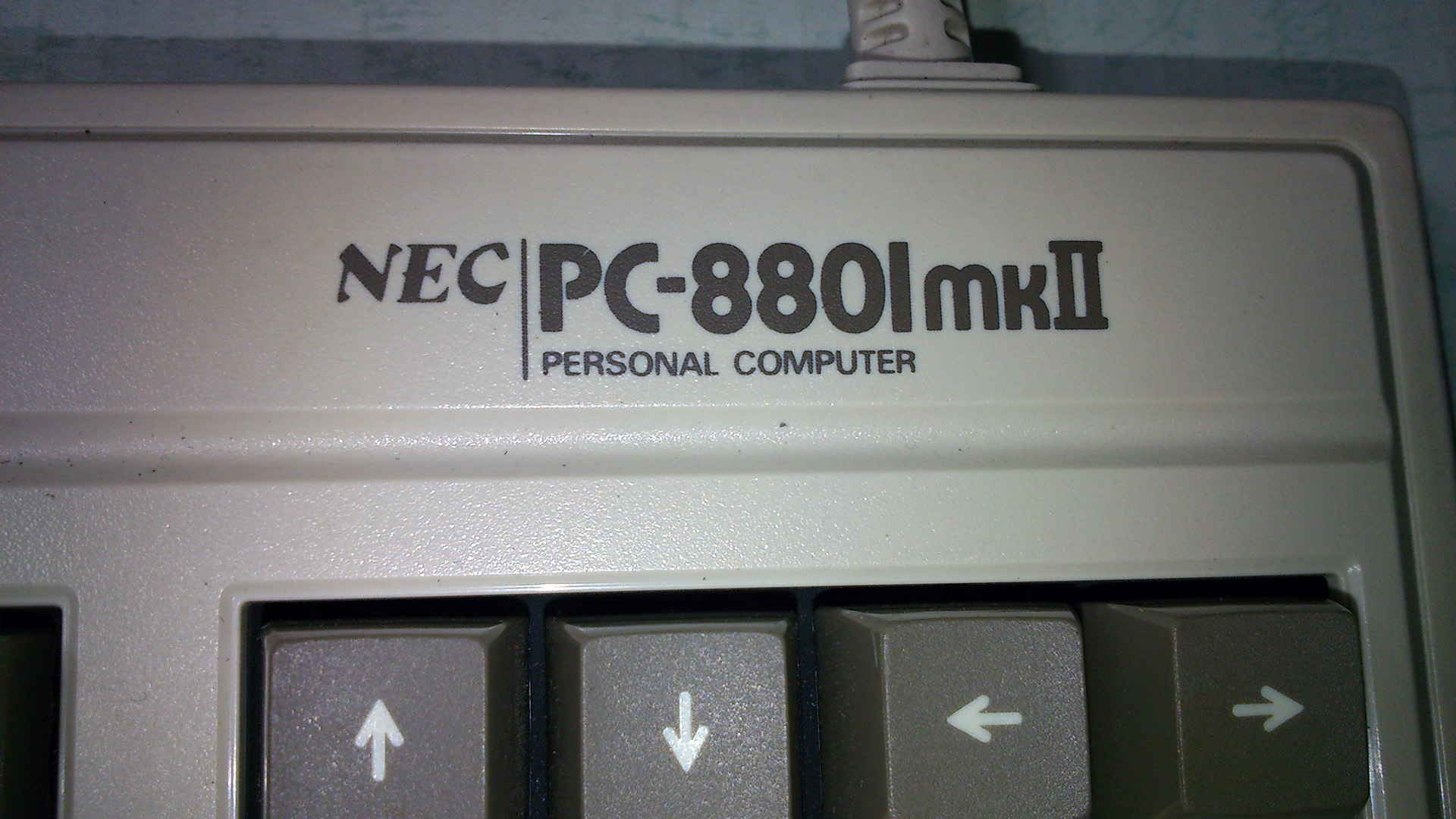

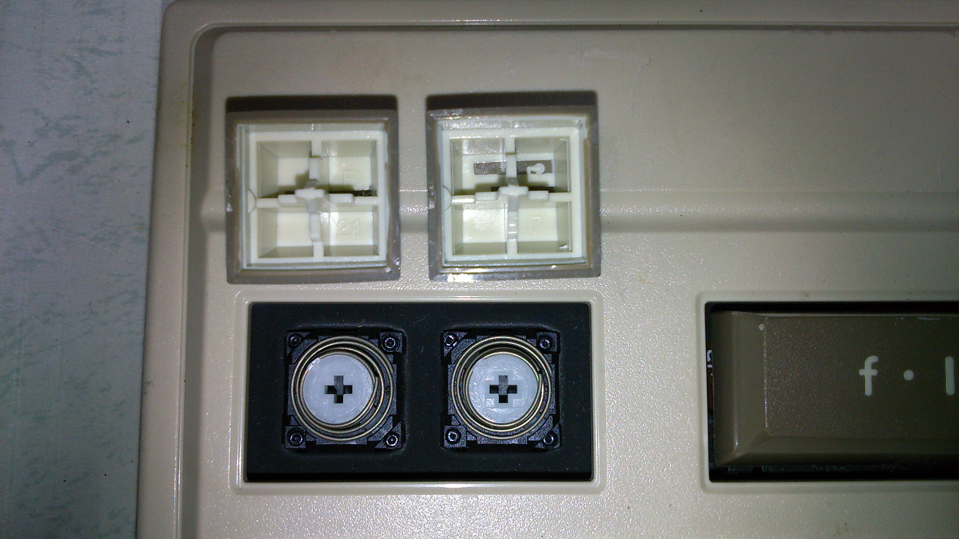

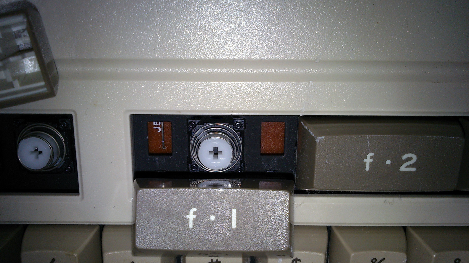

28 Mar 2014, 21:28
NEC PC-8801mk2
Function key
It is heavy so that it may not push accidentally.
Lock key
It also has Futaba of PC-9801 system. The Futaba of PC88 system is lighter.
http://kbd.rzw.jp/mechanical/elsa_notekey-106/

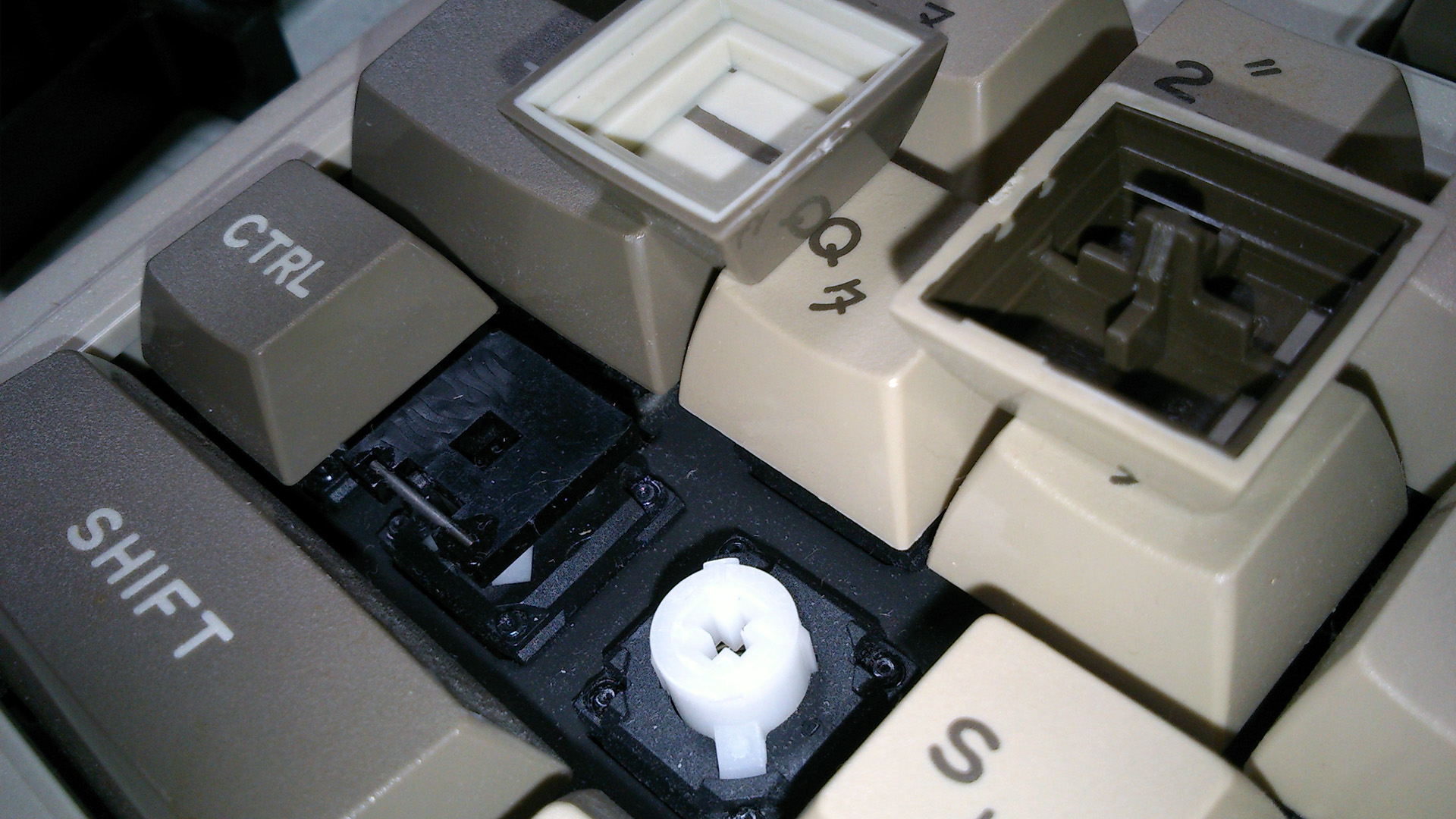

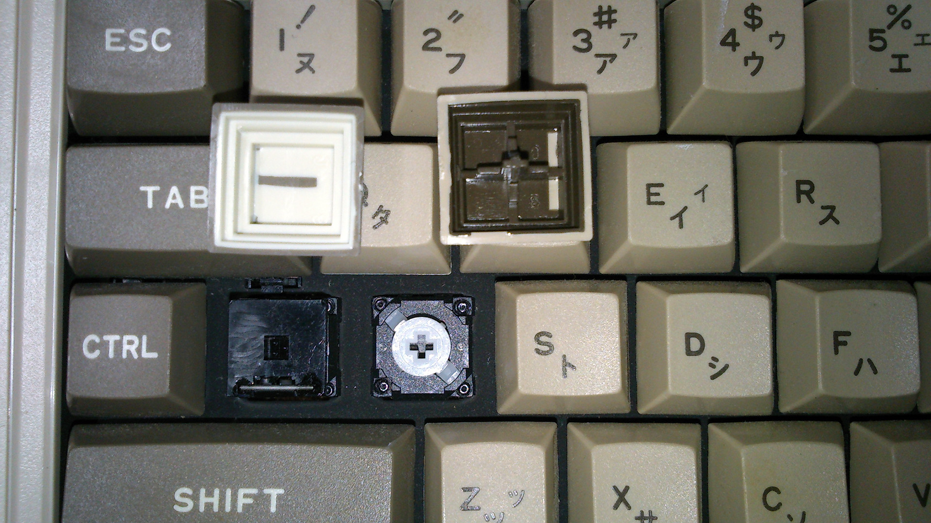

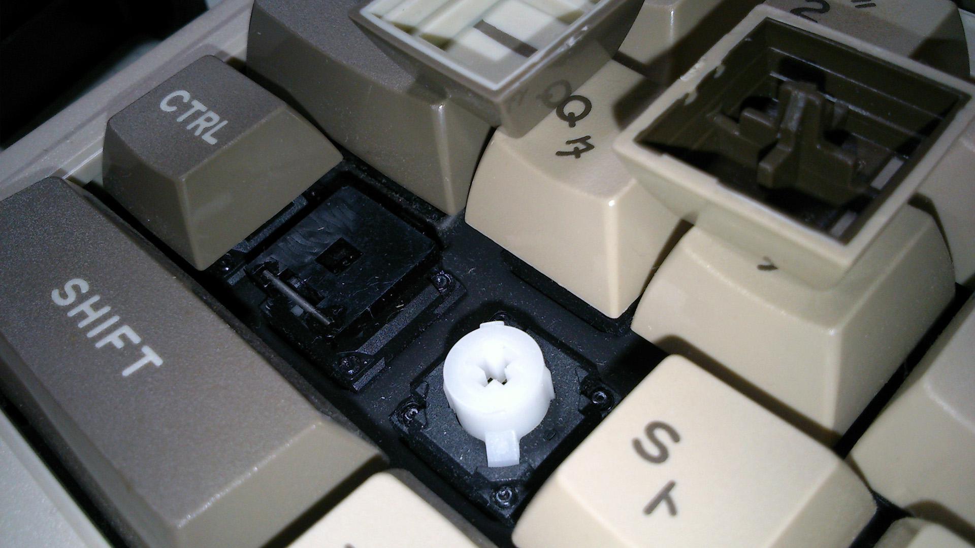

28 Mar 2014, 21:52
Clearly there's more than just the one stiff switch.
Also, that latching switch is strange. This is the newer design:
[wiki]Futaba lock[/wiki]
One day I will figure out some way of getting the switches out of that keyboard and cleaning them.

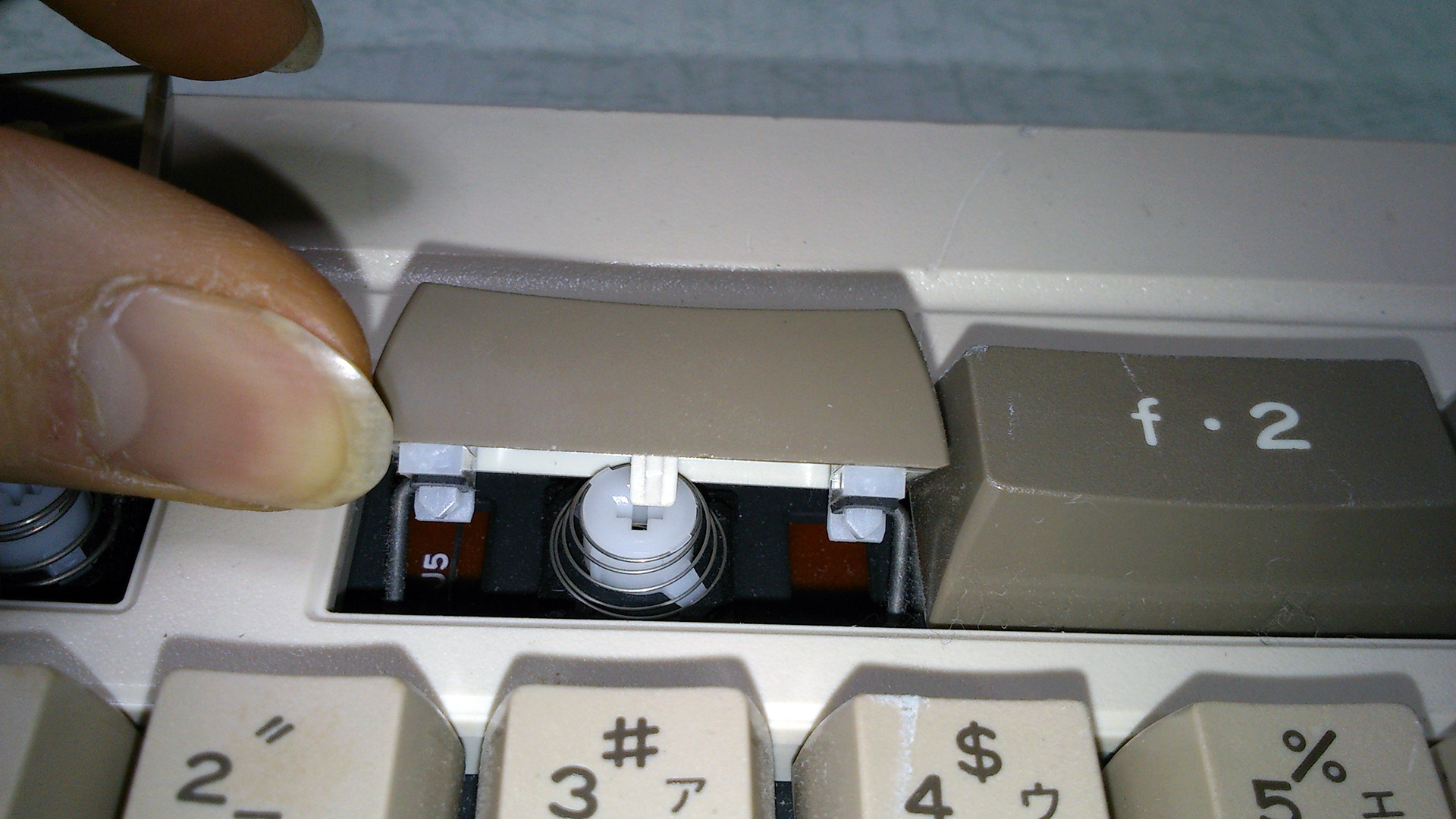

24 Jun 2014, 22:09
I got a couple of pictures from SPARC of that latching switch and I can see how it works now.
The latch arm is attached to that flat block across the top. It looks like they've kept the same slider, and then connected a flat block into it that holds the arm, with a piece of wire across that to hold the arm into the block.
It's slightly … odd.
