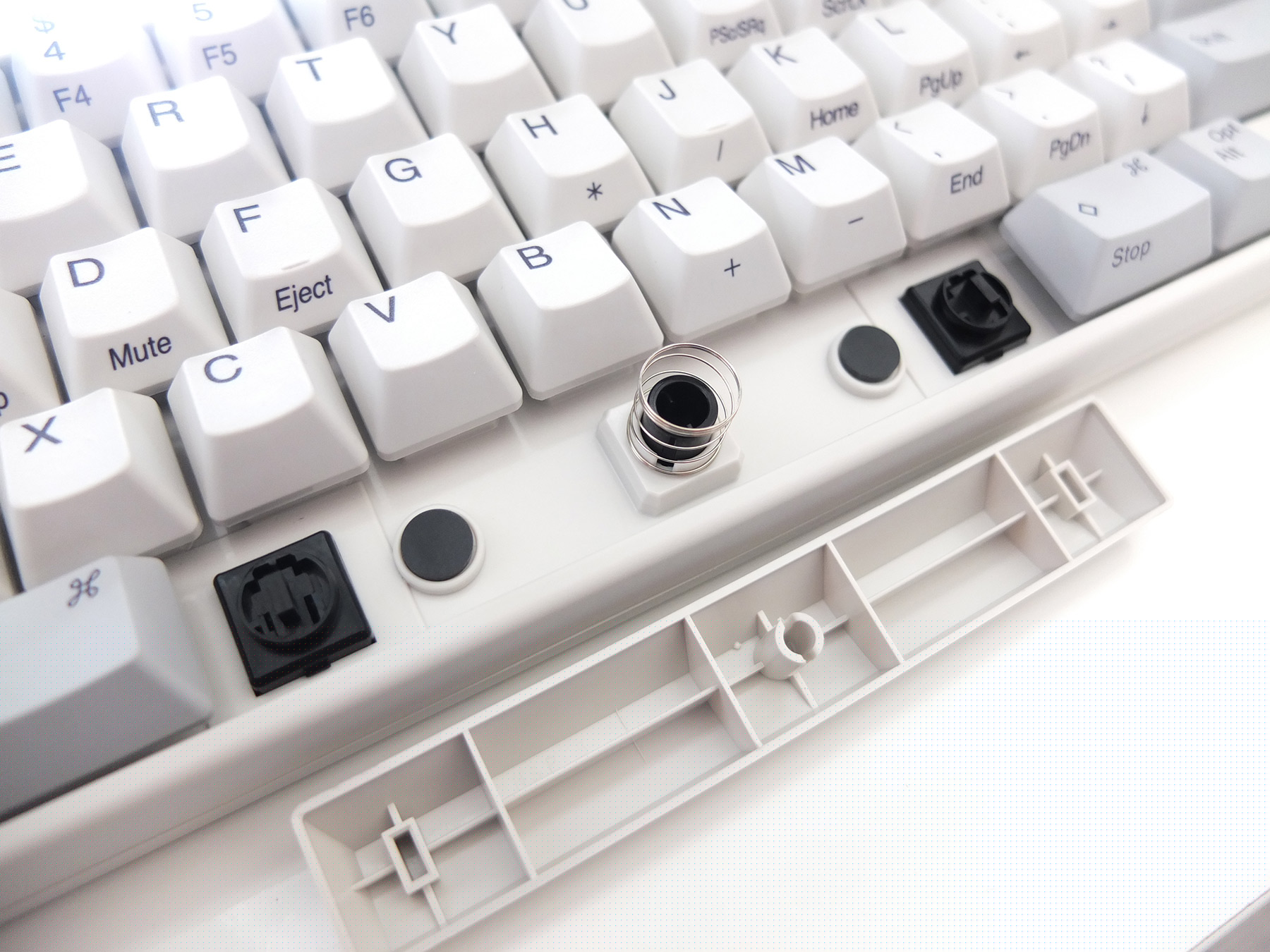

Does anyone know where I could get springs that match the characteristics of the spring found under the spacebar of the HHKB Pro2?
According to my measurements, the characteristics are:
height = 10.0 mm
outer diam = 11.5 mm
inner diam = 10.9 mm
wire thickness = 0.30 mm
full compression height = 0.89 mm
number of coils = 4
force required for full compression = 15 grams @ 1 x g
The spring is flat on top and bottom.
Might such springs be harvested from old keyboards? I think there were BTC boards with foam/foil switches that used springs under the keycaps, and I think the Commodore 64 keyboard used a Mitsumi switch with an external spring that might be suitable.
Other suggestions welcome!

Yes, I was thinking of something like this:

Actually, what I have in mind is an attempt to increase the force required for key presses on the HHKB Pro 2 by slipping a light spring -- such as the one found under the spacebar -- over the slider of each key.
I am not sure how the spring in the spacebar contributes to the actuation force curve. Given that the spacebar is the largest and presumably the heaviest of keycaps on the board, the main purpose of the spring might be to assist with its upward return. However, the spring would also necessarily add to the force required to press the switch. What I am hoping to achieve is a simple way to convert the 45g HHKB Pro 2 to a heavier version, e.g., 55g.
