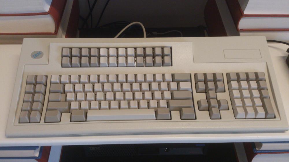

I wanted a 122-key "otaku" Model M in ANSI layout, and here's what it looks like. It still has 122 keys because I split the number pad zero. I've mapped comma to one side of 0 and period to the other.

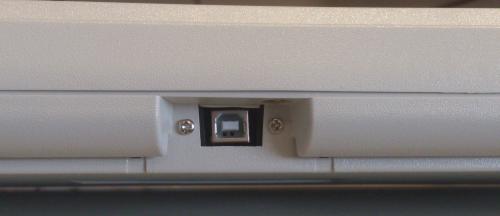

I placed a Soarer's converter internally and put a usb socket in the back:
