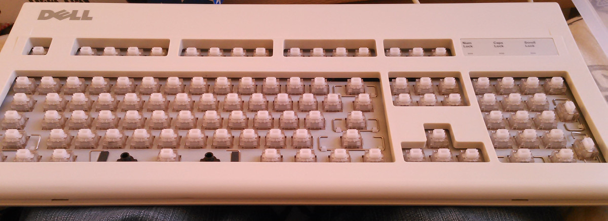

So I bought this AT101W brand new and still in the original box on ebay, hence I feel like I've desecrated something. I like the black switches but they're just not really what I was looking for. Then I remembered that 7bit sold me 400 of these lovely new clicky Matias switches.
There was a small issue with the stabilizers, where they'd pull the key down quite a bit, which I solved by making some spacers out of paper. All in all it's a lovely board now.
This should hold me over until I can build my dream board. The only thing I need now is some SA profile keycaps.
Sorry for the poor picture quality.
I can't be held responsible for the destruction of this board. It's all 7bit's fault... it's all his fault :cry:. Oh god what have I done‽

I wouldn't feel too bad about it. The black ALPS switches that come in it are pretty crap! I want to do the same to mine.

Parts of my AT102W still have black Alps switches including the number pad. If I just tap keys with my fingers, they don't feel too bad, and I wonder whether I should have left it as black Alps. But no, it's not a good switch and replacing all the switches is the right thing to do with the AT101W/102W.
Personally I consider the whole Bigfoot series to be ugly, but it's the only keyboard I've ever seen with full 105-key ISO layout that takes Alps switches.
Of course, the best thing to do with an AT101W/102W:
• Throw away the horrid banana case (especially if salvaging an old keyboard that's gone yellow)
• Replace switches with green/orange/blue Alps or Matias click
• Fit PCB and plate into nice metal case (black dyed anodised aluminium looks really nice, like metal velvet)
• Replace keycaps with ............................?
As far as I understand, a group buy for Tai-Hao doubleshots in Alps mount is possible. Matias also have Alps-mount keycaps coming at some point, as I understand. I assume SP can still do Alps mount.

Nice work. I really would be interested in a sound sample of that board as I conceived the Matias switches as rather loud but ascribed it to the casing (Matias Tacticle Pro).

I believe you could also have opened all the switches and replaced the spring and clicky leaf with Matias'. No soldering, but could probably have taken more time.
I have also heard that Matias' switches would be more wiggly than "complicated Alps". I have not tried them enough to figure that out myself.
21 May 2014, 00:12
Findecanor wrote:I believe you could also have opened all the switches and replaced the spring and clicky leaf with Matias'. No soldering, but could probably have taken more time.
That's the reason why I've still only converted something like 70% of my AT101 to fake blue Alps — opening up switches and swapping parts is really time-consuming, and I broke a couple of the blue switches in the process (nothing serious, just snapped T tabs from ageing plastic that's gone brittle, like how the plate retention wings crack and snap).
Having felt that the switchplate's actuator leaf might account for some of the degraded feel, I should really pull all those off and swap them too, but ........ argh.

I get my B.Sc. in electrical engineering in a week.
The desoldering only took me about an hour and the replacing and resoldering only about an hour as well. That's with my cheap and terrible iron from a local store and my pump from DX.
Also on the height issue. Turns out I just wasn't violent enough when seating the keycaps. It's all sorted out and without he need for spacers.
Findecanor wrote:I have also heard that Matias' switches would be more wiggly than "complicated Alps".
They're only slightly more wobbly than the black Alps that were on here before.
Daniel wrote:I really would be interested in a sound sample of that board as I conceived the Matias switches as rather loud but ascribed it to the casing (Matias Tacticle Pro).
A sound sample you shall have. I'm bottoming out mostly. The quieter sounds that still sounds like typing is actually just me wobbling the caps ever so slightly. It's certainly a LOT louder than the black Alps it came with.
